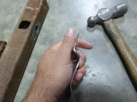

Ok, I'm off today so I banged out a mock up patch to show you G. Since I don't have a 60 anymore (:mad:) I had to go off the pic for reference but I bet its CLOSE!! :rolleyes:
Start with a piece of sheet..
Then bend a sharp edge for the top..
Then a smoother bend on the flip side..
AND TAH DAH!!!!!
Spot weld it in as we have discussed before and then prime and Monstaliner it..
Or as Georg states.. buying one may be easier, but I know you wanna learn the welding aspect..

Thanks Georg, definitely want to learn the welding aspect and really the rest of the tailgate is in great shape so no real need other than that one section. But I will keep that in mind!
Thanks for the pics J, I really appreciate it. Definitely gives me a good idea of what I need to do! Think I might have to go buy a bit bigger sheet as the one I got was only like 5x12 and that was enough to cover just the whole. Oh well, scrap metal for me to practice on!!

Some 16/18 gauge steel, a hammer (and a slight rounded edge to shape with) and bend a piece to match.. Take your time and you will get it pretty close.
