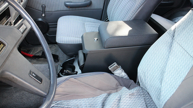

New Smittybilt....
Untitled by renofizz, on Flickr

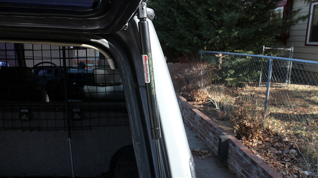

New upper hatch struts!!! The glass finally stays open!

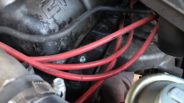

New JimC allen plugs for the air rail (finally completed desmog!)

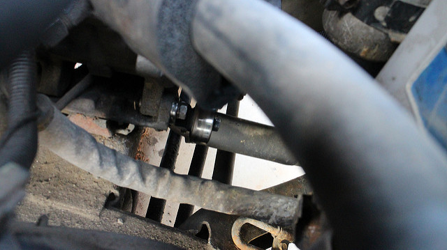

Hard to see AC Idler Pulley with new bearing!! No more random noise from it or screaming..

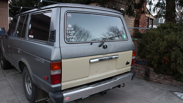

And finally, the new tailgate bought from Finny!

When I was taking the air rail off I found that the connector nuts (piece that holds the rail pipes to the block valves) on the front 4 (cylinders 1-4) were all so loose that I spun them off by hand, no wrench needed. Then the actually block valves (or whatever they are called) were loose enough that I could do a quarter turn with a socket and then unscrew by hand, the #1 cylinder was actually loose enough that I just did it by hand. This was in GLARING contrast to the back to which the #5 cylinder I had to use my 1/2" drive socket and BFH to get it loose enough to turn by hand with the wrench and the #6 had to be cut at the pipe and then the socket actually took both the small section of pipe, nut for the pipe to valve connection and the valve all came out after some major grunting and cussing as one piece.
This is all after it soaking in PBBlaster for 2day (enough that on the first start up all the excess PBBlaster smoked for a good 30 minutes.

But dude, knowing how much you love tan, like really fxxxing love tan, that nice looking tailgate will either kill you to cover up with a different color, or, wait a minute... I like where this is headed. :grinpimp::beer:
LOL... Yeah I know... when I was headed out of the office yesterday I just kinda sat and looked at the tailgate and thought to myself "damn I love that color!" Still debating on Monstaliner or paint, since I don't have a compressor I would either have to find someone with one that is large enough to borrow and use or have it professionally done. Leaning towards the Monstaliner still, but really it is like a 60/40 split at this point.
What she could look like ;)
Well, you have the tailgate from those pics already... You're 10% of the way there!!
Dont know if the 464 Beige would look funky with all grey interior... And NO I do not want to swap out my interior while I am at it... :flipoff2:
Dont know if the 464 Beige would look funky with all grey interior... And NO I do not want to swap out my interior while I am at it... ************
Tint the windows limo black.. never roll down the windows or open the doors again and you'd be ok... Or pray for color blindness.;)
