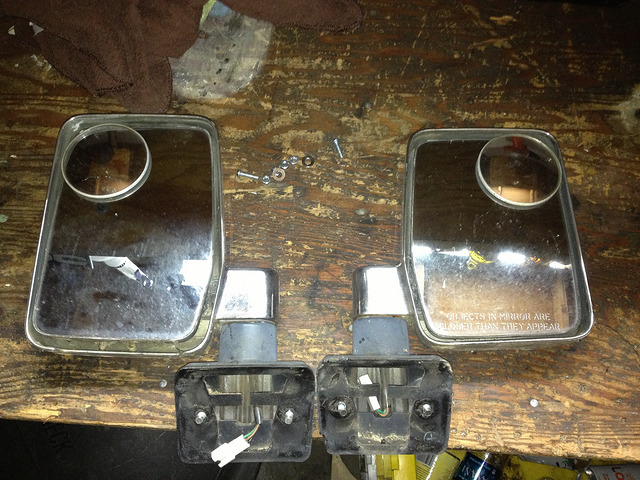

So since this week is a holiday week for me I am off early from work. I still have a bit of gas left in my welding tank so I was planning on tackling two things this week;
- work on stabilizing the DS mirror

Perfect!! Thanks, will probably play with the mirrors a bit today before the club meeting. Tailgate later this week.

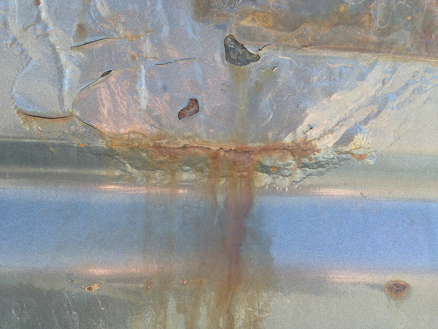

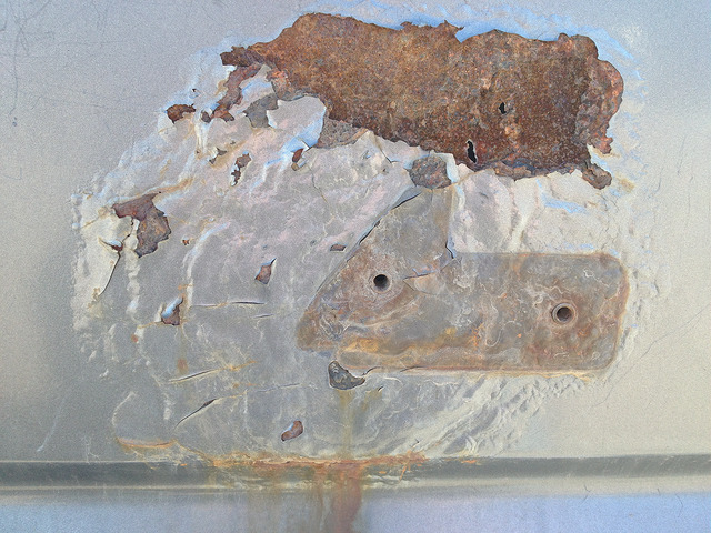

Really need to get on this welding crap, gonna have to grab another tank next week after we are back from Turkey Day as this weekend when i took the dogs to the park they knocked off the paint exposing the rusted section. Which means that will rust even quicker seeing as the truck always sits outside.
So the question now is, the bubbling goes down to the curved/angled section at the bottom but still feels strong. Pretty much assuming that I need to cut the out and replace but what is the easiest way to do that? Should I see about finding a press brake and bend the piece to fit or is it just easier to weld a separate piece on at the angle needed?
