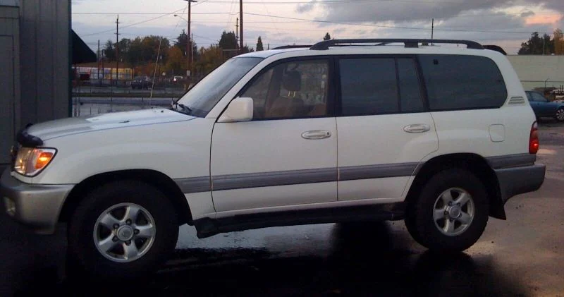

Finally '99 100 owner....
I got the call tonight that my offer was accepted and will be picking it up Thursday night after work. (praying it goes down without a hitch) Then to the garage it goes.
I will hopefully be tearing the interior out on Friday night then......
  • Competently disinfect this thing and clean head liner to floor under carper once removed.Done
  • Install my leather kit. Done
  • New heated seat inserts as I want HOT. Got em
  • New drivers cushion. Ordered today
  • Complete carpet. Ordered front today
  • Husky liners up front. Ordered today for both rows
  • Re wrap all the pillar panels with new vinyl that matches the seats. Done
  • SOR middle row seat cover "Tuff Duck"
  • Re tint entire truck. Done
  • Steering wheel and shifter recovered. Shipped out . Done
  • Order speakers for doors. Ordered from Crutchfield, Infinity Reference 6022si .
  • Order OME lift kit from Slee Done Done
When inside is finished then......
  • Timing belt, cam seals, water pump, plugs, filters and all fluids. Mobil1
  • Rear Akebono pads and slotted rotors.
  • Replace all interior and exterior bulbs with LED. Got them coming from eBay.
  • Install HID head lights, lows and highs and fogs Got them coming from eBay.Done
Then figure out a few things......
  • Removing the running boards. Done
  • Rebuild starter. Done
  • find out why the cup holder cover is a bitch to open. Full of cola residue.Done
  • Find out if mast is broken for antenna. Broken Done
  • Remove bug deflector. Done
Then the outside will get........
  • Full paint stripping by clay magic and Dawn dish soap.Done
  • De grease and detail all the jambs and engine compartment. Done.
  • Touch up all rock chips and bake them rock hard.
  • 2000 grip wet sand most flat areas then send to body shop for polishing.
  • My company name at bottom of doors below molding.
  • MUD and other decals in rear side windows.
Thinking about.......
  • Having the wheels powder coated, but what color?Done, sold and bought new OE Chrome
  • Re painting the bumpers or replacing them. Done Slee front
  • Roof rack. Done
  • Rear cargo storage. Installed Outback Solutions.
  • Rack Mounts and rack. Done
  • 2.50 OME lift (cheap way) Ordered from Ben @ Slee today Shocks and Springs
  • Diff drop, Slee Done
  • Do you remove the factory rack? If so whats the steps? Done
What has been done recently.......
  • TBS
  • Rebuilt CVC'c
  • excessive fluids
  • All hoses
  • Radiator
  • Battery
  • Front brakes
I know nothing when it come to the tricks and secrets of these, so if you think I need to know about it please post up a thread or thought as I really want to know about it.
Fire away.
best,
Shane
