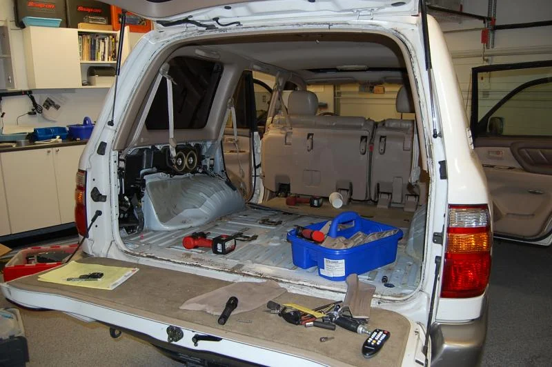

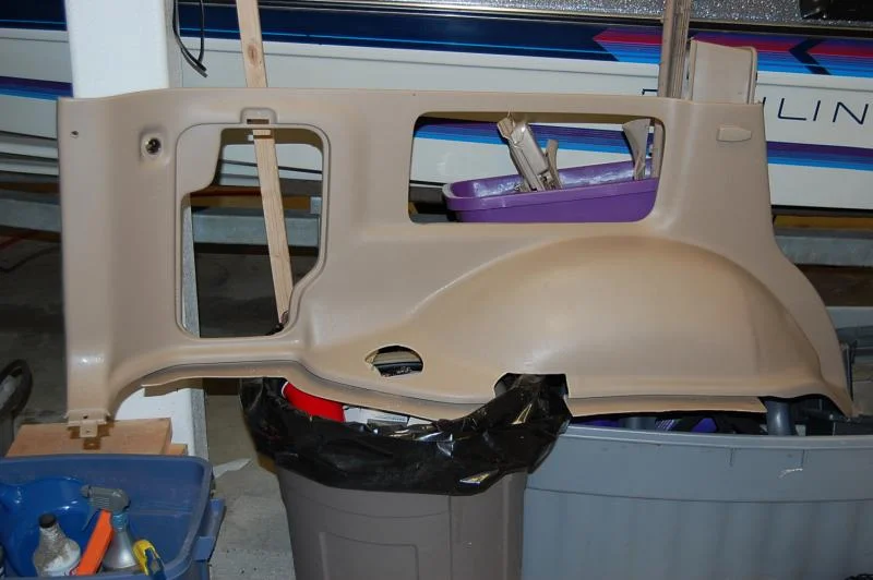

Stripped out the 3rd row area.
Will pull out the seat belts and clean them tomorrow.

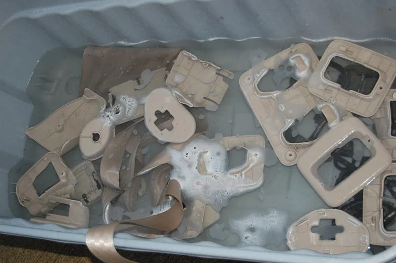

Cleaning seat belts.
First I strip all the webbing out and zip tie the ends. Spray with a cleaner from our detailing vendor called "Special Cleaner" on all the stains. Then a soak in a diluted bucket for an hour. Then removed and used a brush and scotch brite pad to scrub then from end to end. Then into a bucket of fresh cold water and rinse them thoroughly and towel dry and let stand inside to really dry.

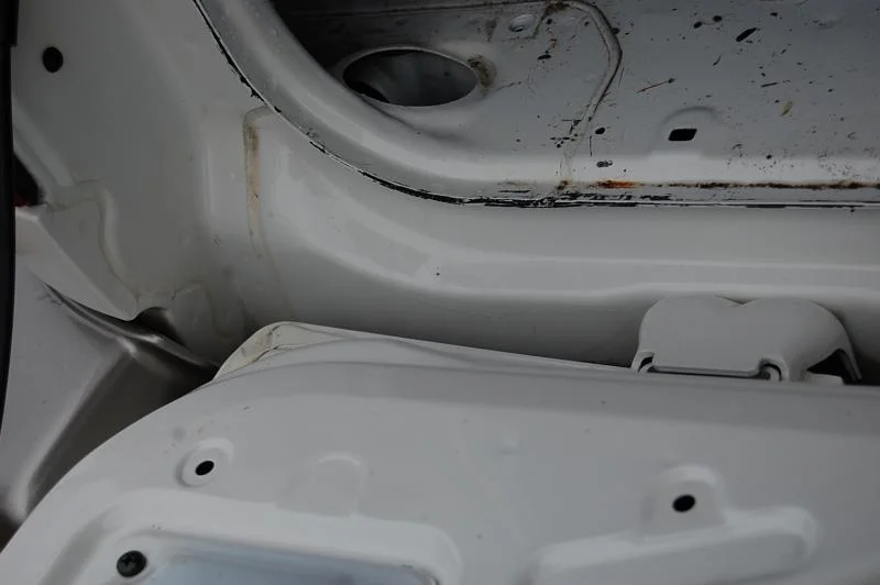

Are you going to add sound deadener material while you have everything out? FYI: It made a substantial difference in mine especially over the wheel wells.
