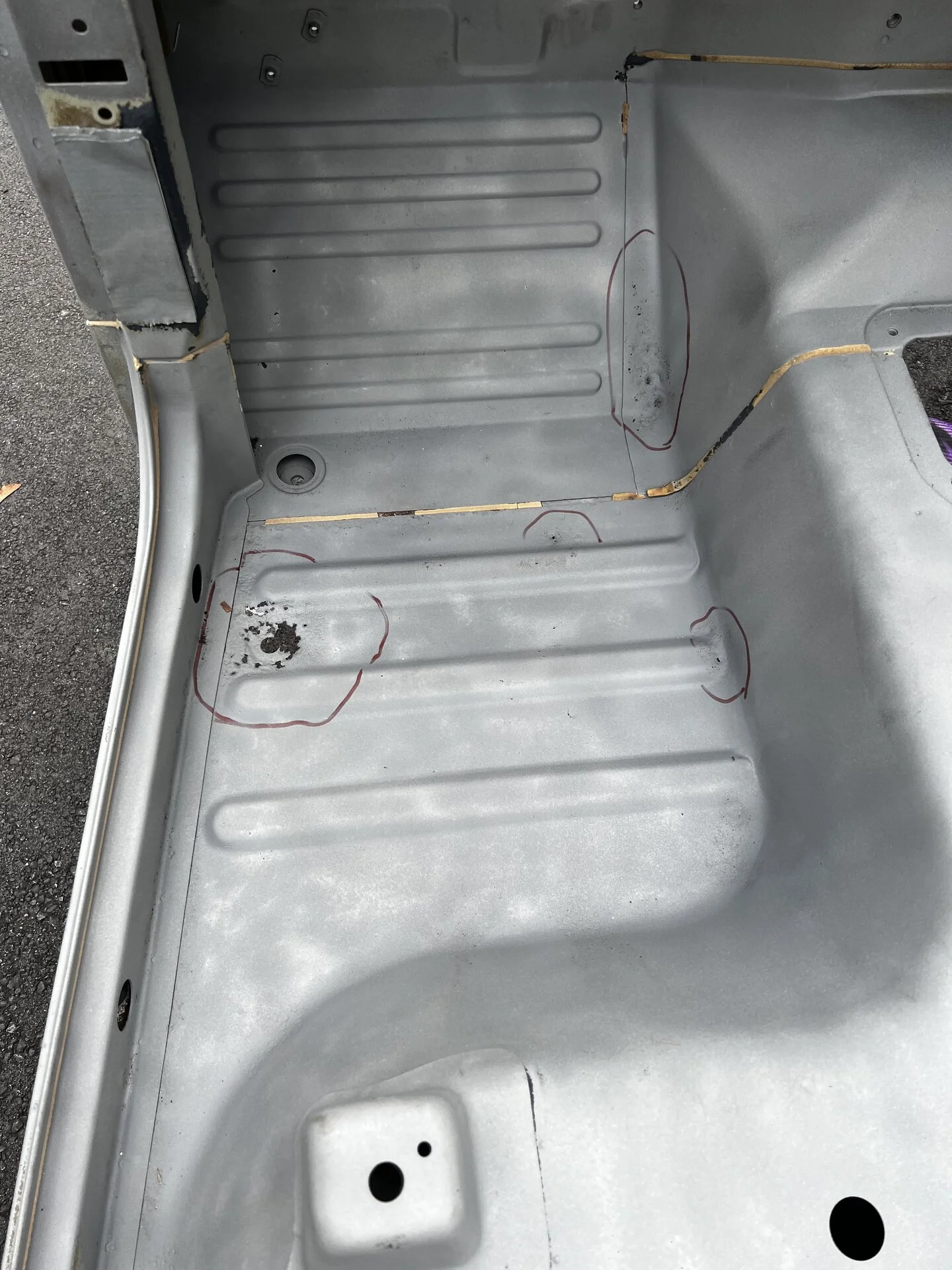

I am in the process of rebuilding my 1979 ‘40, and am getting ready to start welding/repairing the tub and body parts. Since having the original paint blasted off, I have found this tan bead of filler between panels and joints all over the tub. It’s semi-flexible but pretty crusty being 45 years old…
What is this stuff and what is its purpose?
Thanks in advance for any insights.
Seam sealer.
Yes, seam sealer. You can buy it in caulking-type tubes at autobody supply stores. You'll want to remove the old stuff and re-apply it to all seams before you go to repaint your tub. It's really messy stuff, so lay down a strip of masking tape on either side of the seam you're re-sealing. Smooth with a gloved finger, remove tape. Once dry it can be painted.
Fantastic. Many thanks.

I'm almost ready to do paint prep on my 1979 and plan on slightly different order of seam sealer application than previously mentioned. As noted...you need to remove all the old seam sealer. Then I will epoxy prime everything....then seam seal it. My particular opinion is that the 1979 DID NOT get enough seams sealed. There are tons of seams that toyota seemed to ignore....but water and rust did not ignore. The epoxy primer is the primary thing to seal it up. The seam sealer followup covers big gaps and then the top coat will go on over the seam sealer.

Also apply the seam sealer before your epoxy’s flash time. It will literally chemically bond with the primer.
Seam sealer also has a flash time, need to scuff it if top coating outside that flash time window.
