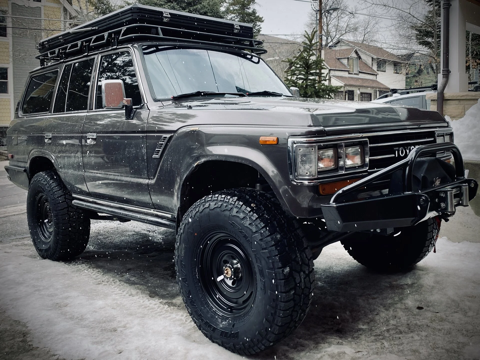

This 60 runs them:
I just bought a new set of tires on my 17 inch rims, so the analog wheel is out for me, but I like the look! The old school Montero on their website looks right with those wheels.

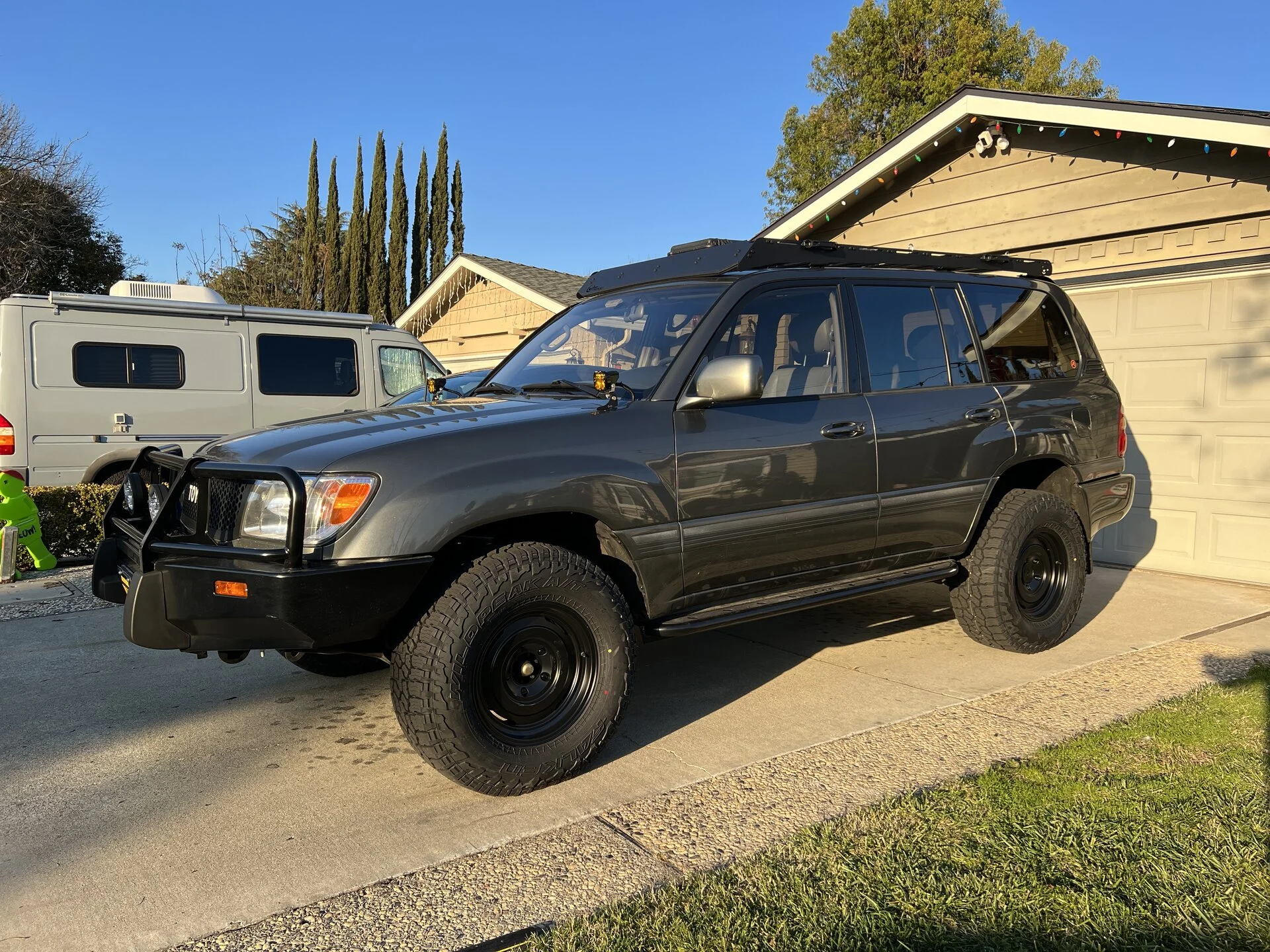

17s, 0 offset.
285/70/17 Wildpeaks and an Ironman 2-2.5" lift. Front needed a little cutting for full turn. Installer installed the torsion bars per Ironman, but think that they can re-index the bars to get a little more out of it. Waiting a few months to see how the rear settles first.
interesting... im currently running 285/70/18 Nitto Ridge Grapplers (34" tire) on relatively stock AHC suspension (I have a very minor sensor lift: .25"+ springs & spacers out back for added weight)..... no rubbing at all. Those Wildpeaks are 32.8"... + lift ... and still rubbing (?) . I'm really interested in those fifteen52 wheels when I need new tires.
Did you go with the Pro Cell Foam Ironman lift? If so, any opinions? Read very good things about their Pro shocks...
