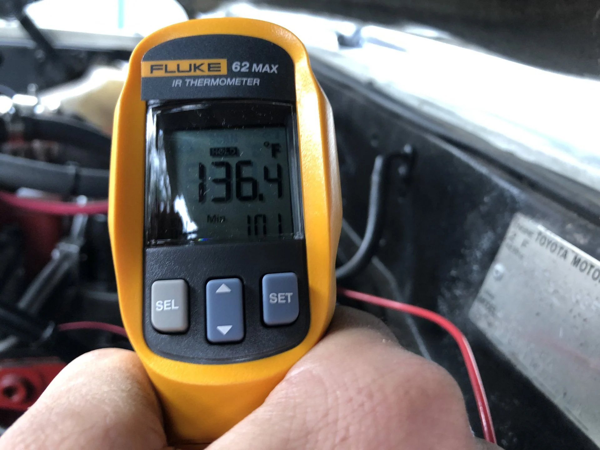

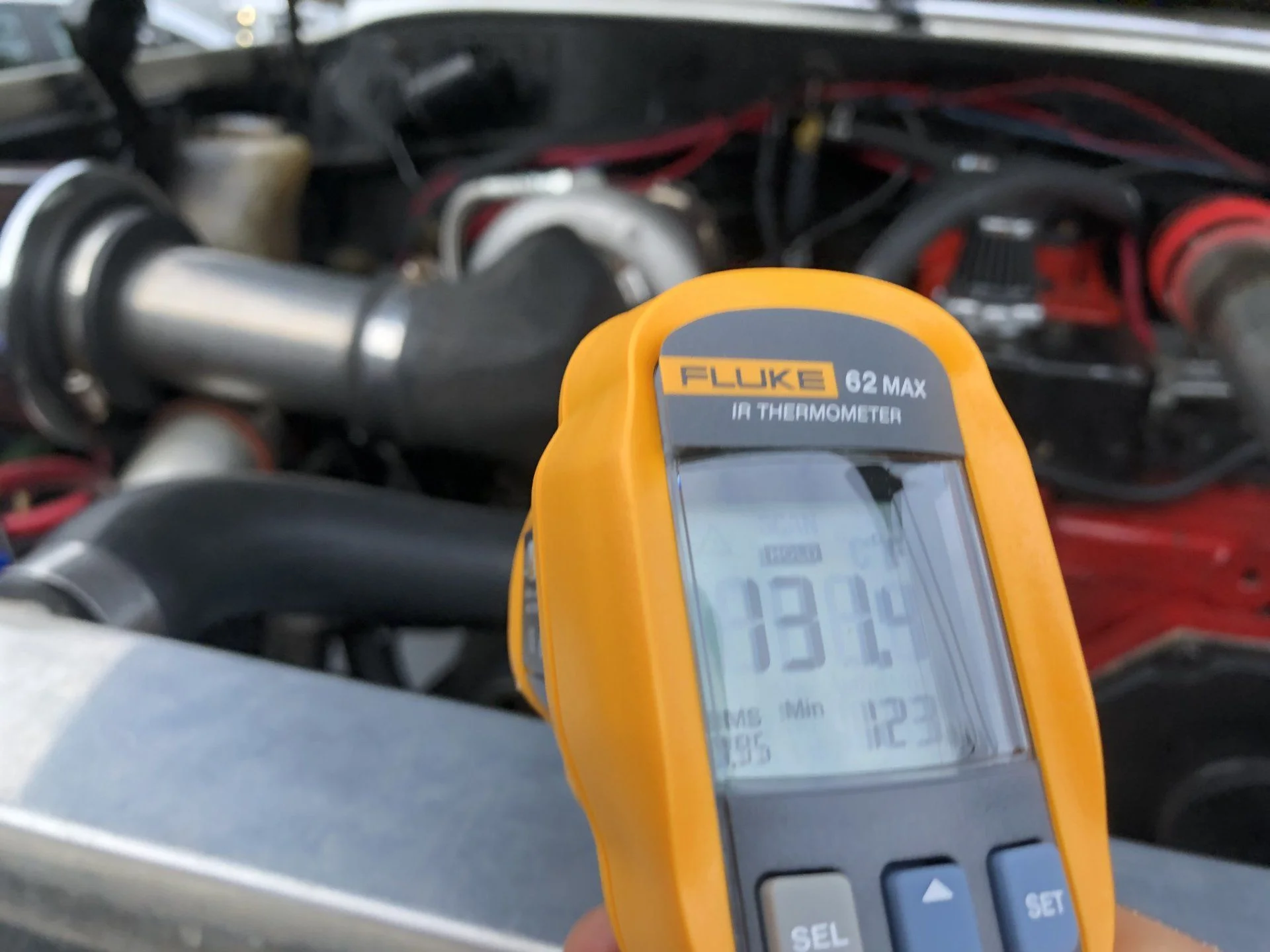

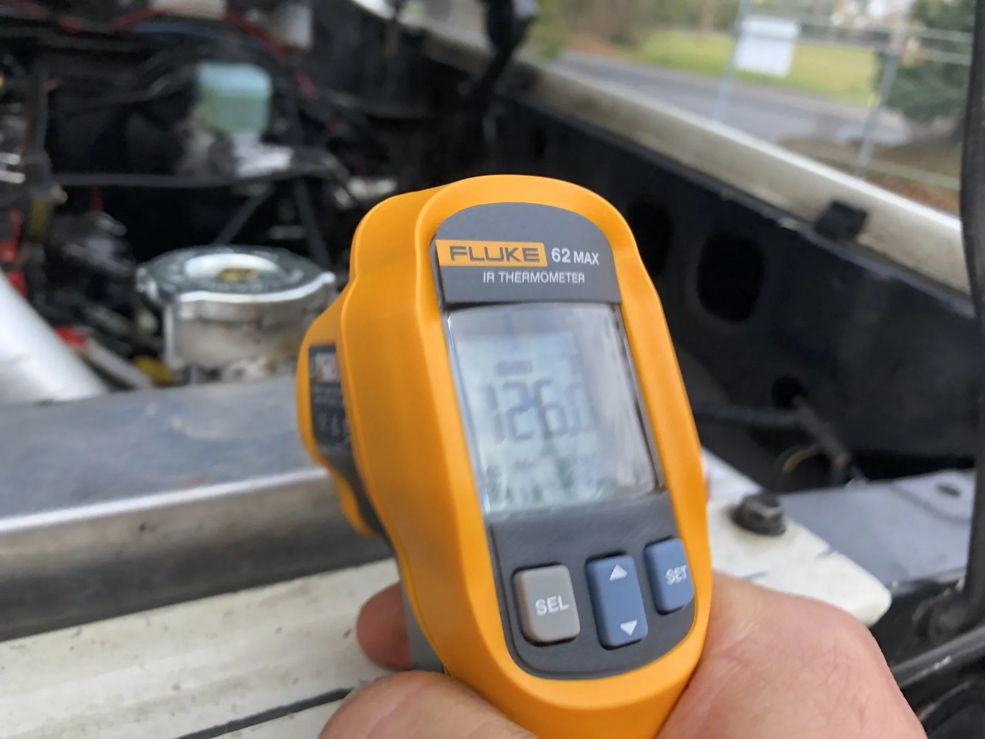

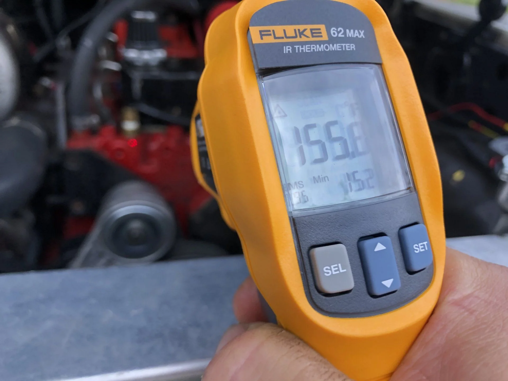

Pickup a temp gun this morning to check temp. My water temp gauge is in the back of motor and is right on.
Fan sensor had the highest temp.
Radiator hose
Radiator cap
Twice I’ve checked water temp since the Speedhut gauges and the temp gun showed the front hotter than the back of motor.
Cool, I could see areas with less circulation being hotter but on a 4bt I wouldn't think that should be an issue with the same pump as a 6bt. The last spot leaving the block should be the hottest- makes sense to me...I'm so thankful you guys figure all this stuff out.
Interesting results. The last cylinder is the furthest away from the coolant flow so it makes sense it should be hotter. This is also the likely spot for coolant pressure spikes when pushing more power and was the reason I ended up installing a coolant bypass set up to release pressure from pushing out my freeze plugs. I wonder if the front reading being on the exhaust side of the head had some heat soak going on. I'll have to try you IR gun on my engine one of these days.
