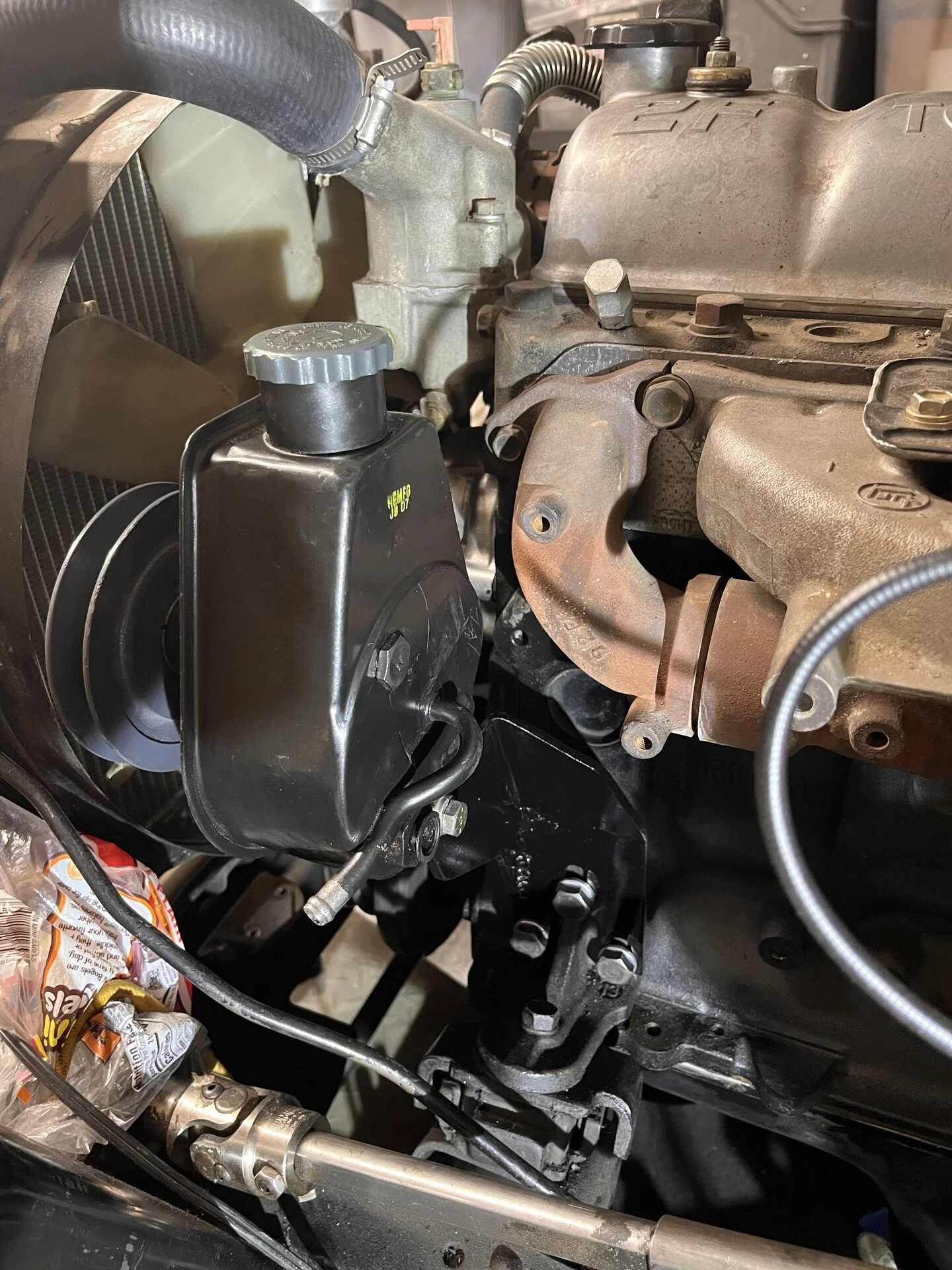

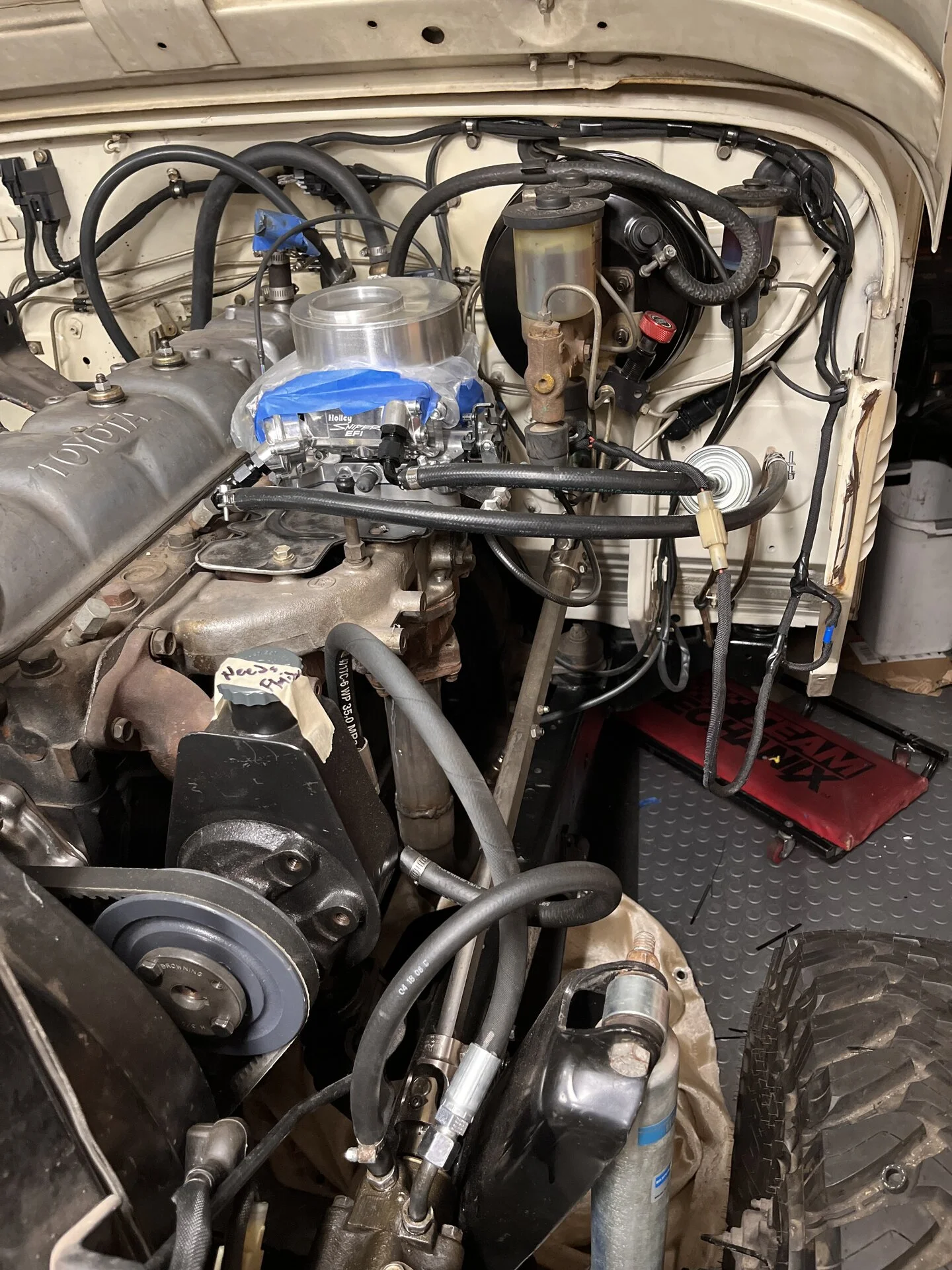

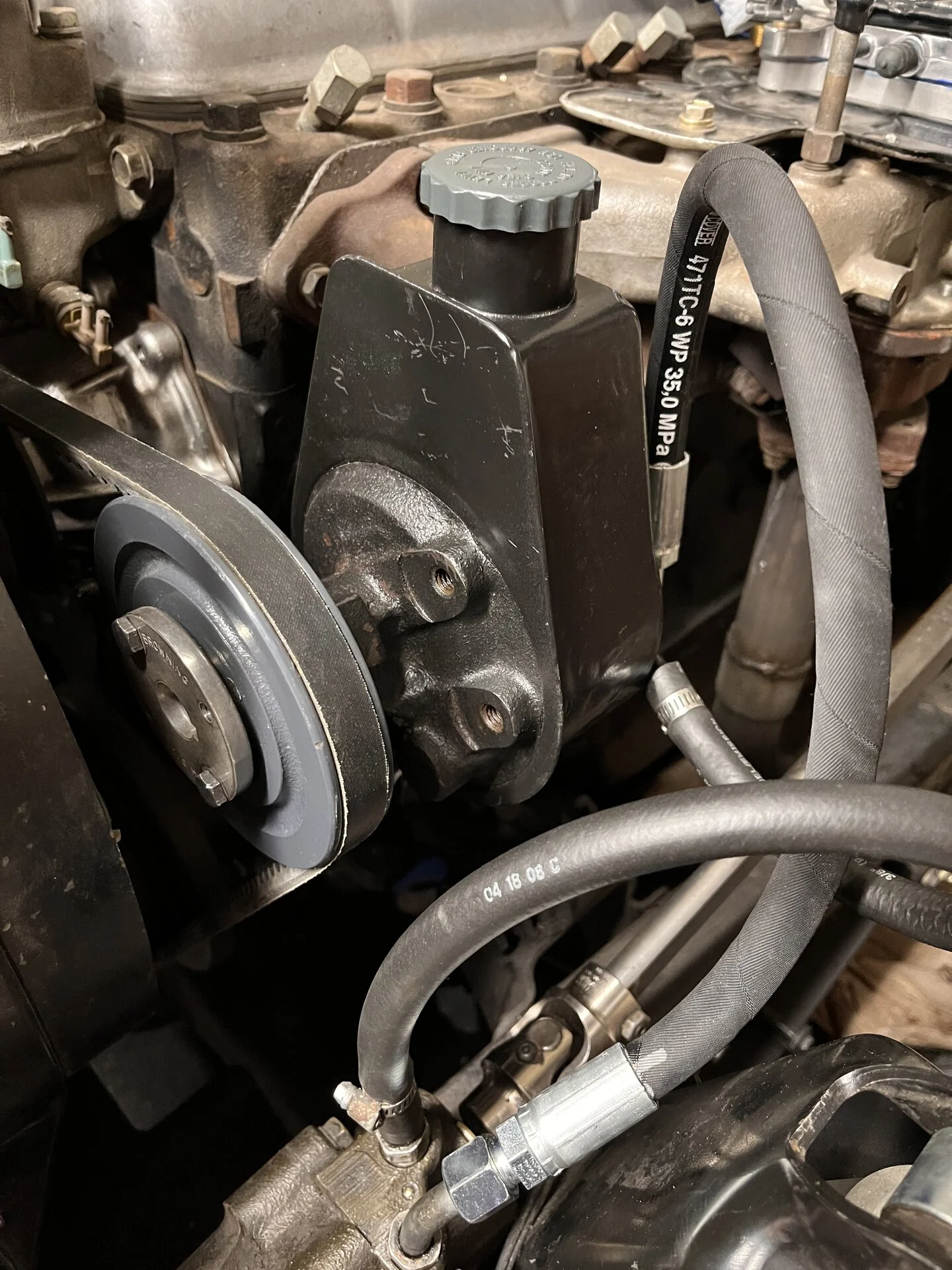

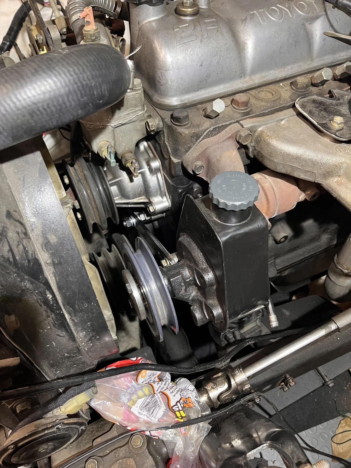

I swapped from the stock location on my 79 40 to saginaw pump and mount so i would not be on the same pulley as the alternator and I prefer the sag pumps. Also, I wanted both belts on the water pump in case one were to fail. I had been using an idler pulley in place of the smog pump before the swap. I did modify the mount i bought to be a little lower.
Wow, that is one clean looking 2F! Clearly there are more options for doing this with the Saginaw pump than with the Toyota pump. Maybe I need to be more open minded about not keeping the factory pump. The Sag installation does look nice and compact in the photos. Looks like you've done a steering conversion, that's on my list as well. Thanks for the excellent photos.

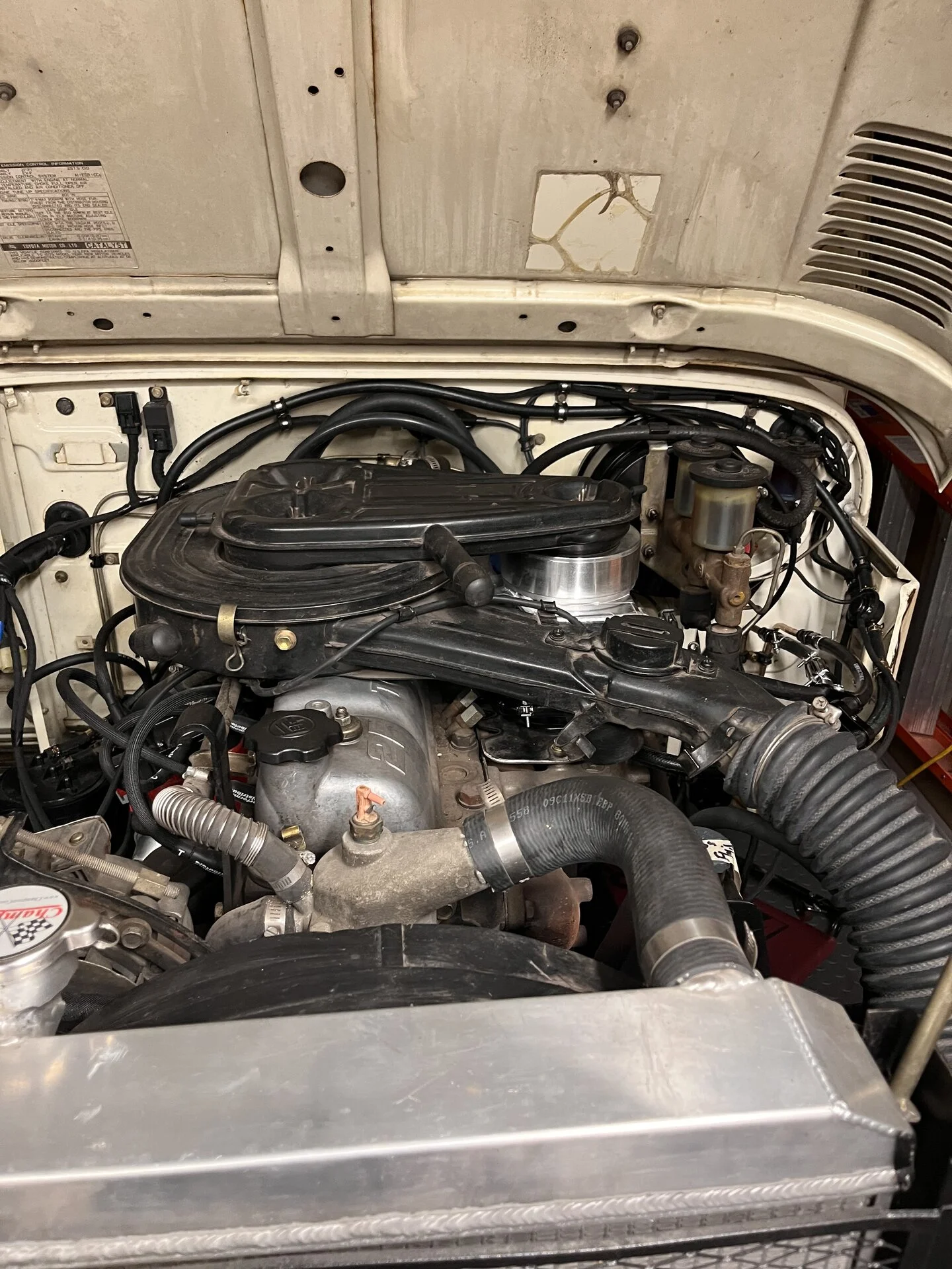

I see you have a Holley Sniper, how is that working out? Are you seeing improvements in drivability and mileage? Also noticed the cool looking adapter you made for the factory air cleaner. Nice.
Thanks for the compliments. I don’t have a lot of miles on the sniper yet but cold starts this winter have been really easy. I got the air cleaner adapter from @FJ60Cam really nice product. The steering is FJ60 and simplifies the linkages. The bracket for the saginaw pump came from @orangefj45 - I did modify the bracket though to make it mount lower and a little further away from the manifold.
