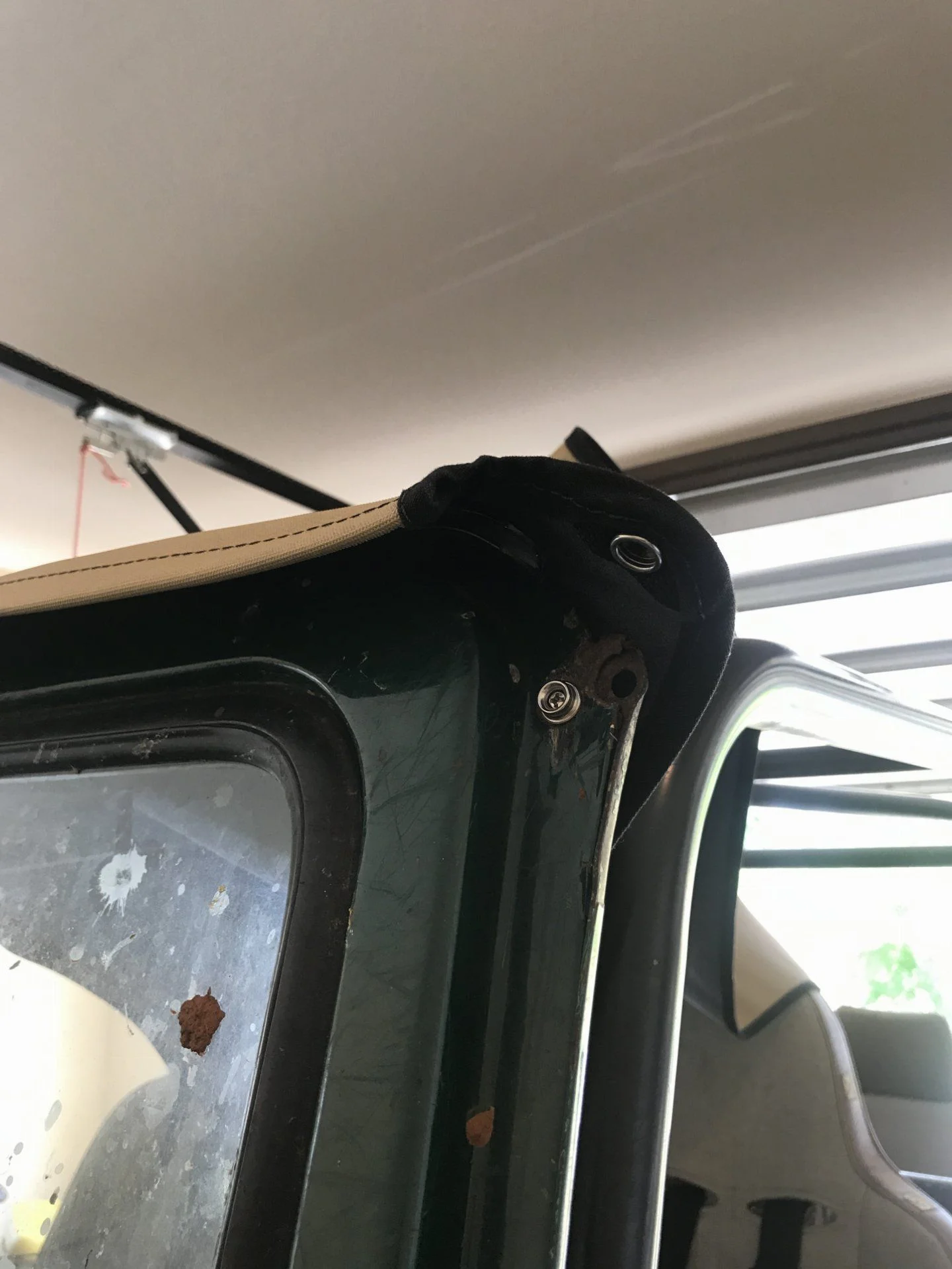

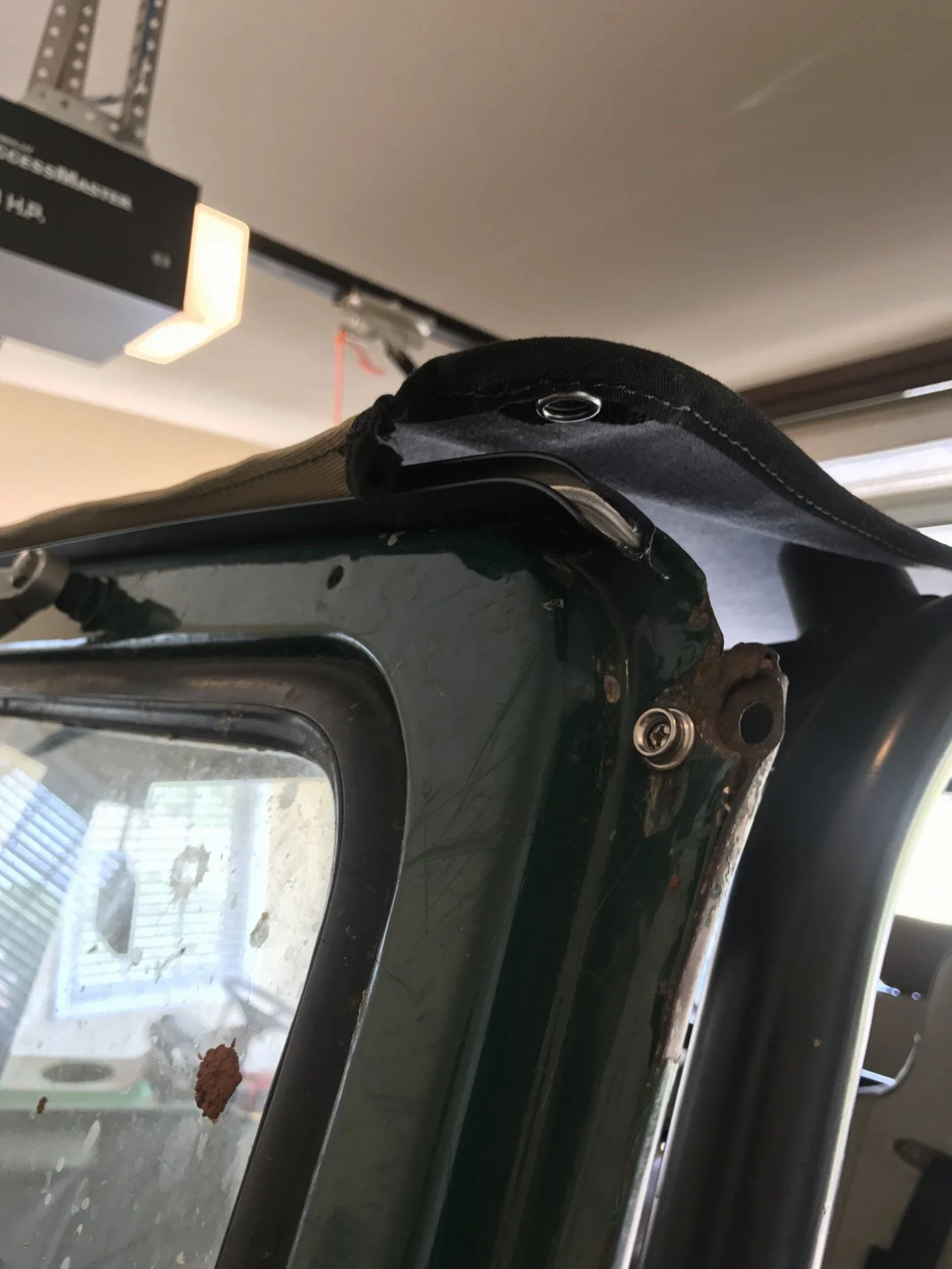

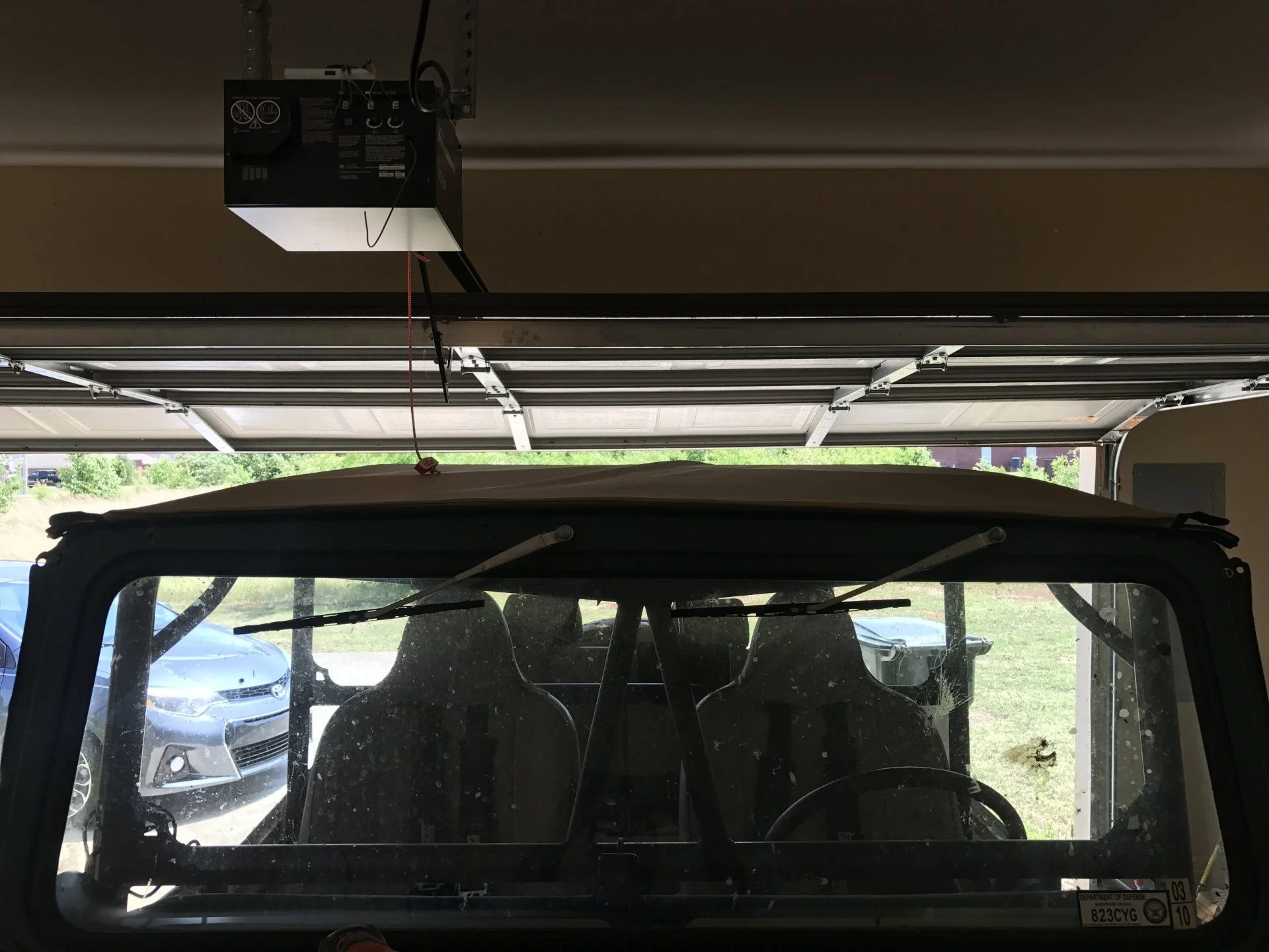

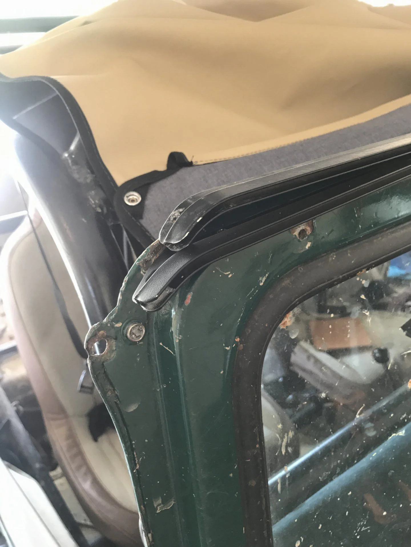

I bought a full length bikini top back in August of 2015 and I'm just now getting around to the install because my Cruiser has been out of commission for some time. I'm having issues with the install. I ordered the Besttop rail linked on page 1 and something doesn't seem right.
The first image shows the driver's side.
The second image shows how short the pass side is.
The third image shows my old kayline rail sitting on top of the besttop version.

You need to shorten the rail. We have it designed that way so it conforms to the windshield.
Okay I will see what I can come up with. The original rail I had installed from Kayline was shorter and fit my cruiser perfectly. The curved section on the ends of the rail fit nicely against my windshield. But I had issues installing your top with that rail which lead me to ordering the BestTop version. Now it sounds like I need to trim it down to be similar to my old rail. The issue with the Kayline rail was that the ends of the top were too thick to fit in the rail (because of the sewn seam).

Guys I talked with Julie this morning. She go confused on widths. I'm looking into what the right with is. The Bestop rail has to be cut down. I'll get a width that we can stick with from here on out.
The issues with the buttons is people are telling her conflicting widths. We will get this straight.
