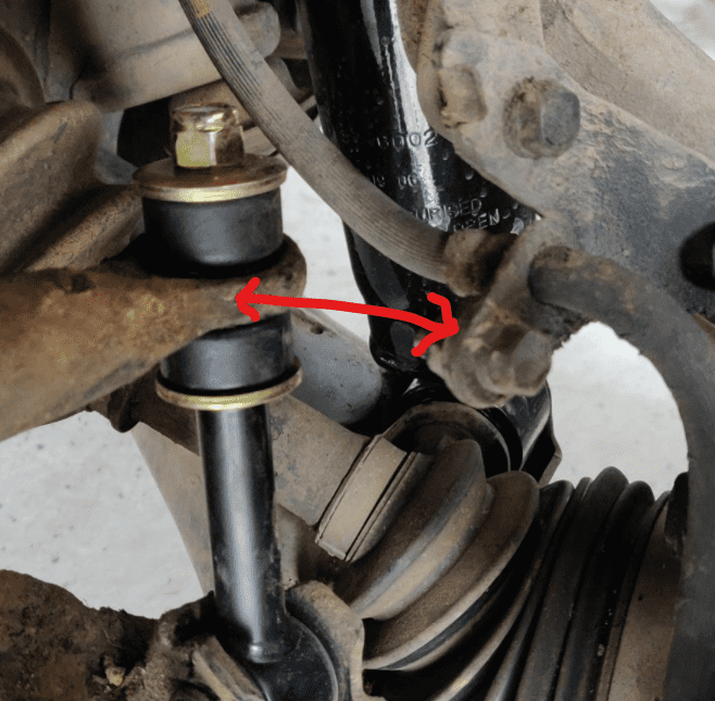

Incase you cannot picture it, the links hit here when steering.

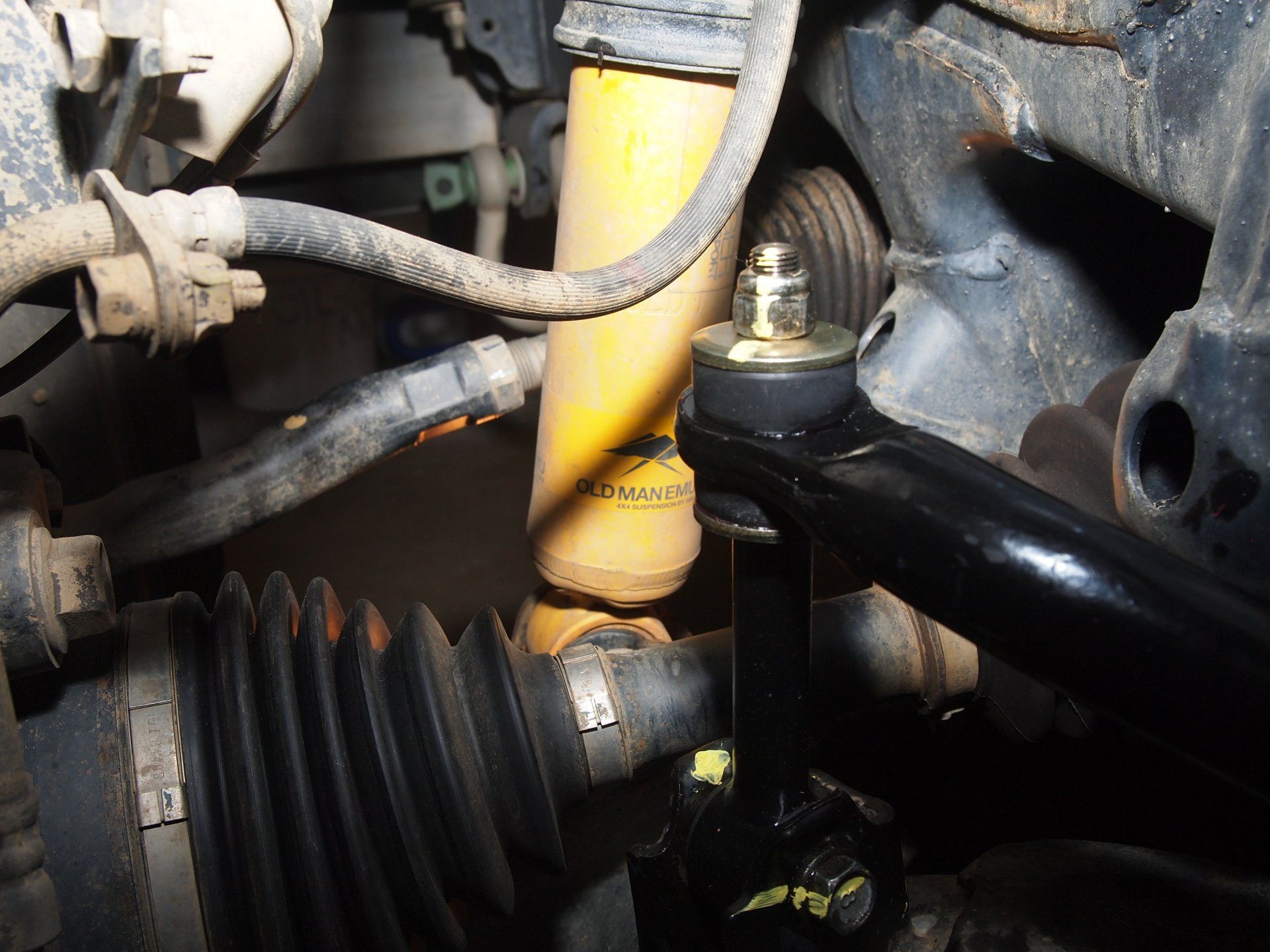

I see no interference with Extended Links and possible interference with flex brake line and or line bracket.
I install a set of TT extended links along with all new stabilizer bars and all bushing, this week. On a 07LX no/AHC, OME 2.5 lift, SPC UCA & adjustable UBJ, Slee belly pan and diff drop.
Inspected for interference:
While on jack stands and wheel hubs dropping free (no tires): Links did not interfere.
Wheels on rig on ground w/full weight: No interference.
This was with wheel straight and full turn to locks.
I do not see, brake flex line at risk of contact with links. For them to even touch, they need to be forced to do so. Even if they do, I can't see risk damage to the lines.
Link, more than 3" away to rear of brake line & bracket at all times.
Full turn, more than 3" away
Full turn, more than 3" away.

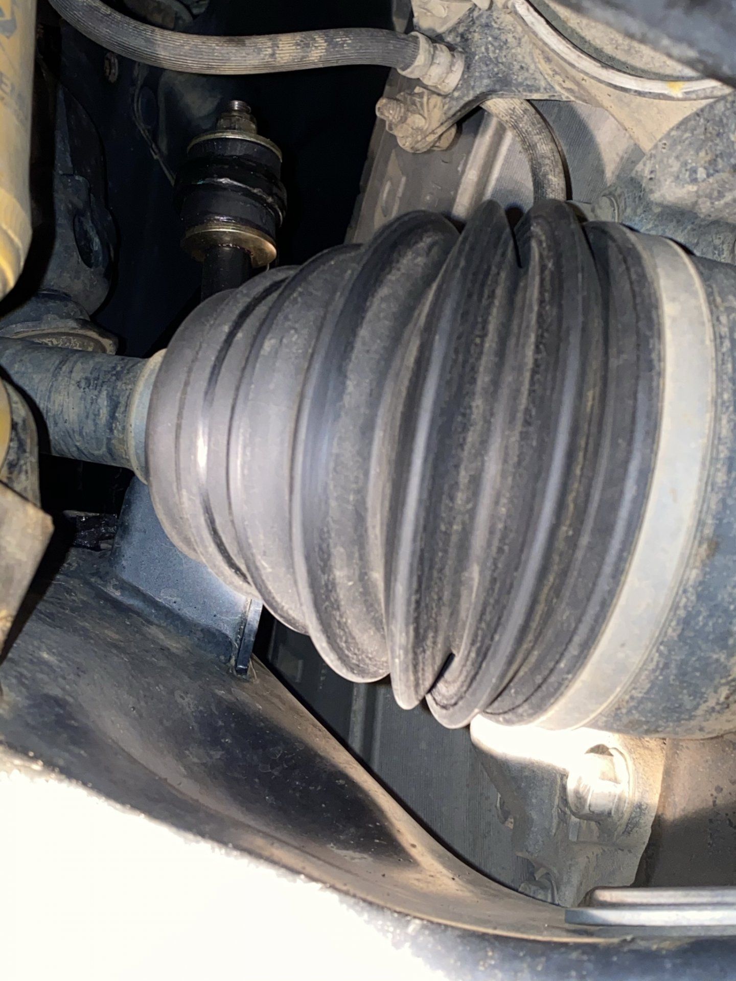

Some more photos and details of the interference I am having, all stock arms, EFS XTR shocks and on the weekend I fitted different bump stops. In the photos where you see it hitting, I am still not at full steering lock, at ride height no problem, but droop is a problem. I have already trimmed the bolt and bent the brackets for additional clearance, but still hits.
Wow that is extreme drop. You may be better off with stock links. Then disconnect them on the trials.
I've never seen the AHC bracket make contact with frame.
For all that to make contact your wheel would have to be at full droop- wheel in the air and turned close to lock right? I think the problem is that you have stock control arms with lift and extended travel shocks, and when at full droop the knuckle is at a rearward angle then you get the contact with the bracket. With an aftermarket UCA, it would correct that clearance (and your caster) and I doubt you would see contact. In the absence of spending more $$ on aftermarket UCA's maybe go back to standard length sway links.
