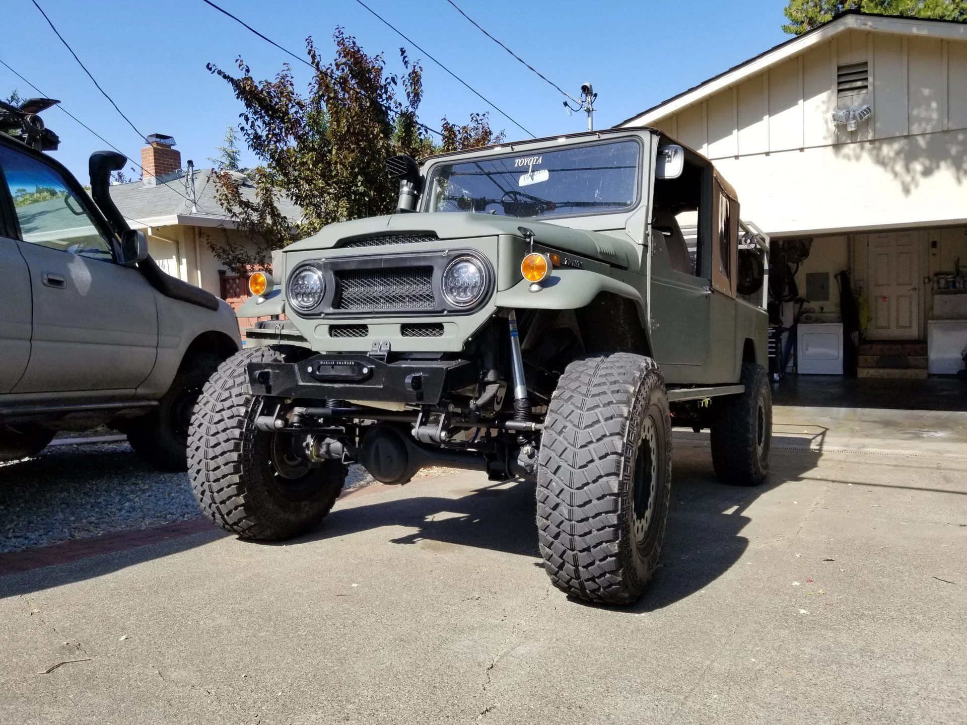

It's alive, again.

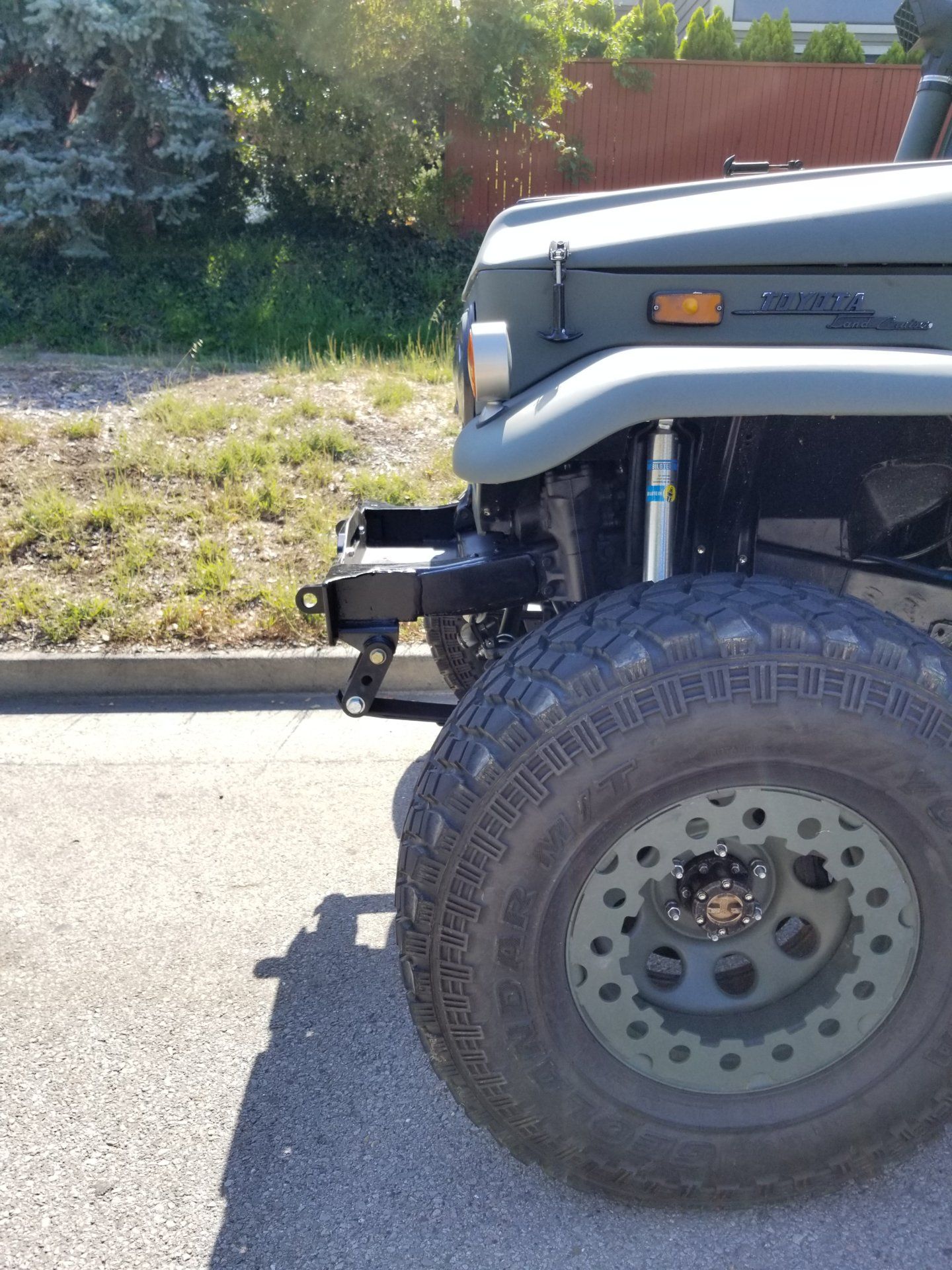

Axle looks like a 1 ton it's so wide. 60 housing, IFS hubs and outboard rotors and wheels with 3.5" back space. I have a set of KMC wheels with 5.75" back space and I will probably swap to those to loose some width!

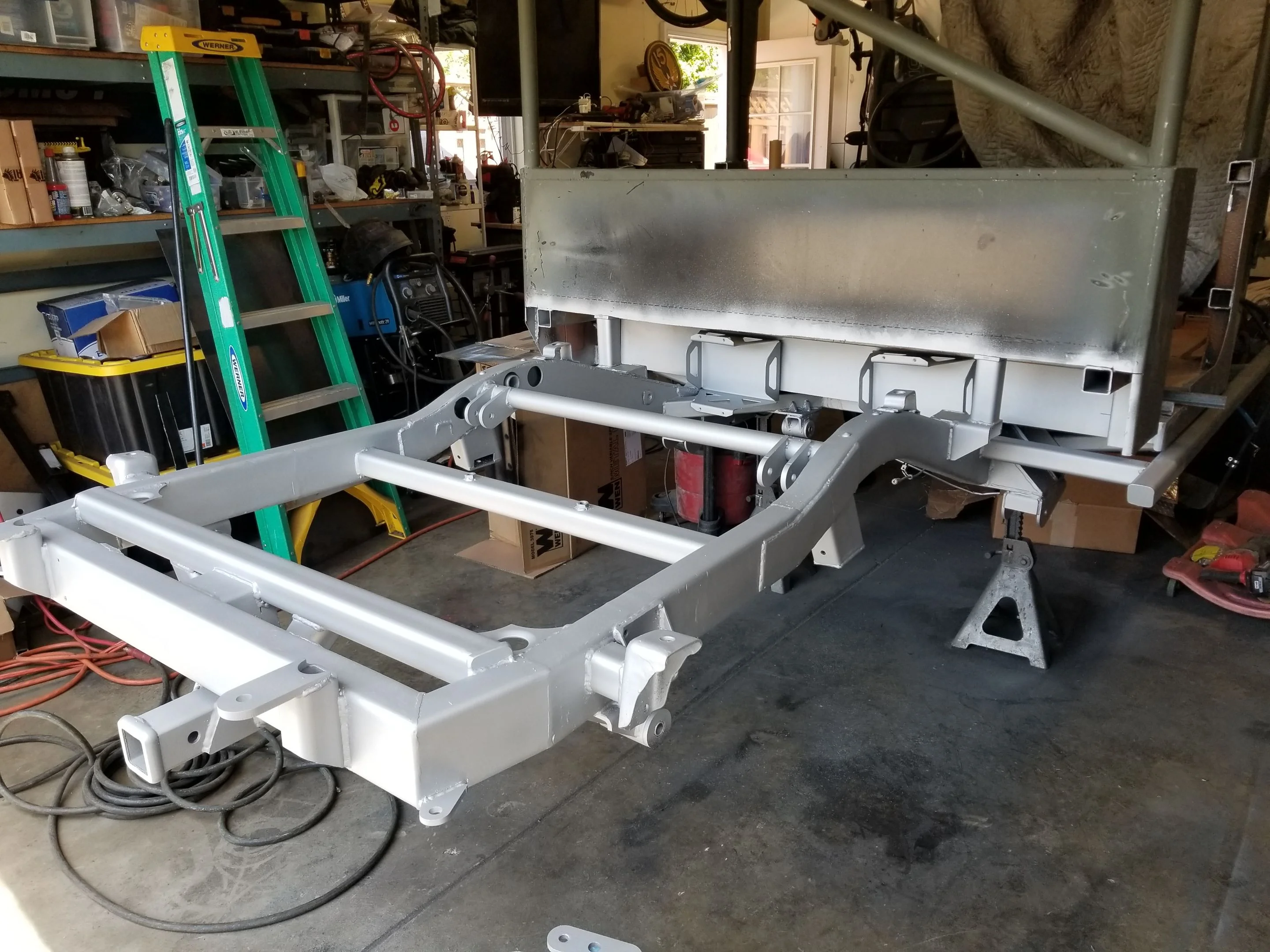

After some half hearted attempts to sell Frank I have decided to cut it up instead. So I can make it a 4-door with a shorter bed. I'm waiting on a set of Aqualu half doors for the rear and I've already pulled the bed off, stretched the rear frame, fixed the crappy frame plates, moved the wheelbase back 3" and swapped in an FZJ80 rear axle.

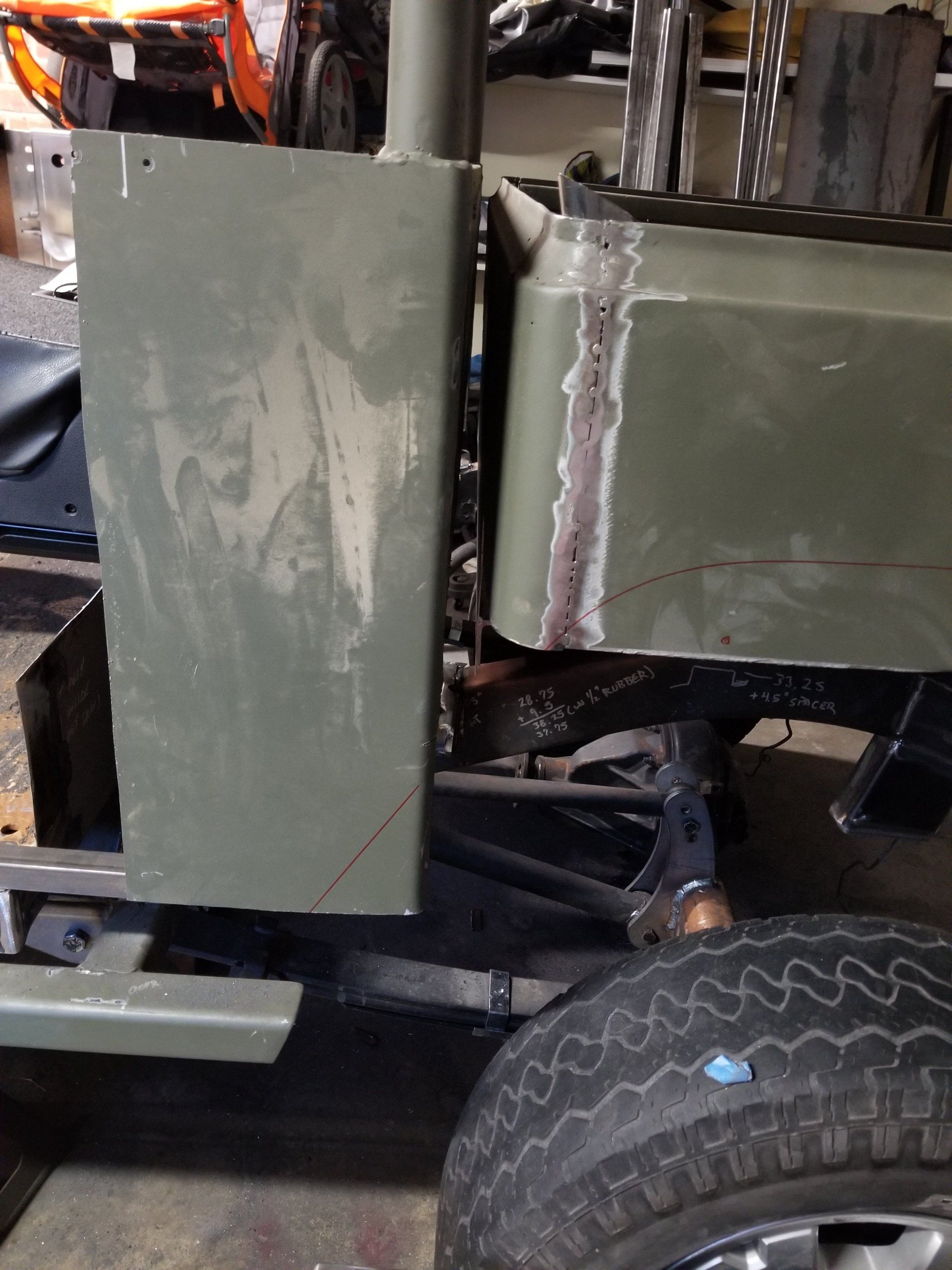

Cab will get stretched 12" to accommodate 29" long rear doors. The frame got extended 7" so I'll end up talking 5" out of the front of the bed and open up the wheel wells a bit for the 37s.

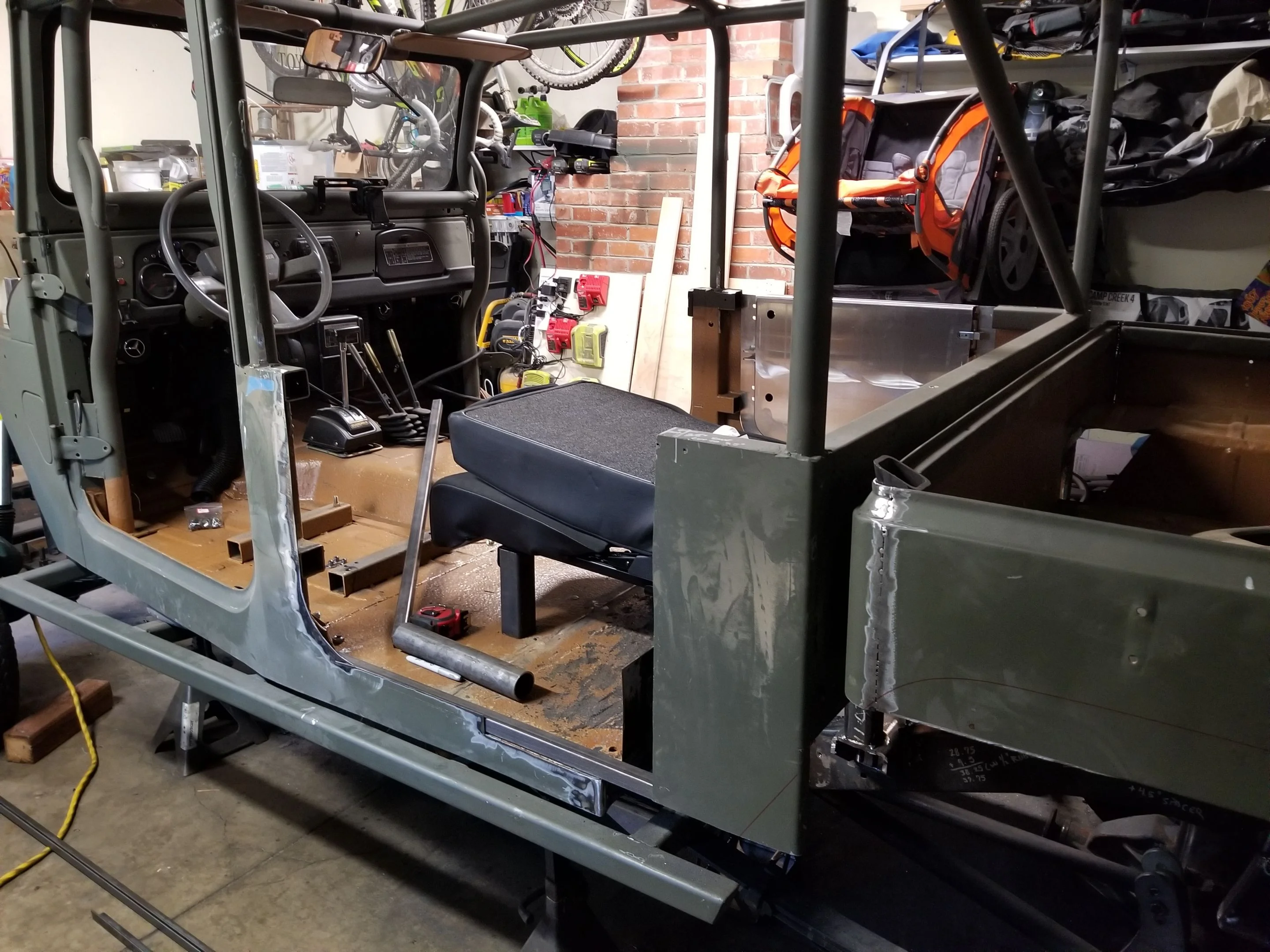

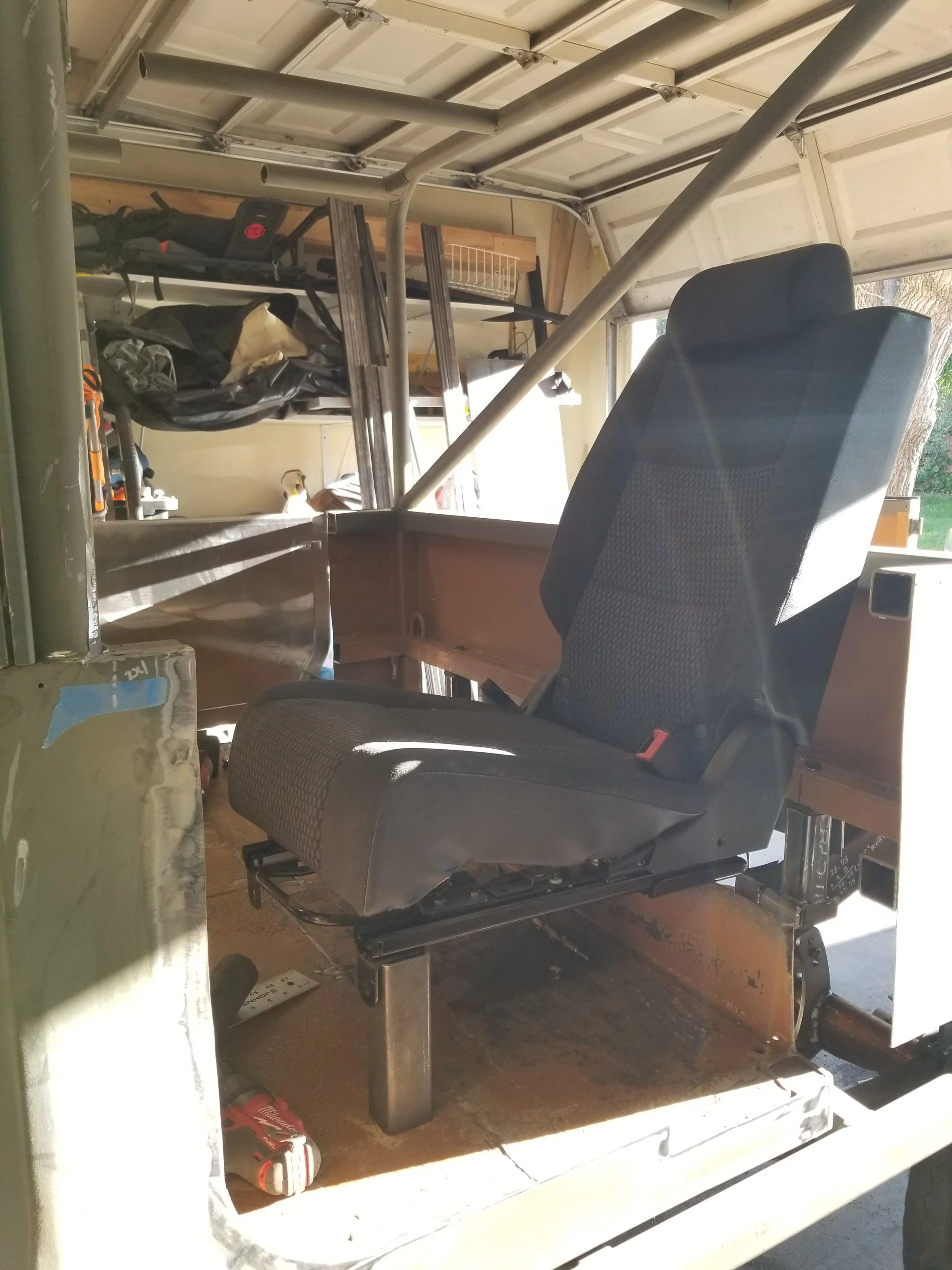

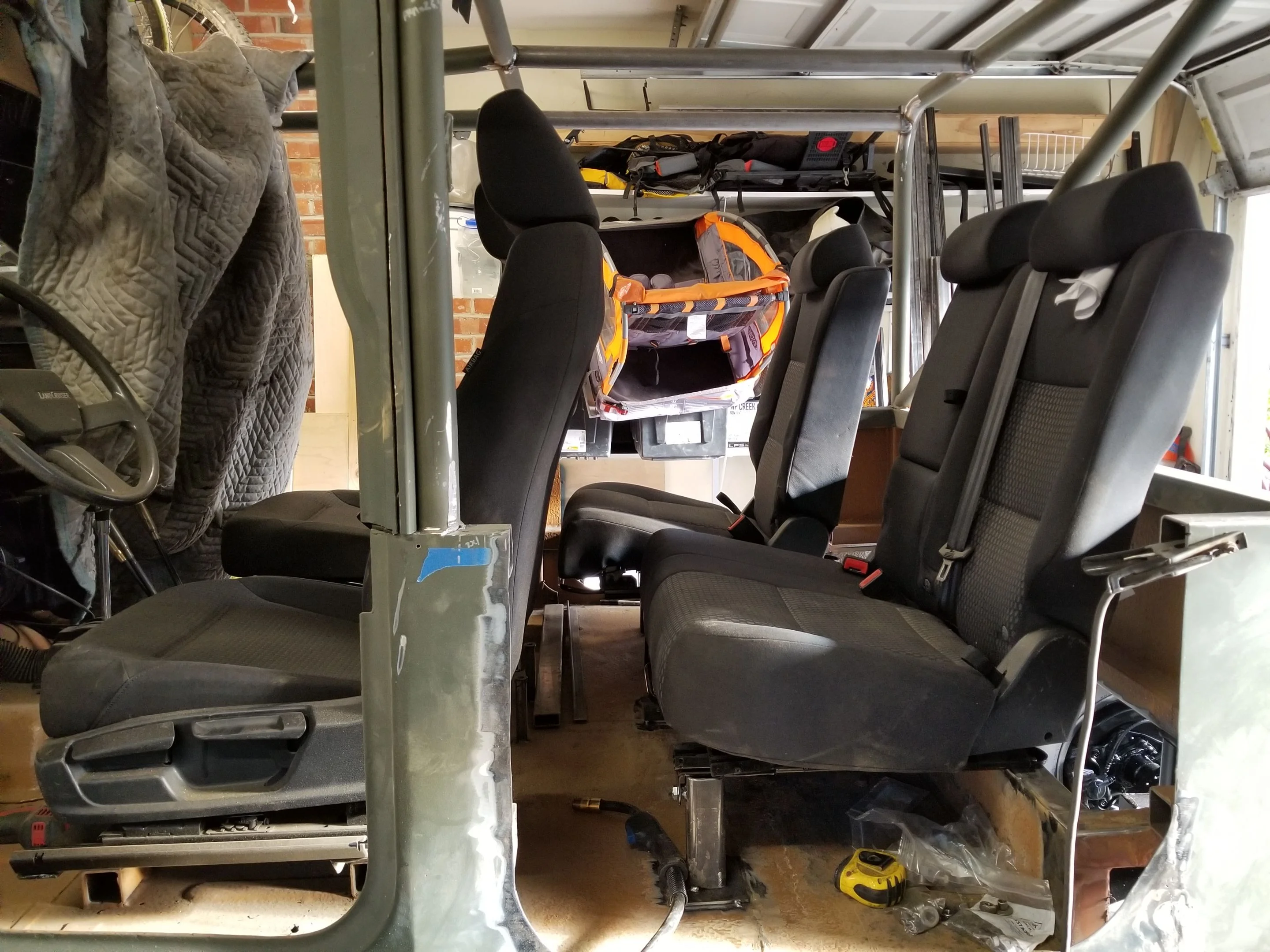

I got a set of rear seats from a VW Tiguan. They are pretty compact, fold flat and have sliding rails. Should work good for holding kid seats. I already have VW front seats because they are comfortable and height adjust.

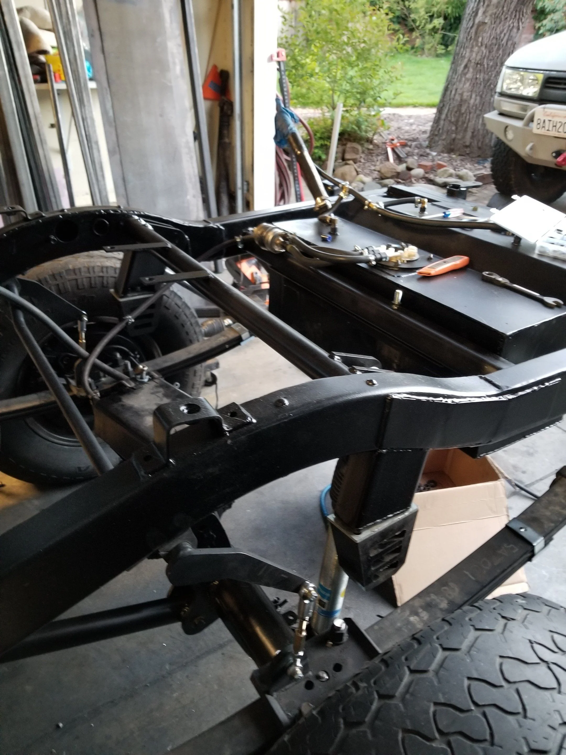

I'll do a few improvements along the way. Going to go to hard fuel and EVAP lines with -6 adapters to soft lines at the tank. I built a weld together fuel tank and put in a VetteWorks plate to mount a GM truck in tank pump module. The Jeep TJ pump worked fine but I could never get the fuel sender to work.

Was 126, should end up at 129 now. I put an add a leaf in the rear pack and pulled the overload leaf. I'm hoping it stiffens up the rear a bit since it's softer than the front. I'm going to spend some time and get my anti-sway bar on now that it have the bed off and room to work!

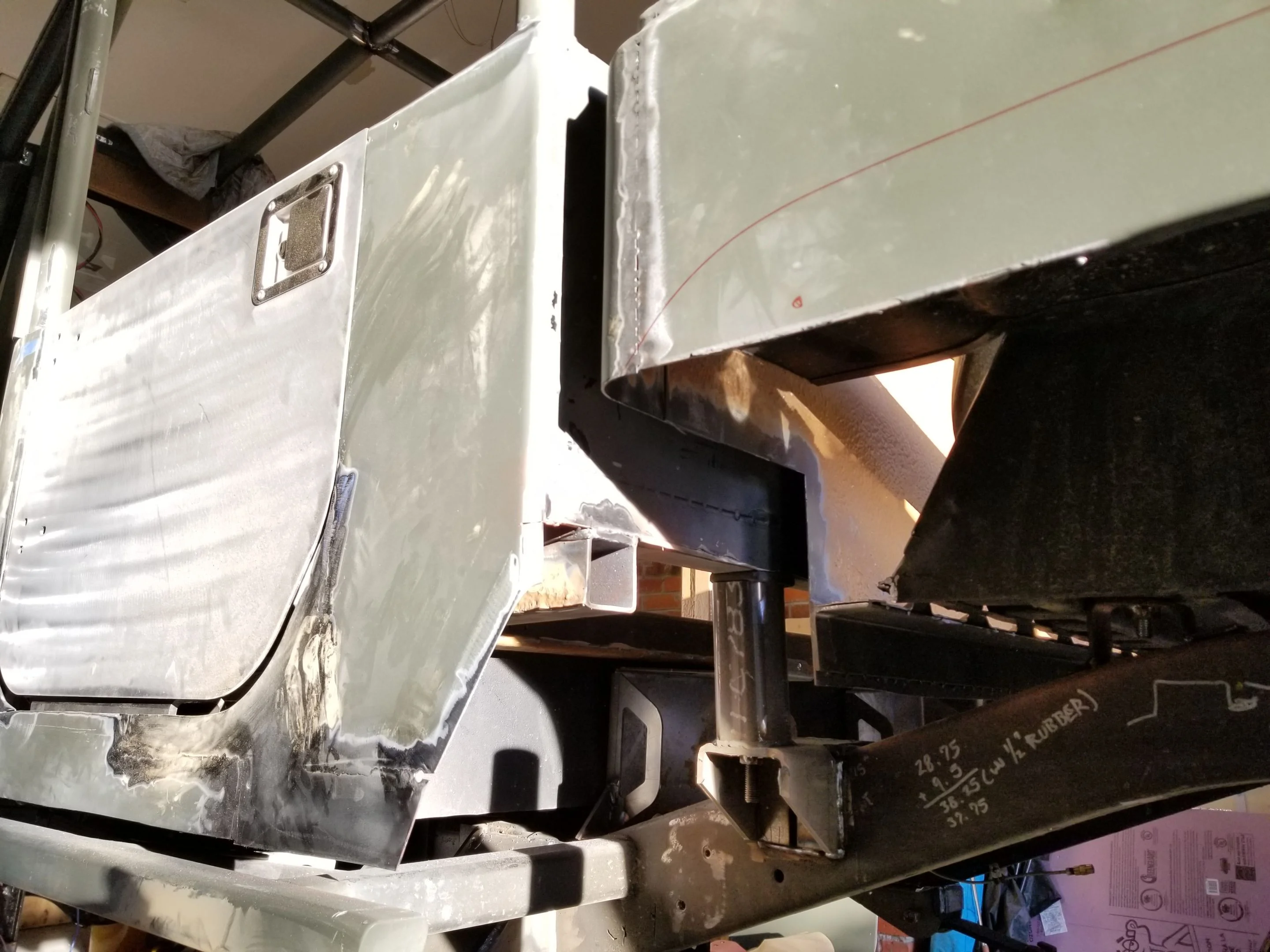

Got the back of the cab cut off and set on the new rear mounts. I need to clean up the mounts a bit but I think it will work.

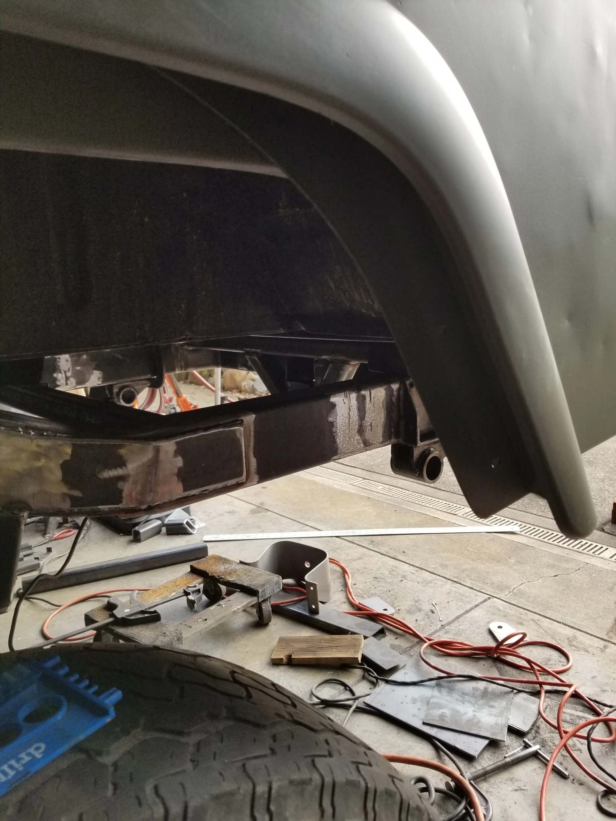

Then I cut the front off the bed. I'll end up cutting 5" out of the front section of the bed and removing the lower corners. It will make a large wheel well !!
I'm going to flirt with being legal and put TJ flares on the bed. I have to cut them up a bunch but should look good in the end. They will start at the cab corner, have a gap, then continue over the rear wheel well opening.

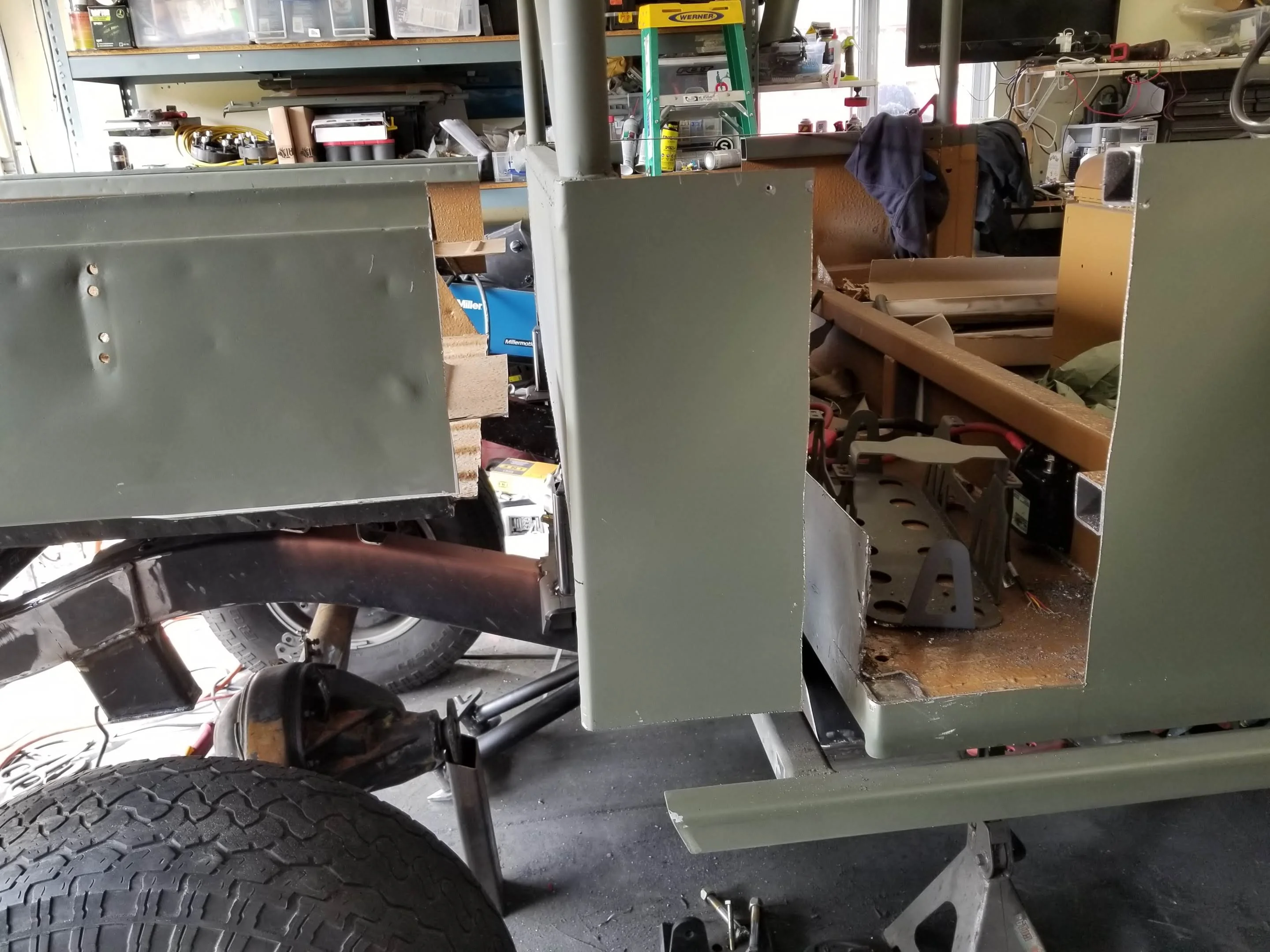

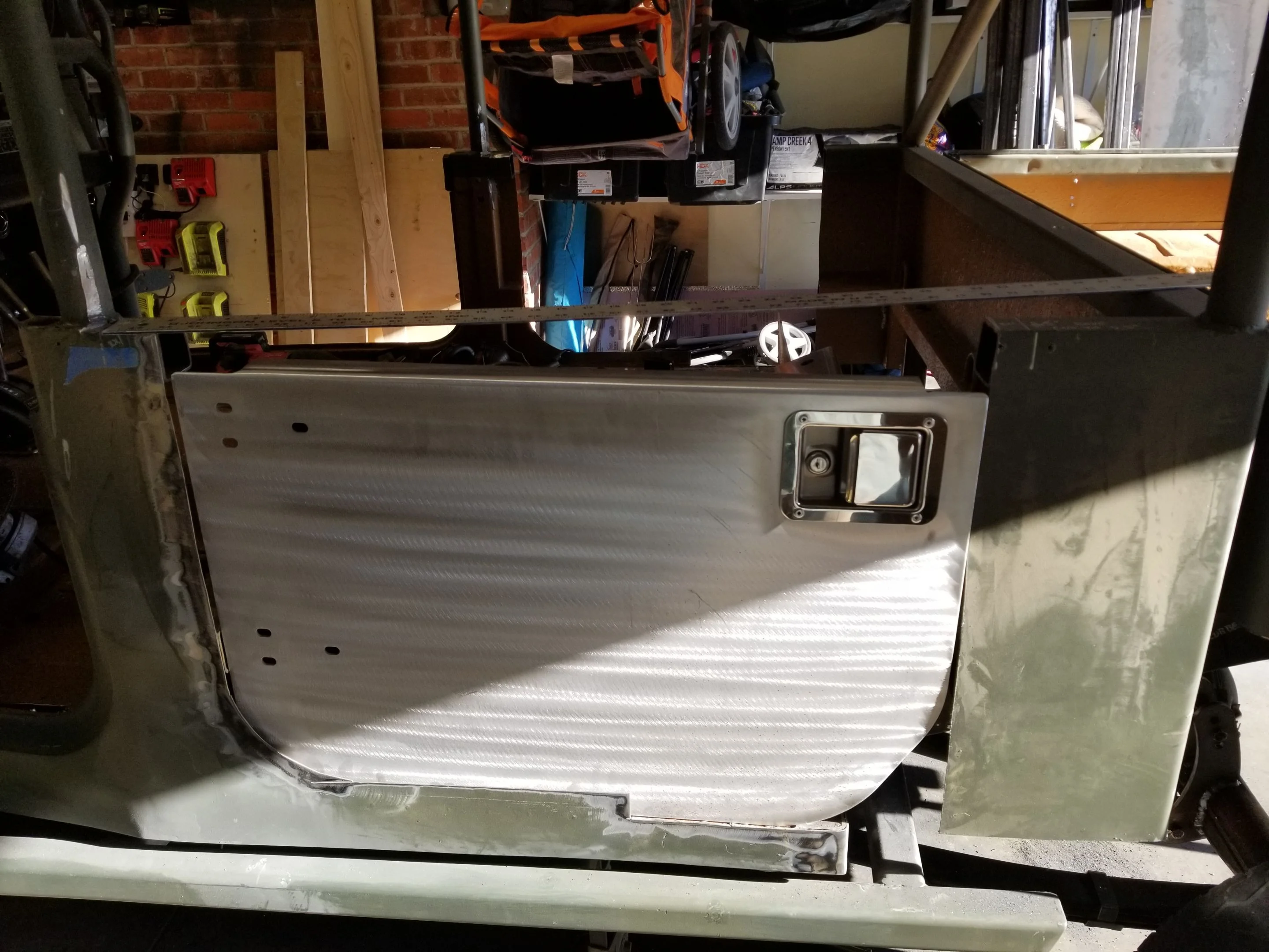

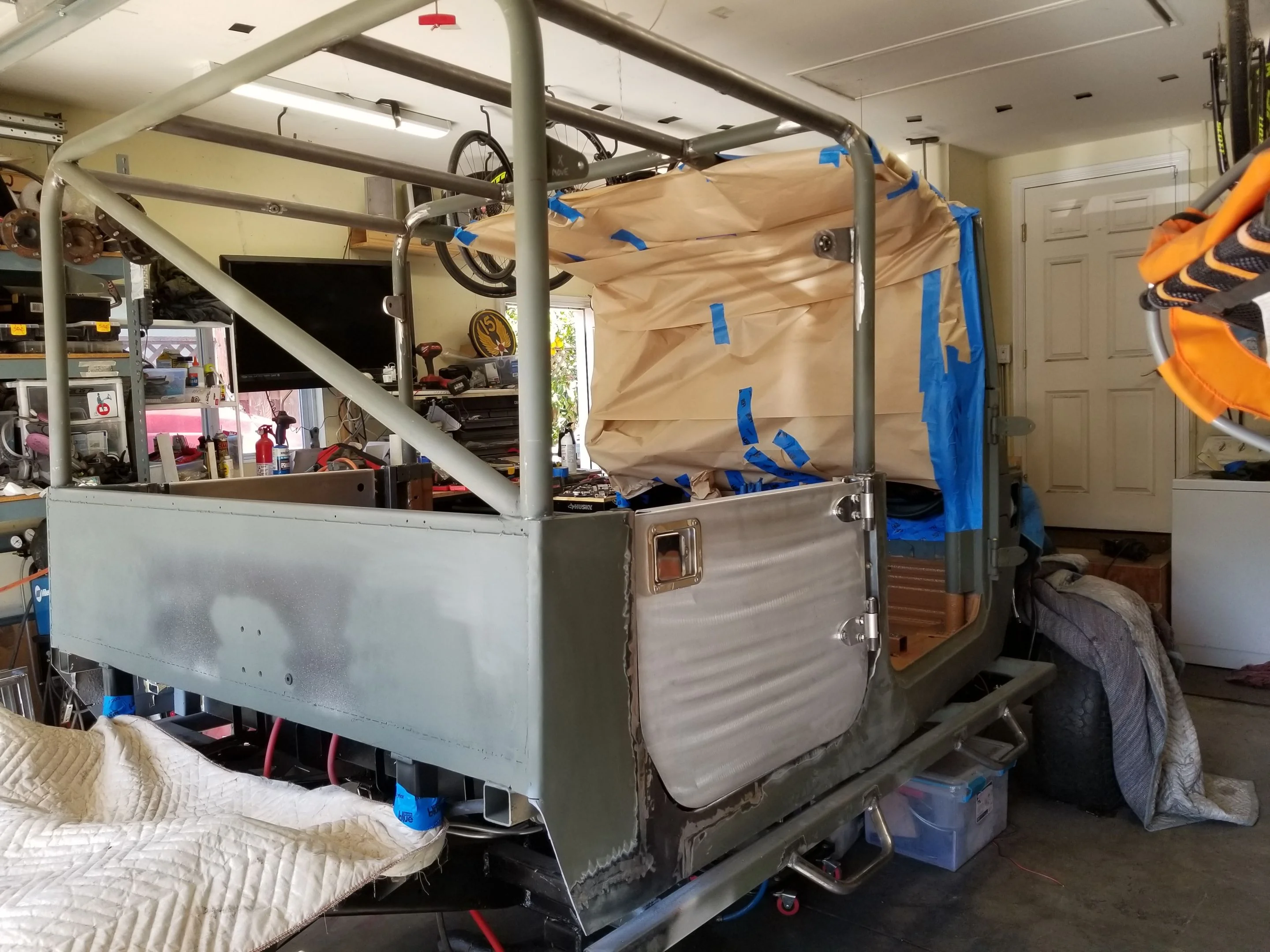

Made some progress on the rear cab. Finally got the correct doors from Aqualu but they forgot the hinge plates so I can't finalize the door frames yet. I plan to do the cage today and skin the cut up areas of the cab stretch.
I think the Tiguan seats are going to work great, they sit a little high but the little people will probably appreciate that.

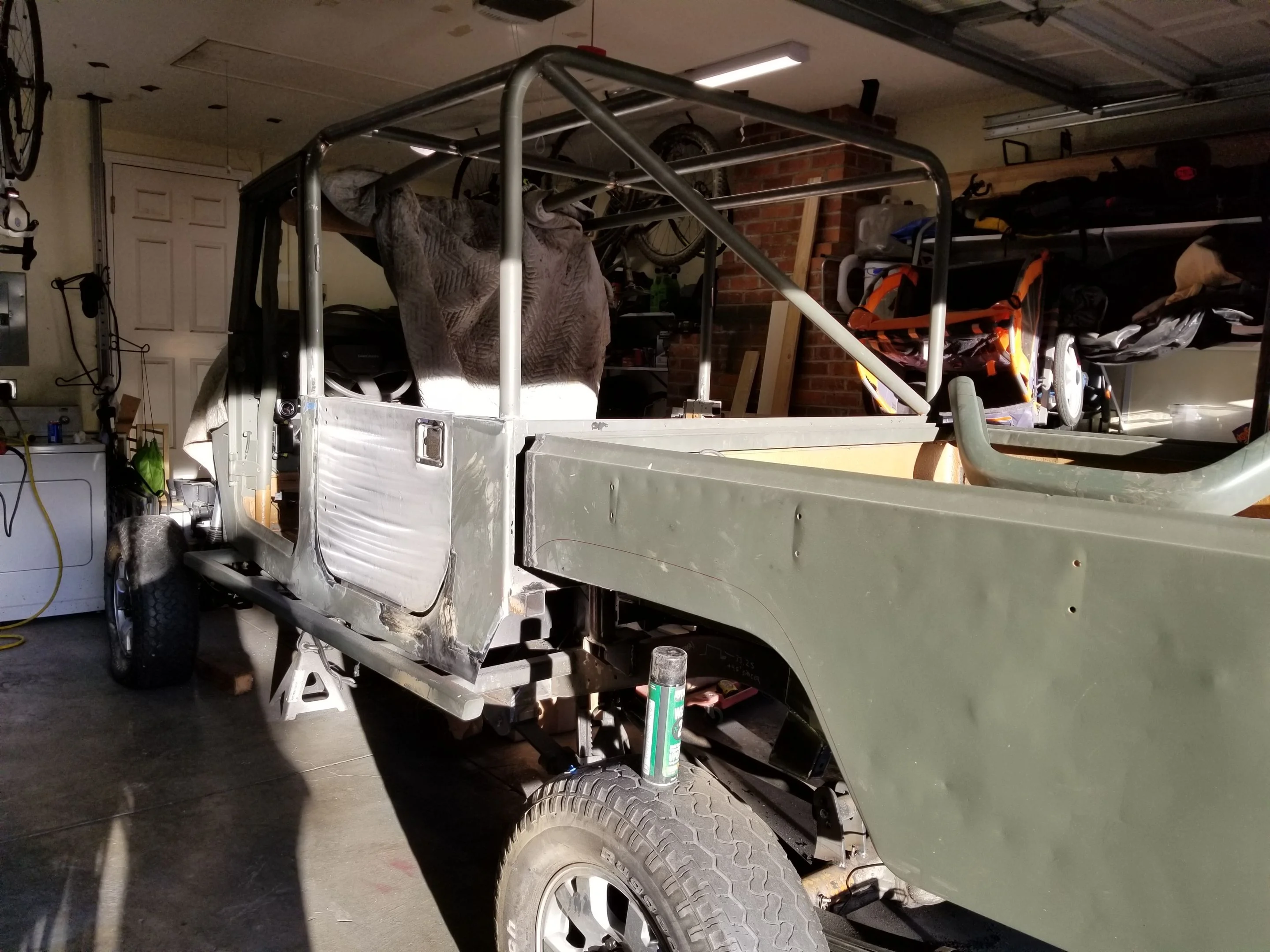

Cage done and the internal 2" tubes are in to make the cab structure. One side outer skin is done. I'm considering making hinge plates instead of waiting for Aqualu to ship them. I have to have that to finalize where the door will sit and to build the frame around them.
Door frame/sill will be a combination of 1" L angle and 1" square tube. This gives me a nice areas to seal the doors against. I still need to decide if I'm going to completely cover up the B-pillar or make slits to slide in soft top fabric.
Today is finish welding in small stuff in the cab and pull the bed to paint the frame and axle.

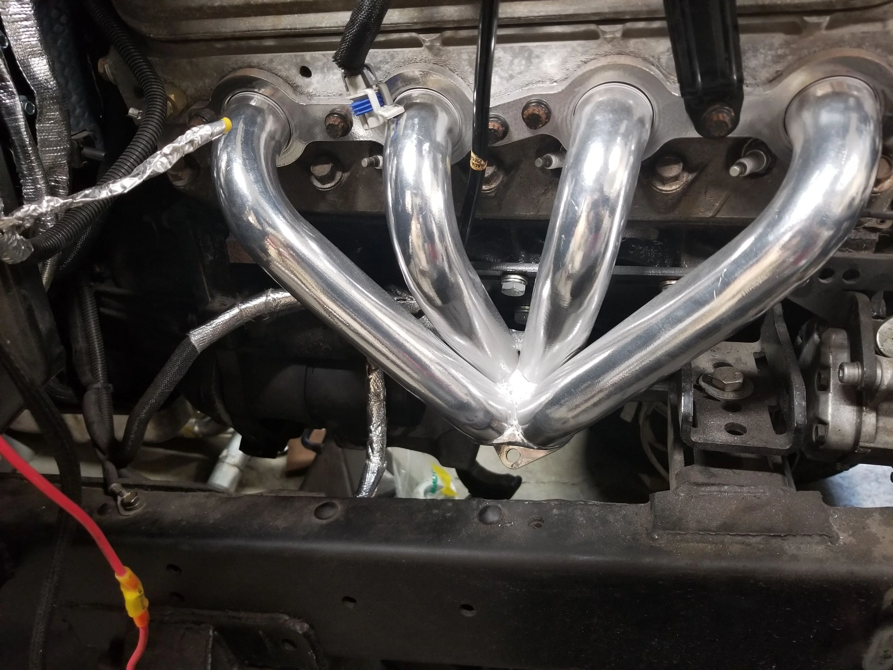

Worked on exhaust and cooling yesterday. The Vette manifolds I was using were leaking at the block, even with stock GM gaskets and I wasn't happy with where they put the collectors. I went with a set of block hugger headers from Speedway, and even with ceramic coating they were very reasonable. They are tight to the block!
I was able to make a very tidy crossover and y-pipe now with a small bullet cat and 3" pipe.

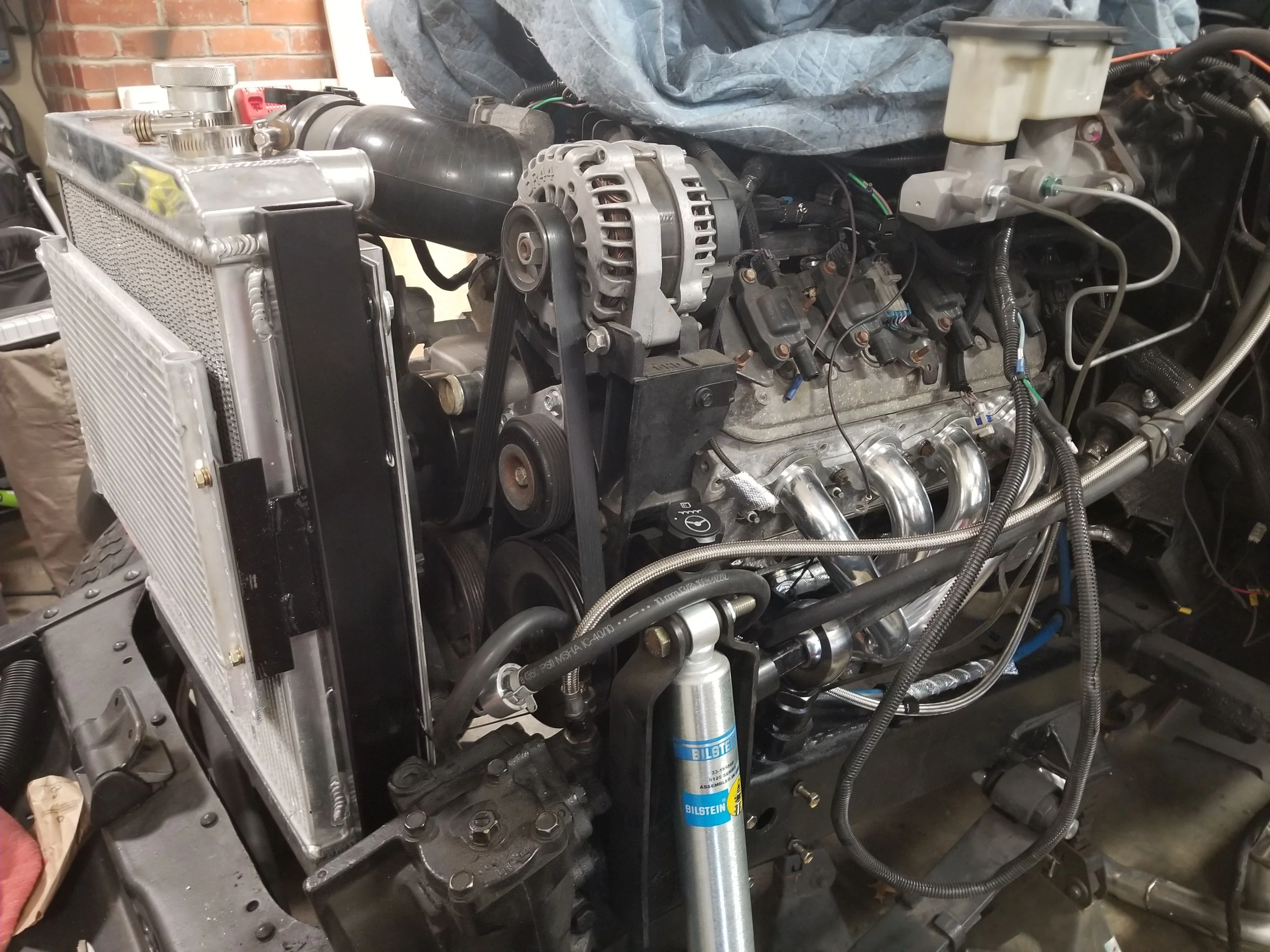

Radiator and condenser are back in and finishing working front to back modifying everything that changed when I shifted the motor back 2".

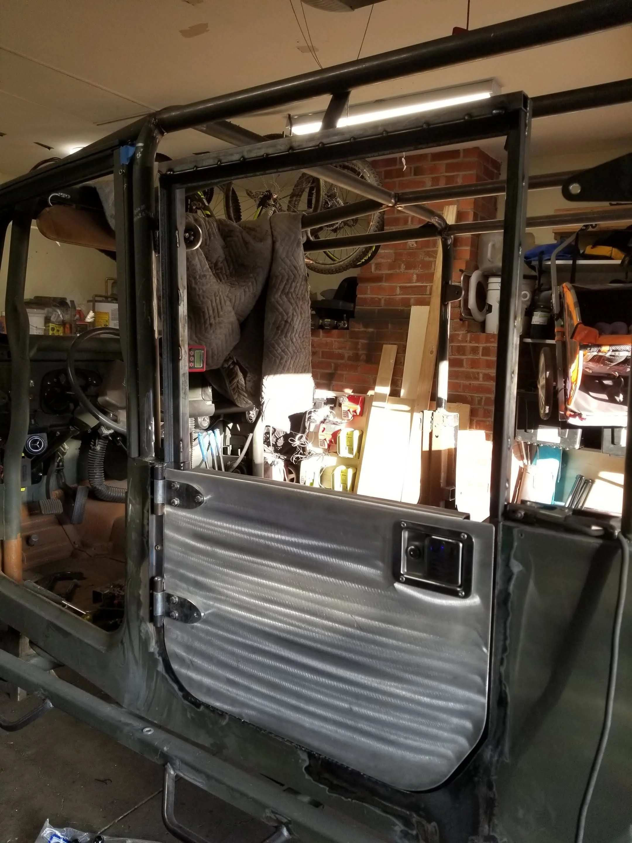

One side done, except for the 3/4" square tube slotted for the soft top to slide in. The upper door frame is removable with three bolts, but strong enough I can do a pull up on it.

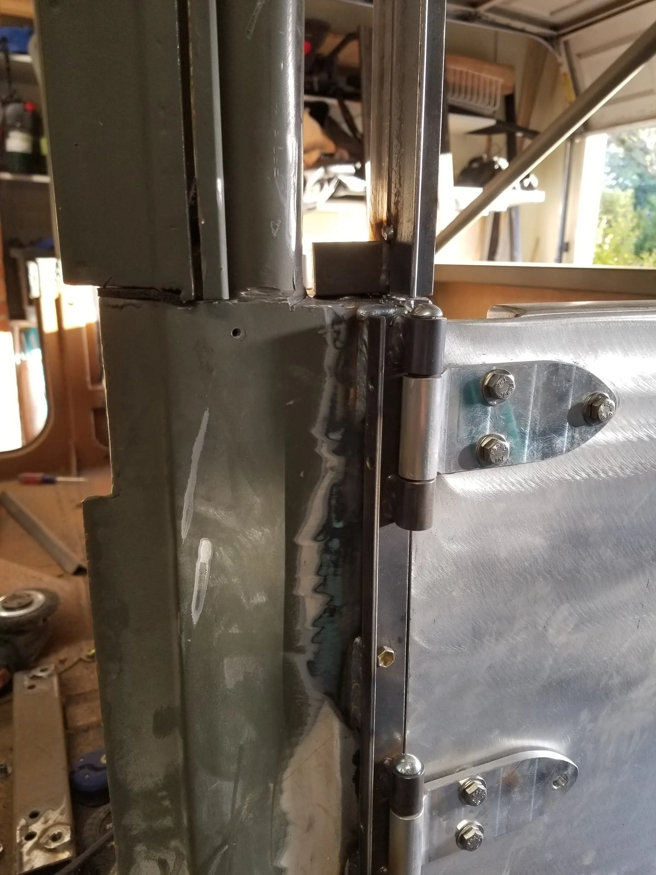

I ended up welding the hinge hanger to the outside and also to the inside sill, I'm sure this will be strong enough considering how light the doors are. It kind of looks like the front hinges where there is a piece of steel to shield them.

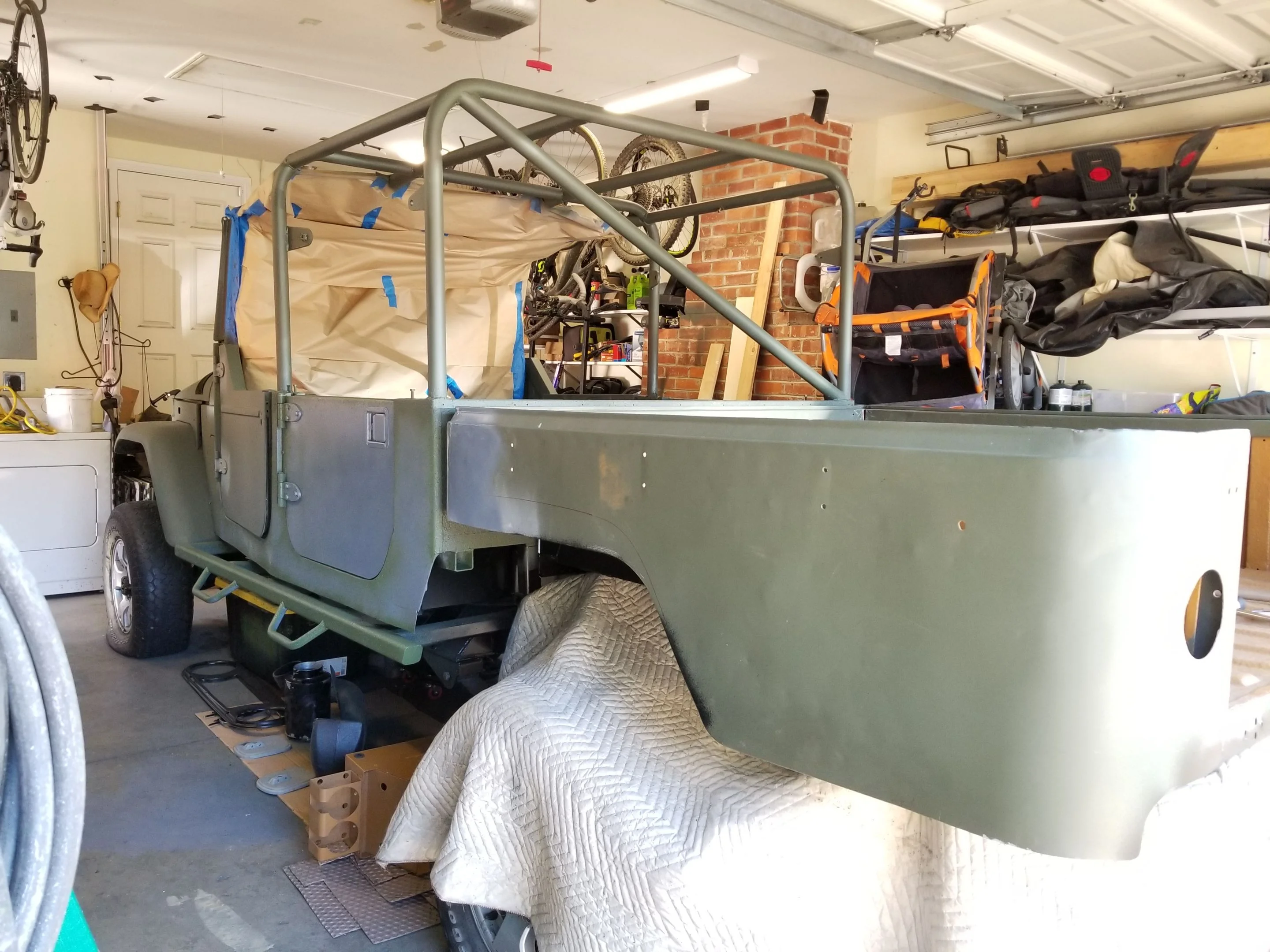

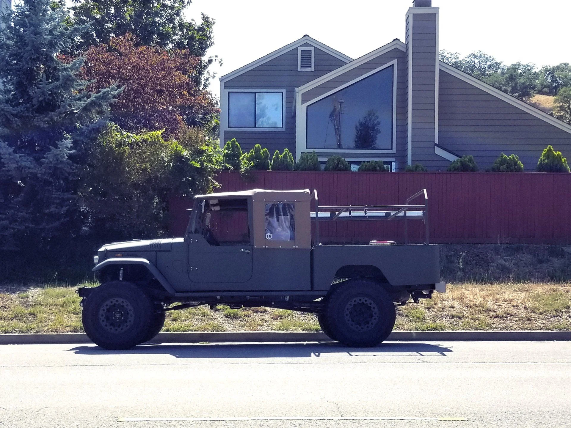

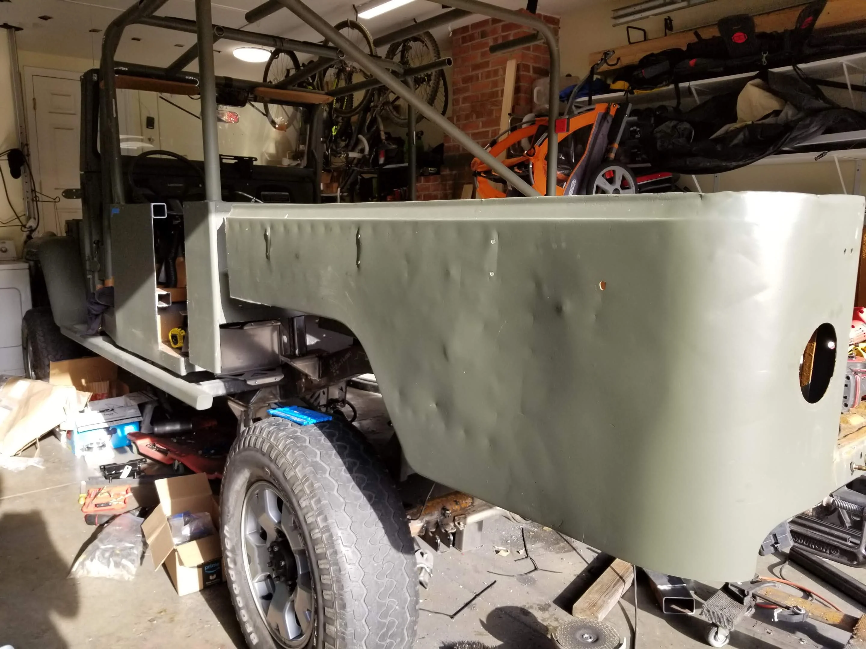

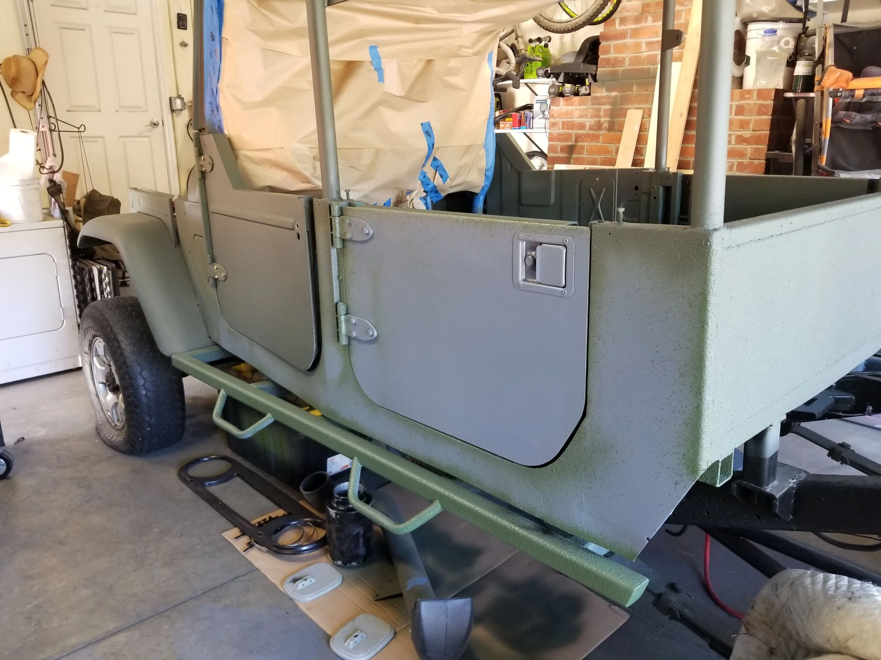

@bugsnbikes came over today and we set the bed on. It's very long, so until I can roll it out I can't take a proper side shot.

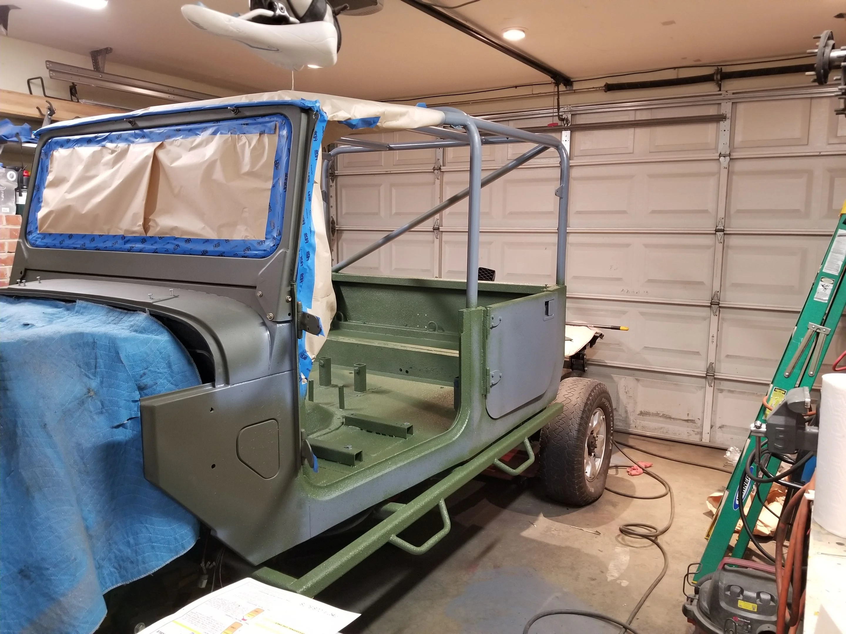

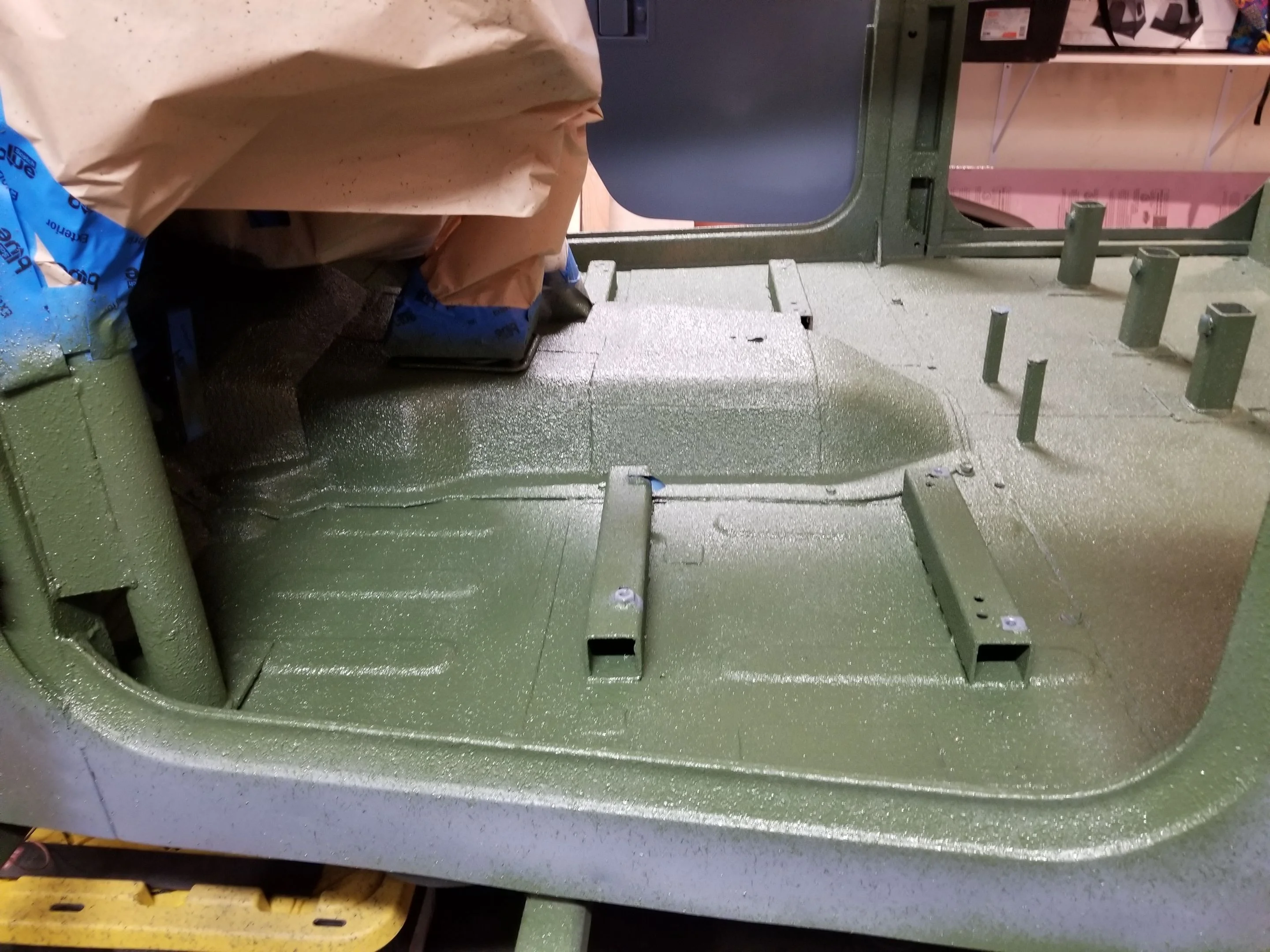

I ended up spraying the original color over the Raptor liner...they are both urethane so maybe it will work. The Raptor color green was too light so I ordered their darker shade of Olive to try. Should get the rest of the exterior and bed done on Wednesday.
