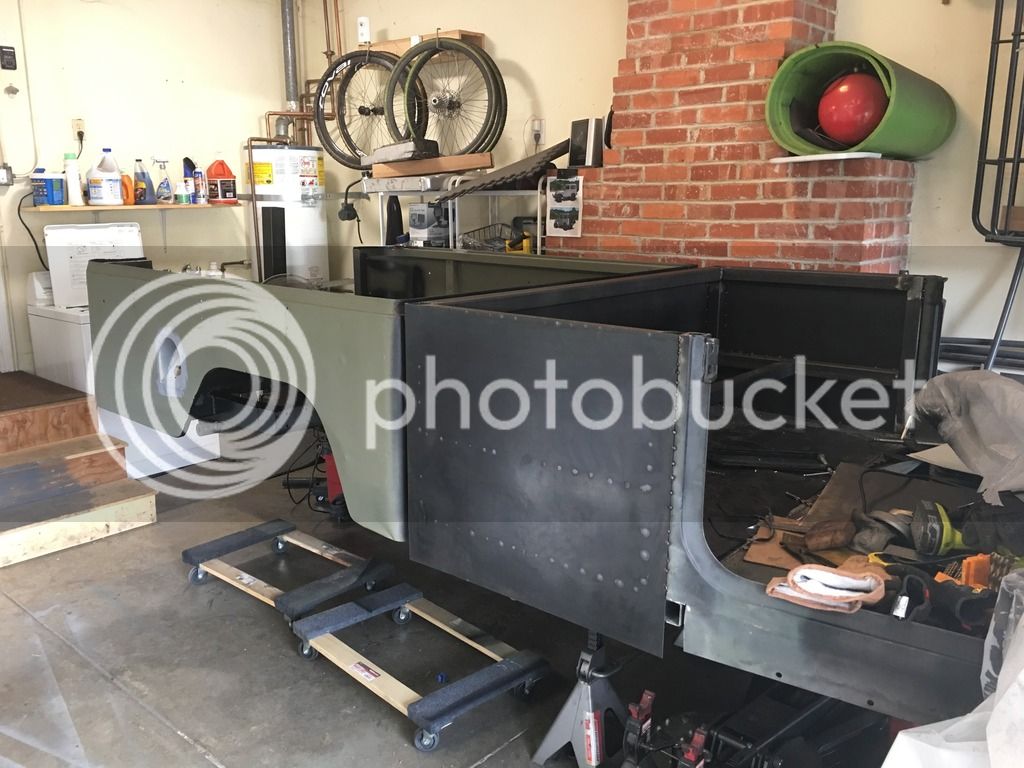

The front of the SWB was really rusted. It looked like there had been a channel there at the very front that had either rusted or been cut away. So I got the bed sand blasted and I cut out the front wall. Welded in a 2x2 channel at the front and that let me straighten up the wavy floor.
The rear corners were both crunched so I cut them out and welded in 40 rear corners and then cut them down and cut in the curved profile.
New 16ga front wall of the bed, I might go back in later and make it curved, but I don't think you will see it.
I am running a J**P TJ gas tank so I needed to move the fuel inlet. I cut this out the profile with the plasma cutter, smoothed it, then welded it in and smoothed it again. Turned out pretty neat.
Corner profiles
It was supposed to pour here so I sprayed it with primer in case it started to flash rust in the garage...but I used etch primer and now I have to shoot something else over the bed before I can do any bondo. I do like the Frankenstein look though and that's kind of the theme of this truck....it's a compilation.
The extension is all skinned, but I'm still working on a full width bench that needs skinned.
This is about caught up to where I am now. I really need to make a bracket to attach the 3 shifters for the transfer cases and then I can work on the tunnel. I had to cut the tunnel in half with the longer drivetrain and it will probably get a 14" stretch with some extra width on the passenger side to cover the transfer case shifter pivots. It's supposed to pour again this weekend so I might shoot some more paint on the bed tomorrow while it's still nice...maybe the axles too so I can get them back under the truck and set it on the 315's.
