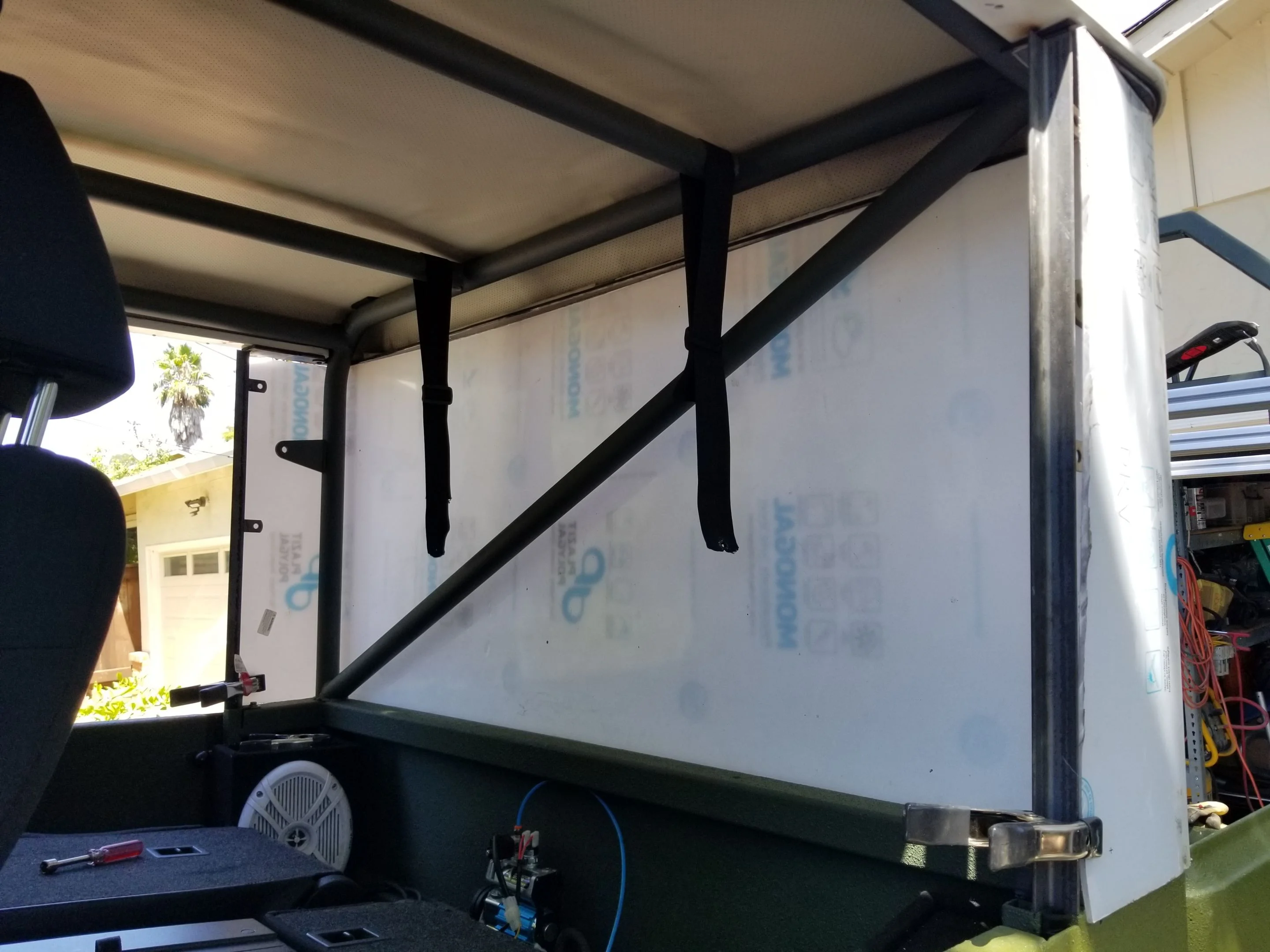

Finally had a day off and no kids around to work on the 45 again. My plan for the rear cab was to take a piece of polycarbonate and bend it so it wrapped around the cage corners and matched the body corners. I had to redo my rear door frames and make a plate to bolt the top to which then got welded to the new door frames to make the brace for the polycarbonate. I need to support it in the cent still but the sides are strong. When the mounting is finalized I'll pull it all of for primer and Raptor Liner. The polycarbonate is clear so I'll cut out the shape of the rear window I want and mask it and spray everything else to match the body.

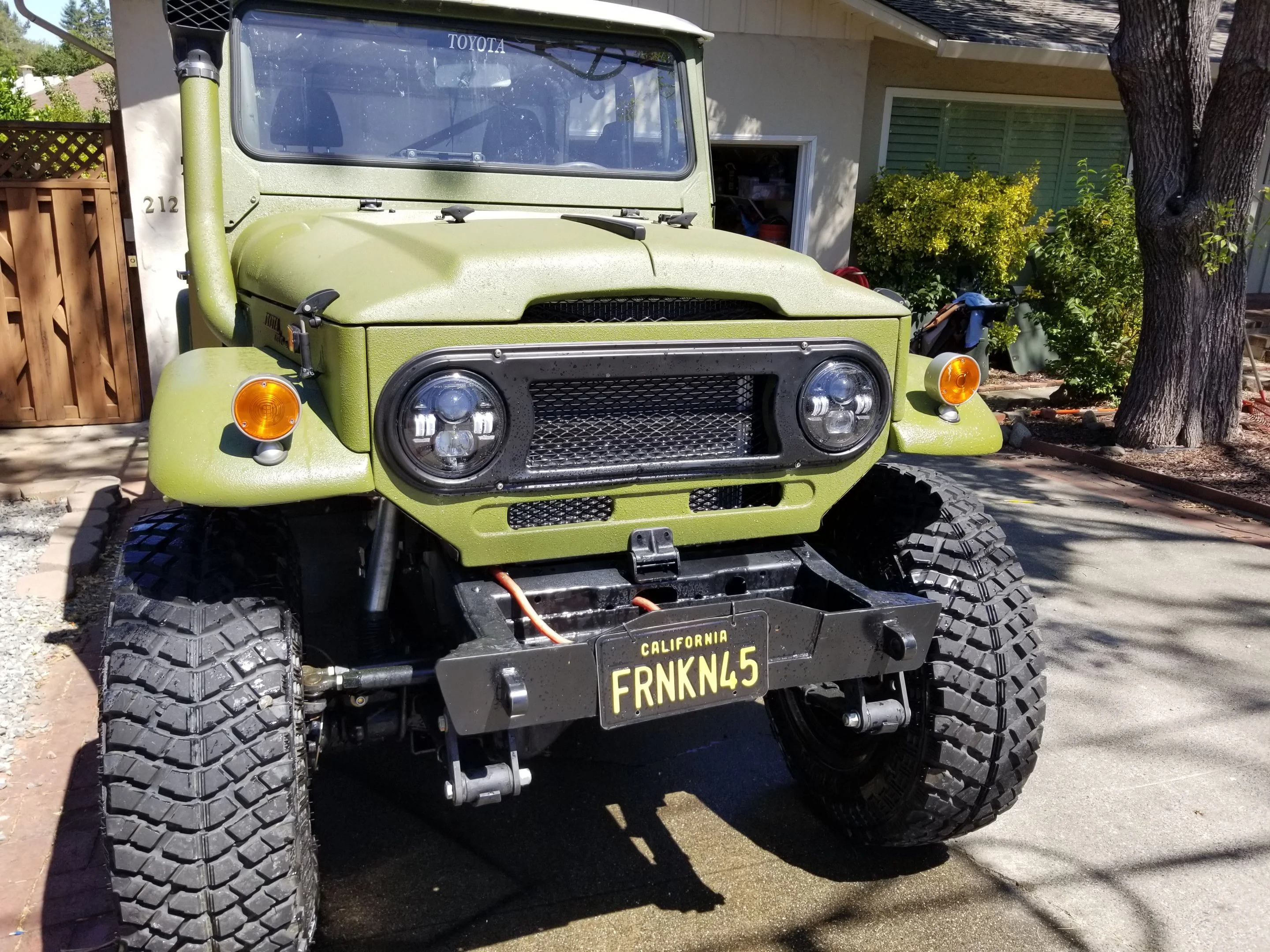

I also changed my headlights from the eBay specials to some Morimot Sealed7s. I have them on my 80 and they work great!

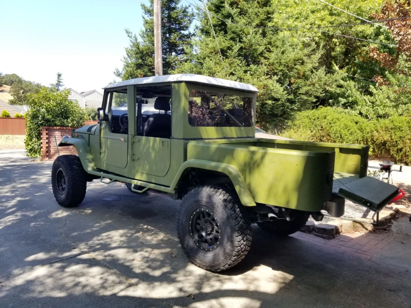

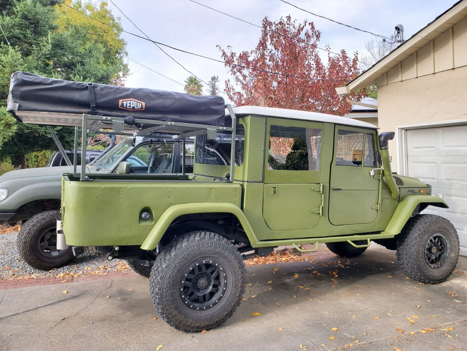

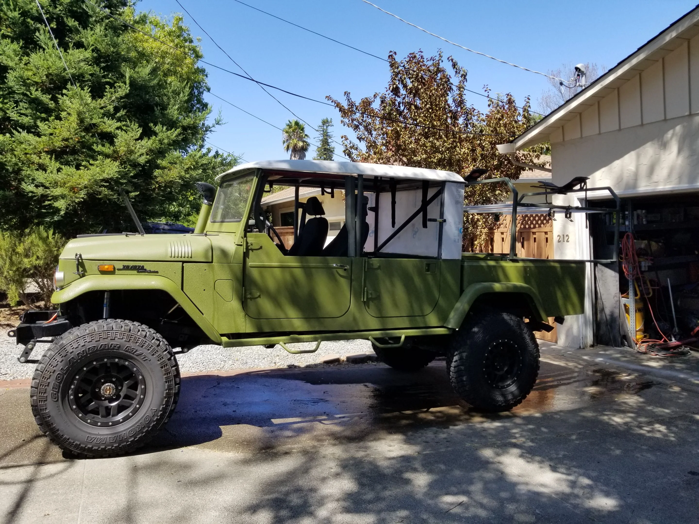

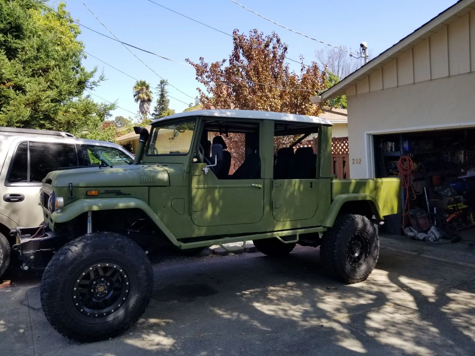

So I finished the rear of the cab and the B-pillars so the top is bolted very securely to the tub on all sides. I reused the front of some hard top sides I had from the soft top days and 1" angle to form the rear door outer frames. The rear frame is 3/16" steel cut to the shape of the rear top and then welded to the rear 1" angle iron that forms the rear of the rear outer frame. It's all modular...but the hard top isn't coming on or off quickly. I still plan to get the soft top modified and use it as just a bikini top, but it's nice and quiet with the full hard top.
Got door uppers done, at least it's mostly water "resistant" now for winter. The frame is 1/2" square tube and 2" angle that is bolted to the tops of the doors and covered with 3/16" polycarbonate. I'm not sold on the shape/size of the rear windows. I had thought about matching them to the front height, but then the kids can't really see much, so this shape is a compromise. In the future I would like to cut a full size door out of aluminum and use those for the winter with some sort of a slider window.

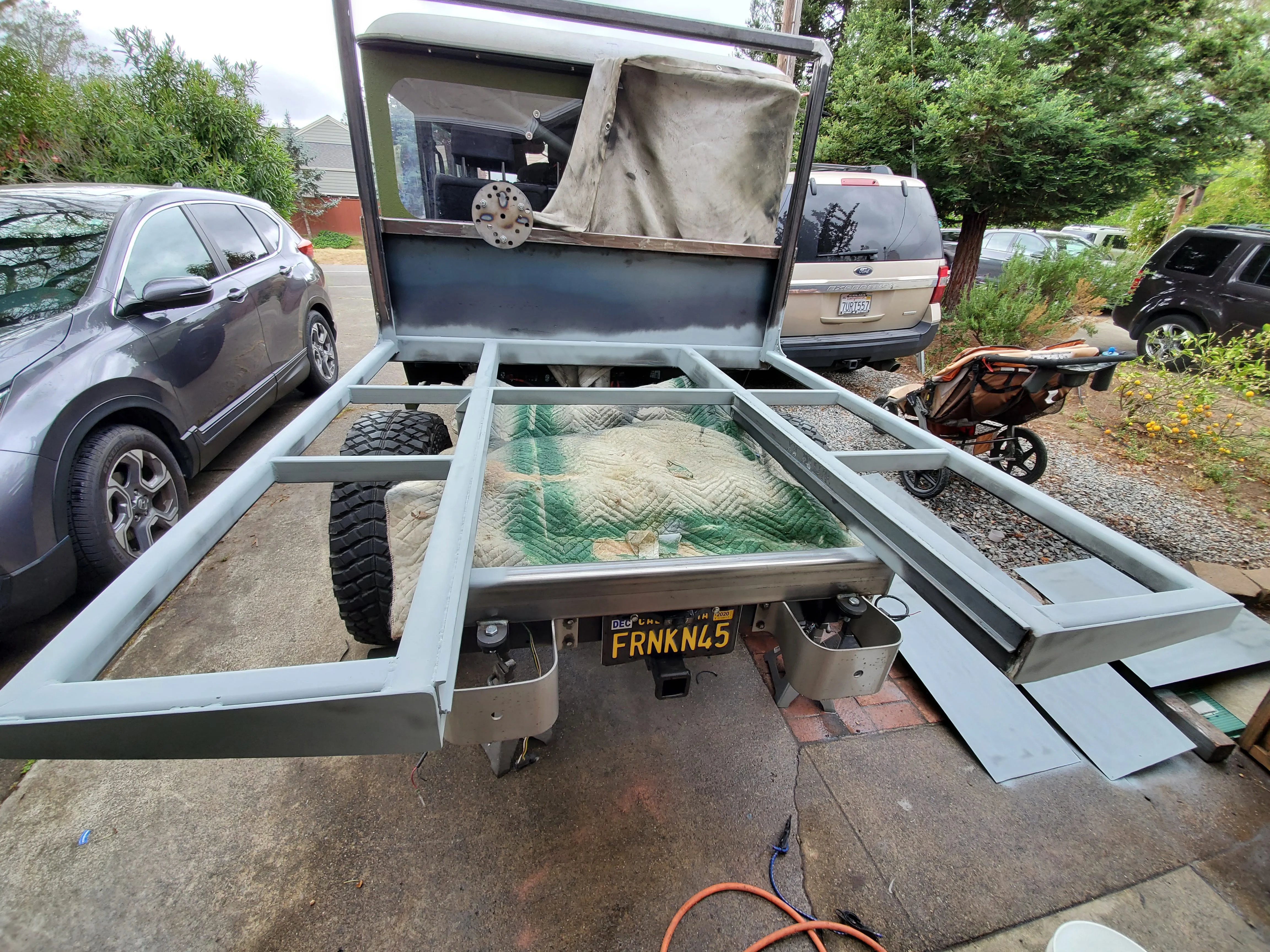

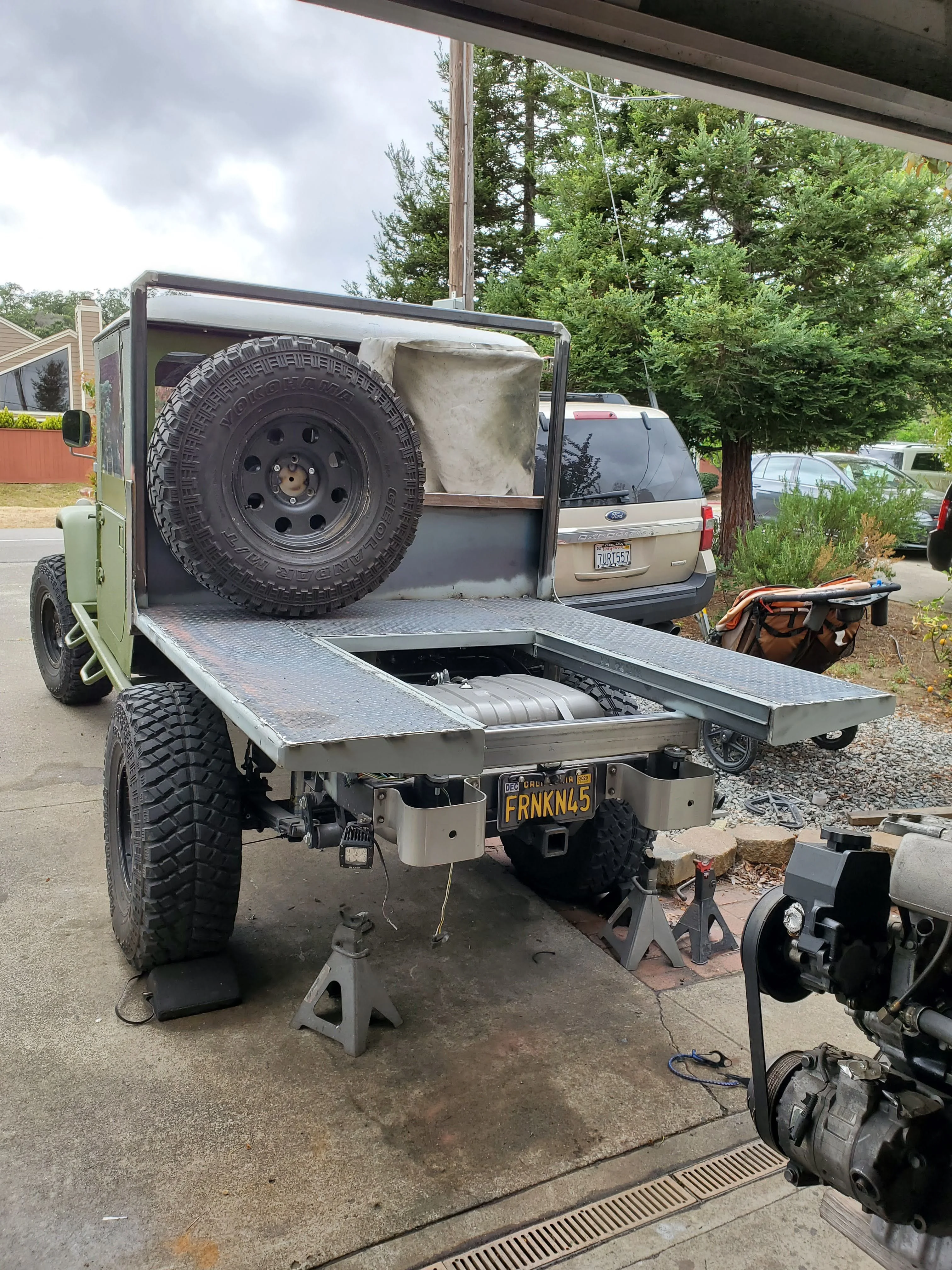

So I have always wanted a more modular bed. I figured with all this forced home time I'd start on making Frank a flatbed. So I pulled off the shortie bed and started with some 2x4" .188 wall tubing.
I changed out the fuel tank to a 33-gallon tank from a full size Bronco and replaced the in tank pump with a higher pressure and volume pump.

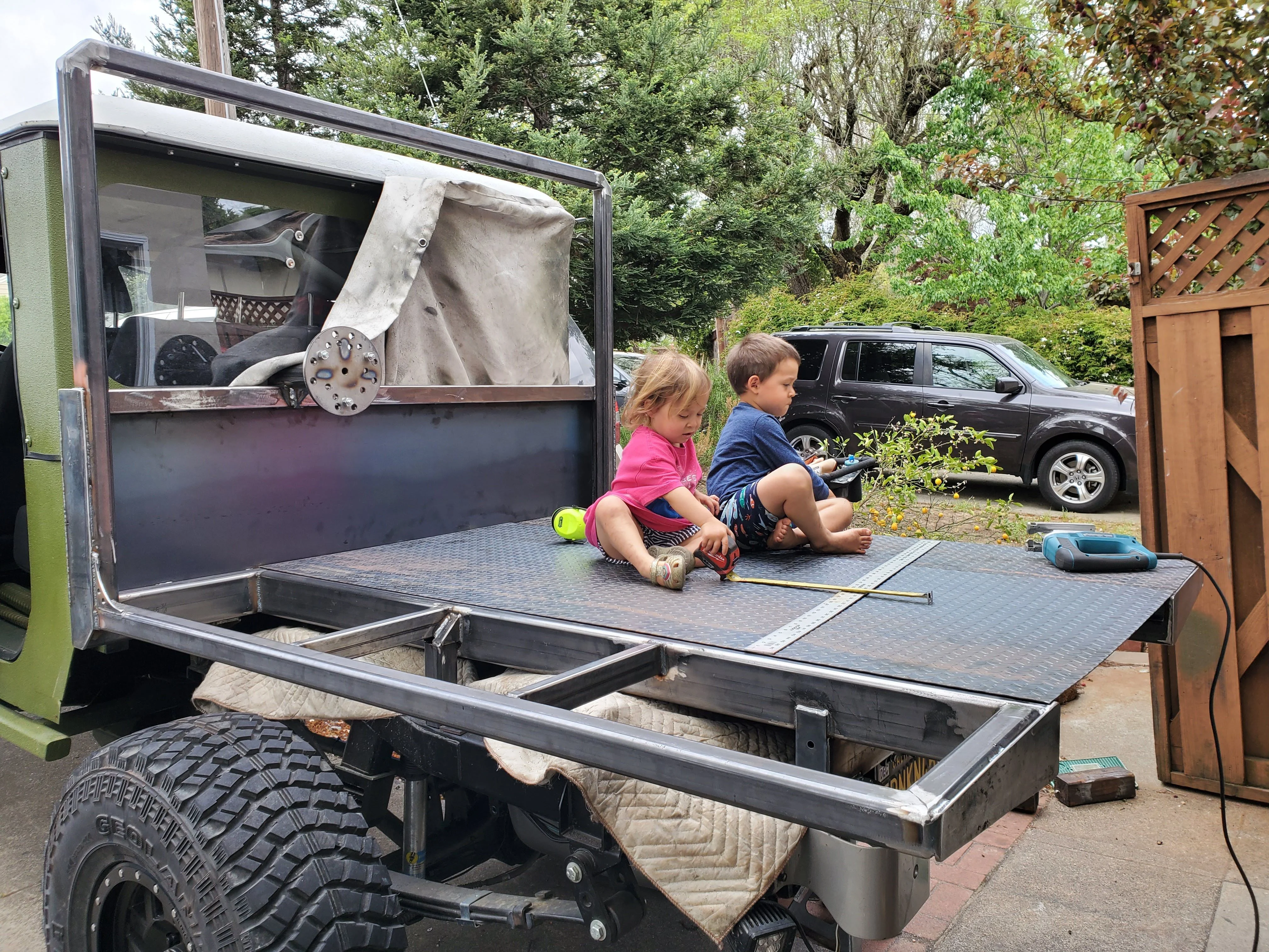

I worked on framing out the flatbed and kept the idea of having the center of the bed be one large slide out.
In the end the full length (72") slide wasn't going to be practical and I settled on a 44x33" slide that I will turn into a drawer so the top diamond plate is hinged.
The kids helped me cut the diamond plate today.

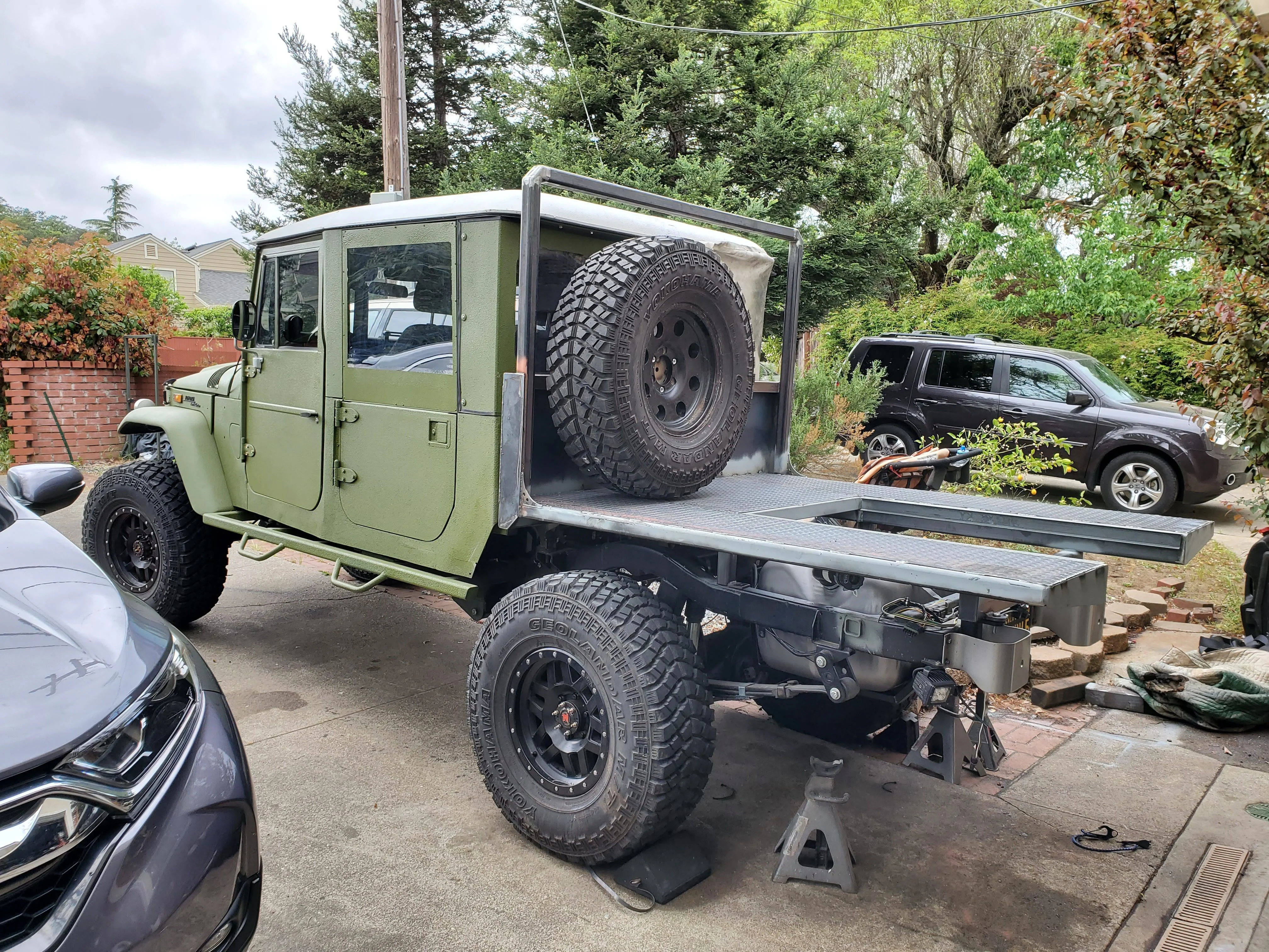

Added a spare tire mount and now its ready to go....aside from the slide drawer that I haven't built yet.

I think he does too, he has that truck pretty optimized. I need more cab though for more people so unless I want a giant/narrow truck I am limited on bed. I think this one at 72"x 65" will work pretty nice though. I have a matching rear hoop to weld up and that will bolt on/off when needed.

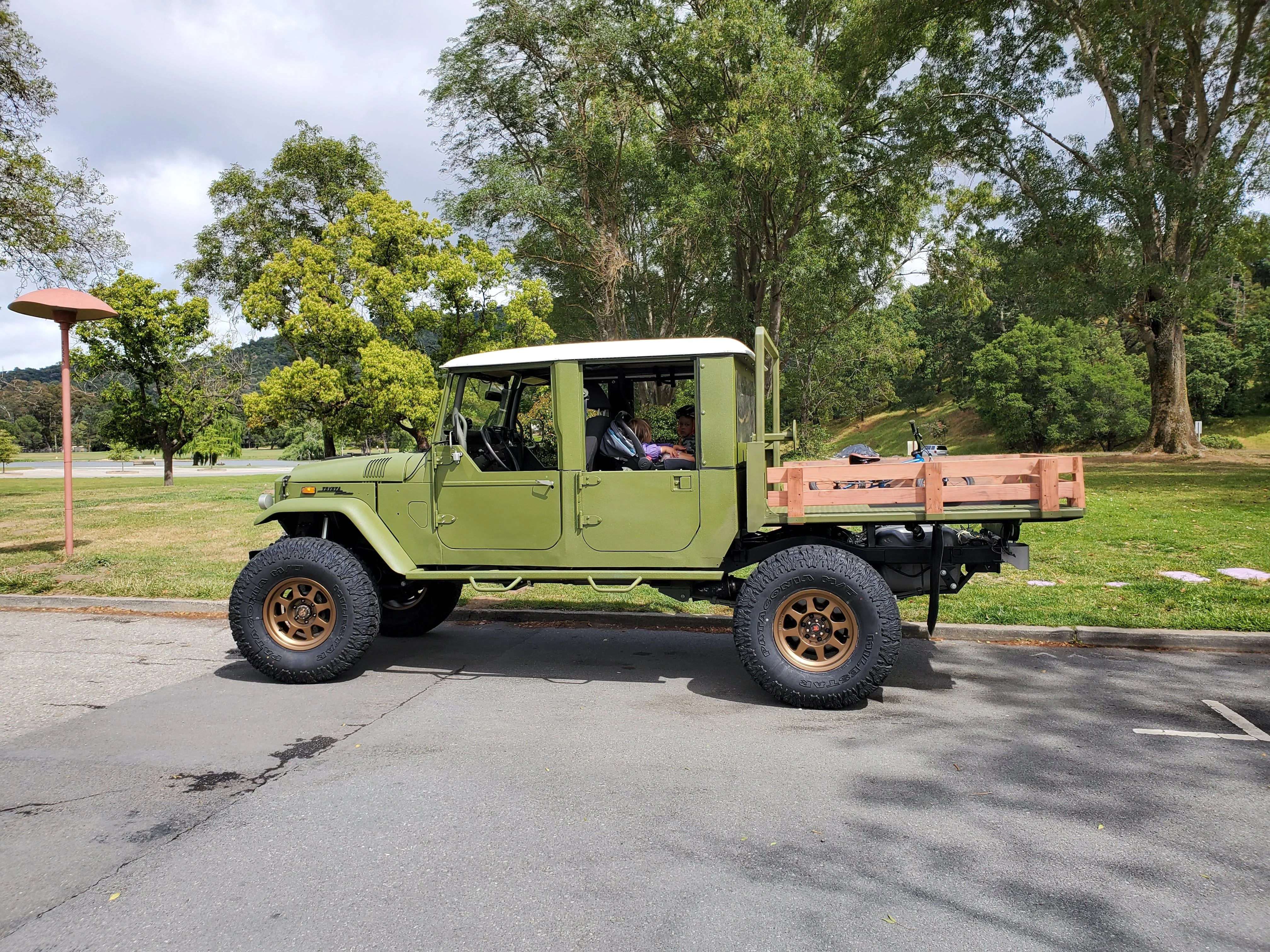

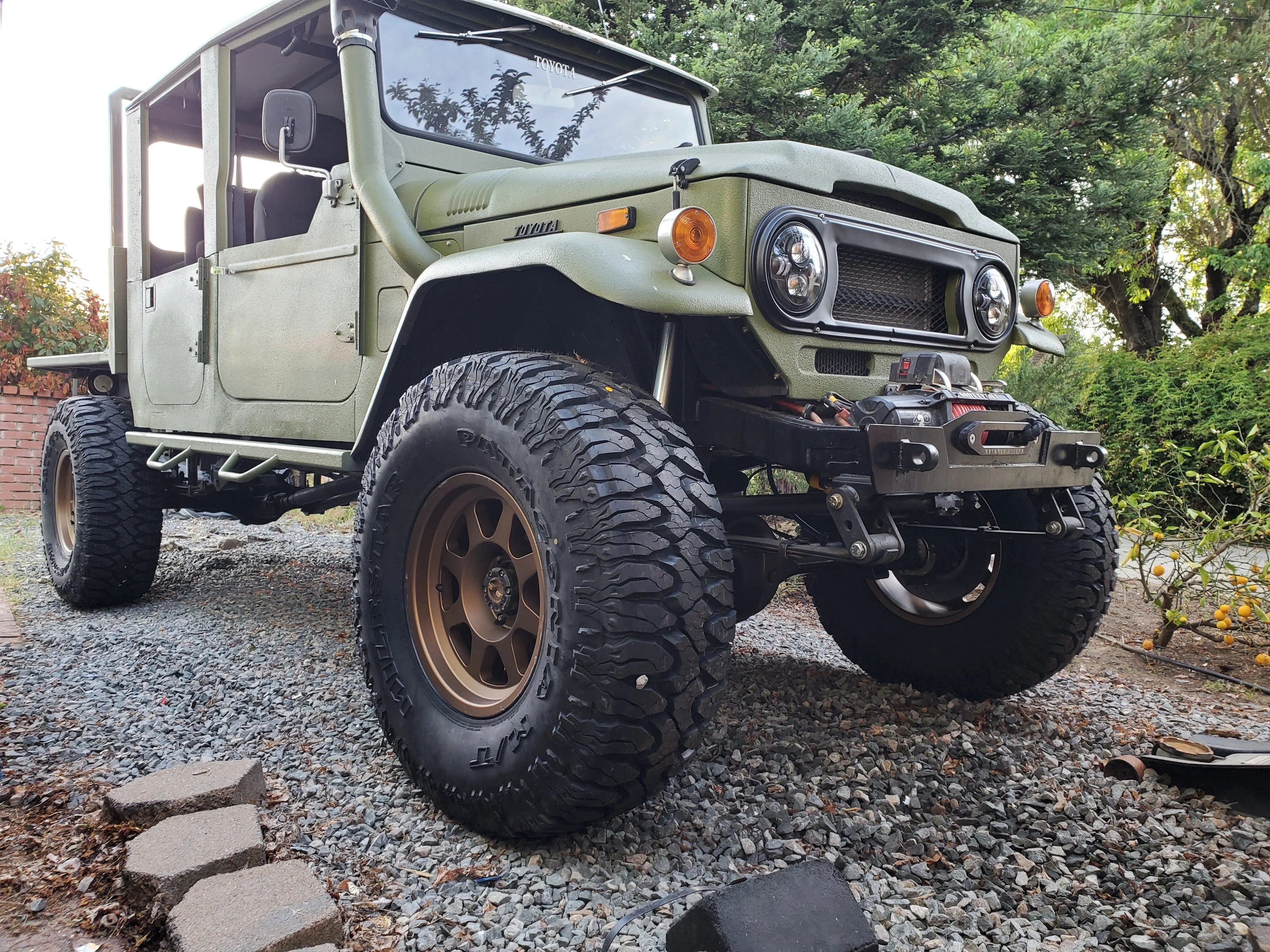

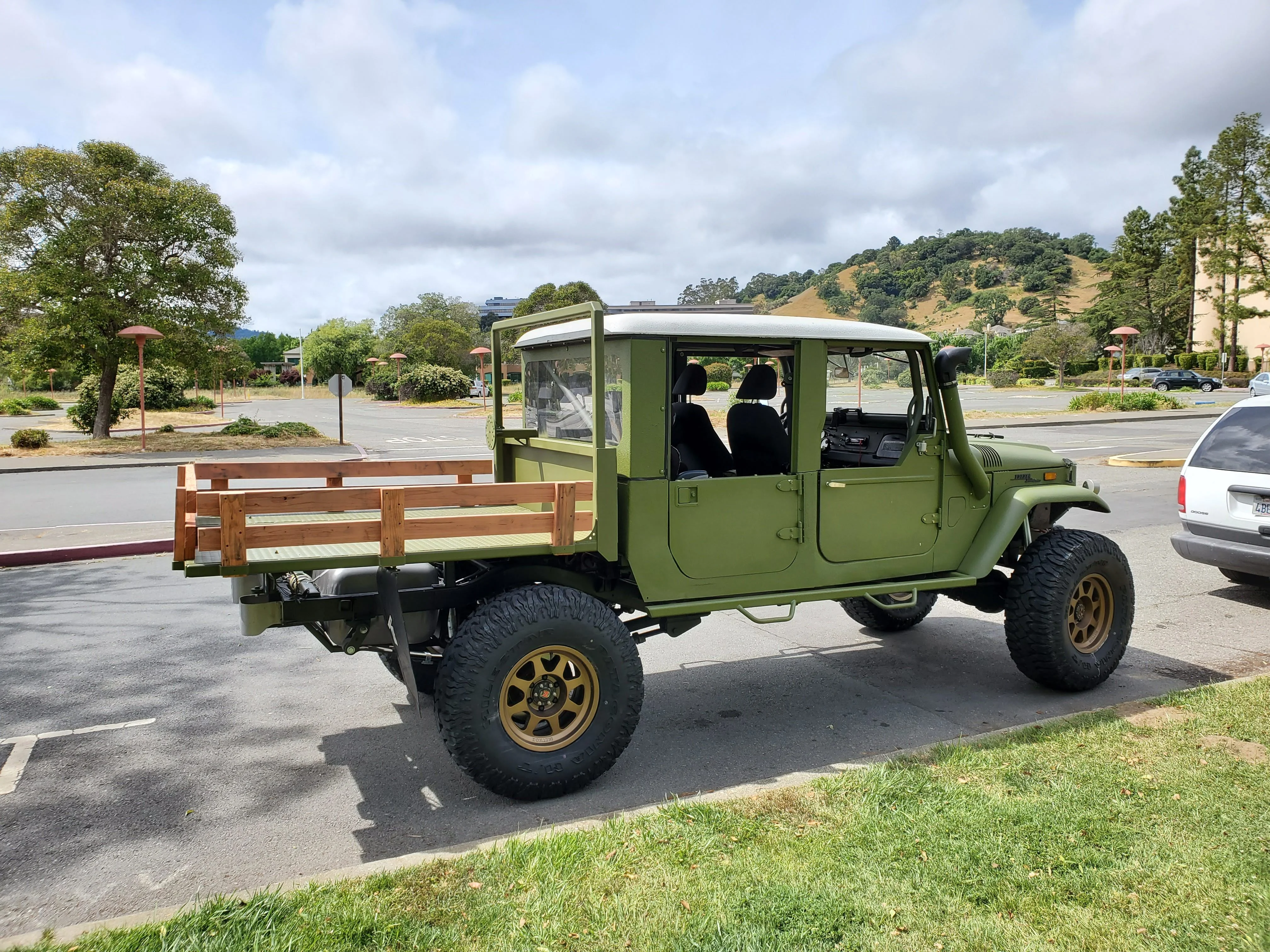

Some updates. I made some bed sides out of Redwood but I still haven't finished the slide out drawer. So there's still a giant hole in the bed. I changed the wheels to some Method trail series wheels and pushed the back spacing out to 4.5" from the previous 5.75". I also upgraded to Patagonia MT tires, man are these things quieter and look great in 38"!

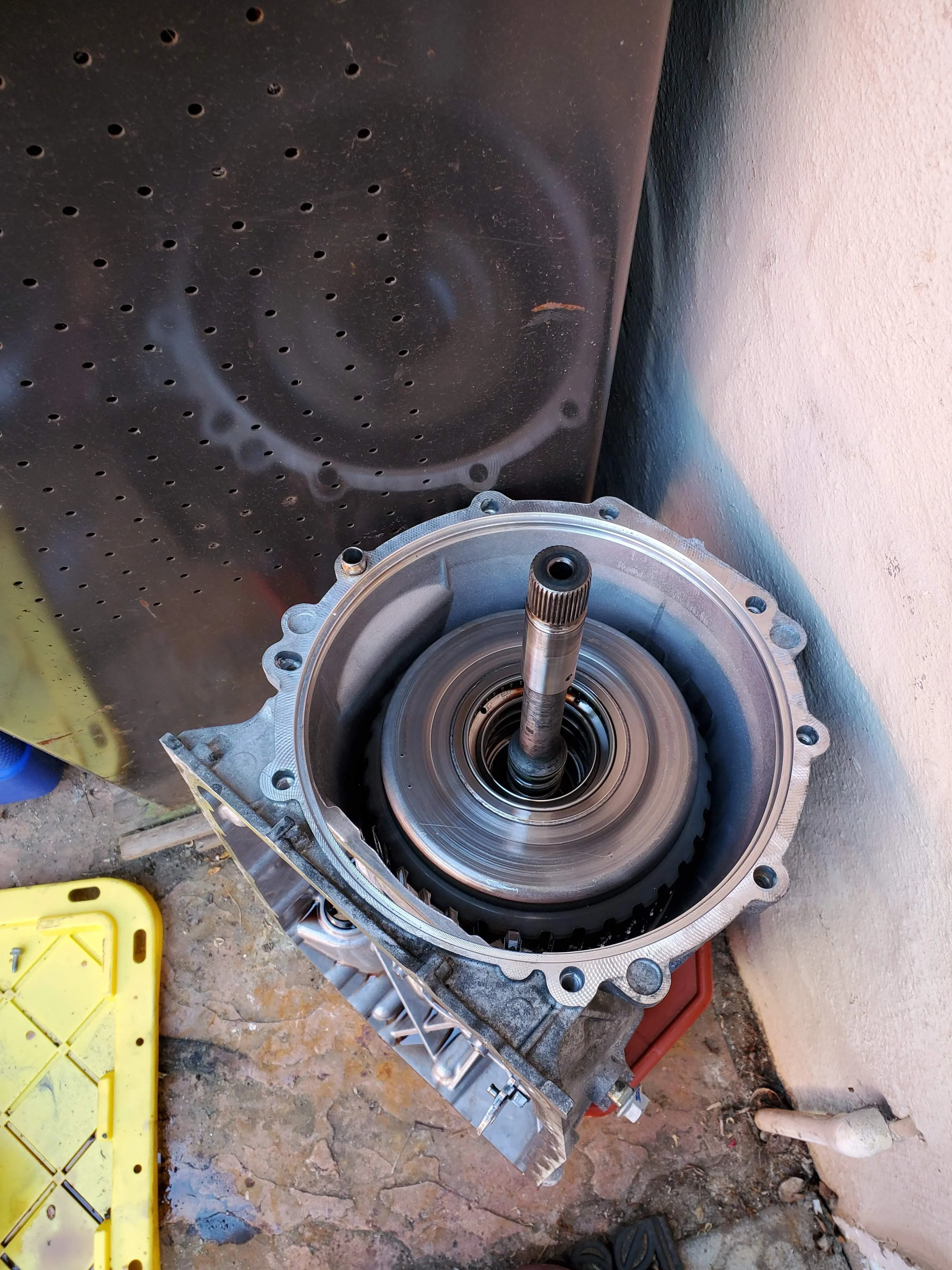

I am still fighting the NP203, it won't shift into low. I got a deal on a Blackbox but it requires a 6L90, so I found a used one and it's torn apart in my garage to replace all the friction discs and upgrade the pistons. Aside from a 3ft long pair of snap ring pliers it was very easy to disassemble.

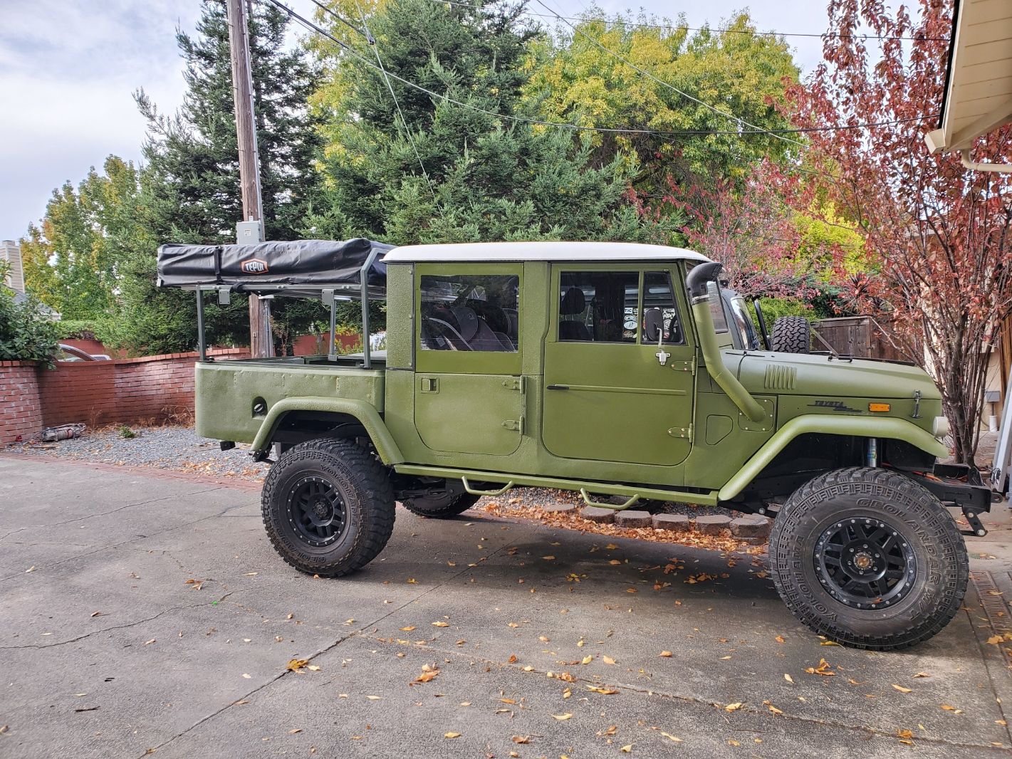

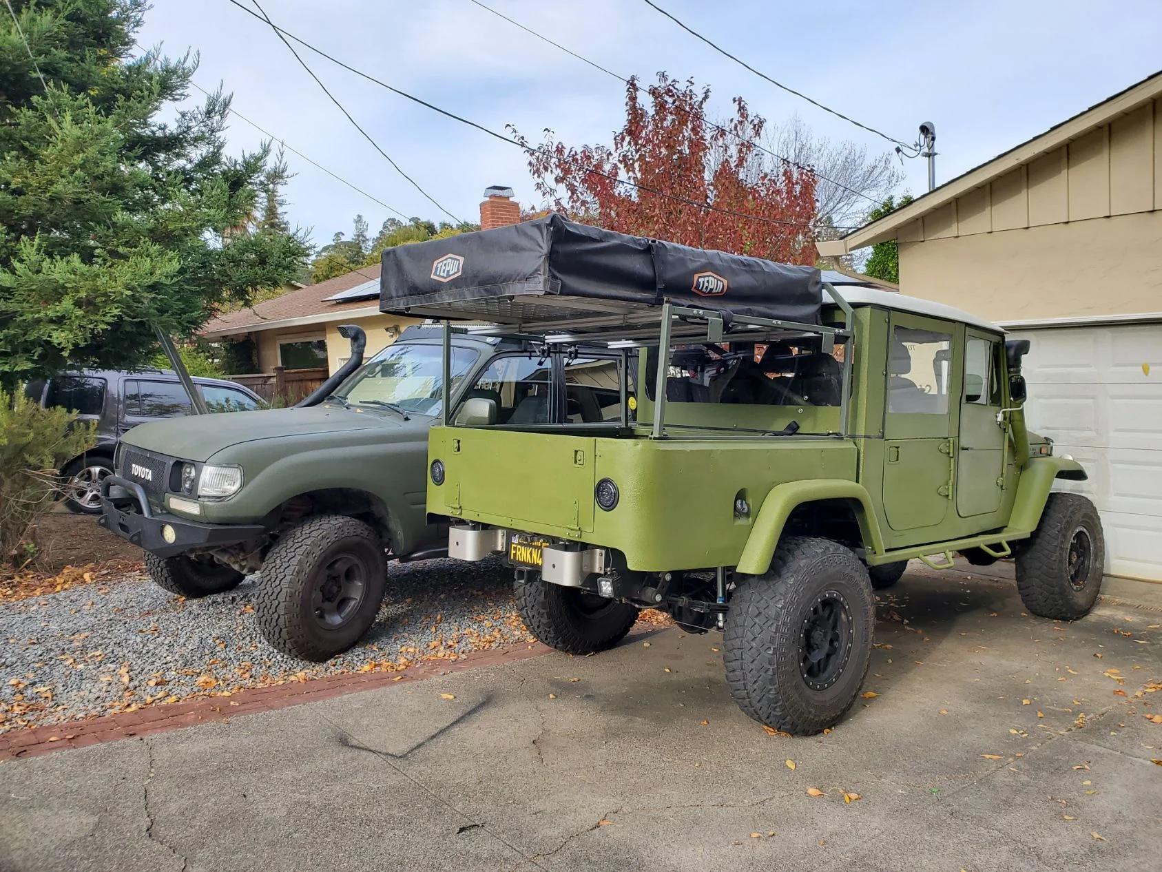

Been a while since I updated this build. We moved twice and even though I tried to sell him, Frank is still with us. When things in Virginia finally settled down I finished swapping the axles over to 2008 Ford F250 axles. Sterling 10.5 rear and Dana 60 front with Fox coilovers and WFO parallel link arms. The ride with the coilovers was great but I was never happy with the temporary rear window. So, Frank is under the knife again....
