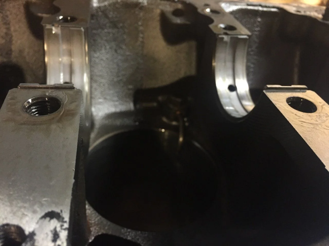

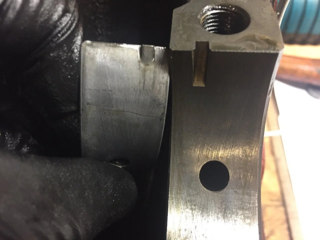

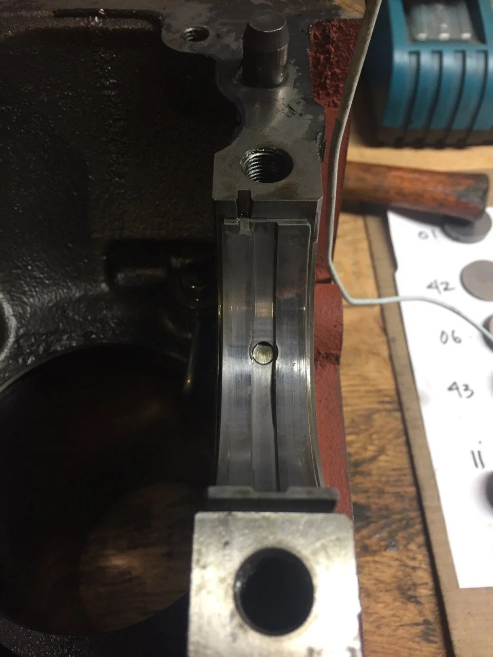

Clearing some space in the garage, I finally finished tearing apart the block and made an interesting discovery. It appears that the #7 crank bearing had spun as far as it could and several others had spun at least a few mm. Can someone explain why the grooves for the bearings wouldn't absolutely hold the bearings in position so this could not happen? Seeing this, I'm certain this is what happened, but I'm confused about what I would do to stop it from happening?
Did some checking on the crank and the number 6 rod journal is about .5mm wider than the rest, but fine other than that. Still probably not salvageable but it makes me wonder if it could be and most of the damage is actually in the rod end. Anyway, food for thought.
I would be checking the numbers on the back of the bearings... make sure they are the correct ones and also plastigauge the crank to see what if anything is amiss there.... measure the crank as well (mains and bigends) maybe....... essentially measure everything and see it its all good..... partially spinning a bearing like that with no other signs of anything seems very odd....
considering the bearing halfs touch each other, i find it strange that the bottom "turned" ...
what about the other half, what is the back of it looking like.
also, considering the oil feed hole isn't lined up i find it interesting there is no oil stain on the casting.
you sure this rotation didn't happen when pulling the crank out? sometimes there is a bit of suction and the bearing can move upon removal.

You were correct, I jumped to a conclusion without enough inspection. After double checking-- even with the minimal miles on the engine-- I could actually still see some staining where the hole aligned on the back side of the bearing. So it must've been the suction on removal.
On a related note, I finally decided to bring the block, pistons, old crank, head and cam to my machine shop to have him look things over. The preliminary conclusion isn't all bad news! After hearing what I know of what happened with the initial start up and all details I could remember, the first conclusion he came to after looking over all the parts was that it really looks like oil starvation in the number 6 rod bearing on start up was enough to start the snowball rolling. Prime your oil system people! In the future, I wouldn't start up a rebuild without using a pressurized oiling system like he loans out on builds he does.
He also feels like the block is salvageable, but that is still being determined. The latest news I got was that the re-hone he performed wasn't quite enough but it could be okay after a really light re-bore. We'll have to check clearances against the pistons I have to see if it's viable. Should know more on Monday once he's back from vacation. If it's okay, I kind of wonder if I should have him put the short block together since I have all the parts minus the bearings...Then it's warrantied. Anyway, it's food for thought at least. We'll see what Monday brings, maybe it'll be a late christmas present!
