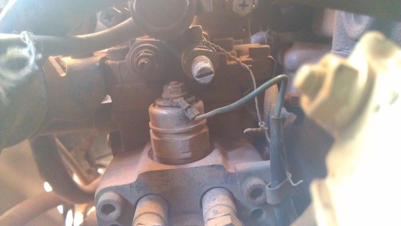

so had a bit of a fiddle, found some cracked hoses, but it still didnt fix the problem. then i came across this little bad boy again.
main fuel is on the right, the little one on the left what does it do?!?
Me and this little screw had a run in when i first got the car, I wound it in thinking it was the main fuel screw.... duh.... and ive no idea if its back in the right position.........
so with it idling it adjusted it to see what it did, and wouldnt ya know it the idle went up and down according to the adjustment of the screw... so whats it bloody do?!?! seems like some sort of "mixture" screw for low revs??
*edit* have been told it was the idle adjust screw. but i thought that was external and pushed on the actual throttle control arm?!

yap .. that's the way that it works .. same way that AC idle up ( vacuum device ) works ..
The one on the left is the Dash Pot. It adjusts idle speed. Seems redundant to me as there is an idle speed adjuster that pushes on the speed control lever. Maybe someone else can offer a better description of how the dash pot works. The FSM mentions it but it's not obvious how it functions.
Isn't that the Total Fuel Screw? Or something to that nature
So it's a dash pot.... What's its function? Is it just another idle screw ?
Its a kind of damper I think,it regulates the idle,stops it from fluctuation,.
It also stops the engine from stalling when you back off on the accelerator quickly.
Its suppose to be set when the pump is on the bench,then you use the idle screw or hand throtle to increase/decrease the engine speed.

There is a fuel screw which can adjust fuel, uses a deep 12/14mm socket and flat screwdriver, you need to disconnect the throttle linkage in order to make this easy. Mark where you start and end the settings, be sure to hold the set screw when locking the nut because the setting may move. Adjust by 1/8 turns till she smokes and then fine tune. If all else is good my guess would be more fuel!!!
Lastly: Because the fuel set screw increases or decreases the amount of fuel going to the injectors you need to adjust the idle accordingly, therefore at the front of the IP you have a double nutted 10mm idle screw, loosen the outer nut and adjust rpm via your tach to specs.
