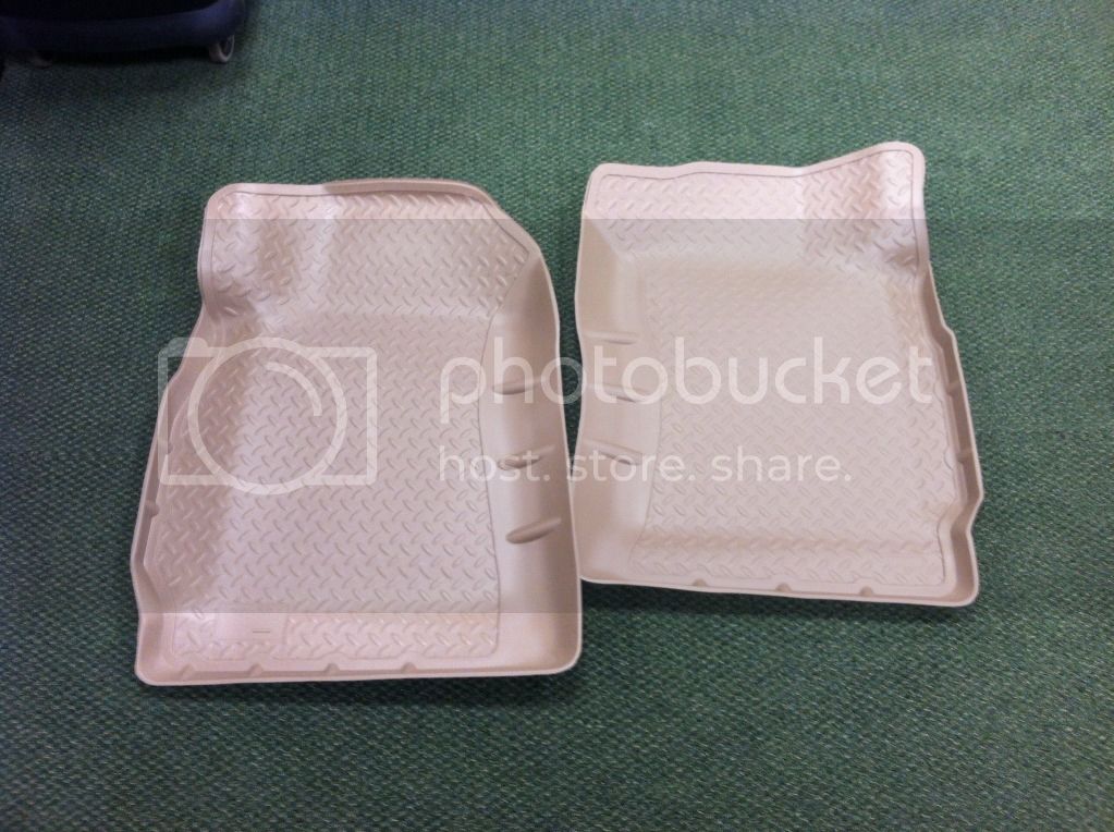

I spoke with the engineering manager at Husky. The front Husky Liners are discontinued but they still have the tooling to make them so can still take orders in any color they offer. They arrived today for $80.95 shipped. They're worth it to me.
Unfortunately they have already destroyed the tooling for the rear liners so I couldn't get them too. If anyone ever sees some rear liners in tan please let me know.

Me too. Had them in my Cruiser, had them in my Honda Civic from an unknown donor vehicle, and now in the T100. they rock and really help keep things clean.

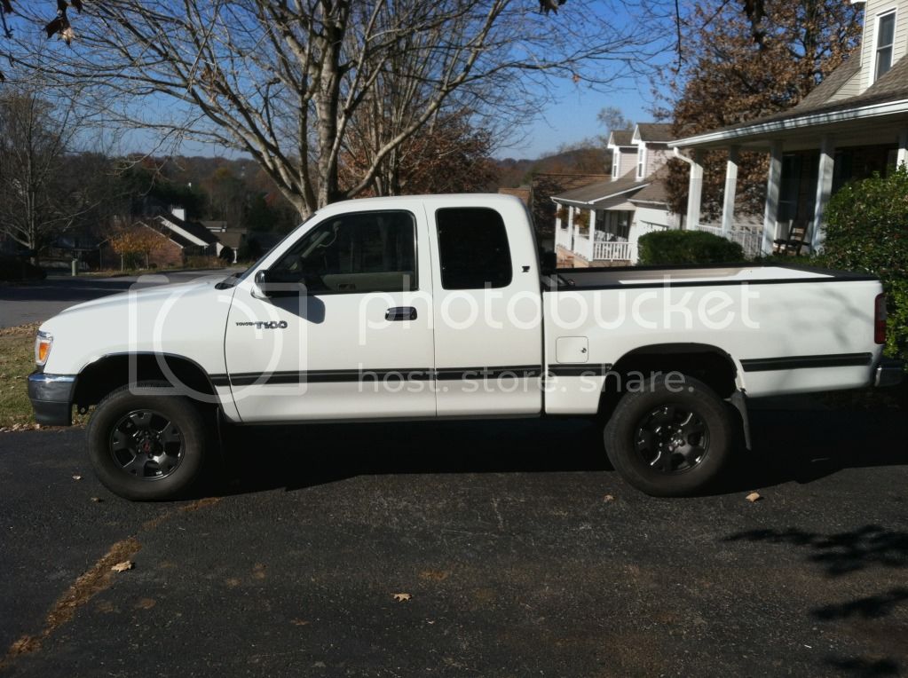

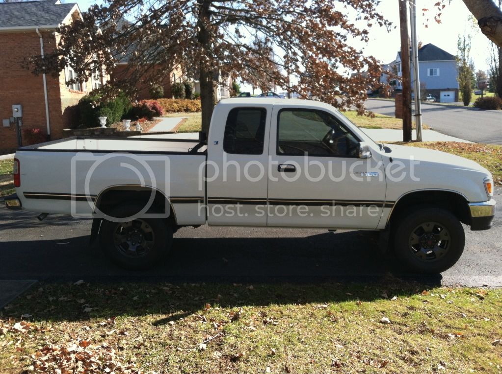

Finished the wheels. I did a bad job filling in the circle and the T on the center cap so they didnt get any clear coat. Ill redo them again sometime.
Rustoleum Self etching primer p/n 249322 Bar code 20066-18865.
Rustoleum wheel paint p/n 248927 "steel" Bar code 20066-18650.
Rustoleum crystal clear enamel p/n 7701 "crystal clear" Bar code 20066 77018.
Looking nice! Thanks for the name of the color Rustoleum as well.
On the rear liner I saw someone post that the 1st gen Tundra was a good fit in the rear. I was lucky enough to buy my T with front Husky liners from the PO.
Thank you. I have the codes for the primer, paint, and clear I will post when I get home.
Ill check out the rear tundra liners. Thanks for the tip!

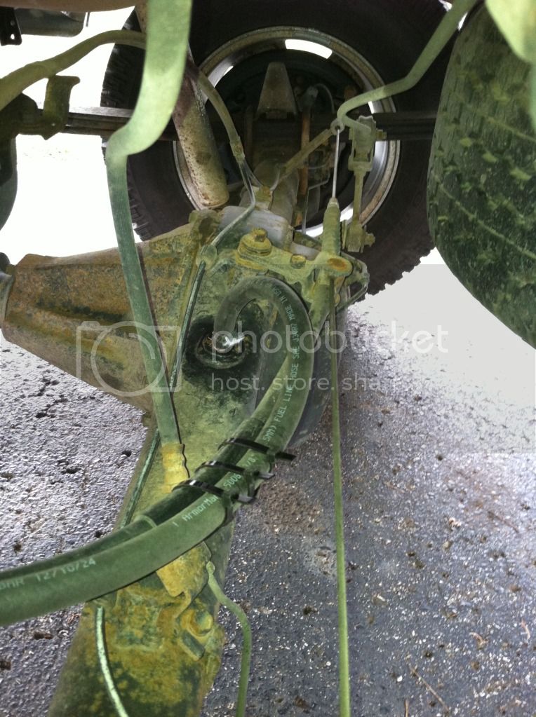

I finished the diff breather. I decided to run it to the fuel door area because there was much less dust there than behind the rear taillight. I had to drill a hole but the metal there is very thin so it took about five seconds. I put a little synthetic wheel bearing grease around the hole to seal it, water proof, and prevent rust since i didn't paint the edge.
Took about 20 minutes to decide the best way to run the hose and to drill and install.
parts used p/n#90404-51319 UNION. 90930-03136 PLUG, BREATHER. 5' 3/8" fuel line from auto zone
Was everything from AutoZone or just the fuel hose? Looks good and this is a must mod for us.

Thank you.
The breather and "union" are Toyota parts. The hose and clamps are from auto zone.
Definitely a must mod. This factory breather was completely clogged and probably the main cause for my rear seal leak. Now that this is done time to learn about pressing bearings, retainers and abs ring. :-(

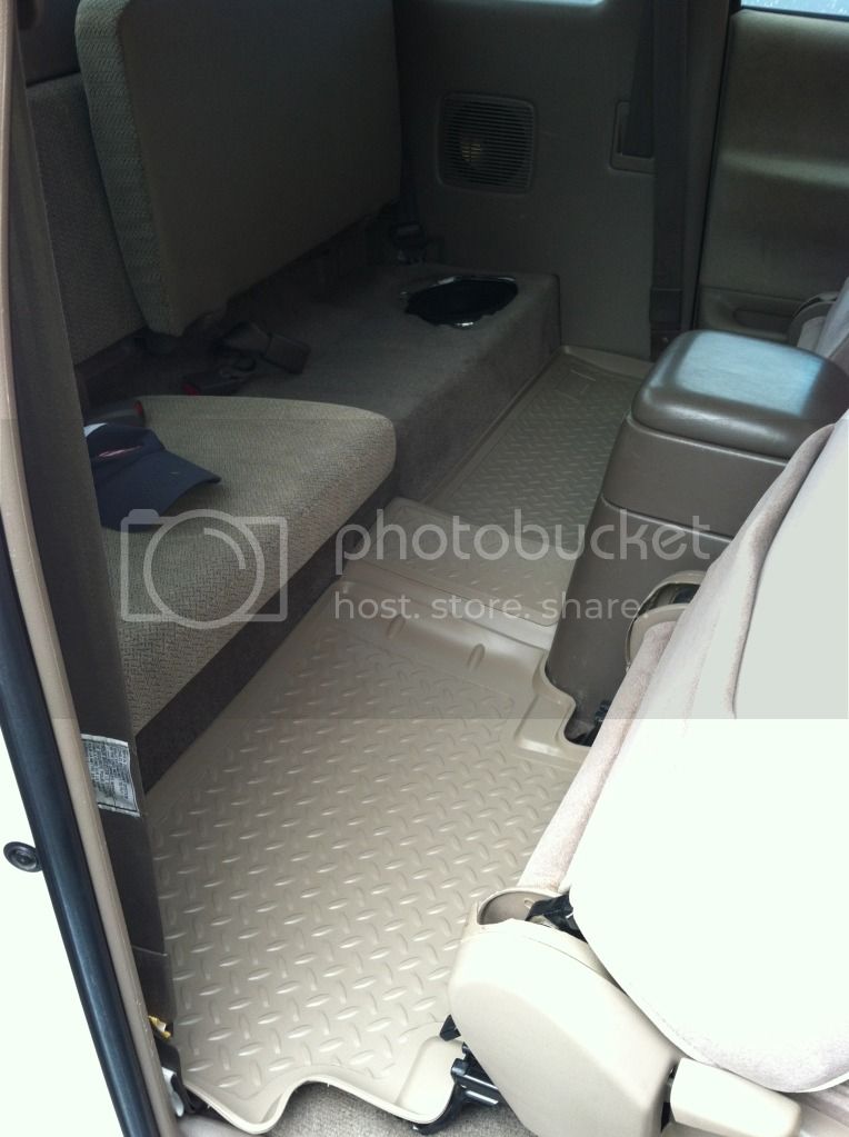

They were right. Rear Tundra Liners are in and fit almost perfectly.

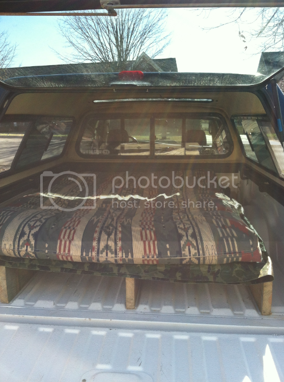

I also made a sleep platform for the camping trip. I have an old futon mattress I used in the Cruiser. It worked out well. I left spaces between the cross planks so i could reach small things if they slide to the front of the bed. I also left space on the passenger side so the platform is easier to remove and for easier access to whatever I store over there during the trip.

UPDATED post #76 with the finished sleeping platform.
