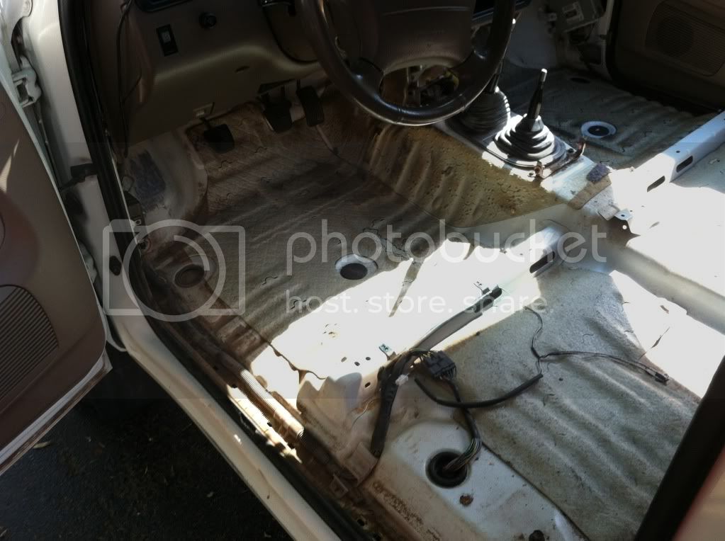

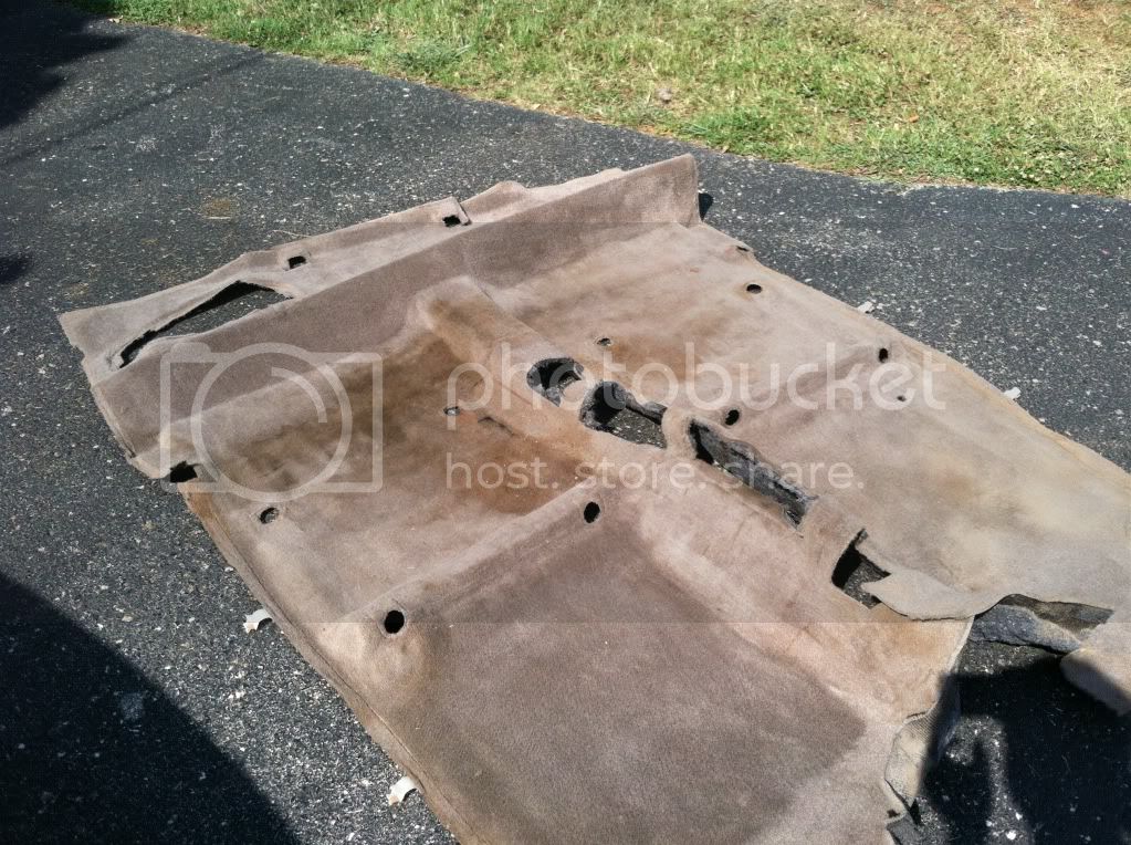

Ive been wanting to scrub the carpet since i got it so I decided to do a little cleaning on the interior today. There is New Mexican dust under and behind everything. The panel removal process wasn't as bad as I thought it would be. Just start with the bottom door panel with the four screws and work clockwise (counter on the PS) popping out the panels. Be aware you have to remove the grab handles, rear hatch window latch, shifter knobs, and seat belts. Also before you get to the main side panel you have to remove the back seats and panels there. Then the sides just pop right out.
Here is the nasty smelly carpet. One of the PO's had a dog with white hair. I scrubbed it with a mixture of degreaser and some old oxy steam clean stuff that has been in the garage forever. Depending on how it looks I may scrub it again and take it to a power washer.
