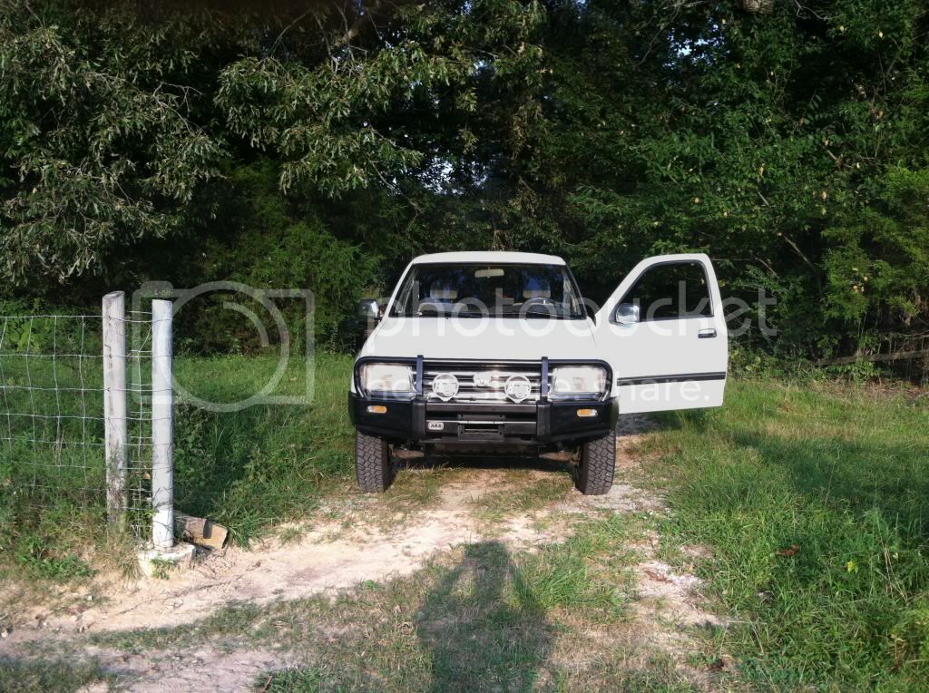

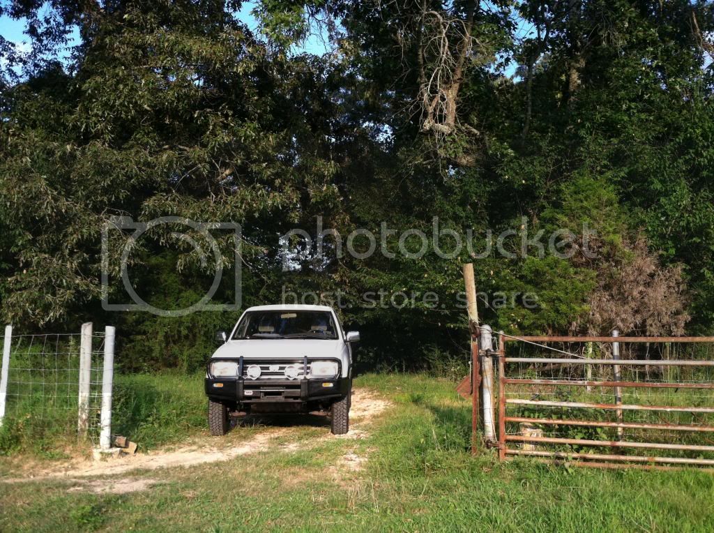

That guy kind of inspired me, fit was easier than I expected really. I used the previous model of the 100 series ARB. It did not have the fog lights and such, and cost a little less. The earlier model also seems to hang down a bit more on the corners and covered the undercarriage stuff better than that one I thought. Looking at that guys pictures I thought he had to shim the mounts down some. The earlier model uses spacers to avoid cutting the front frame horns on a 100. I thought getting the model with spacers would be easier to add material to the spacers, but as it turned out I didn't need to.

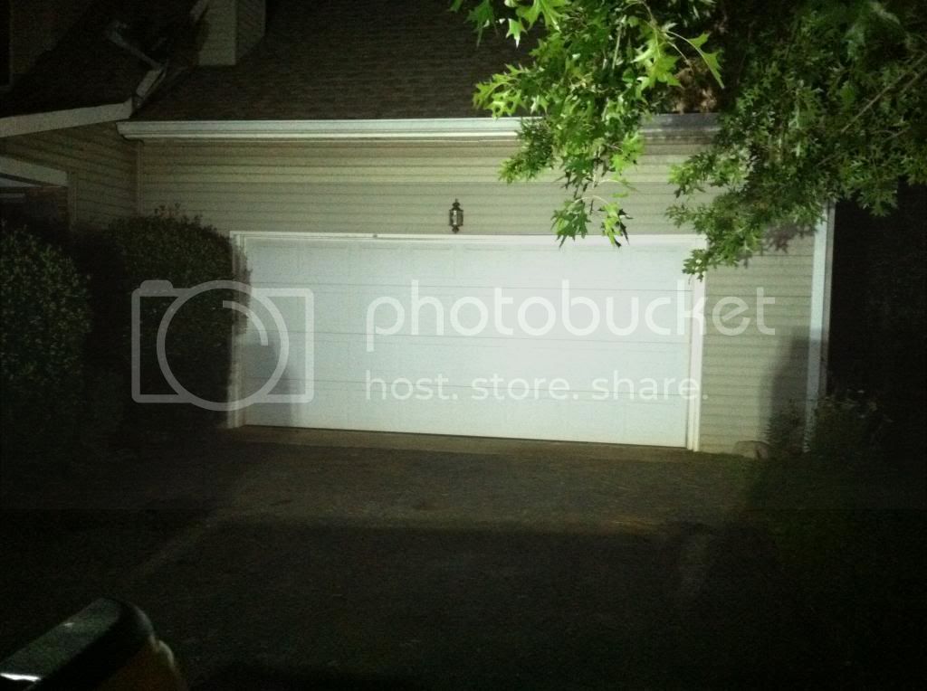

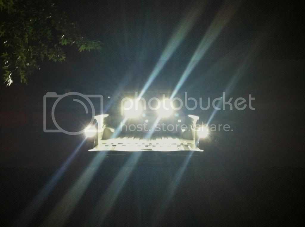

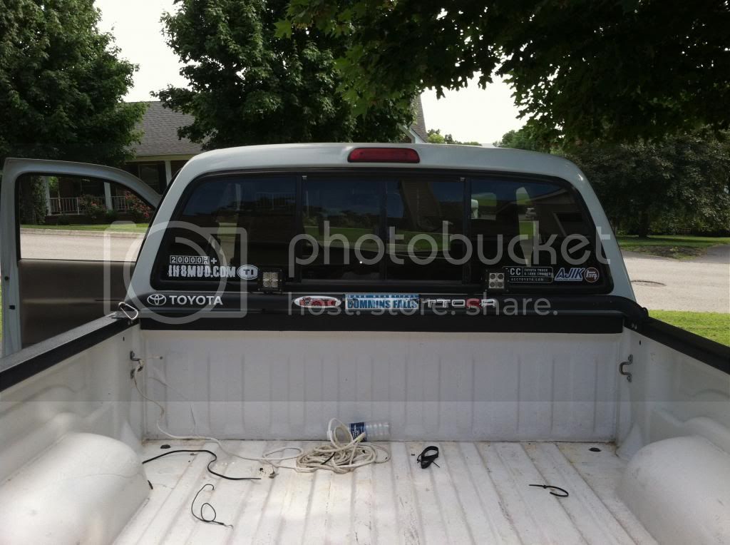

Today I changed out the bed lights for some LEDs I got from ELS' group buy.
Before:

New Bed Lights:

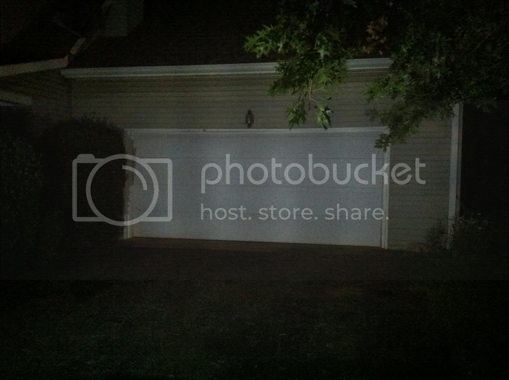

Are those the flood or the spot pattern? That is crazy bright! I think I need to figure out a way to work a pair into the 4Runner rear bumper. Also a good way to get those tailgaters with the illegal HIDs to back the **** off.
Damn, this is a big improvement over stock. I think I'll pick some of these up!
They're a huge improvement. I have some comparison shots earlier in the thread of stock vs the LEDs.
I'm ordering some now. Going through Amazon though, they're half the price of Pfran for the same thing.
I'm all about supporting small businesses when they provide superior customer service, but one online retailer against another... price is king. Especially when they're $5 Chinese LEDs that all come from the same place.

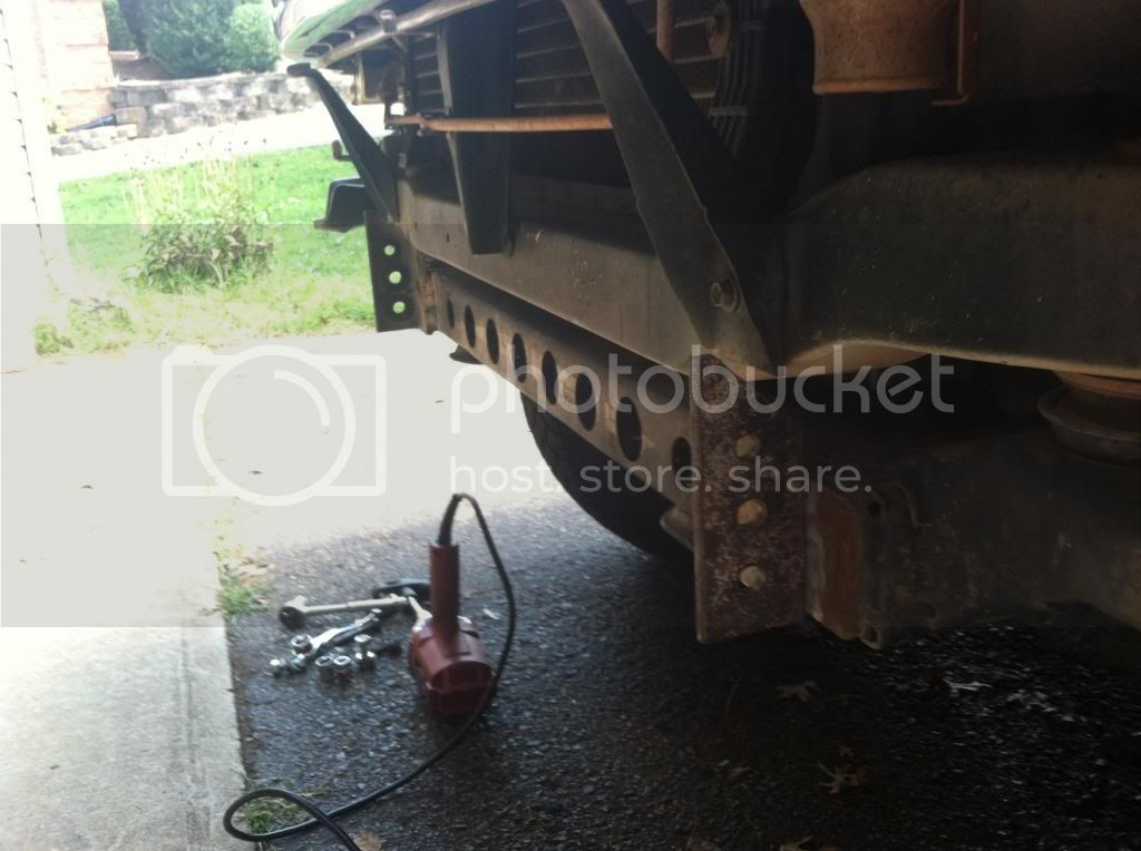

More ARB progress. I welded a bracket to the frame and reinforced the bumper mount so now I'm comfortable driving around with the bumper on.
Brackets:
My Original bumper mount:
Reinforced bumper mount:
Frame bracket:
I used bolts from the tacoma kit that came with the bumper.

Still have some more superficial work to do but its pretty much complete.

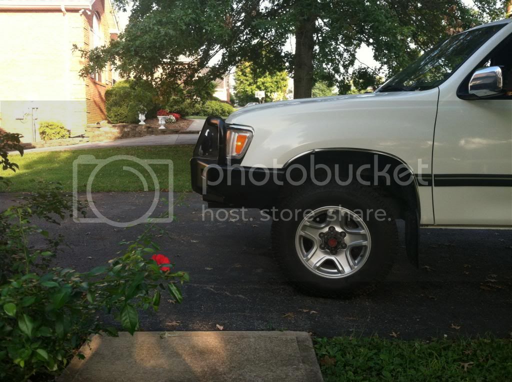

Looks like it belongs on there. The truck sure does clean up good. Did it squat the front end very much? This makes me want to go out and fight with mine a little more to get it mounted up.
Thanks. no squat with it. Steering feels a little harder after install but that may be because I'm used to driving a civic lately.
