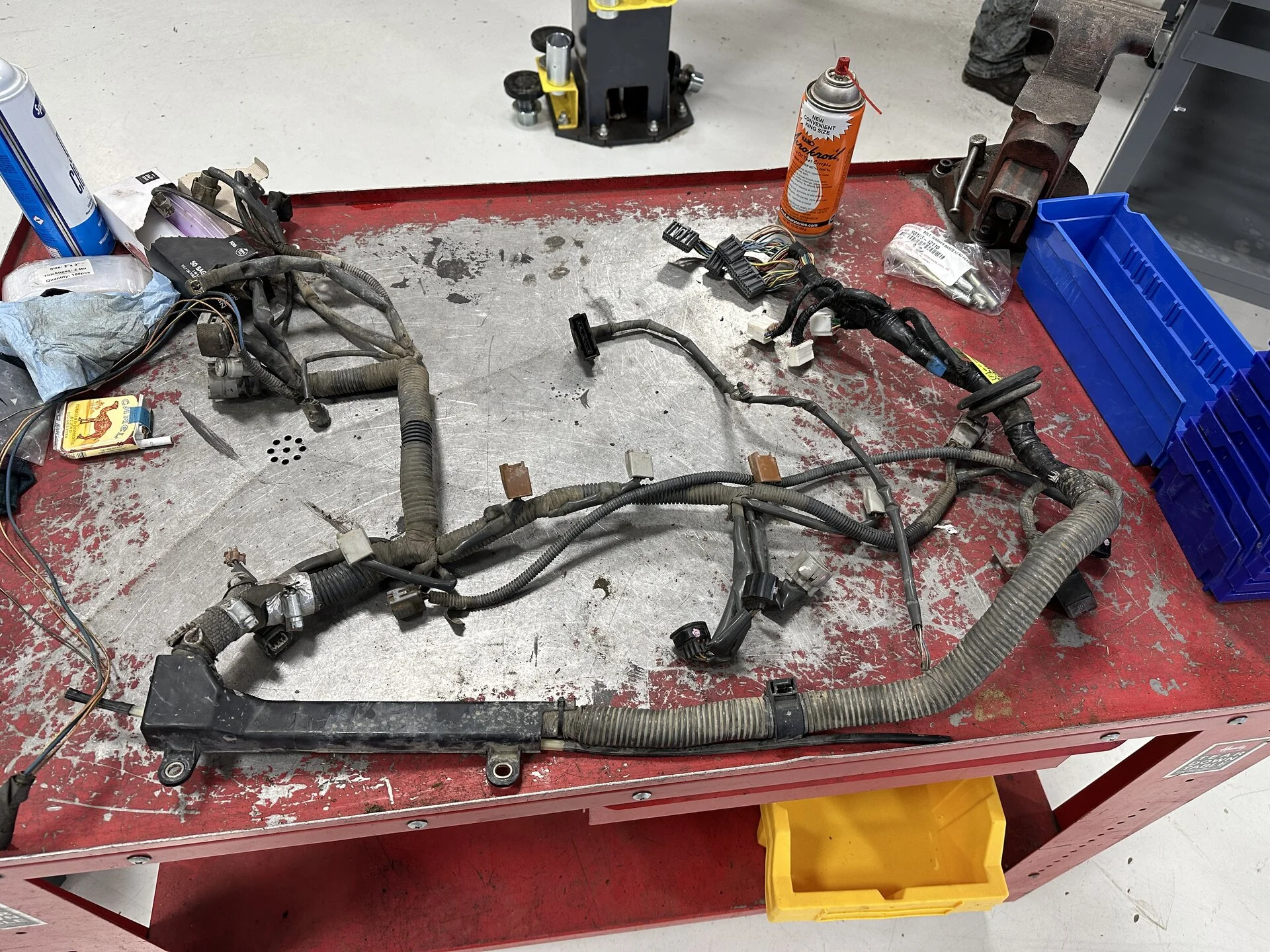

The harness came out great. We only reused 4 connectors total.
We used factory wire supplier Yazaki for the whole rebuild. They sell wire in large bundles. But it’s all out of Japan and one has to do the translational legwork to get it all jimmey’ed correctly.
Toyota service parts splices (82998-Xxxxx) are Yazaki as well and we utilized a lot of these PNs for the rebuild.
Injector splices are gold plated internally and ergo expensive as fűck.
Everything was soldered, wire-by-wire. Every wire was inspected from end-to-end.
I believe we had about 55 man hrs into the harness rebuild: not including removal, cleaning, disassembly, and research hours for ordering parts, etc.
