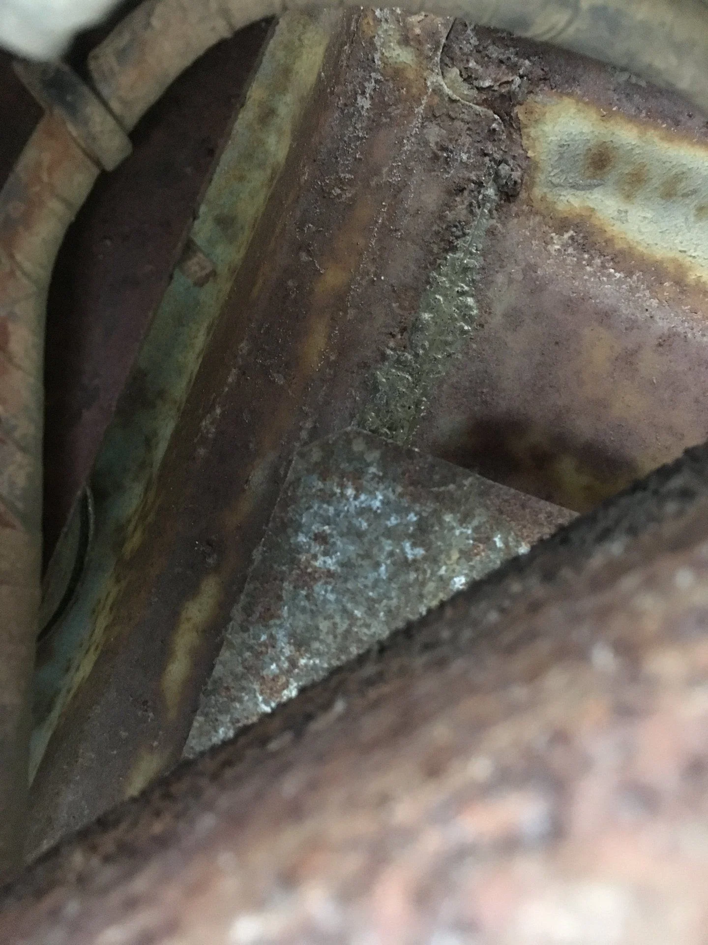

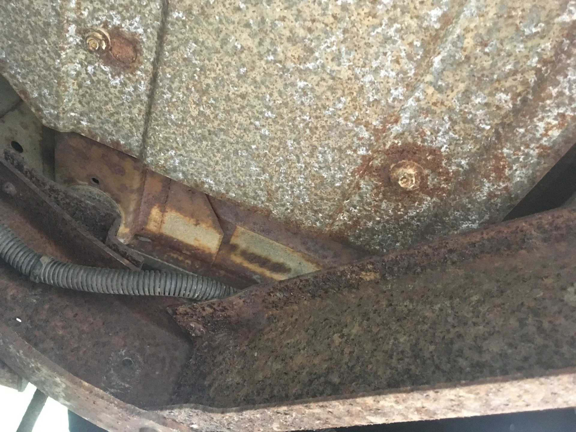

I guess I wrestle with patching one area on a panel knowing that there's hundreds of small areas of surface rust happening and who knows what in the seams. Hey, don't get me wrong, I'm not looking for a museum piece, but I would like it to stop the rapid decline. Here are a few images of the corner rear bed/ rear sill from below. Plus rear bed near gas tank.

I guess I wrestle with patching one area on a panel knowing that there's hundreds of small areas of surface rust happening and who knows what in the seams. Hey, don't get me wrong, I'm not looking for a museum piece, but I would like it to stop the rapid decline. Here are a few images of the corner rear bed/ rear sill from below. Plus rear bed near gas tank.View attachment 1408002View attachment 1408003 View attachment 1408004
I edited my above post FYI. I agree seams are a major concern. U could remove tub, and take it all apart drilling out the spot welds, clean up the pieces individually, treat and reassemble as another option.
