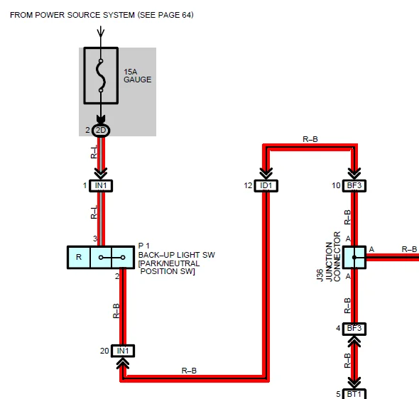

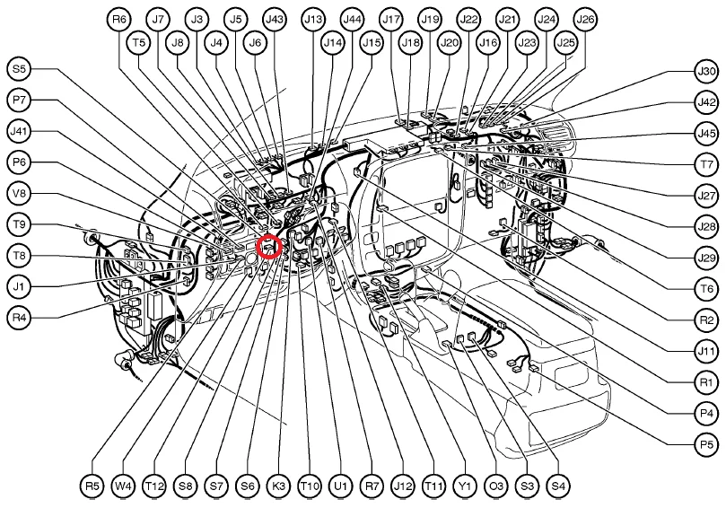

The easiest location for the reverse light seems to be the IN1 junction connector behind the glove box. See page 126 of the EWD which @Malleus posted in the resources. Look for the red wire with black stripe.
