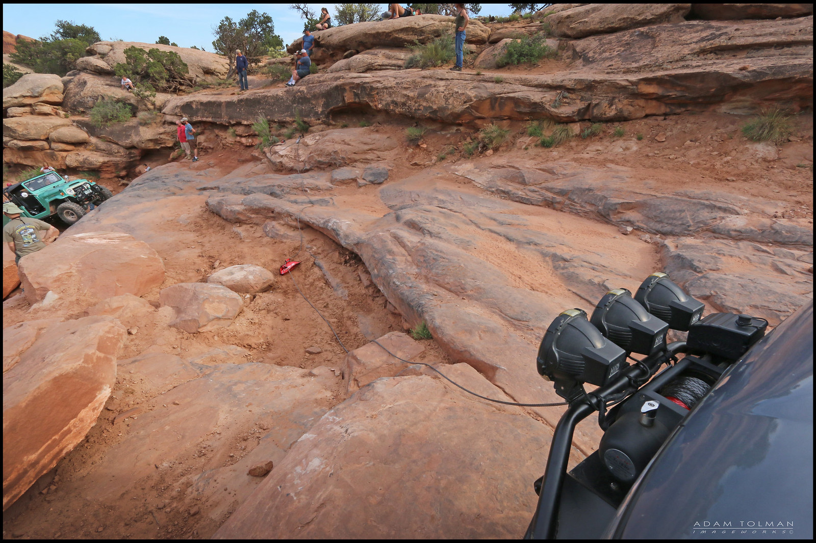

Winch Brand: ComeUp
Winch Model: Seal Gen2 9.5rs (Synthetic Rope)
Rated Capacity: 9500
Years Owned: 10
Number of times used: Dozens
IMG_2218 by Adam Tolman, on Flickr
Worst Case: Winched 17 different rigs up the waterfall on GoldBarRim in Moab during Cruise Moab. Wasn't a particularly difficult pull but the challege was with the time involved and number of rigs that needed winching, one after another without much time between.
Common Scenario: Only used for self recovery a couple times but winched dozens of other rigs most often from MUD or Snow.
Zero Failures, Zero repairs. This winch was used on my Tacoma for a few years, then my 80 for several years, and is now on my son's minitruck.

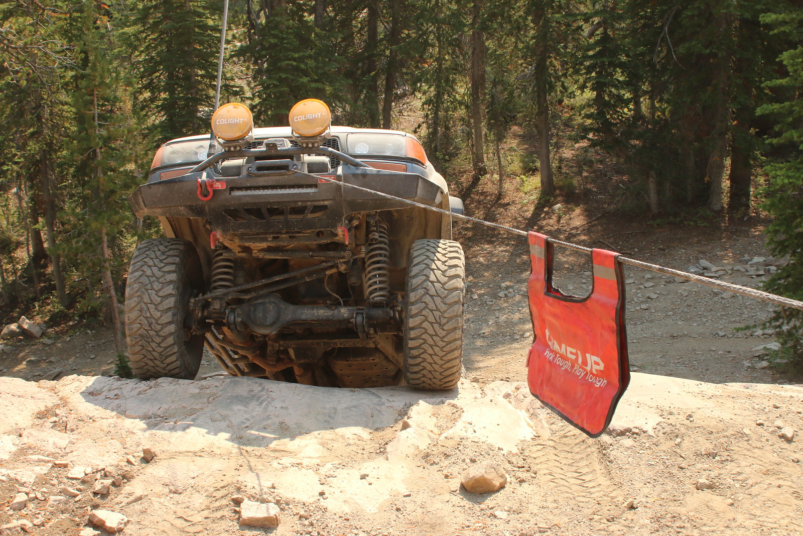

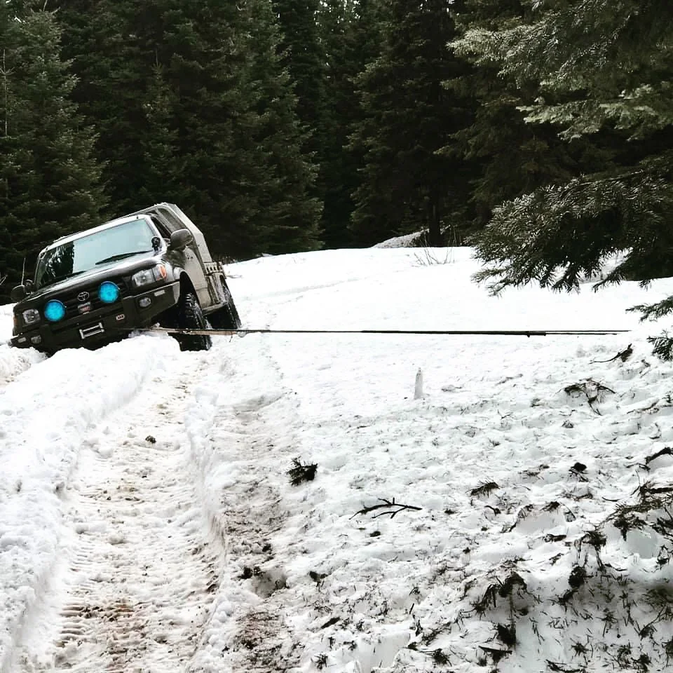

Winch Brand: ComeUp
Winch Model: Solo 12.5rs
Rated Capacity: 12,500lbs
Years Owned: 4
Number of times used: 3-4
IMG_7031 by Adam Tolman, on Flickr
Worst Case: Hasn't been used heavily yet but most difficult so far was multiple full line pulls through deep snow across a mountain meadow. Again, the pull itself wasn't difficult but the repeated used over about 30 minutes was a good workout.
Common Scenario: Most often used for minor recoveries to get through a trail obstacle.
Zero Failures, Zero repairs. This is currently on my 80 and replaced my old ComeUp Seal Gen2 9.5rs mentioned above.
