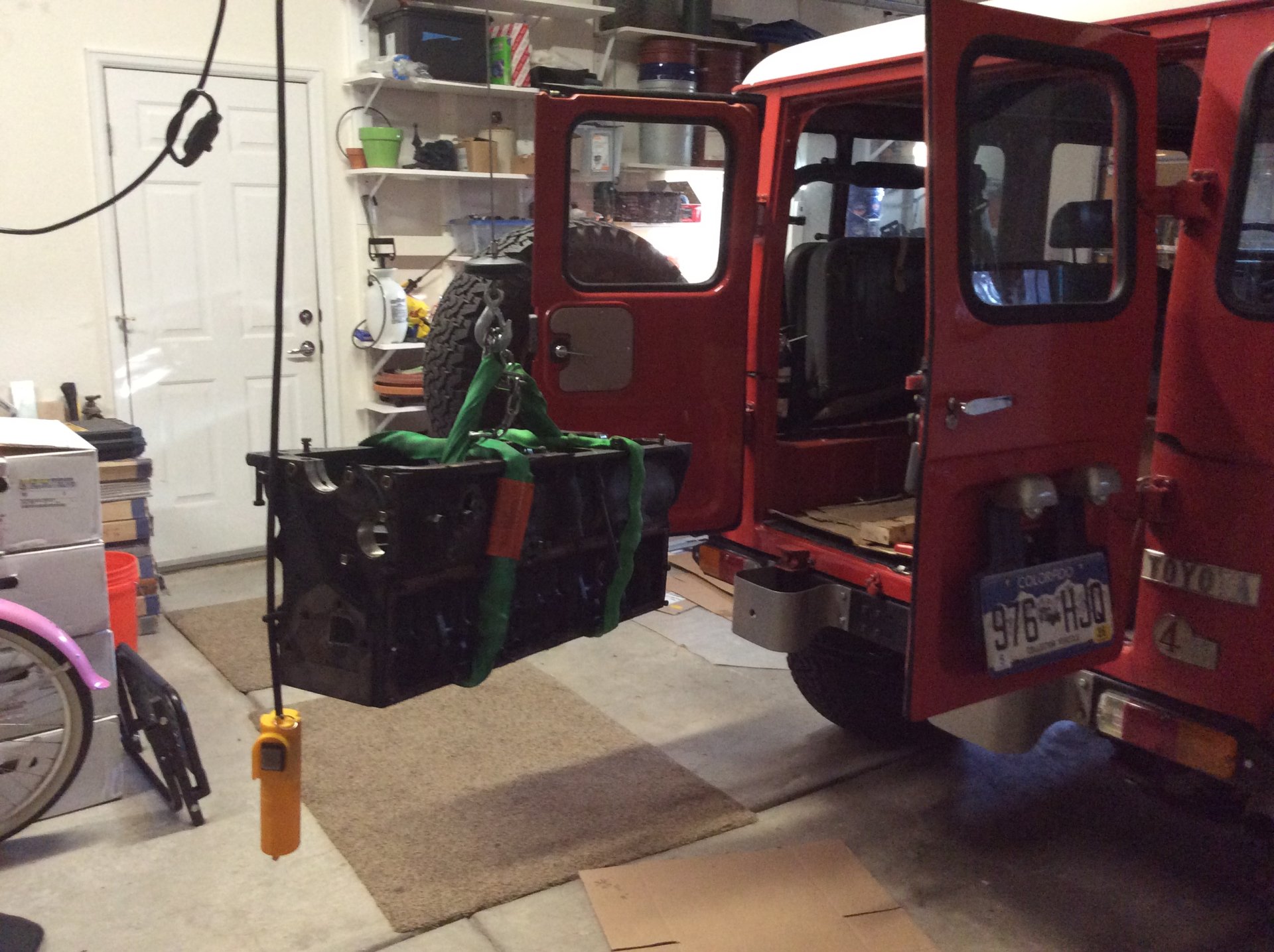

Did a quick video on the Harbor Freight 2 ton engine hoist aka cherry picker. It is not perfect, but will work fine for what I need. A couple of flaws here and there. And it measured out just right so that I can lift the engine out from the side of the truck. At least the short block. Not sure if it has enough lift height to get the entire long block out in one piece, but I'll do some measuring when I put it to work to find out.
Very neat setup! I love all the pulley action to get it to work with a single winch.
Swivelling pulleys would have made life a lot easier, but I didn't have access to them at the time and (as is tradition) wanted everything "finished yesterday."
Before you freak out, I’ll tell you that I have attic access above my garage and each anchor for the unistrut is mounted to a 4”x4”x6’ fence post laying across 3 ceiling joists with a length of 5/8 all thread passing through it and a metal plate secured with nylock nuts to spread out the load.
Nice!! If I had attic access above mine I would have given it a go with additional bracing. Love your setup!
