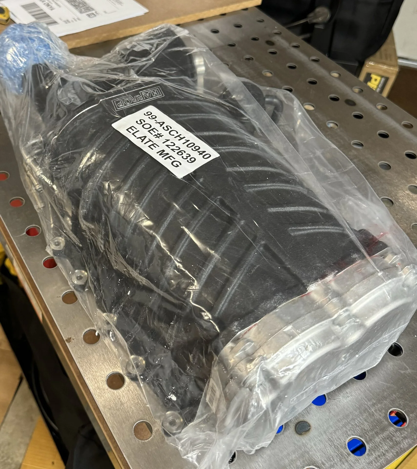

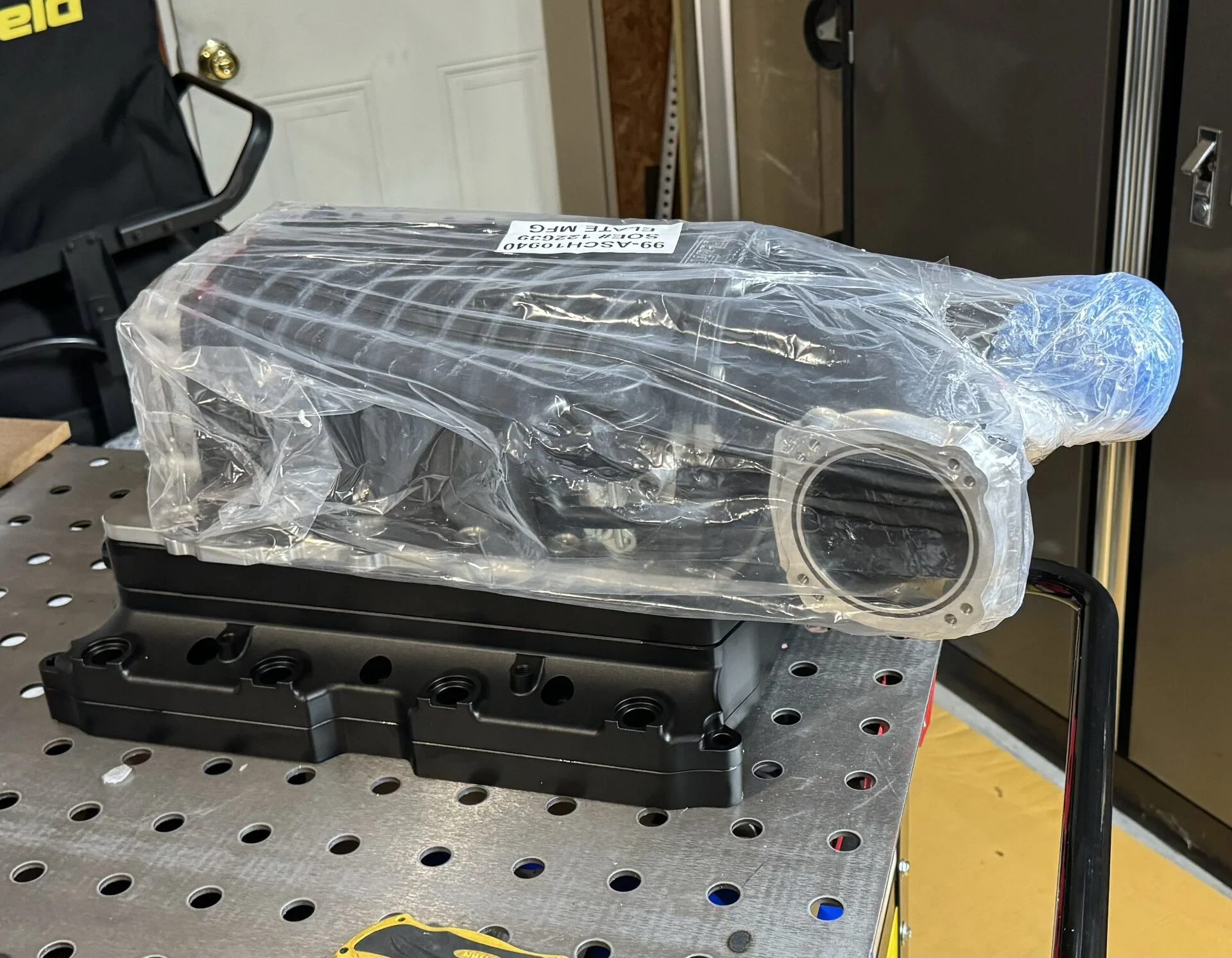

Today all but two parts have come it. Have enough to get well started into my project. I am sure more stuff will be needed as I get into it.

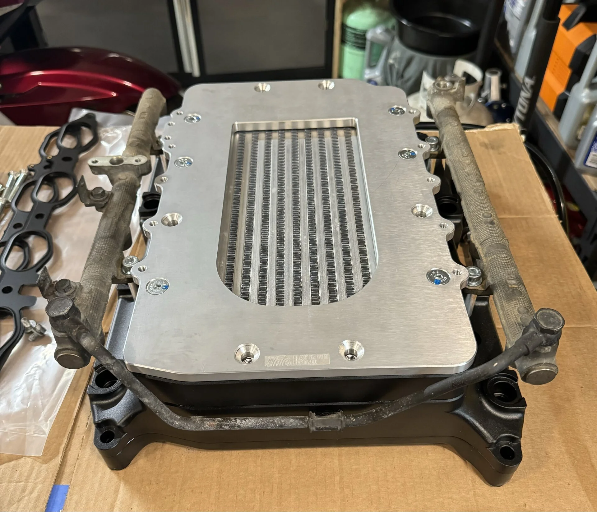

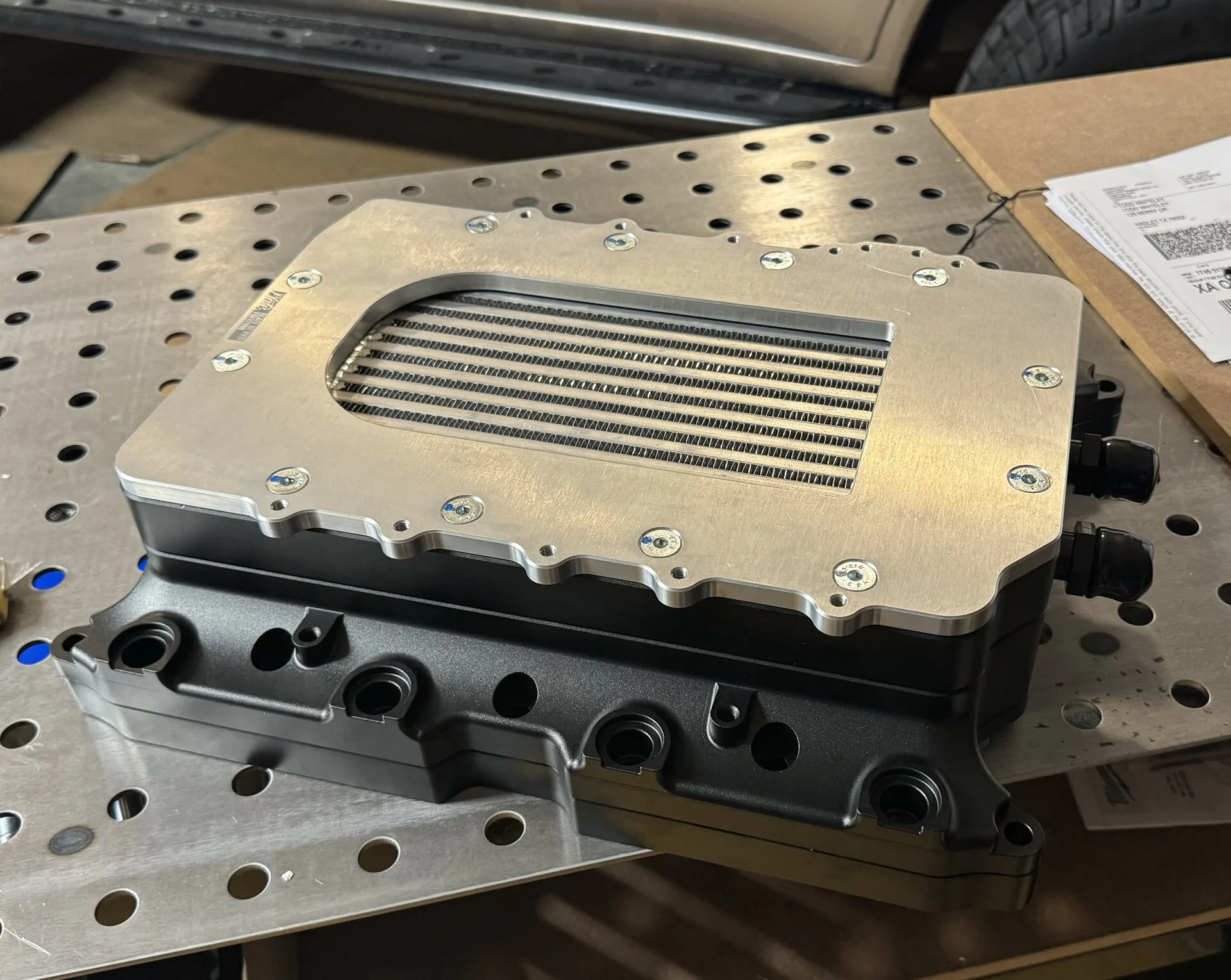

I opted for the thicker of the two intercooler cores. Since I don’t have VVtI and air pipes under my intake I can do this without having to raise the intake as I understand it.

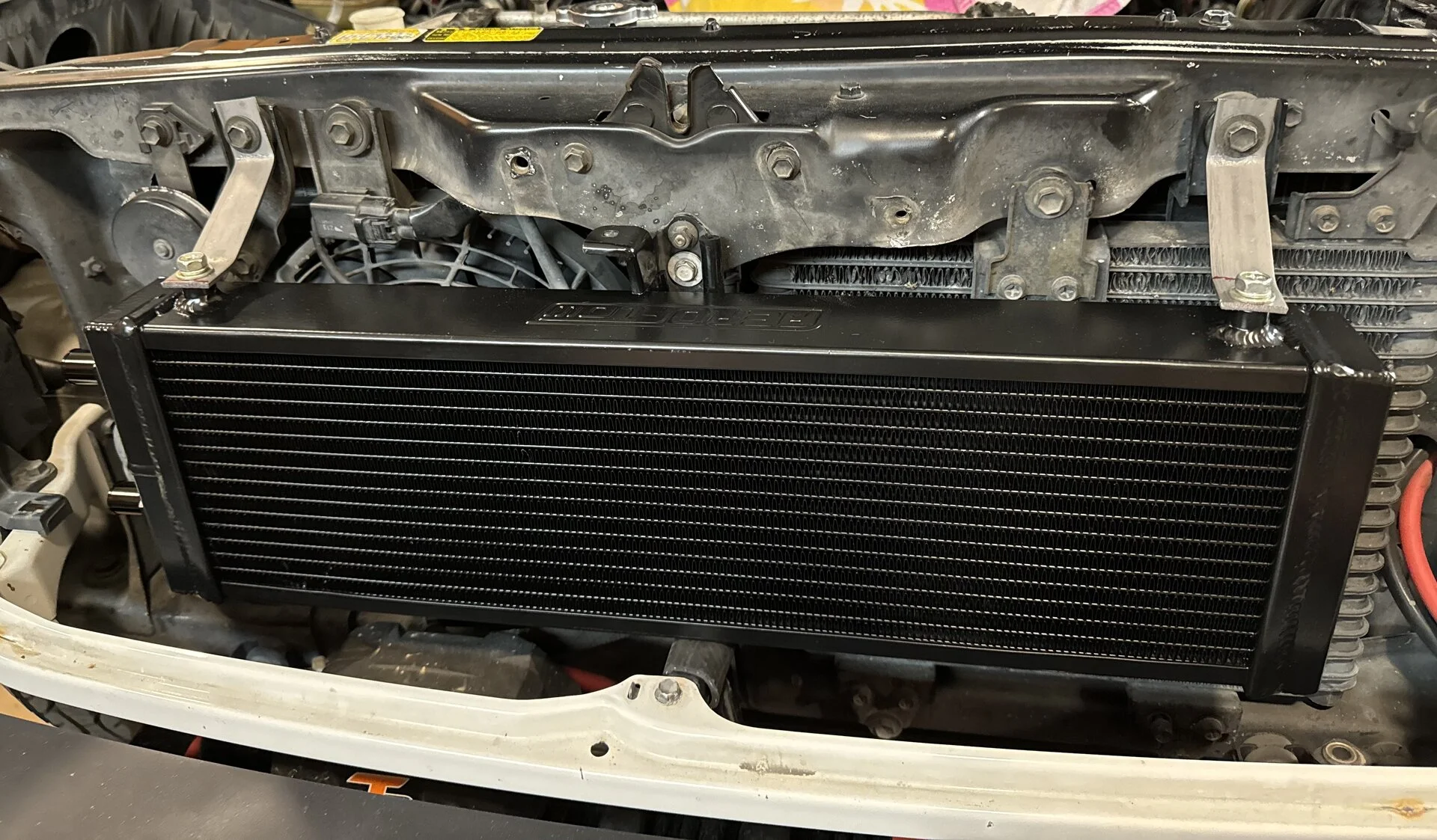

The heat exchanger is here too.. that mounts in front of the radiator / behind the grille.

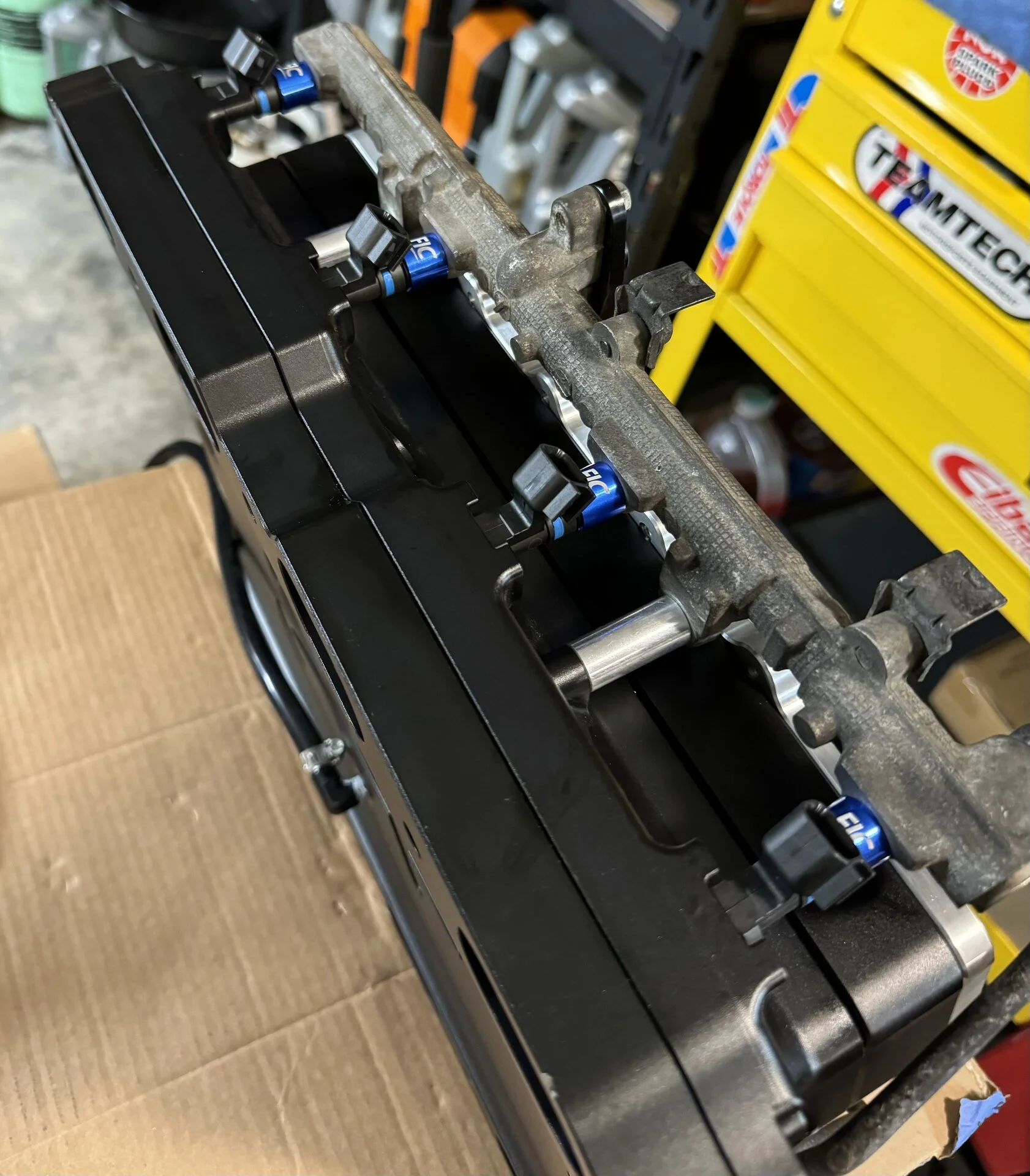

I bought an adjustable regulator with the plan to remove the OEM regulator and replaced with a fitting rail to AN-6 hose. Have all new hose to make hose with swivel fittings. Then an-4 to metal return line to tank, from regulator.

I opted for the thicker intercooler since we are in Texas heat during the summers. Bought new FIC injectors matched flowed 377 cc ish at 3 bar , 43 psi is the spec sheet. Planning to target 7.5 ish boost with one of two optional pulleys at 600-700 MSL.

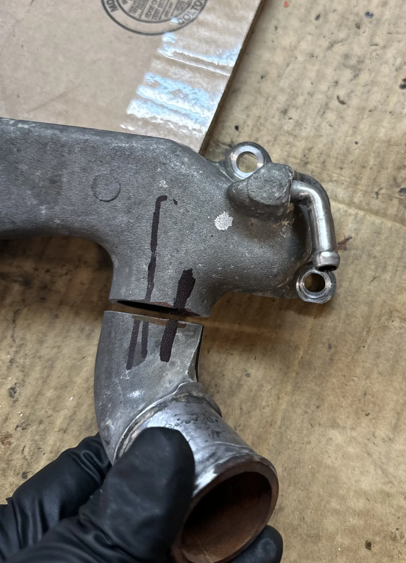

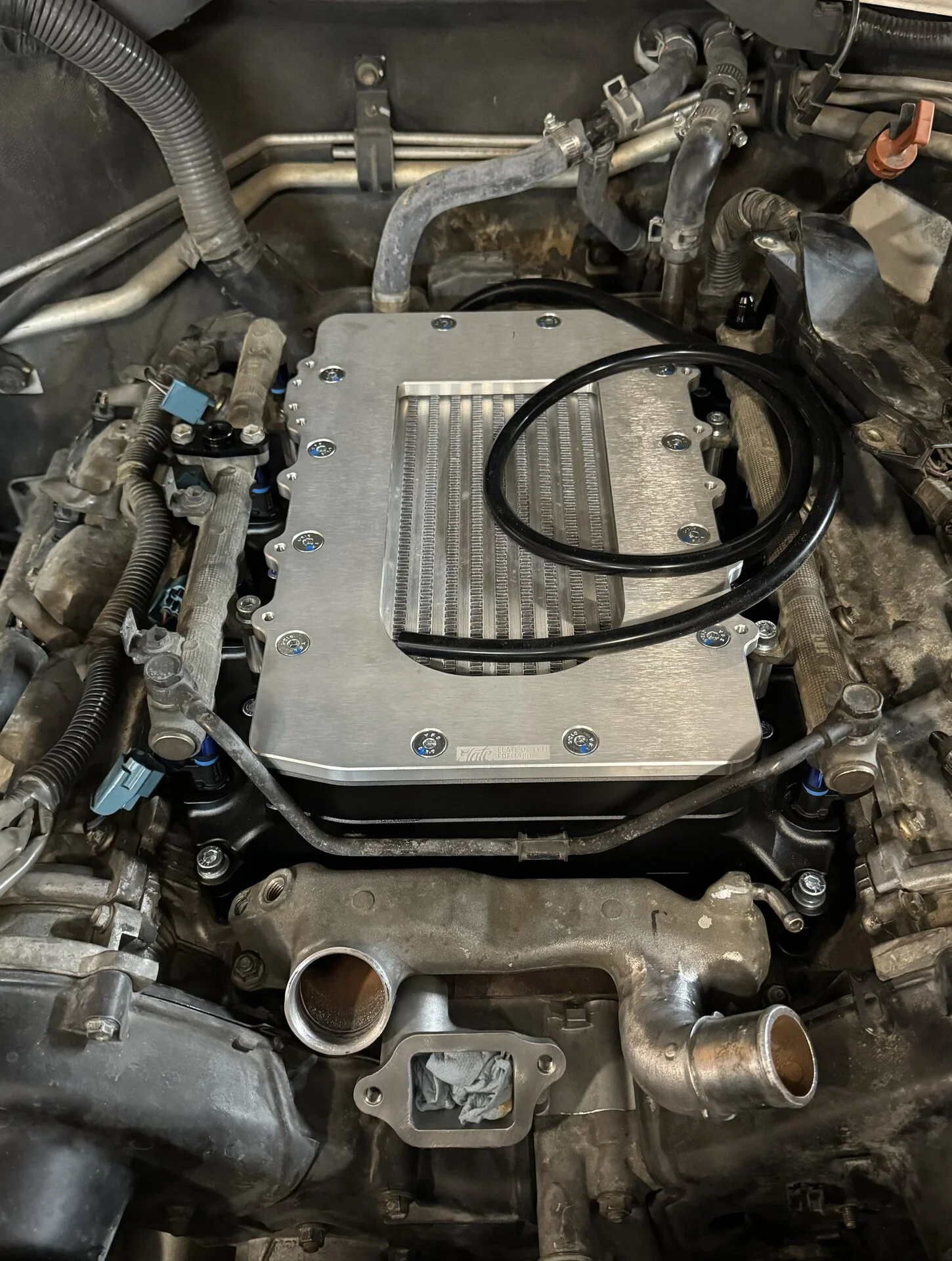

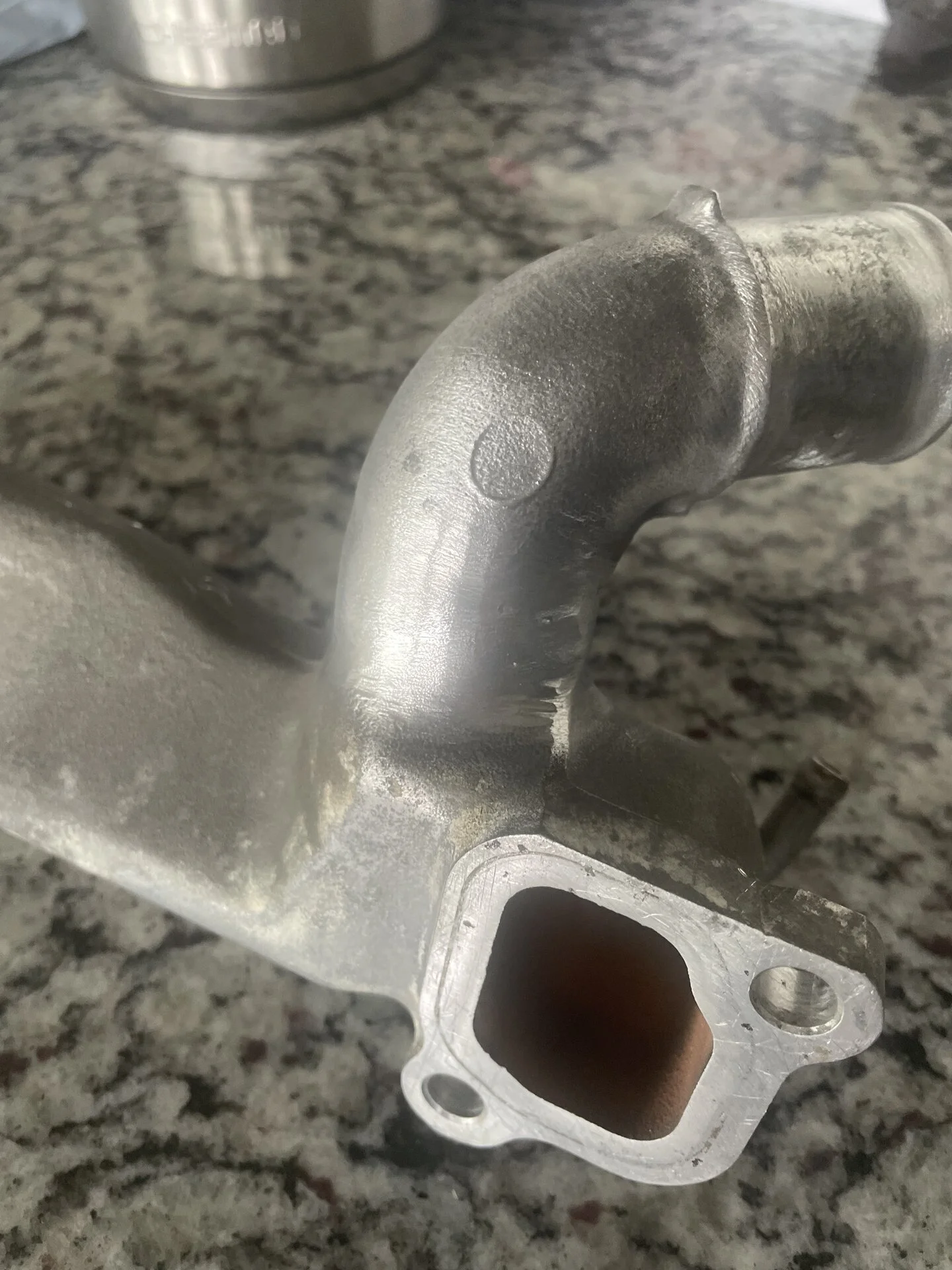

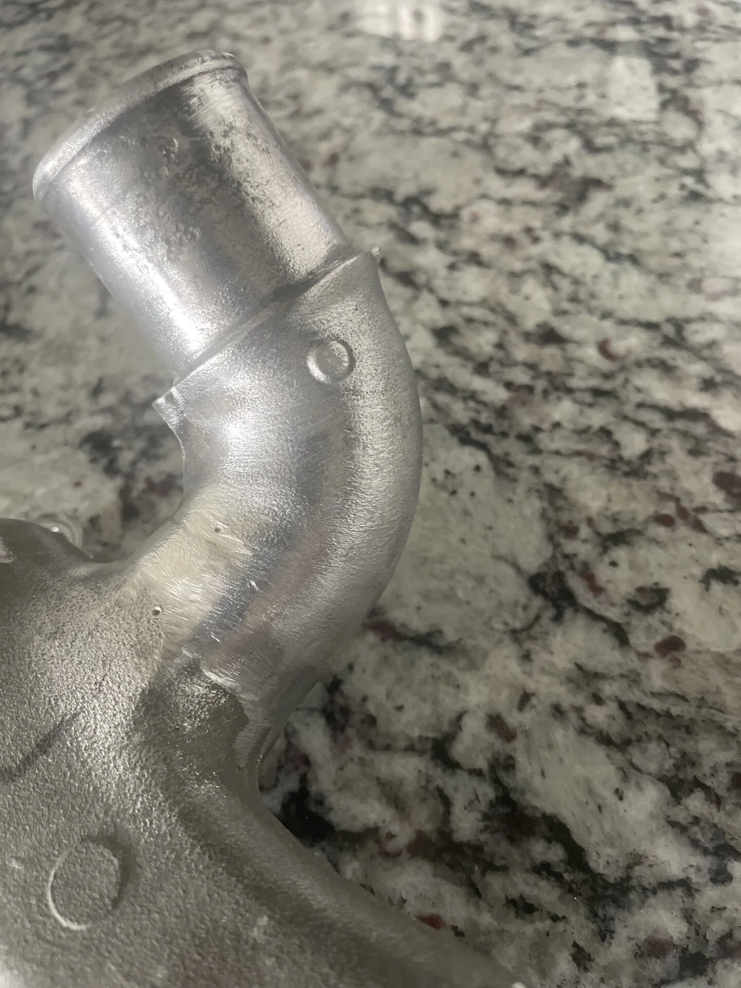

Today drained the coolant, removed the intake, and water neck cross over.
The cross over water neck requires 80 mm removed and welded back together.

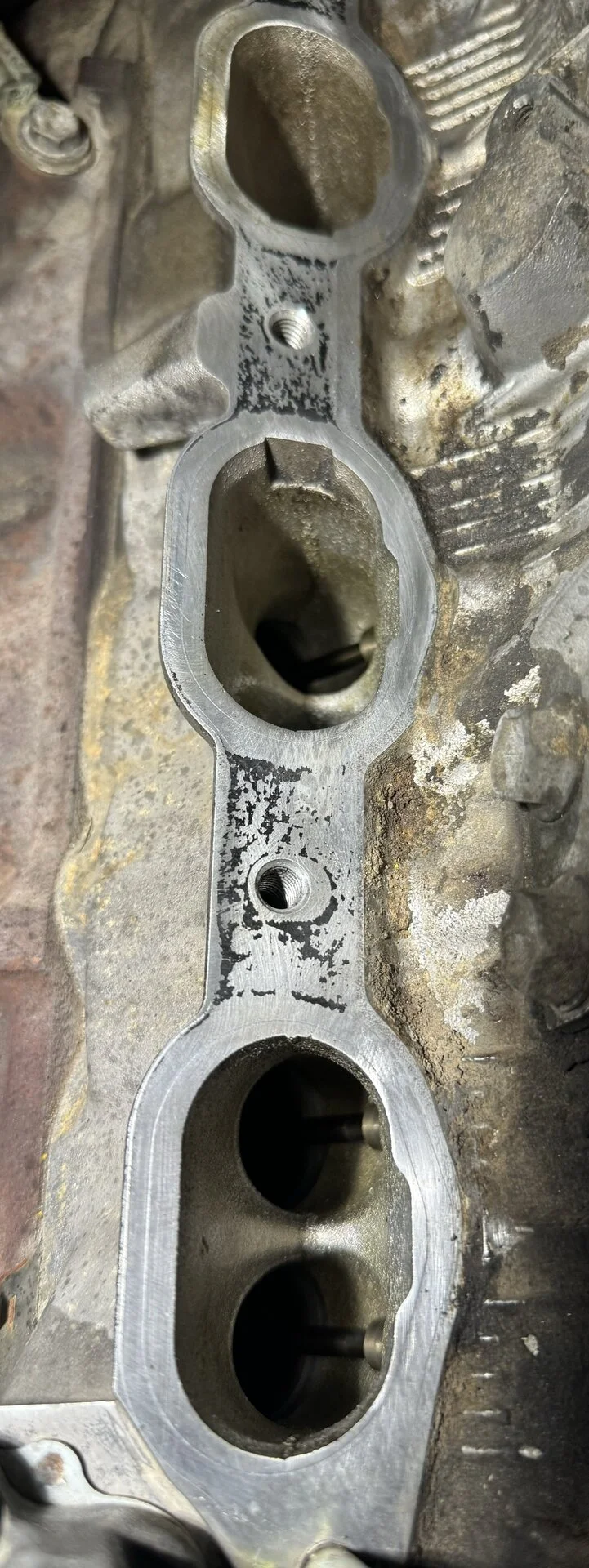

Got the water next cross over cutt and surprising how clean the intake ports, and valves are exceptionally clean for "1995" correction 1999 year 390k original miles. Valves seals replaced at 379000 miles.

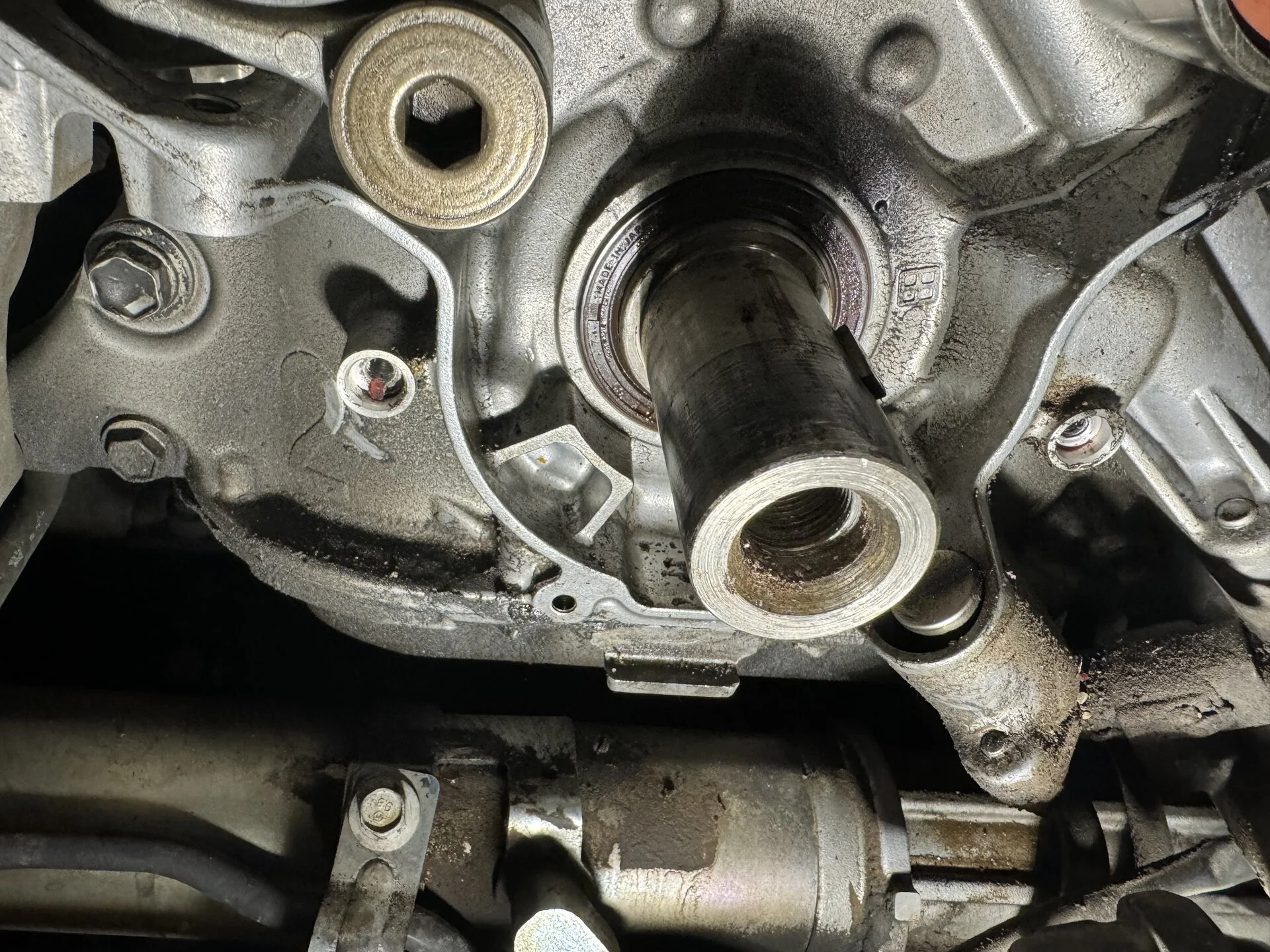

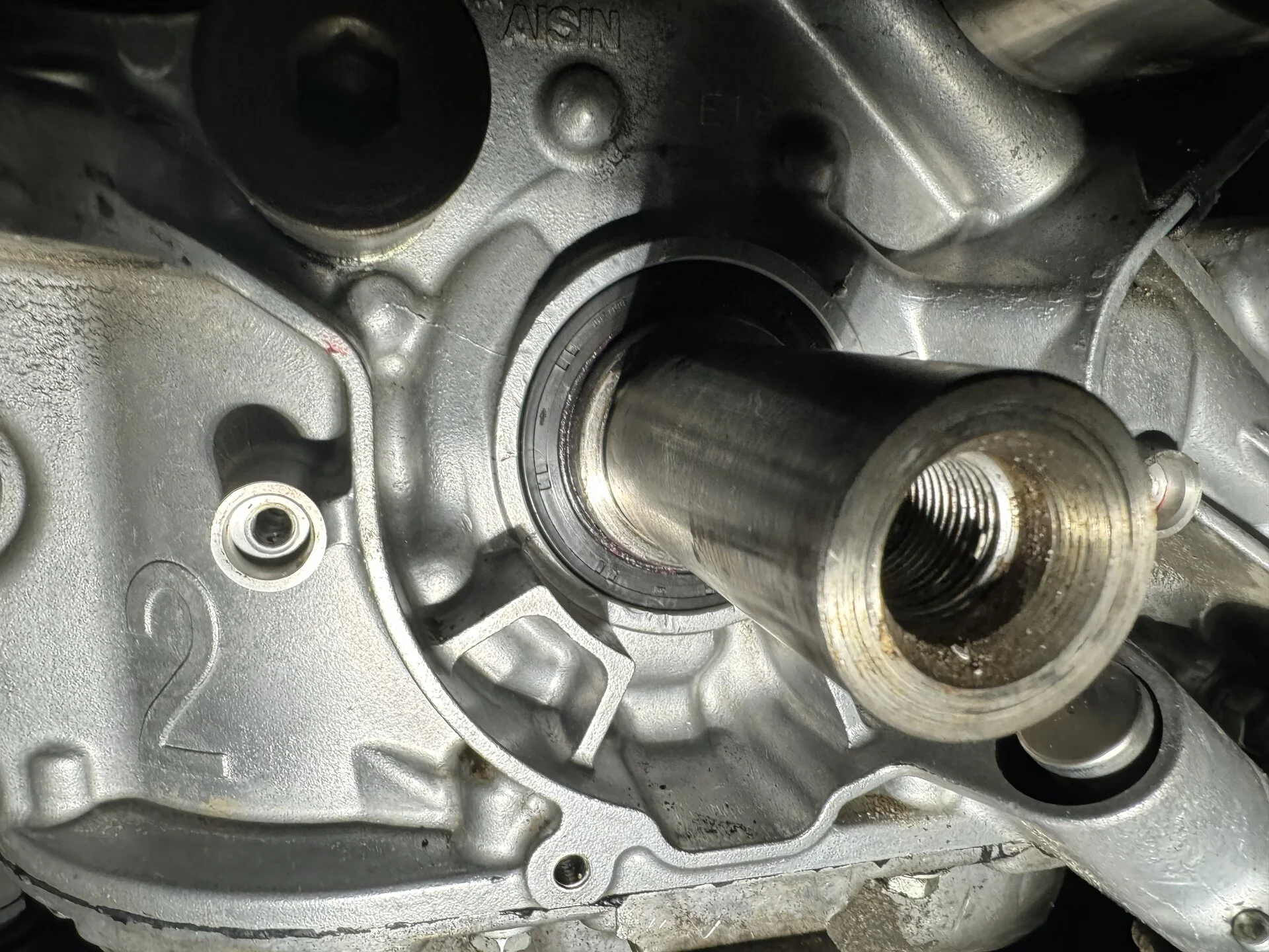

Ok, intake water neck modification completed. Decided to go ahead and remove timing belt and lower crank pulley. Light seep of oil accumulated around the front after 12,000 miles. Not to the point of oil drip on the floor.
Replaced Asin seals from oil seal kit, when I changed this oil pump and Oring in the front of the engine 12,000 miles ago.
Went OEM seal this go around. Oem yota pump did not come with a seal or oil pump screen gasket. Hopefully, this will cure it.
This is back together now and moving forward.
Now to the SC install… make sure and bolt the water neck 1st before the intake itself, one nut is not accessible once intake is installed. I saw this and didn’t fall into the trap.

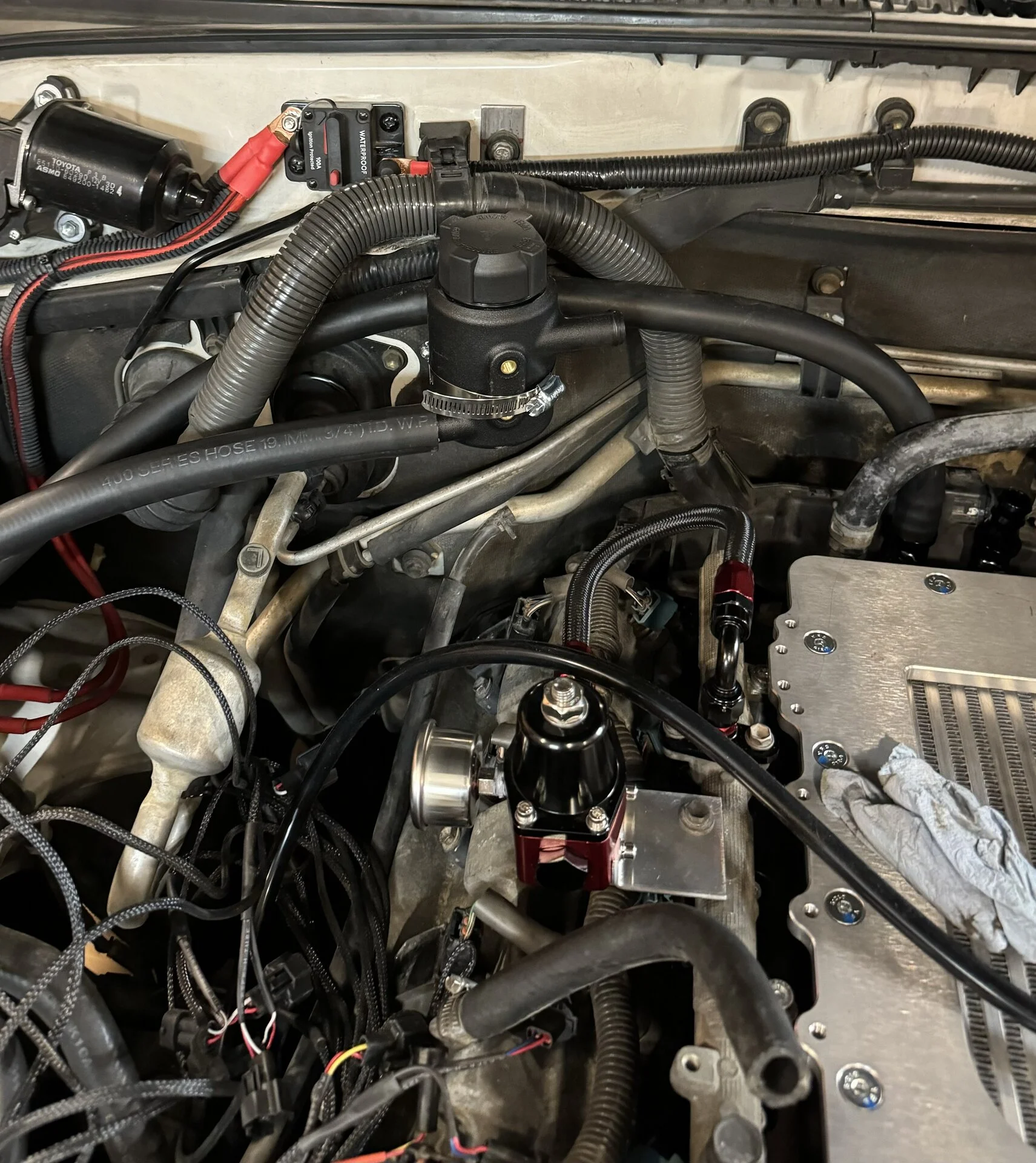

Fuel lines made, and fuel pressure regulator installed. Fuel pressure adjusted prelim to 3 bar / 43 psi… and leaked checked good.
Water lines to the intercooler next.

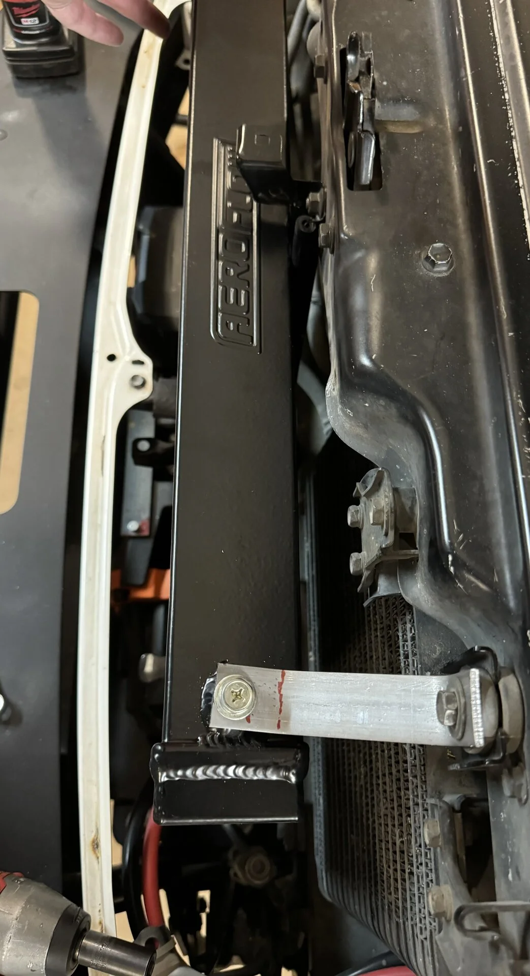

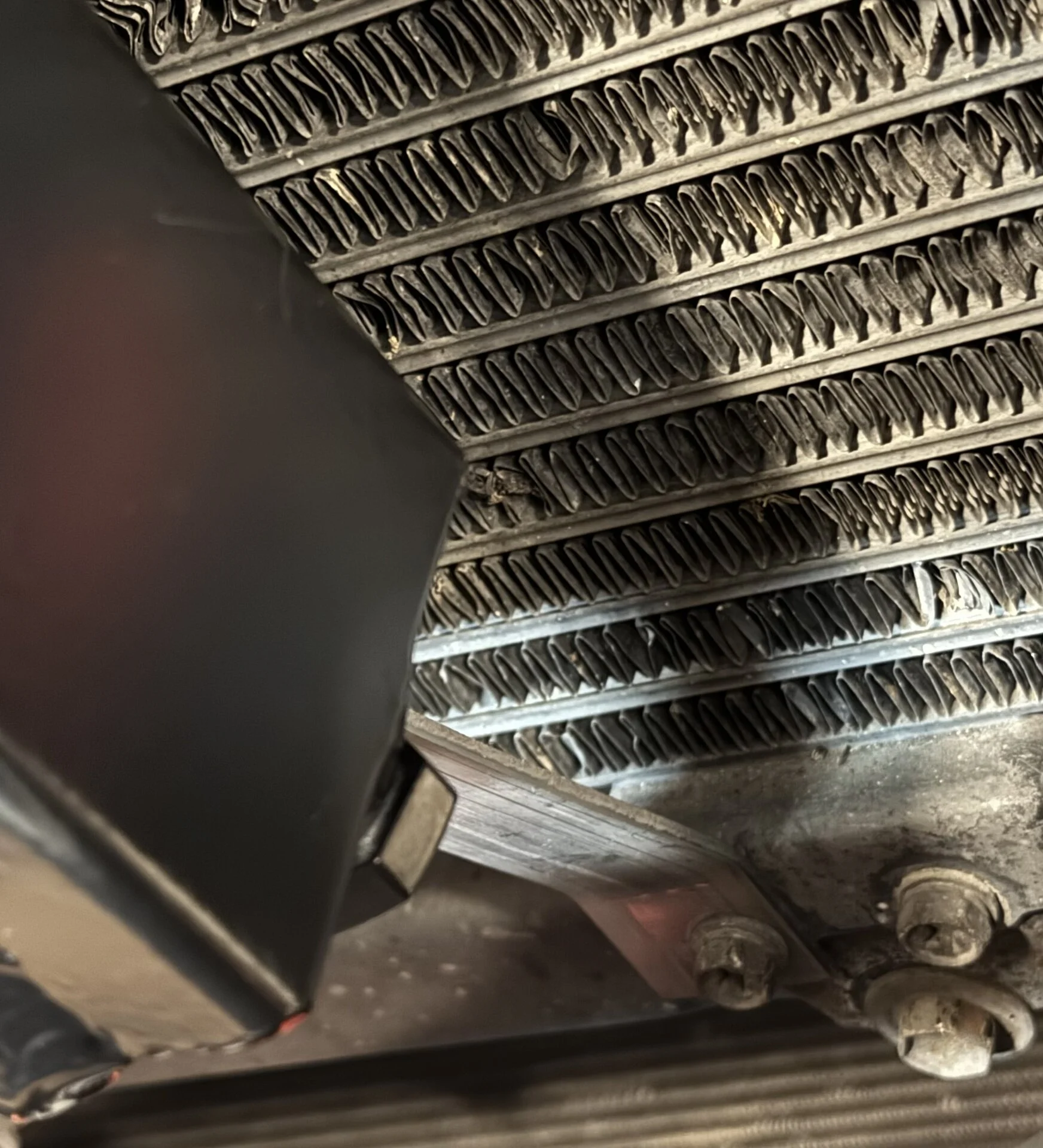

Next mount the intercooler / heat exchanger. Hum compromise time, hi to allow air flow through, behind grille. So modified the center brace to upper core support / hood latch to allow the core to have a resting place on the bottom on a rubber mount pad. And lean back against the upper support bracket with rubber channel to not chaff the heat exchanger. Bend and make brackets to hold imposition.
Uppers done core doesn’t move on top.
Lowers to go to brace the bottom.

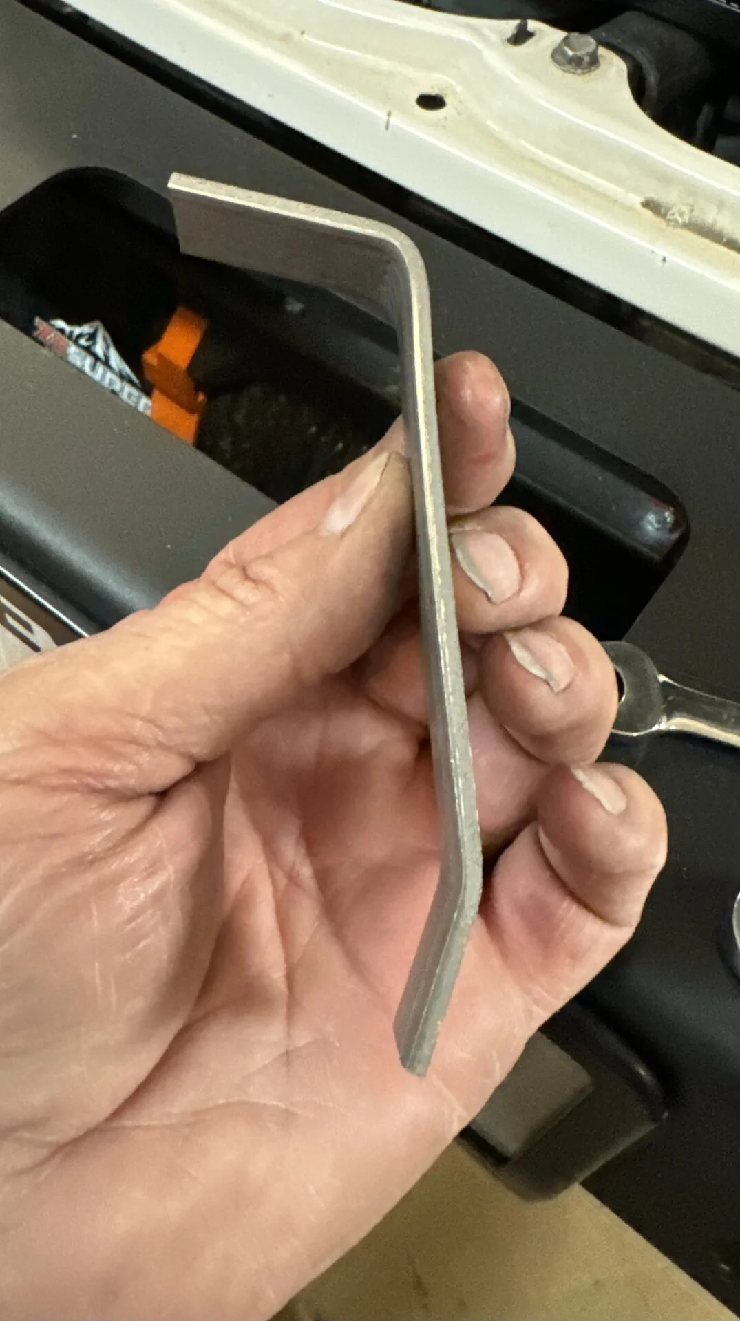

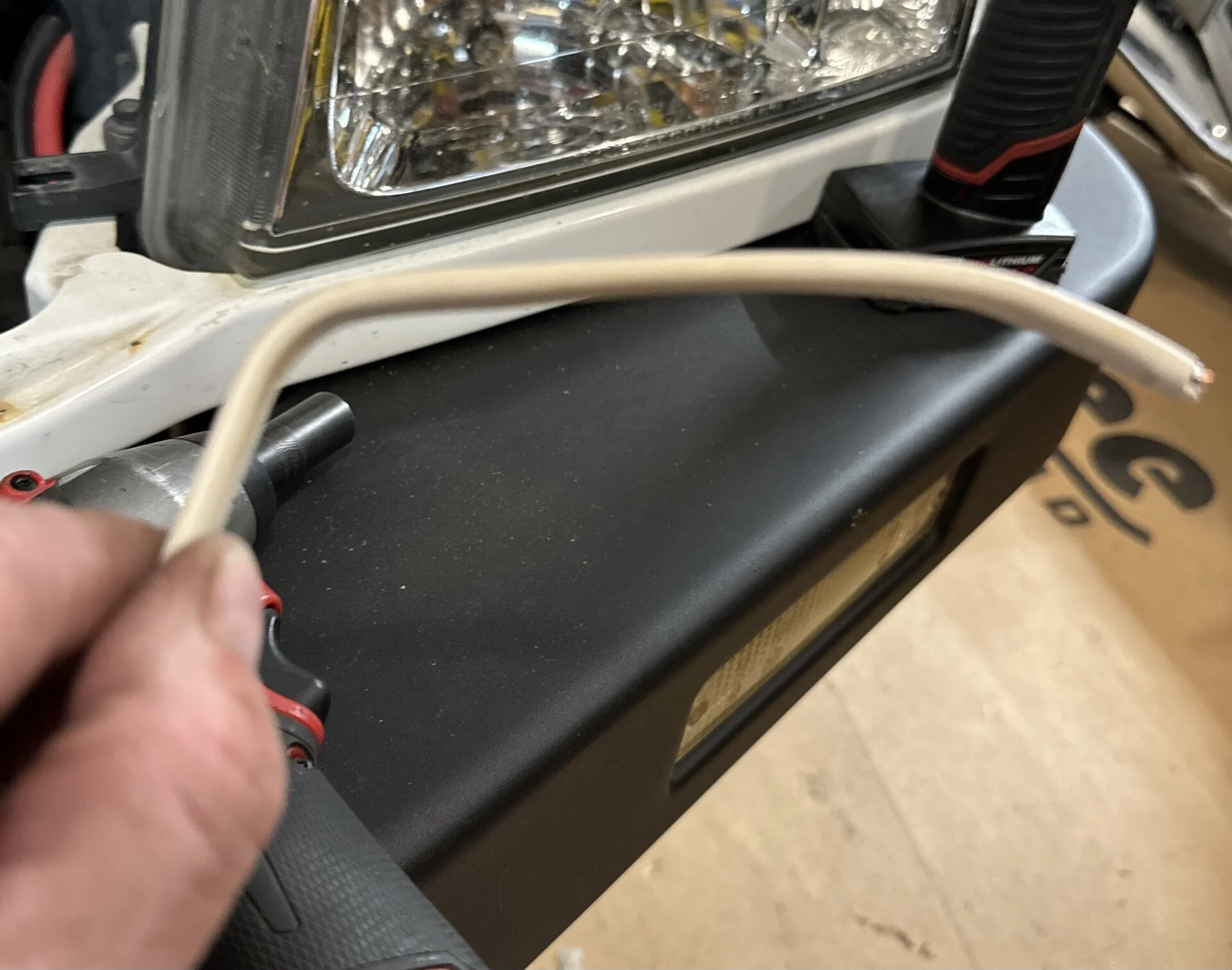

Bottom right bracket made, just an FYI my blueprint tool used to find the angles and lengths
Simple romex wire same thickness as my metal.
Last bracket fit like it was made for it
