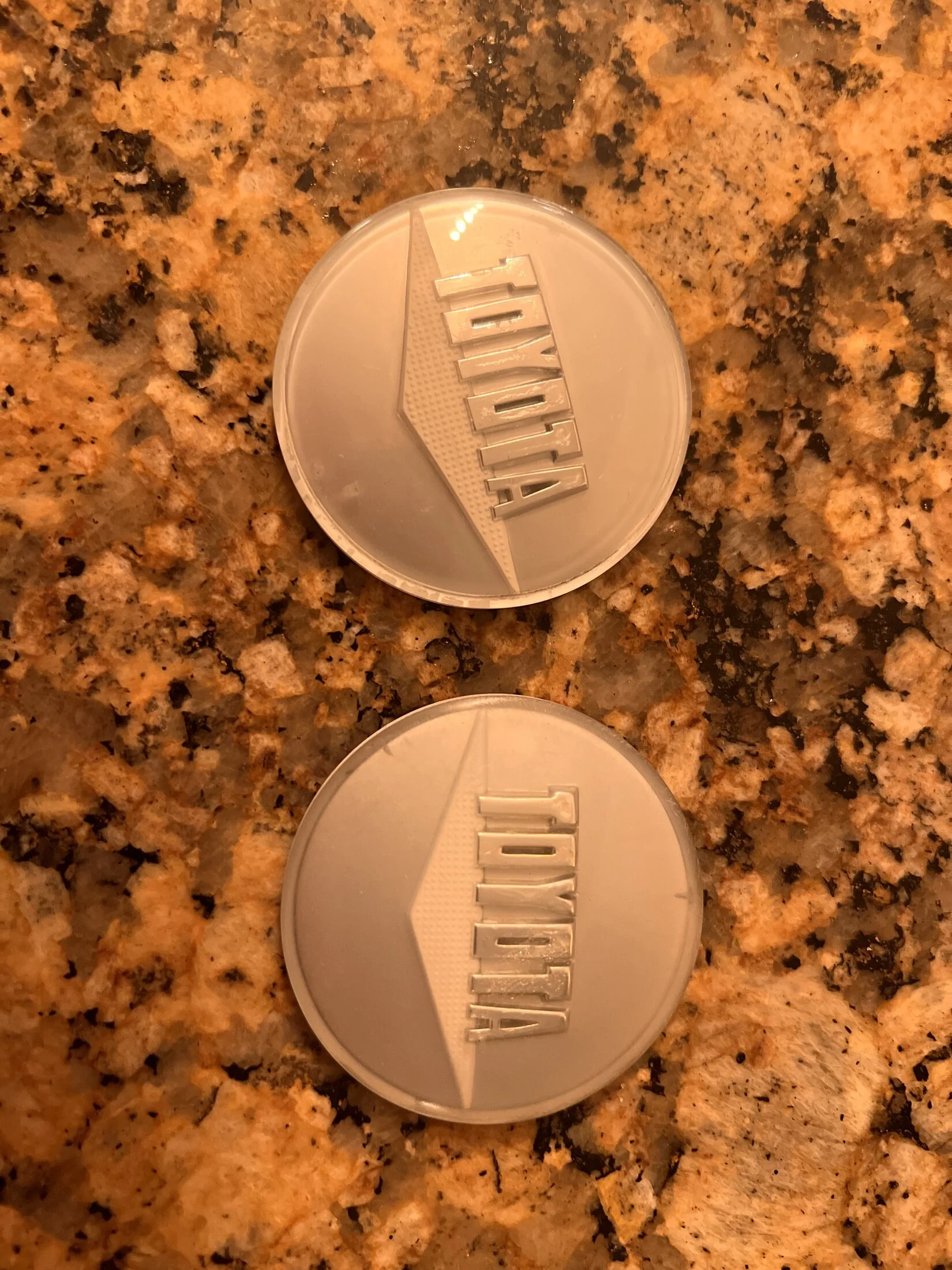

I am getting ready to have my guy restore some of the early TOYOTA steering wheel pieces. If you have one that is crazed scratched whatever, as long as it is one piece it can look brand new. If you’re interested contact me asap. It will be yours, original and look factory new.
Jimmy 918-693-9208
PS : he’s busy quite a bit so if this is something you’re planning on doing, i would recommend it now.
Jimmy 918-693-9208
