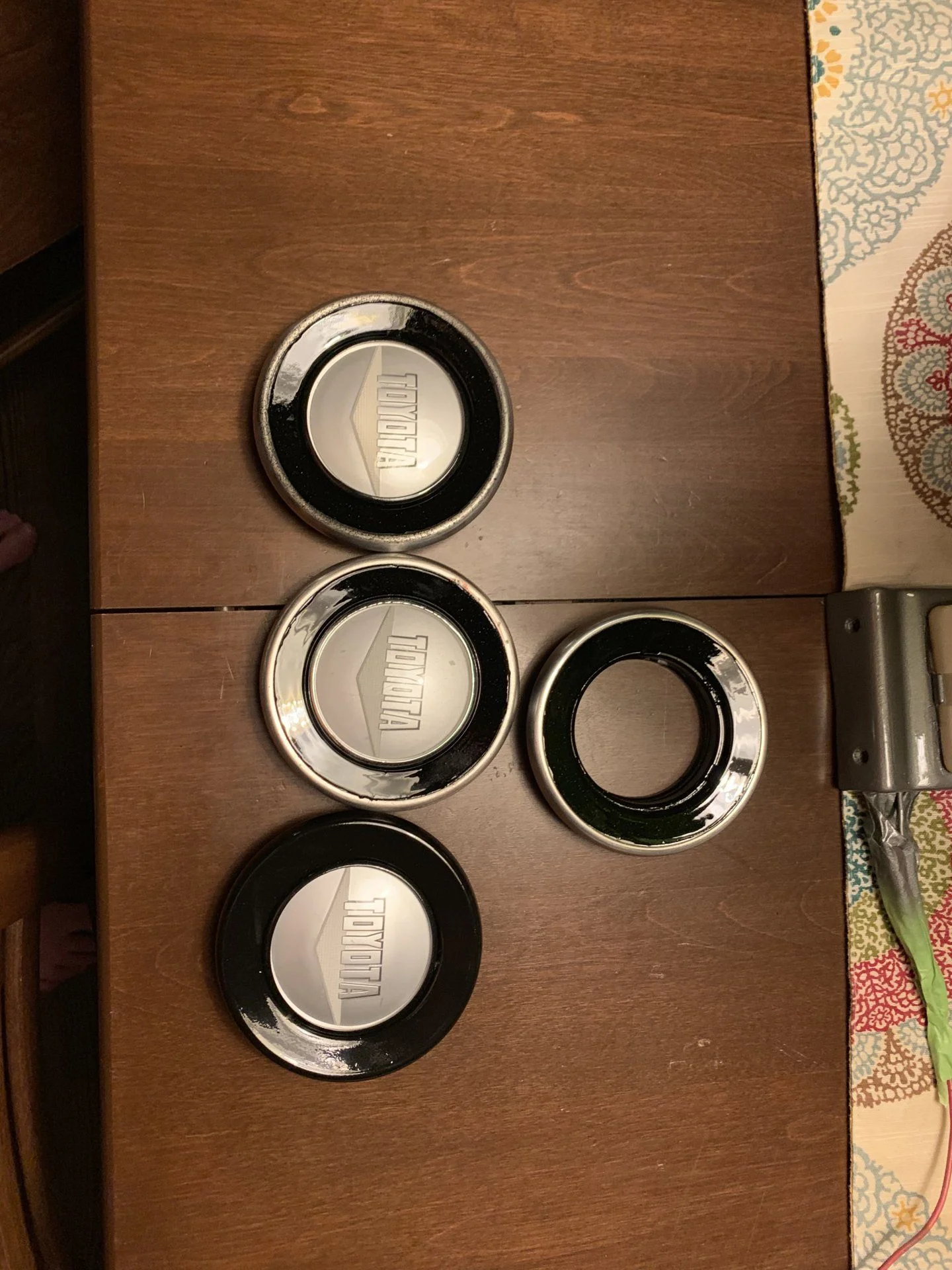

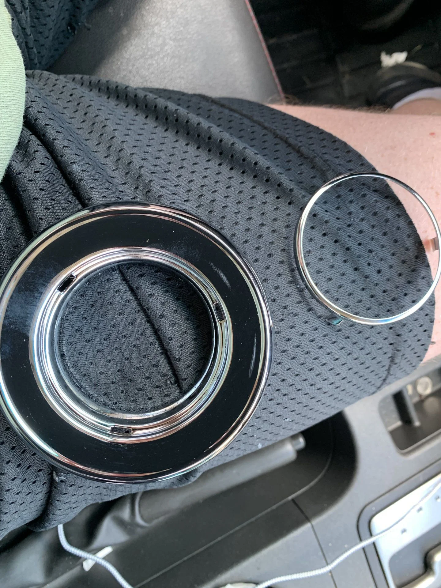

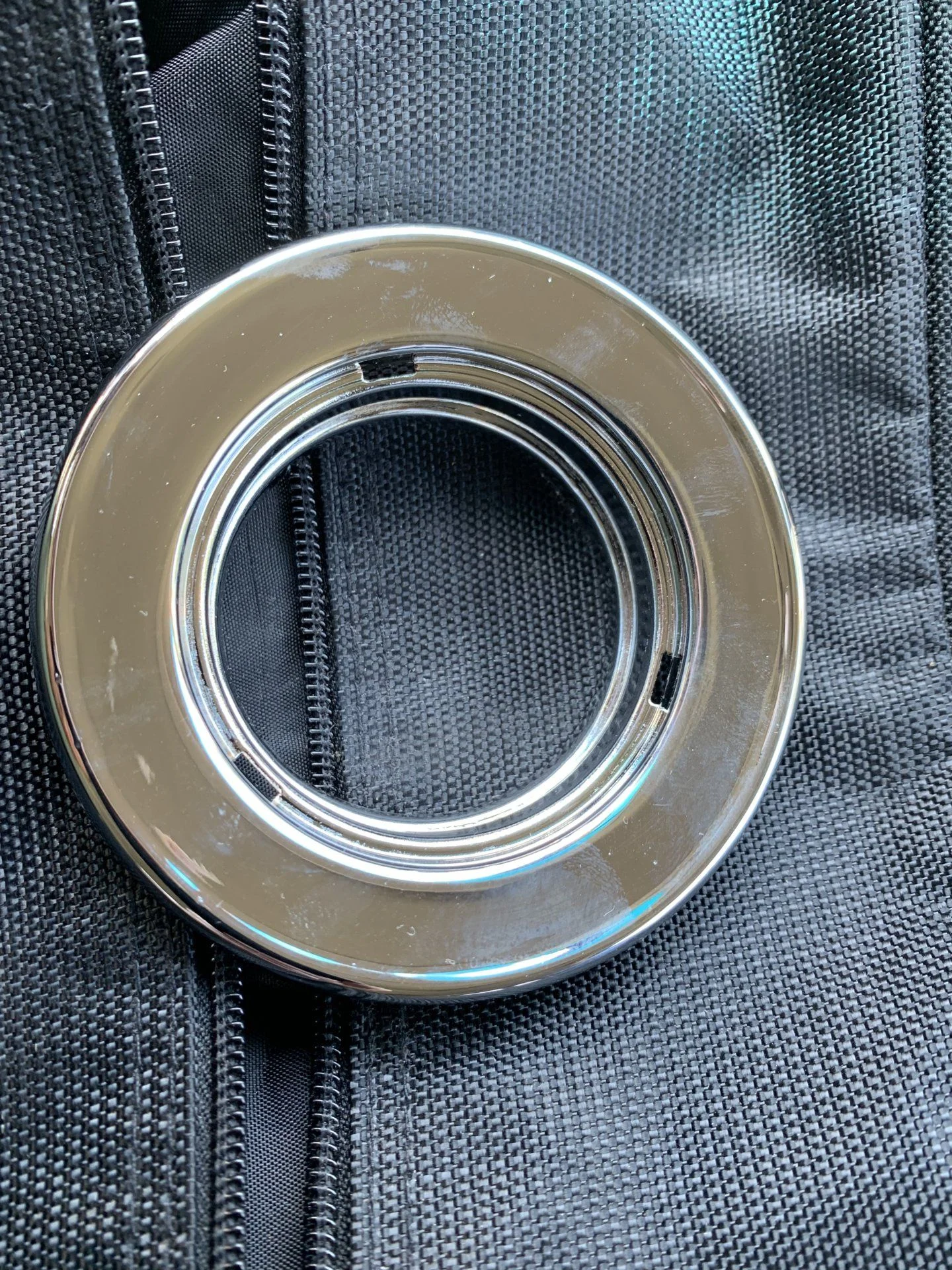

I can now rechrome early FJ horn buttons.
Better pic
75$ plus the ride

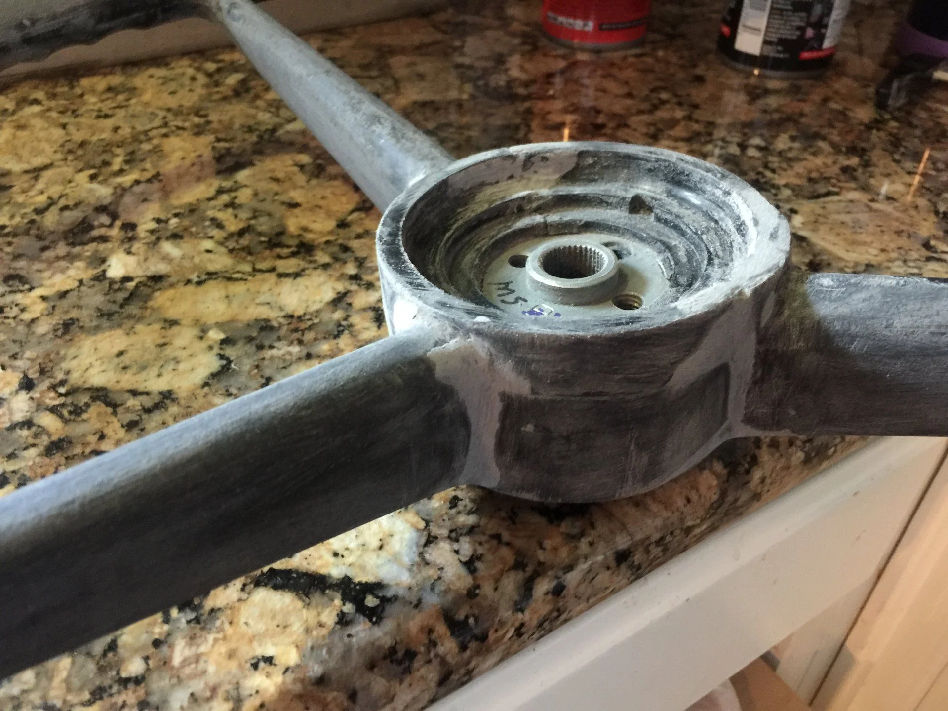

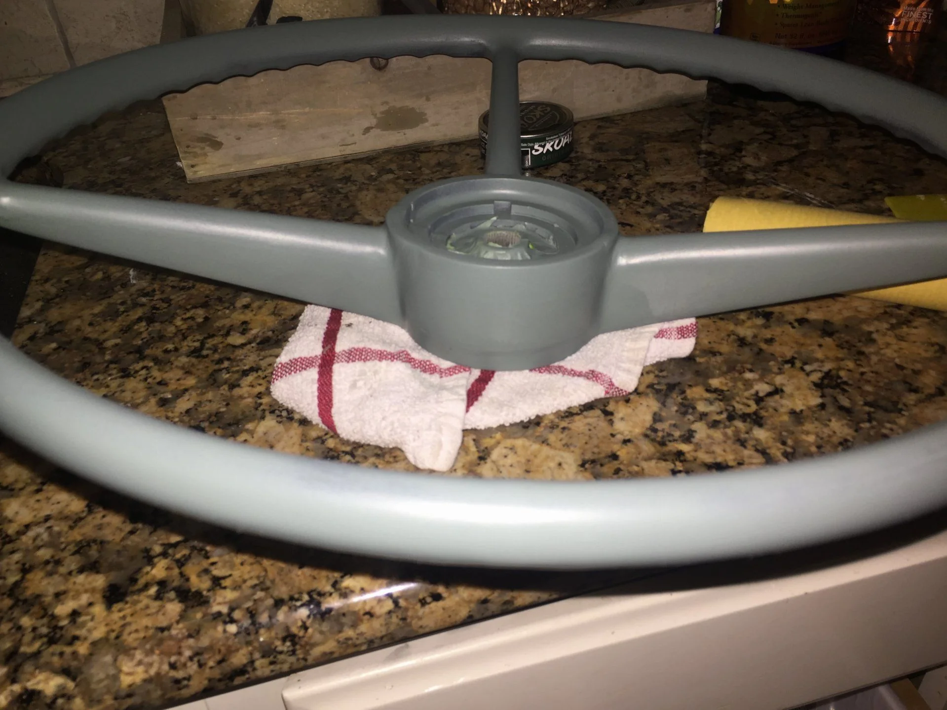

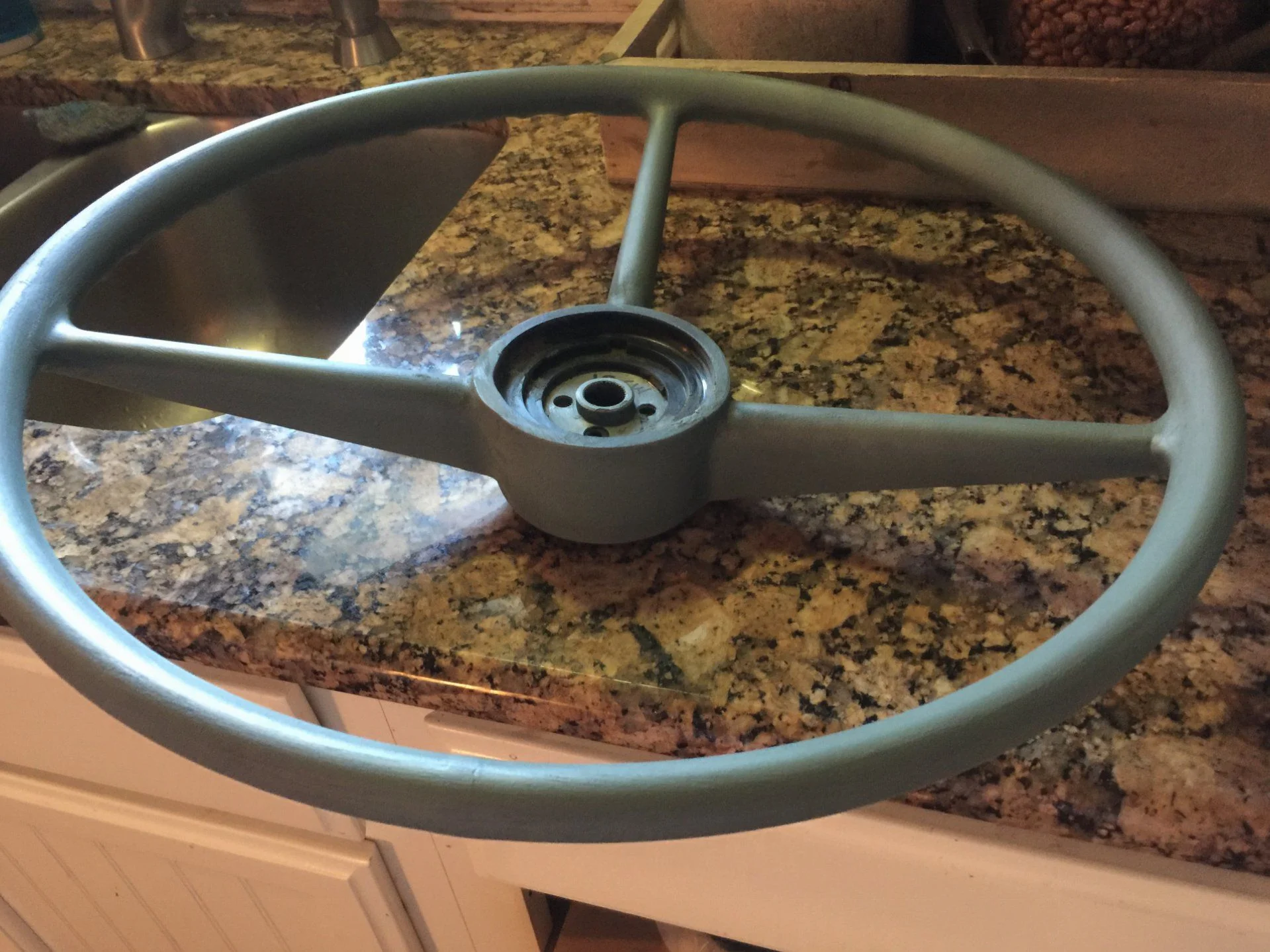

This is one I'm working on now. It had some cracks in the circumference of the hub which is a 1st for me (that's why I'm doing some for free). You can see I used green primer on my first two primes and black on the third. Every time I sand/prime I find a repairable spot. I think I got it all on this one, should prime and first coat tomorrow. FYI I talked to the cerakote company today and they seemed to think using the air dry cerakote would be best because of the UV protection it offers. I'm going to buy a cerakote set up next week so I can try this. I'll keep updating.

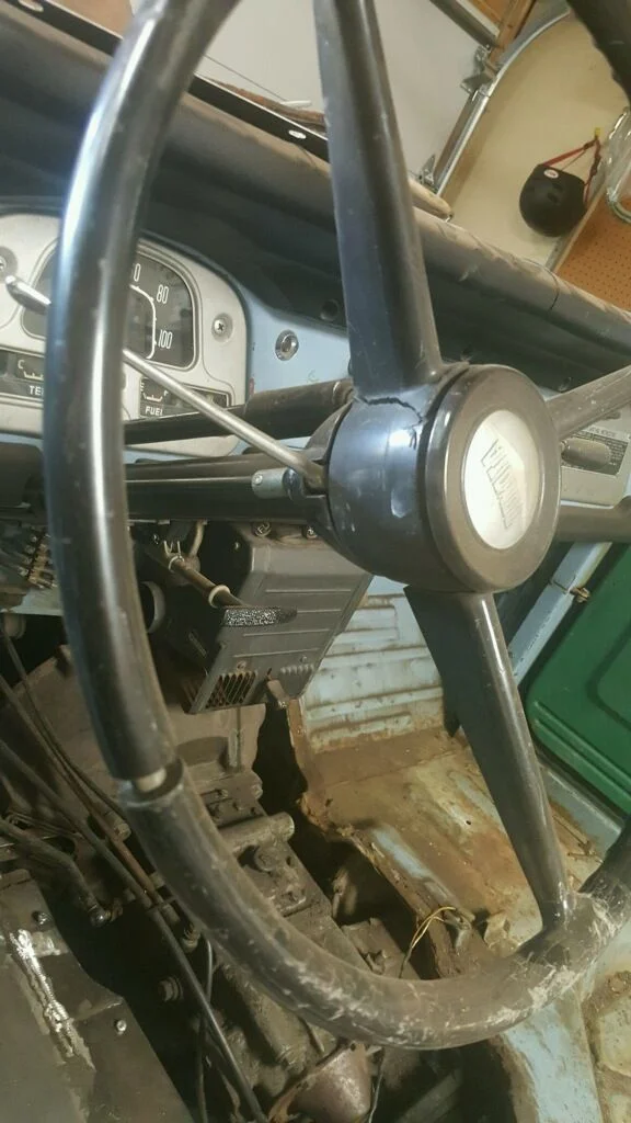

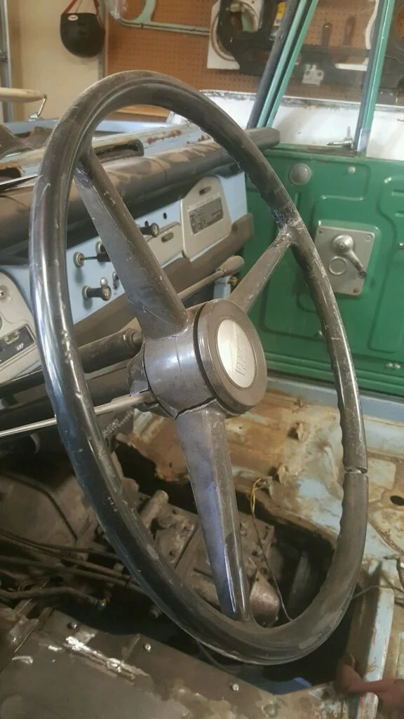

Was this wheel resplined for another column? Do you know? Thanks!
It’s a 76 steering wheel with the blue emblem in the center. The central 3 “spokes” are starting to get a bit crumbly
I can do those and there are some pics a few pages back, if the trumpets are worn down they’re really hard to repaint, so new horn buttons w/ trumpets may be necessary, if they’re on there.
I don’t think so, 68 and before have 36 splines and up to 72 have 33, I thin, that’s from memory.
