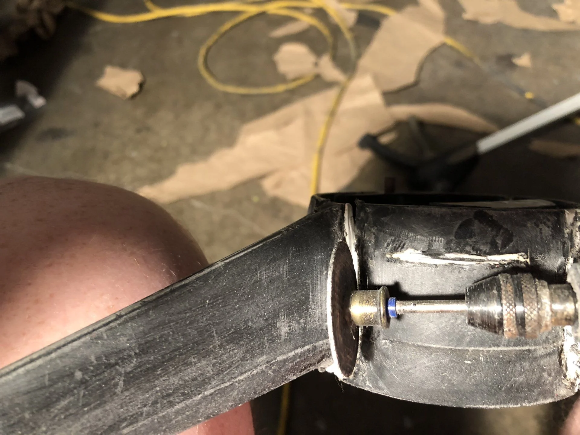

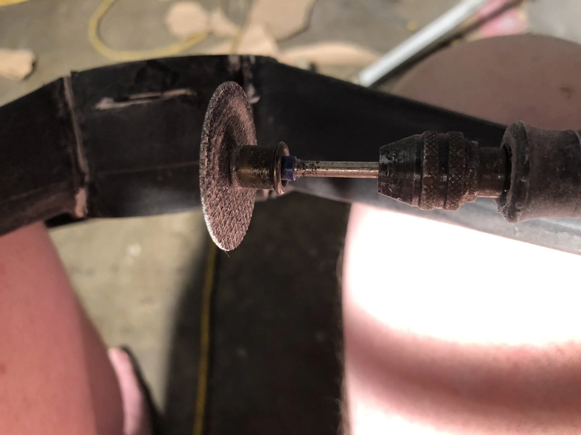

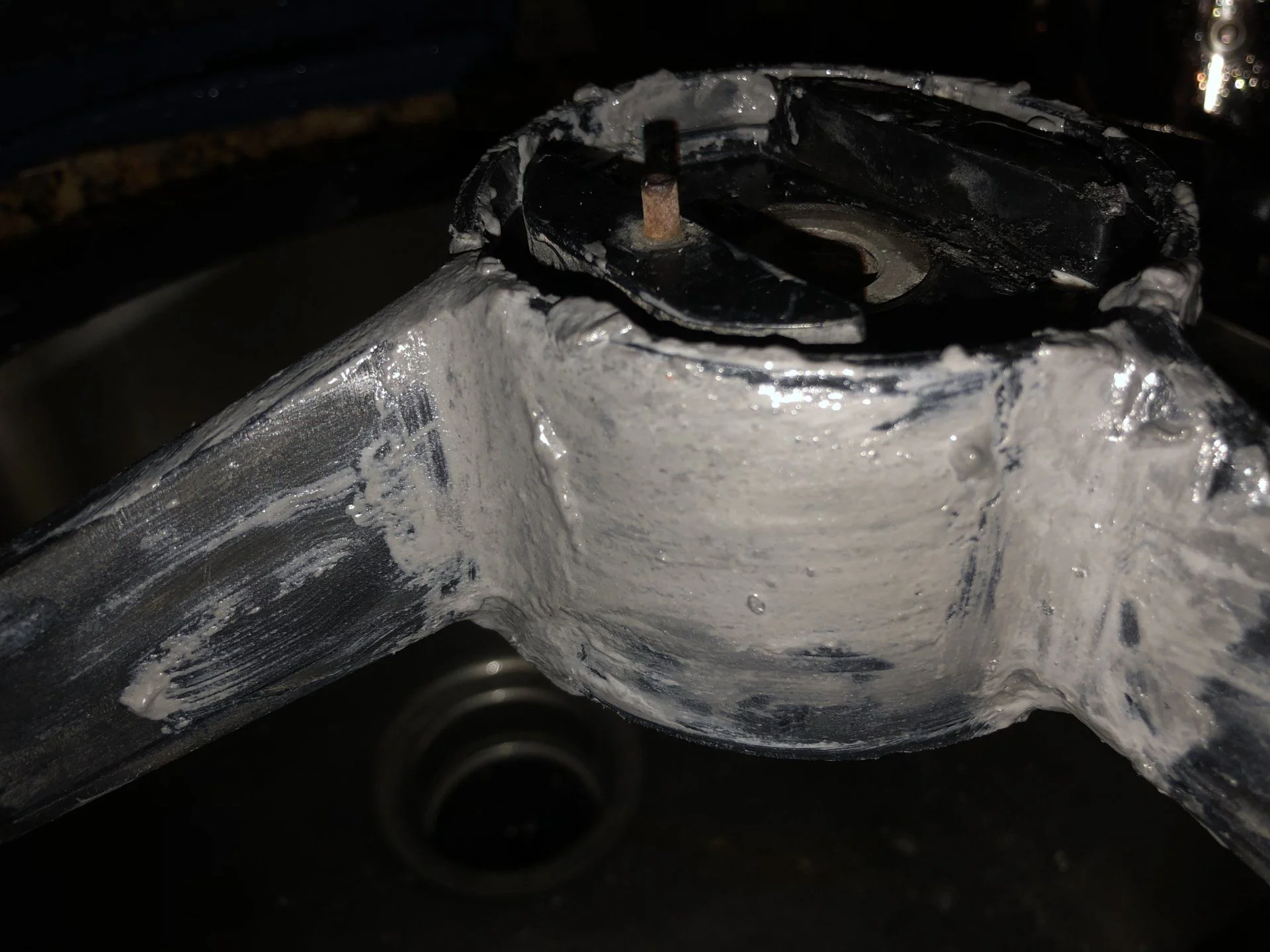

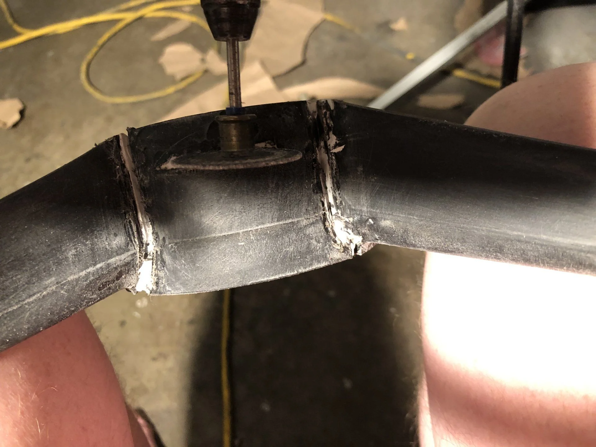

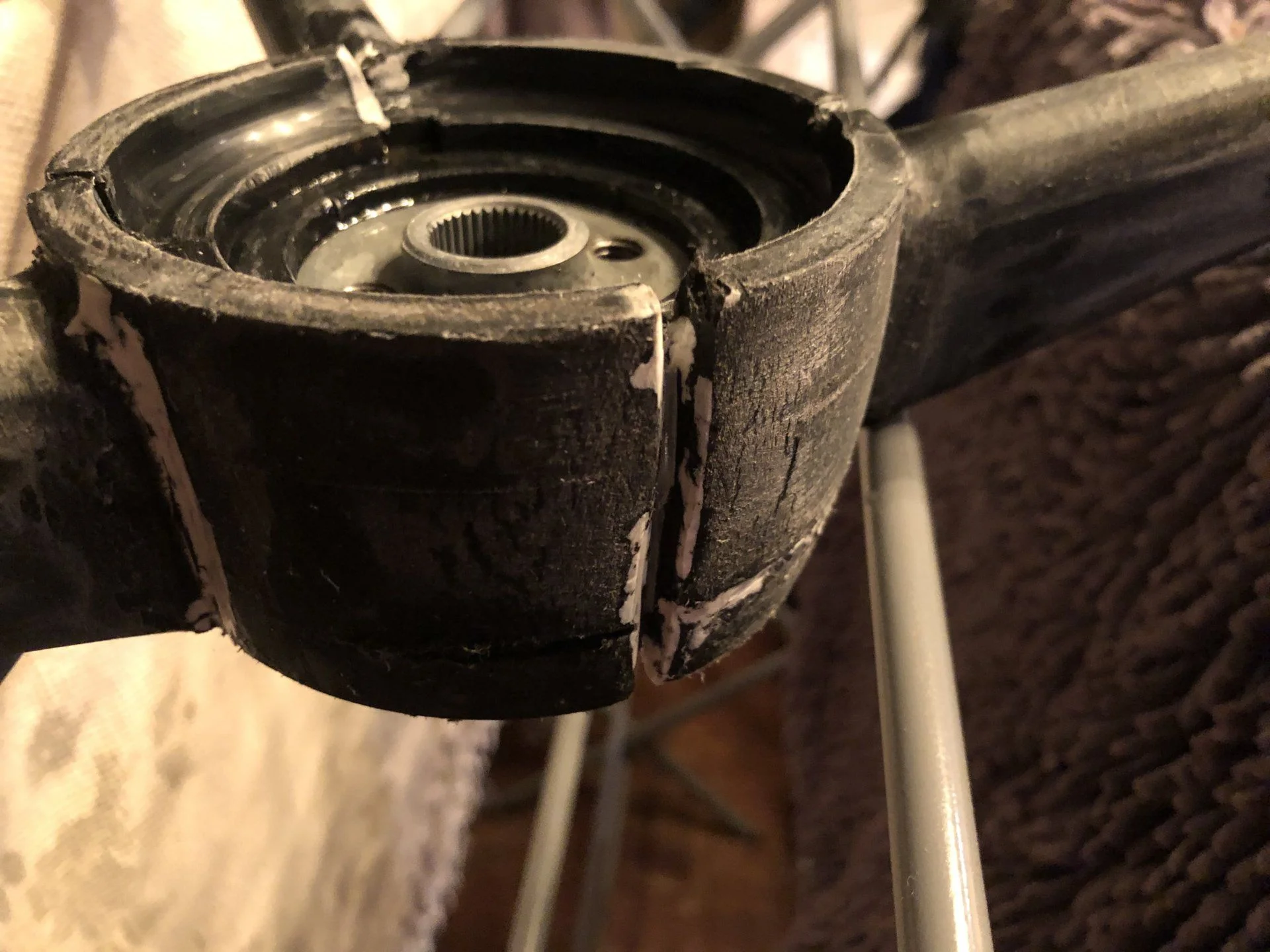

1st step open all cracks in a “ V” shape, it sounds counterintuitive but will make the epoxy lay better.

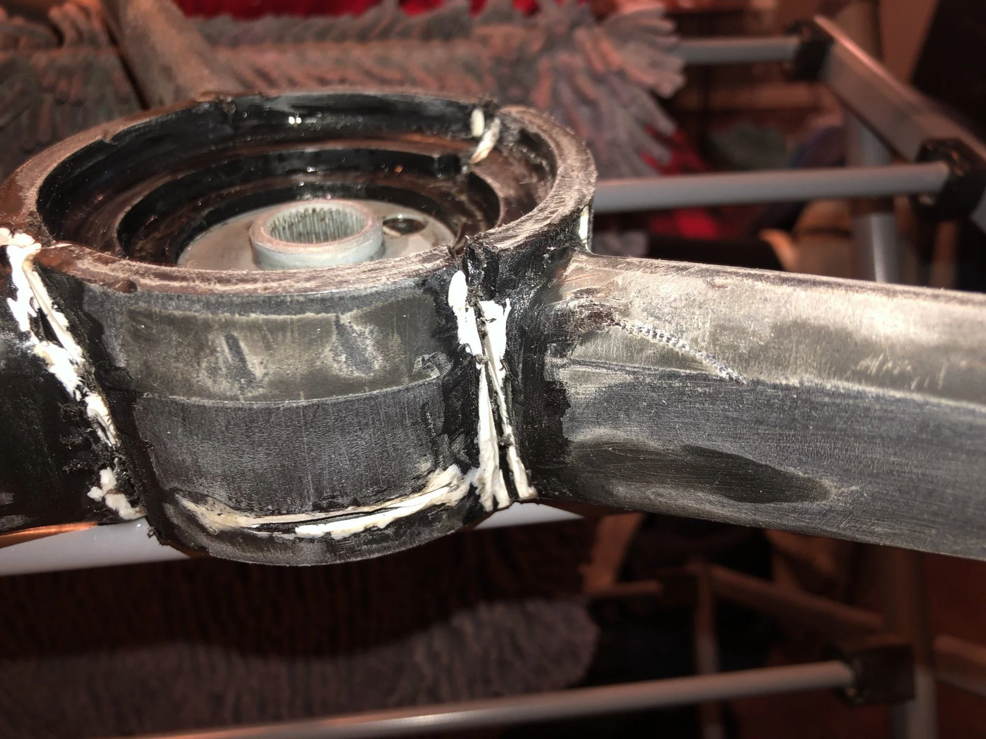

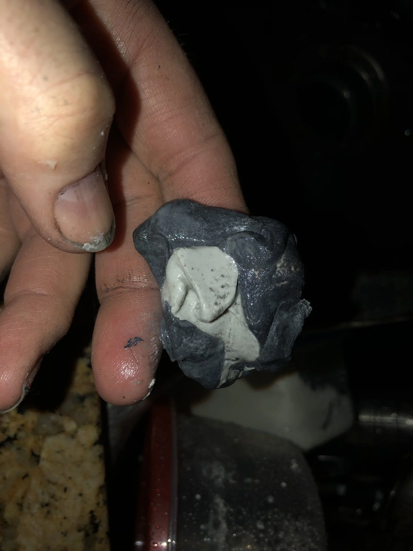

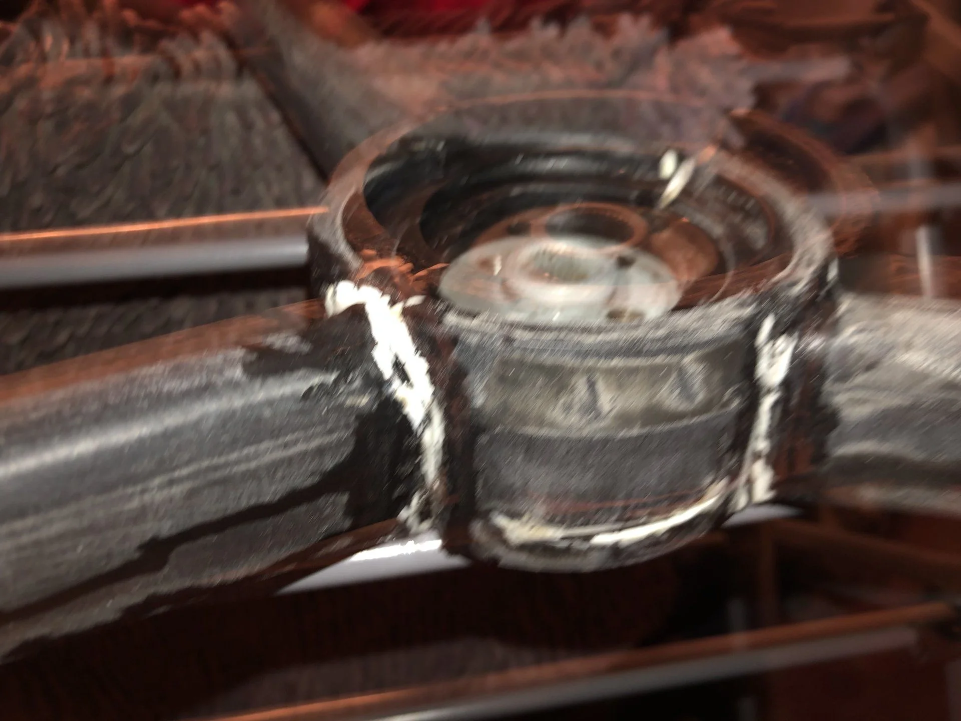

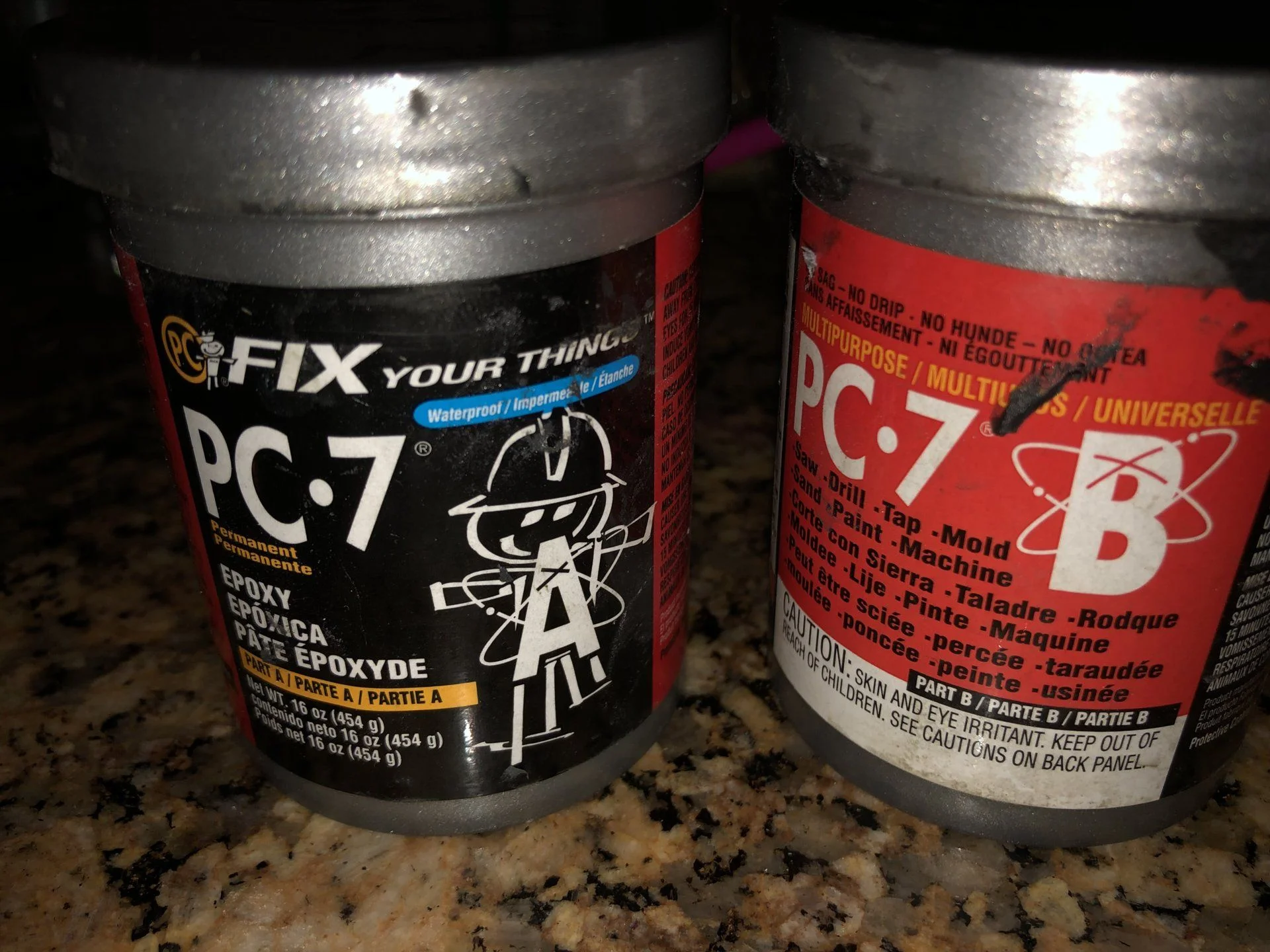

After sanding the “Vs” with heavy grit sandpaper and begin filling cracks w/ PC-7 in equal amounts mixed.
Force the epoxy into the cracks and smooth, the epoxy will rise higher out of the cracks. I know it looks messy now, but wait for the finish.
PS: a lot of heavy grit sanding will be required. I’ll show more tomorrow after the epoxy sets up.

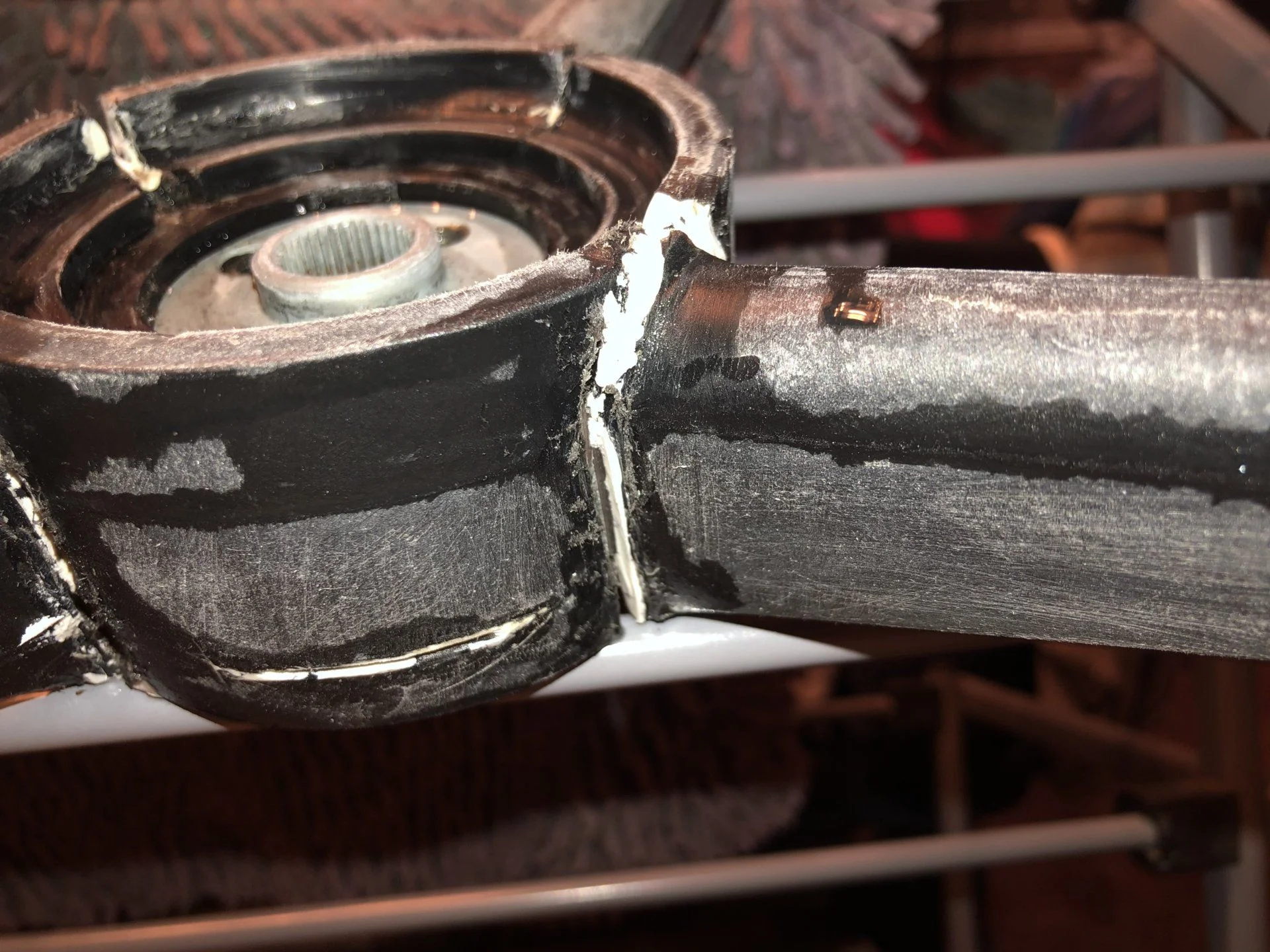

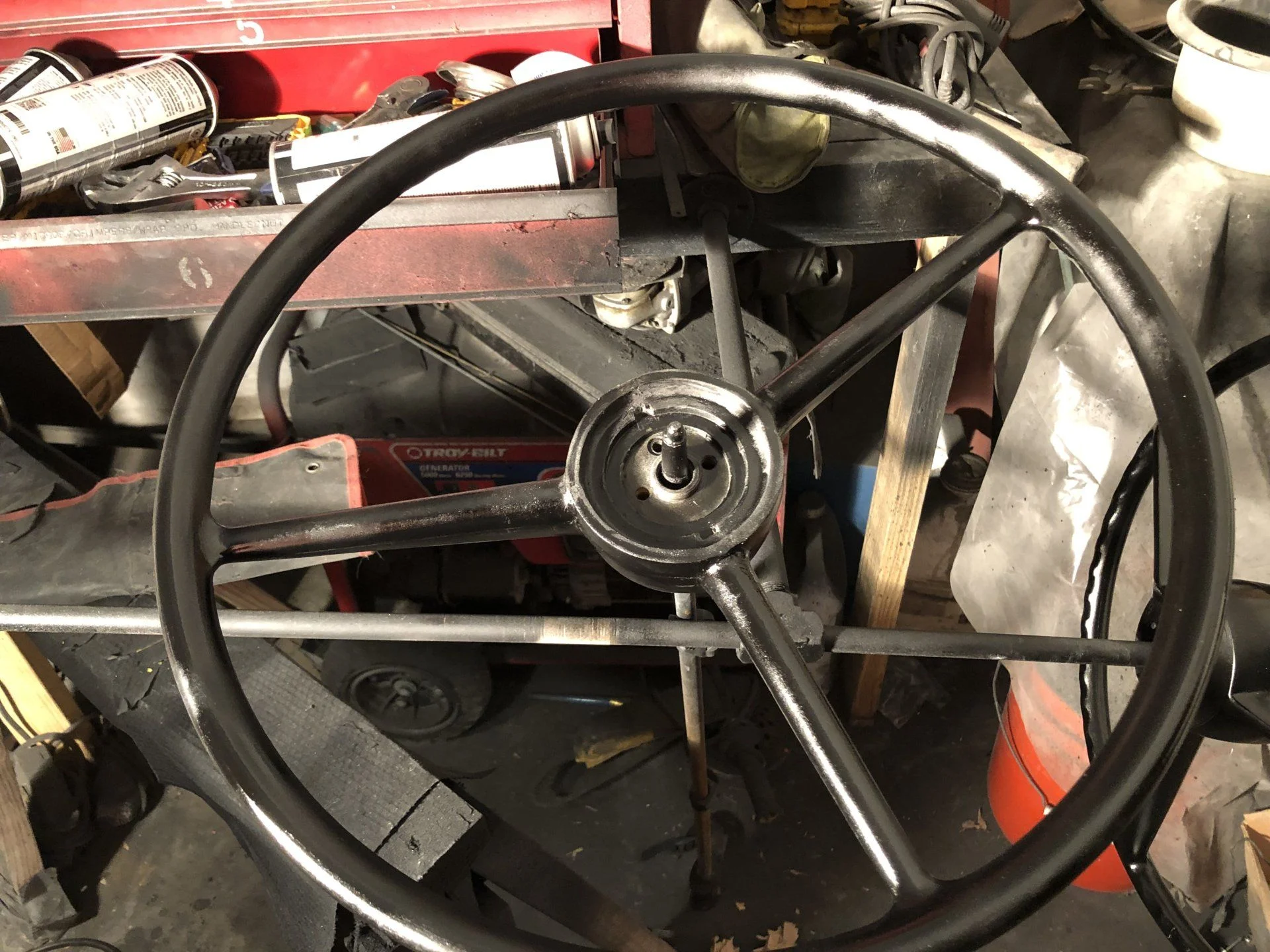

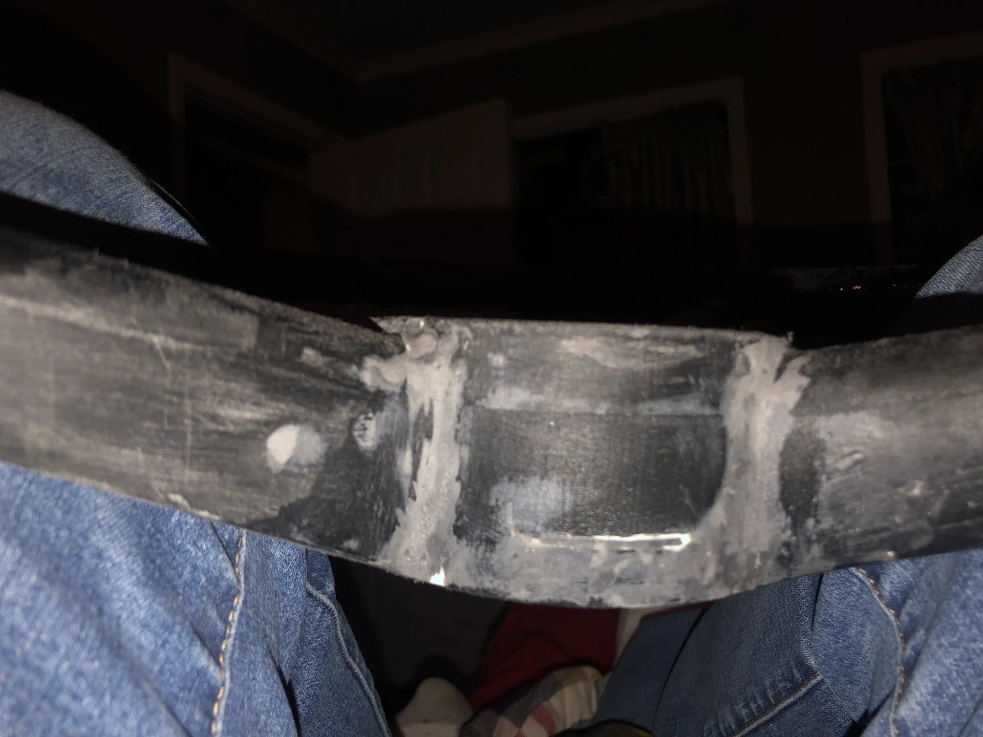

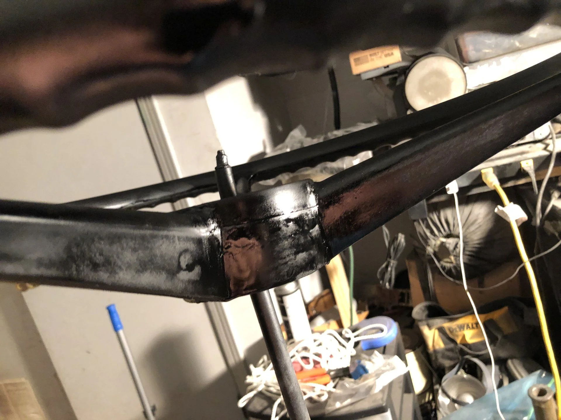

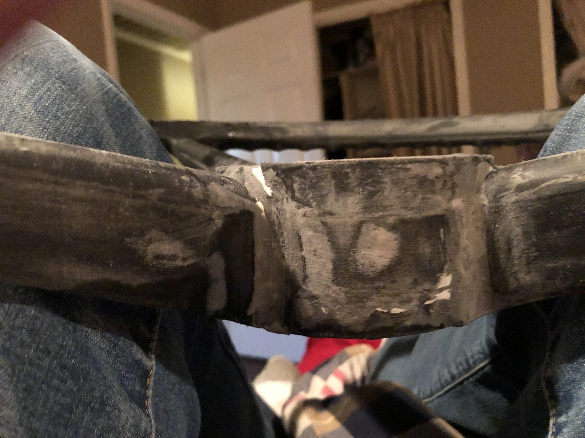

After the epoxy dries and a rough sanding.
Next I will do a softer sanding, then put the body lines on with glaze and sand to a perfect finish, then start painting.

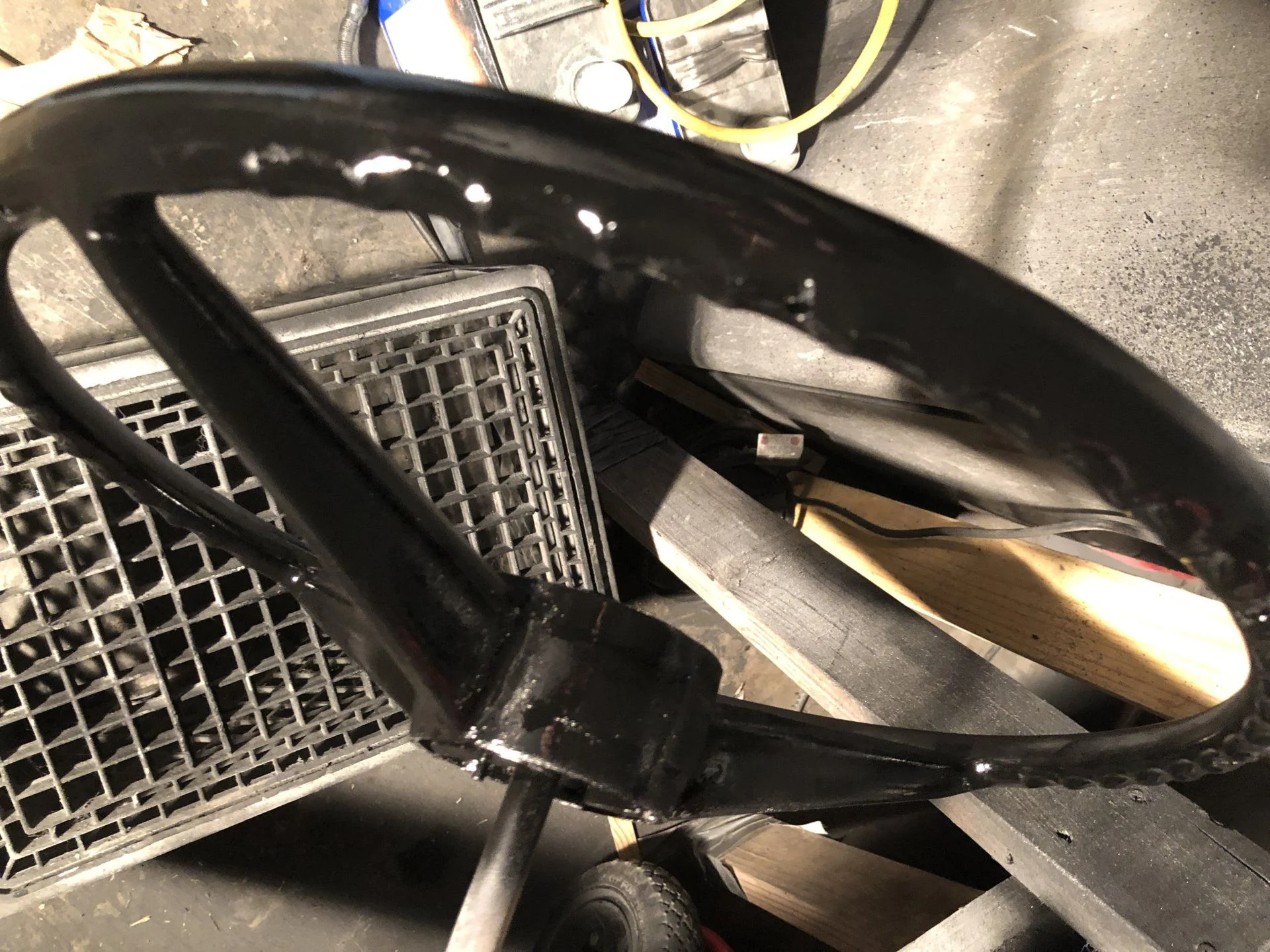

Before the light sanding, I use cheap black primer which makes the problems stand out more, so I can sand in the necessary places/ways.

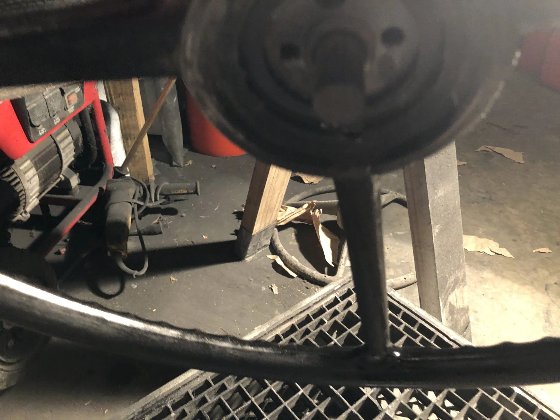

Prime

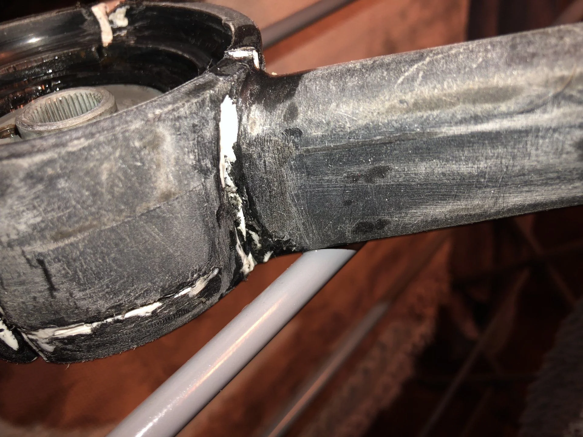

The black prime shoes all bad spots, tomorrow I’ll go repair those spots and put a new ring around the hub.
The black primer showed me the bad spots,

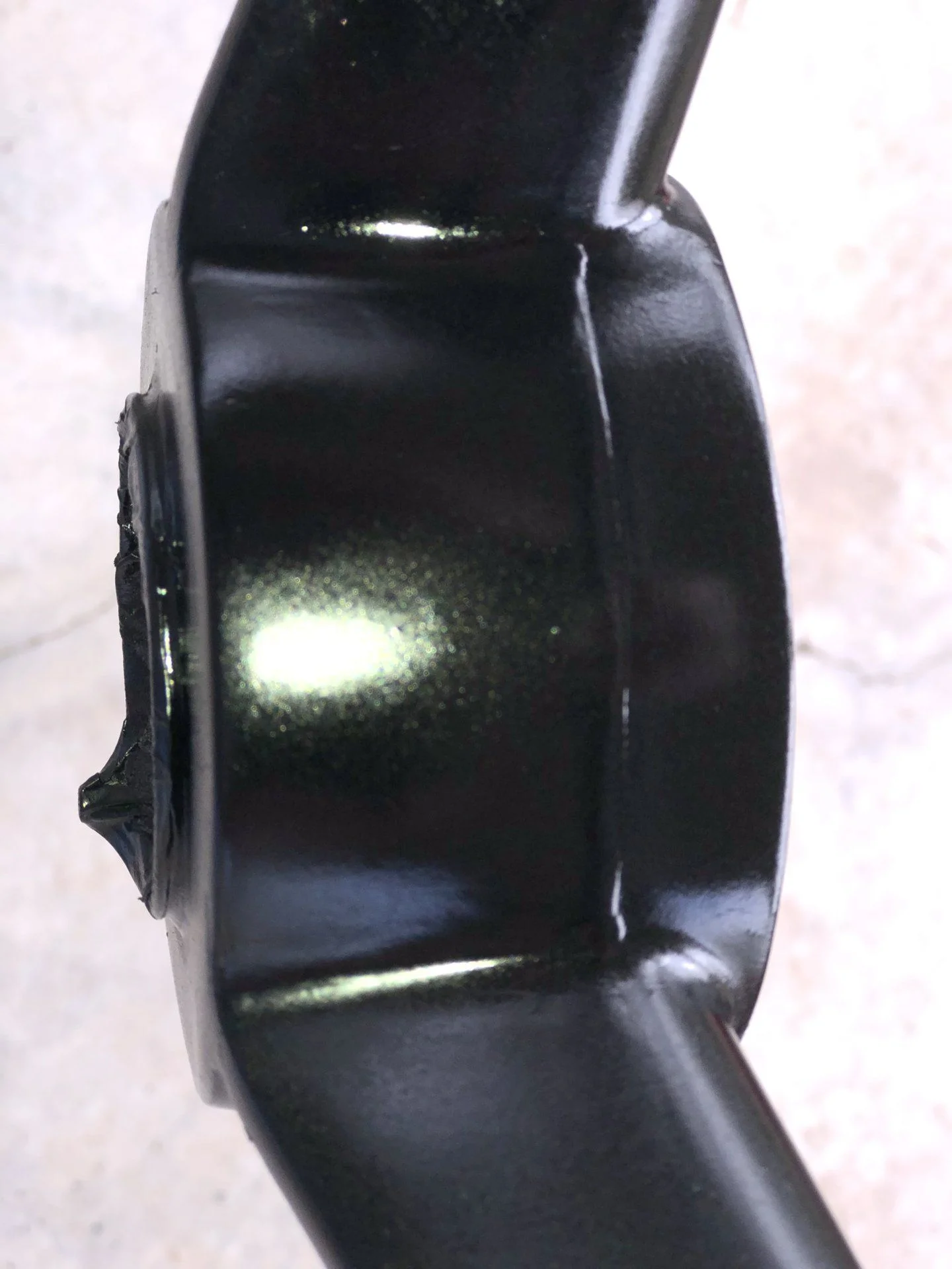

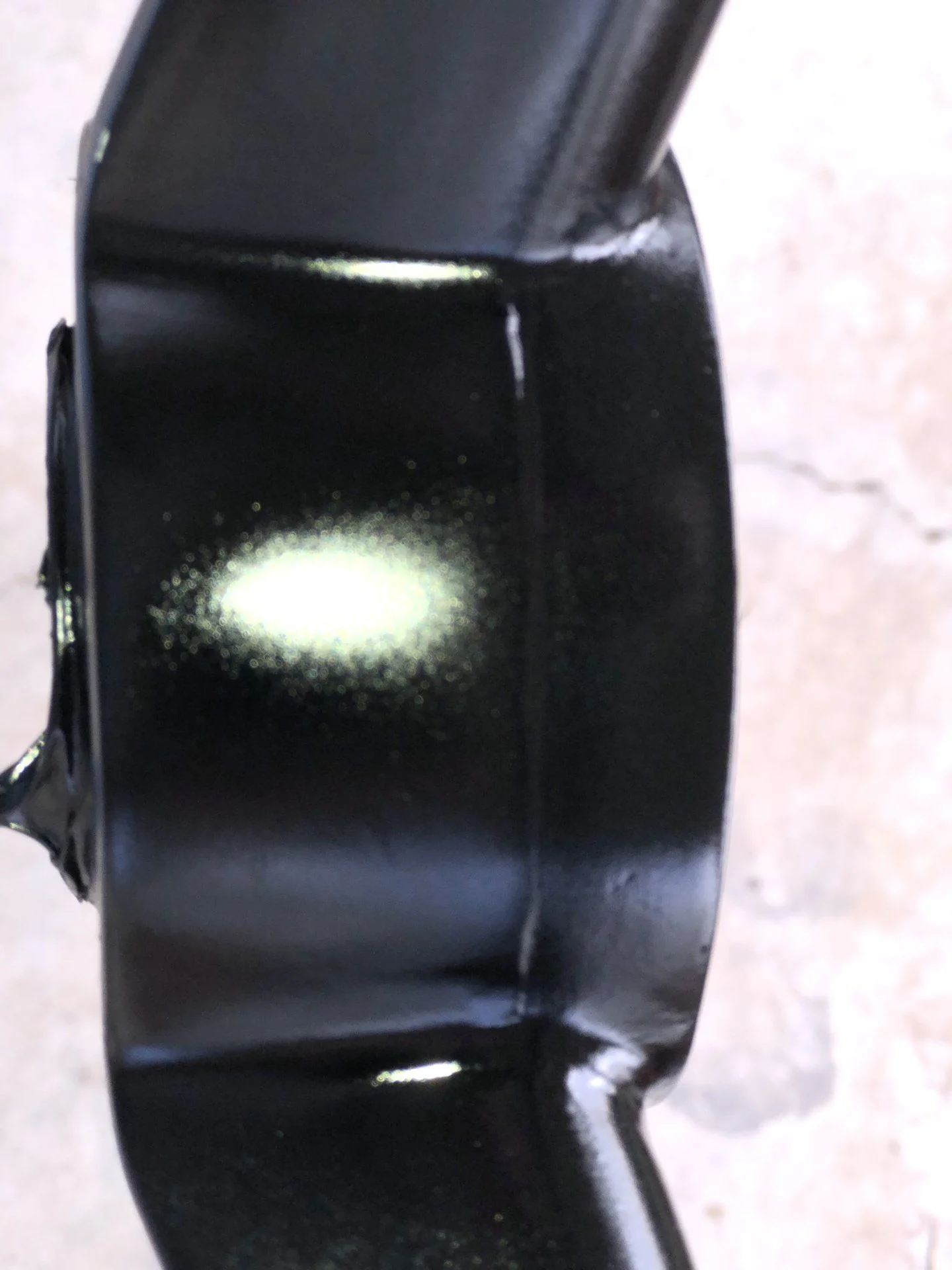

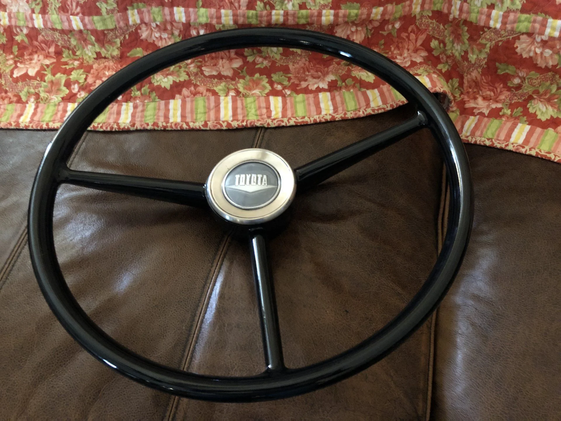

But you can see how the the wheel will come out perfect.

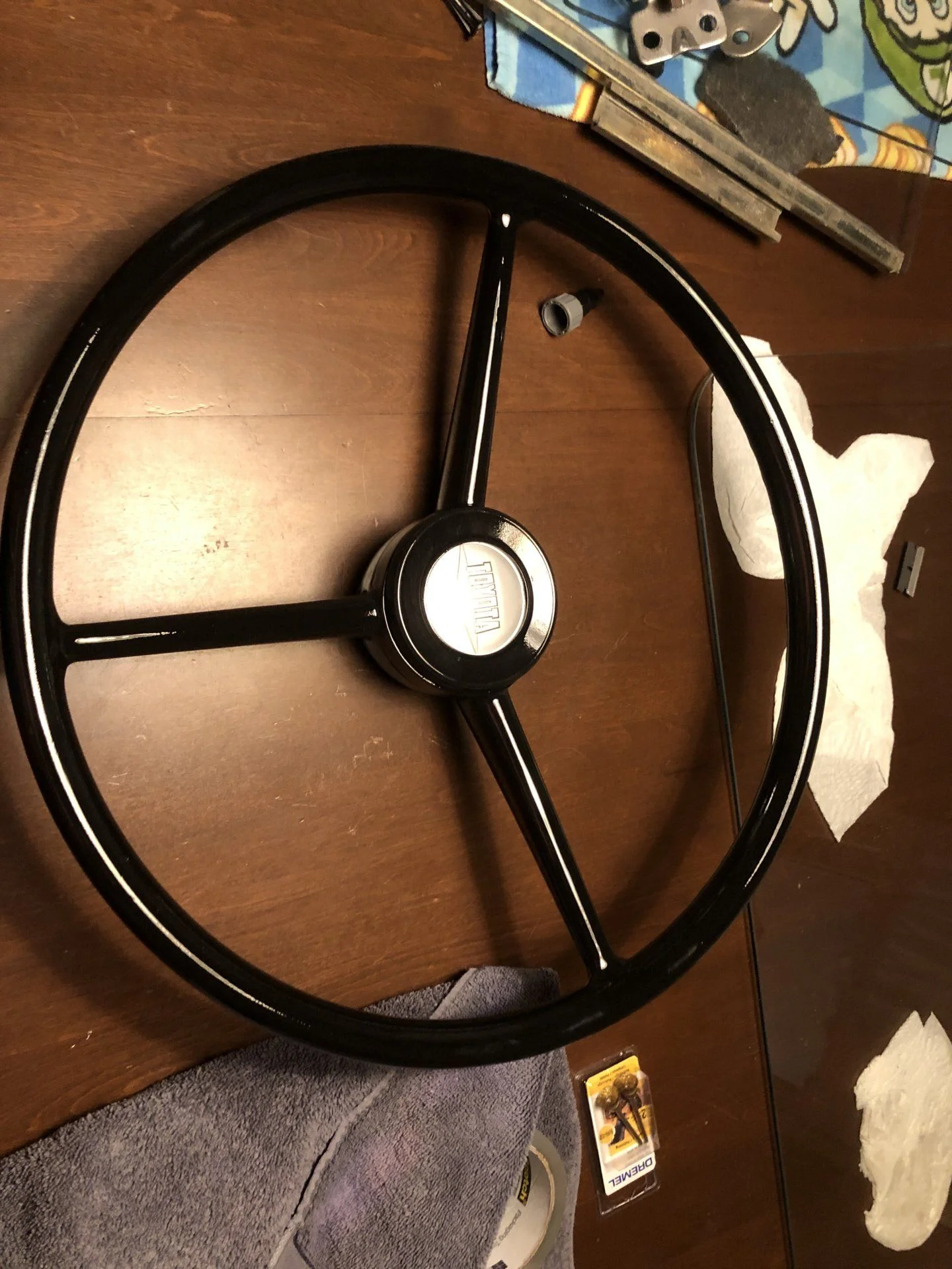

Tomorrow I will ha e it perfect, anyone’s needs a restoration 36 spline wheel, it will be ready in about 4 days.

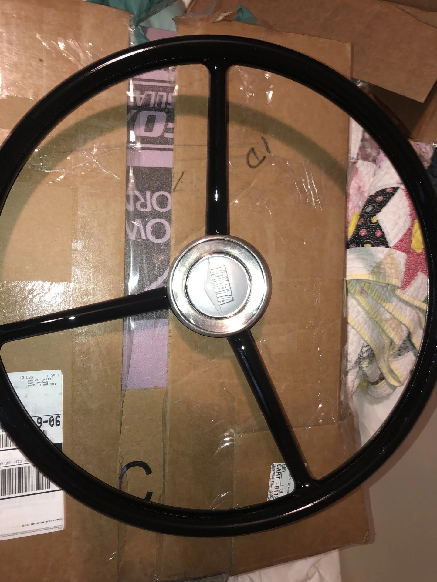

Just finished three more, first time for a 65 wheel.

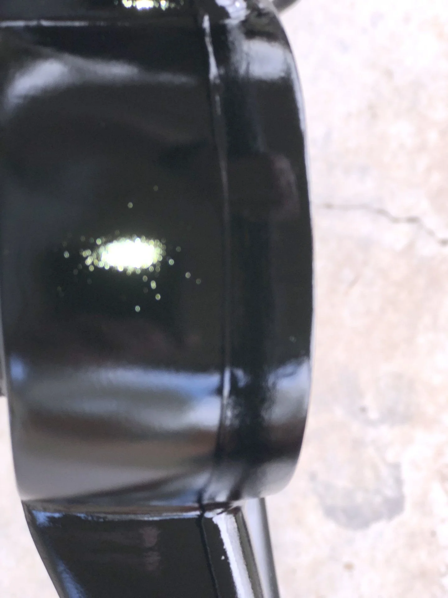

This where I restored the ring around the hub.
