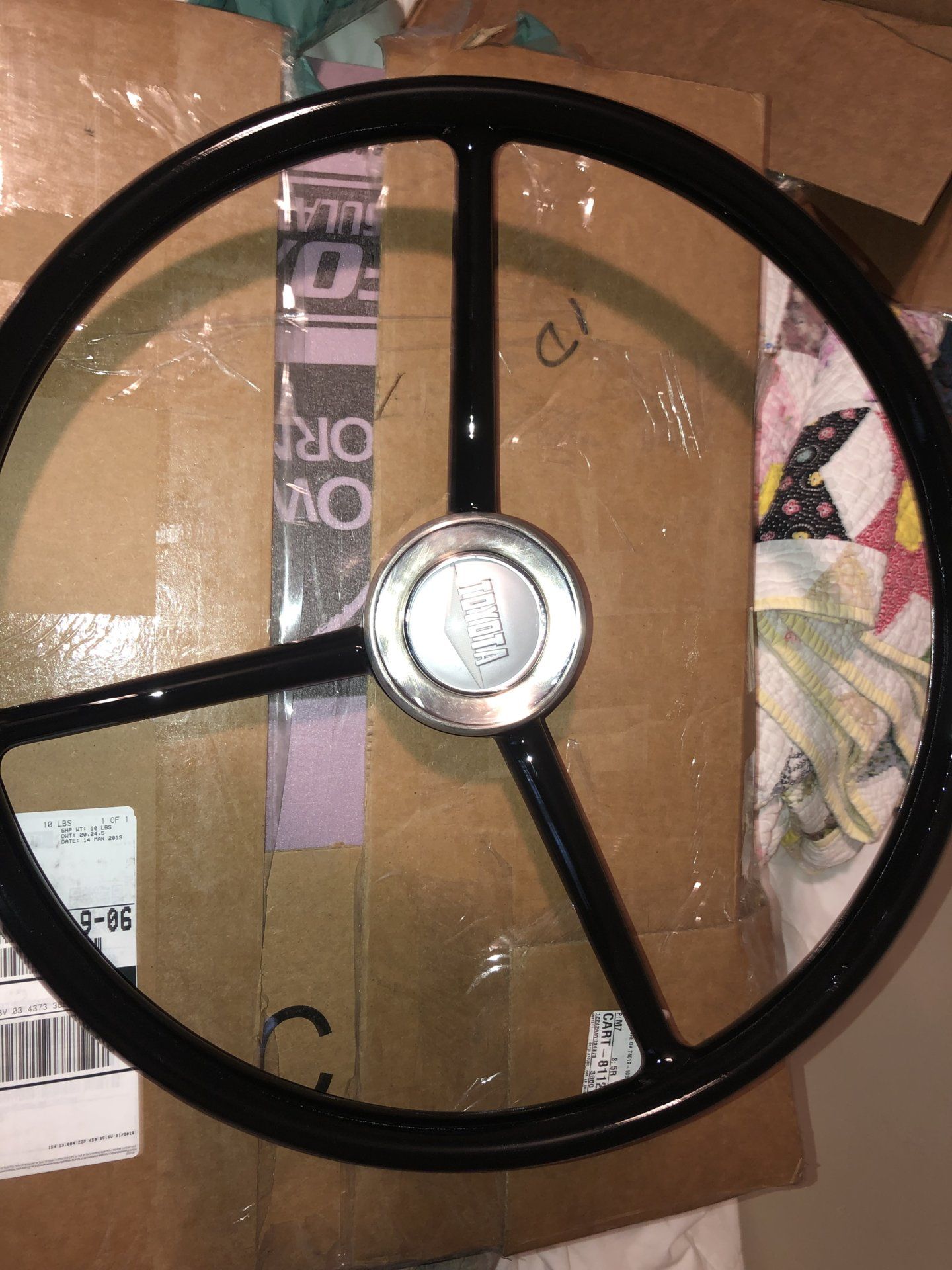

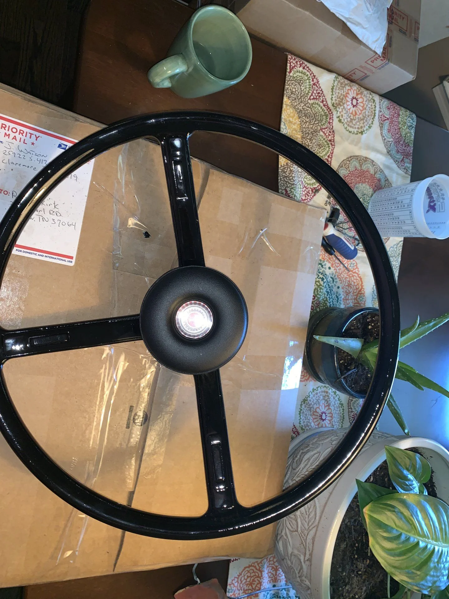

I've done the ring. I'm leaving the emblem as is since the entire truck is either re painted, re plated, or blasted. My truck is a 3/70 so the one you're doing would be good.

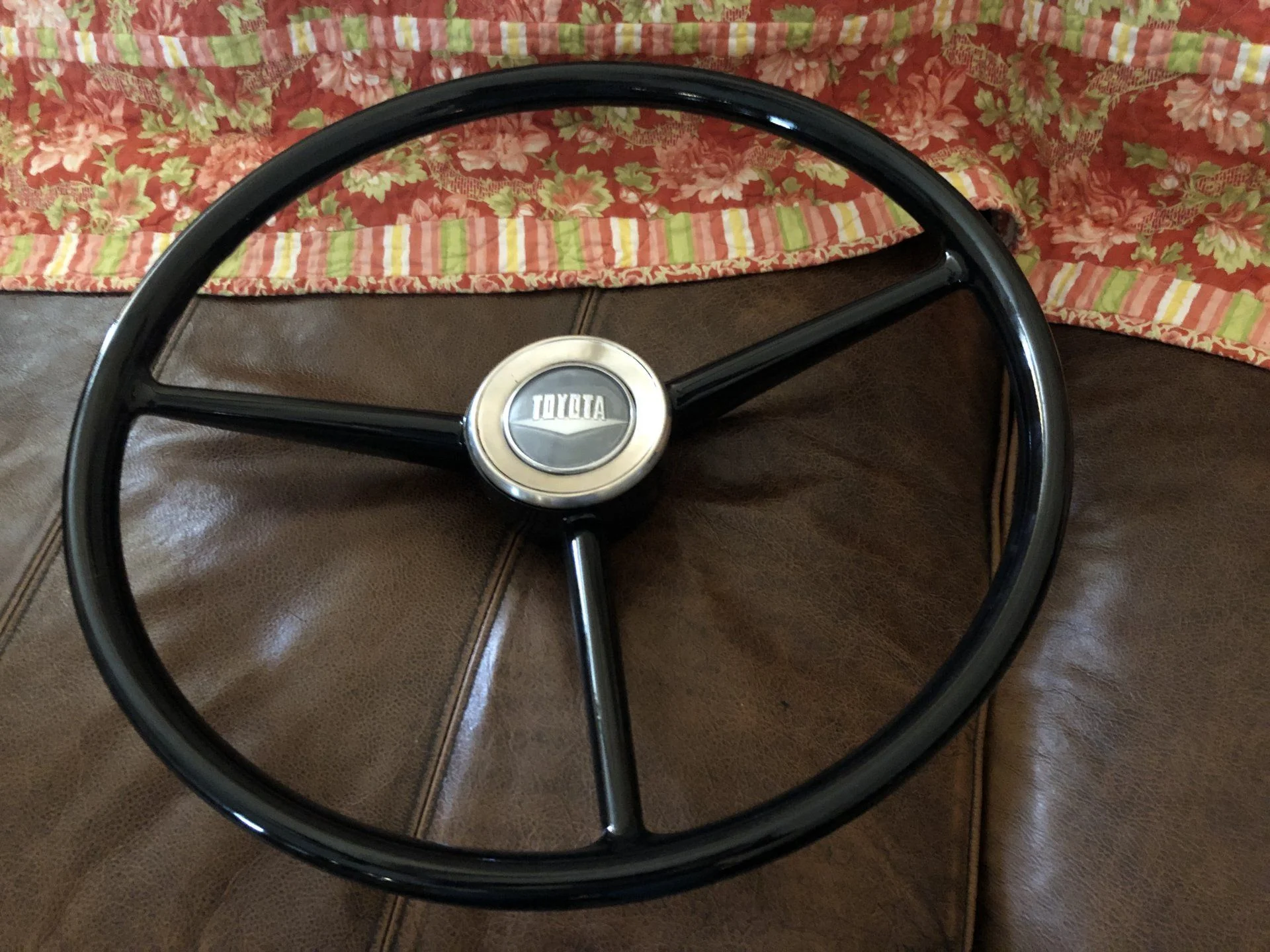

Here's my version for this truck. It matches all the new hardware.

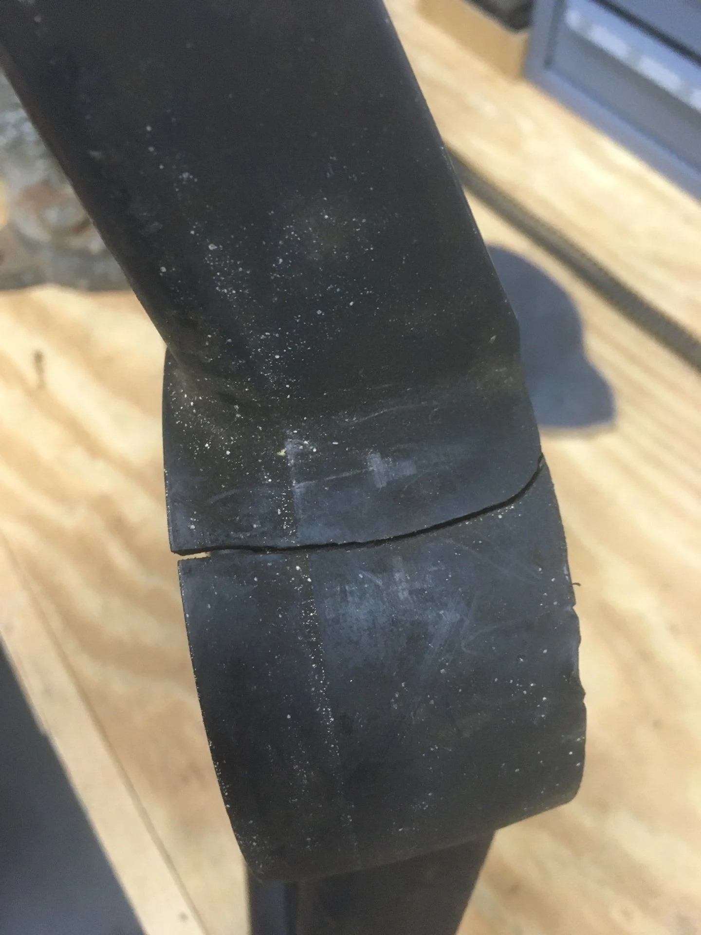

I degrease, repair all visible cracks and go over it with a magnifier to find future cracks and repair those before they get worse. Refresh body lines (like the circle around the hub) prime, paint, clear coat and buff.
Looks great

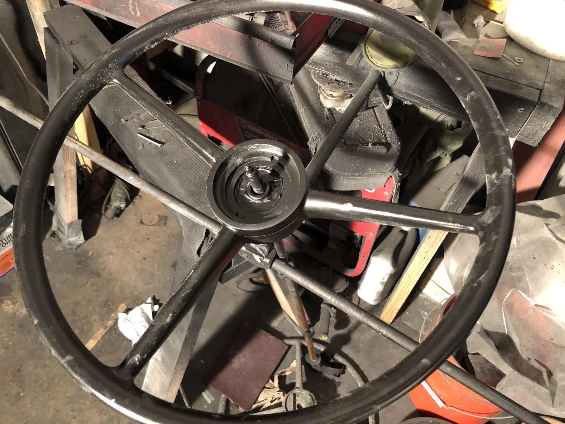

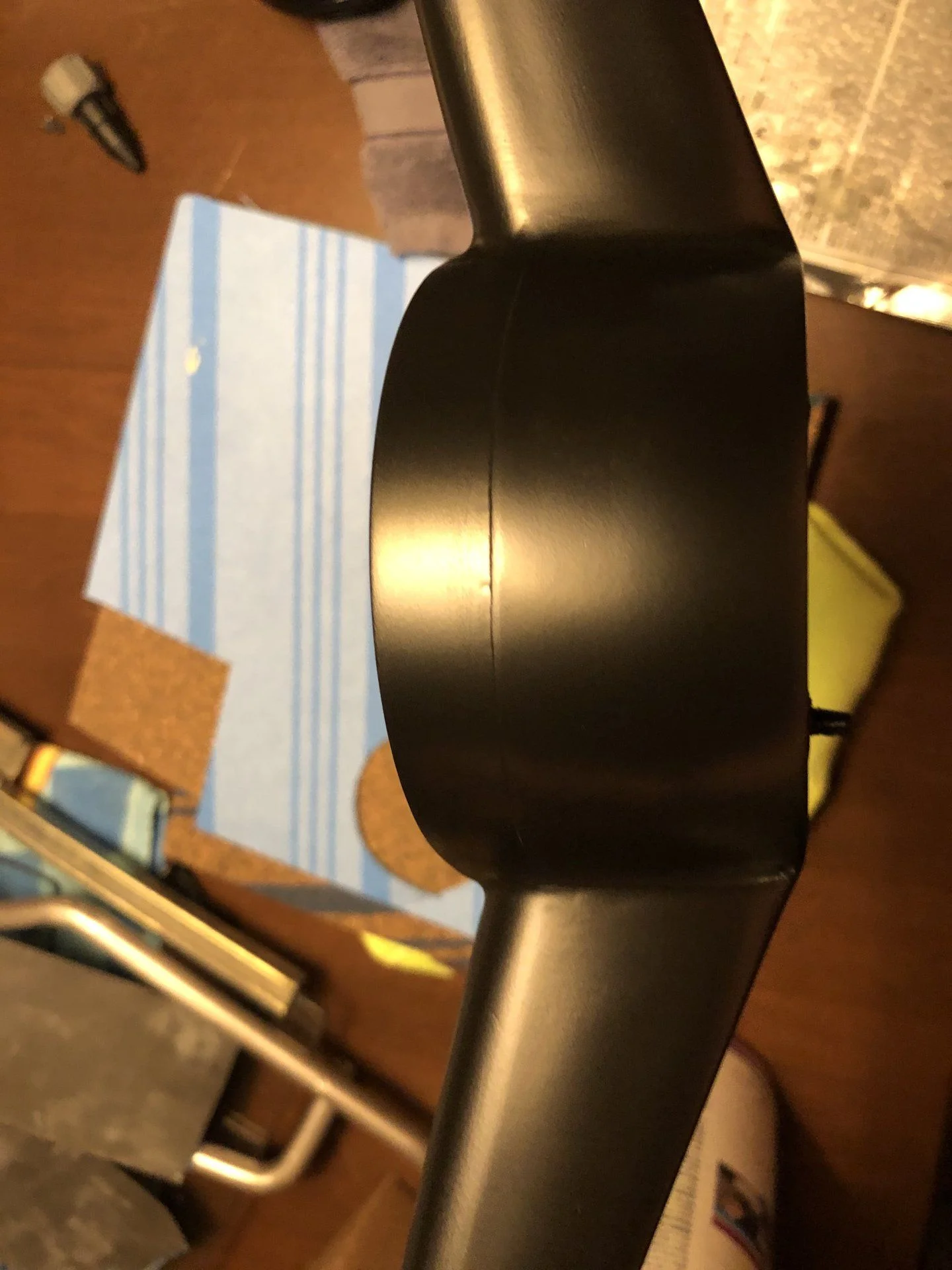

The wheel has dust on it but it is going to look ne
*new*
Back of it

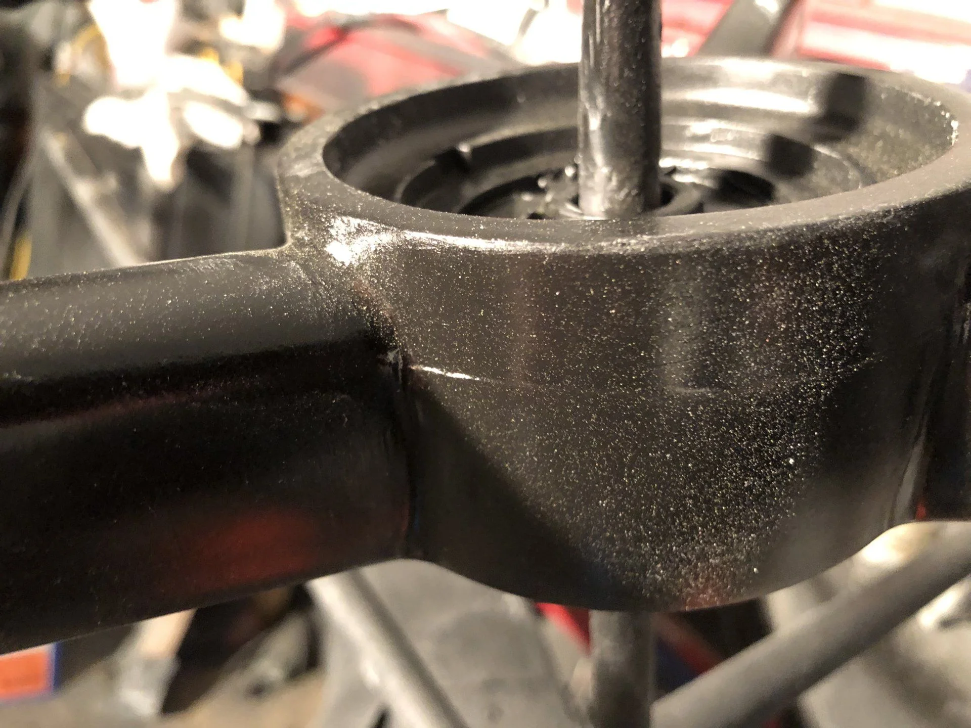

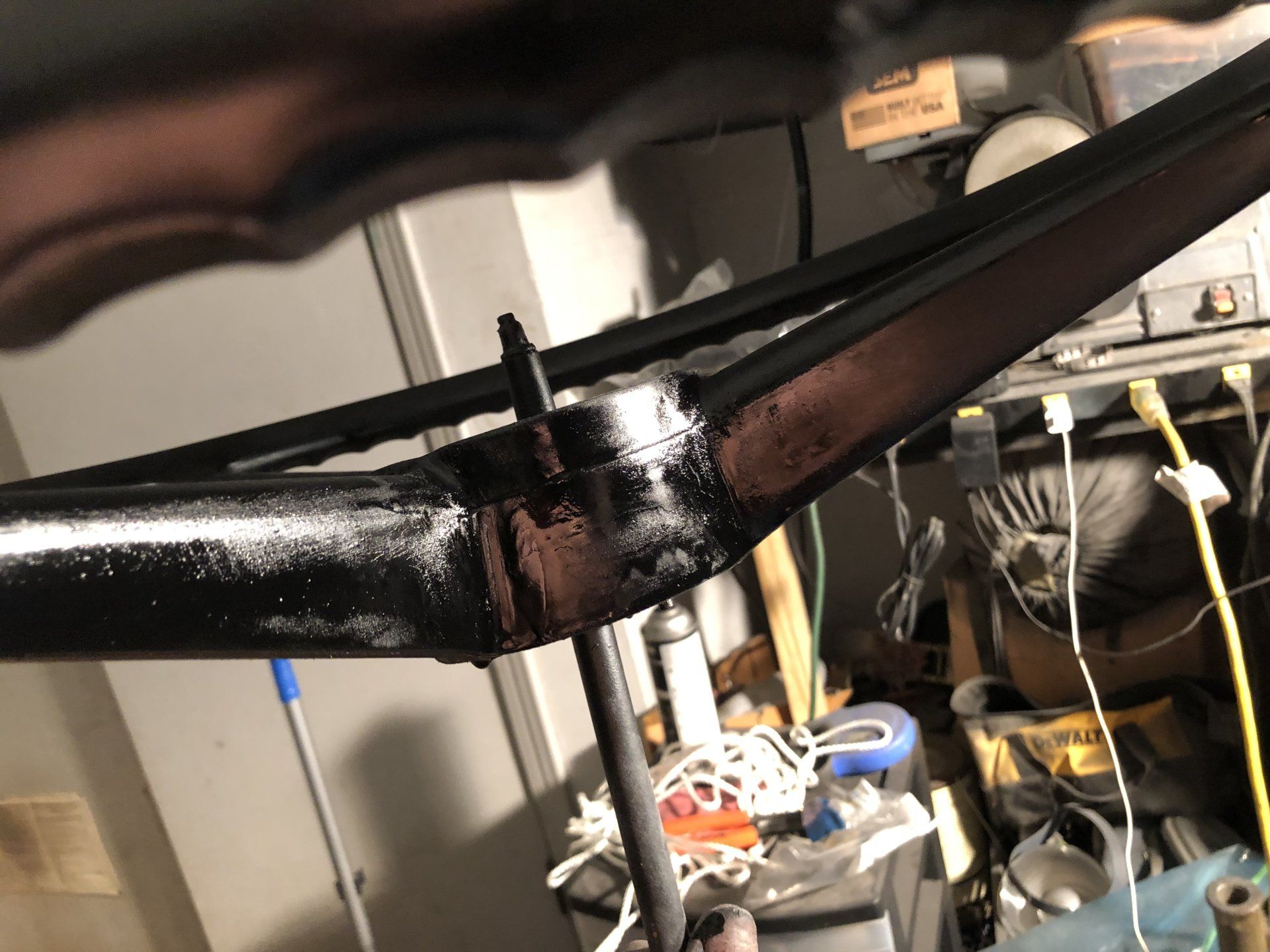

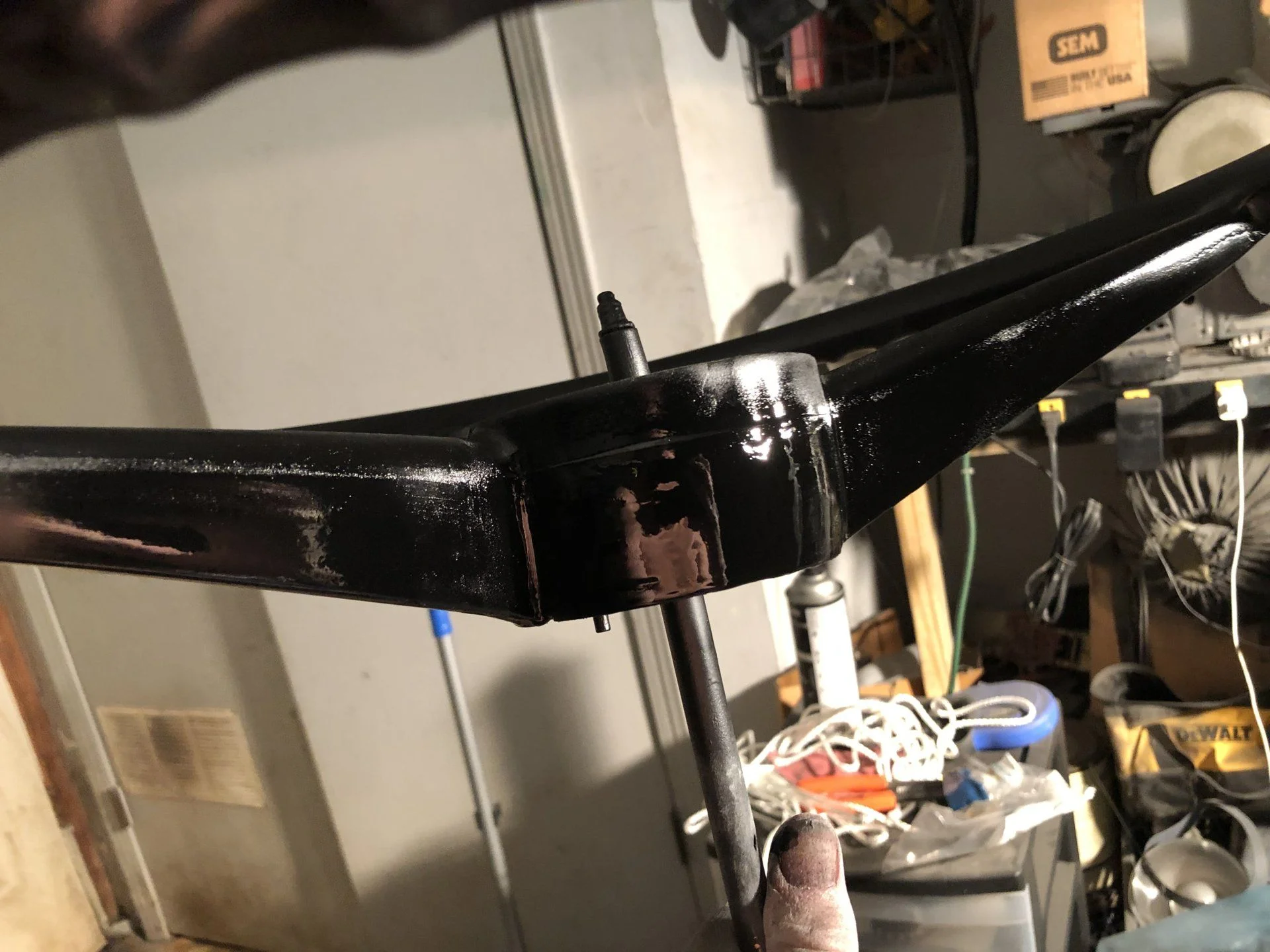

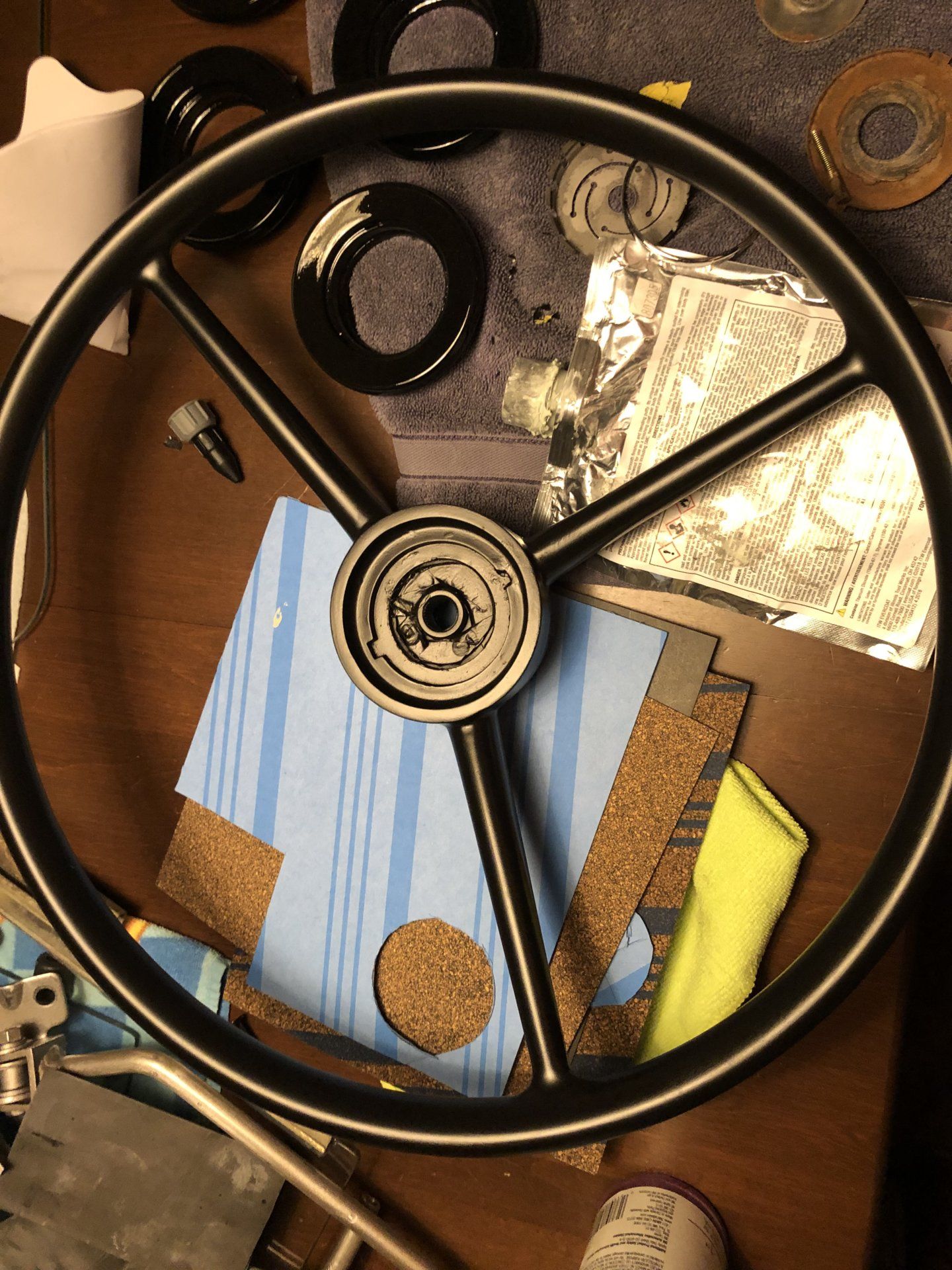

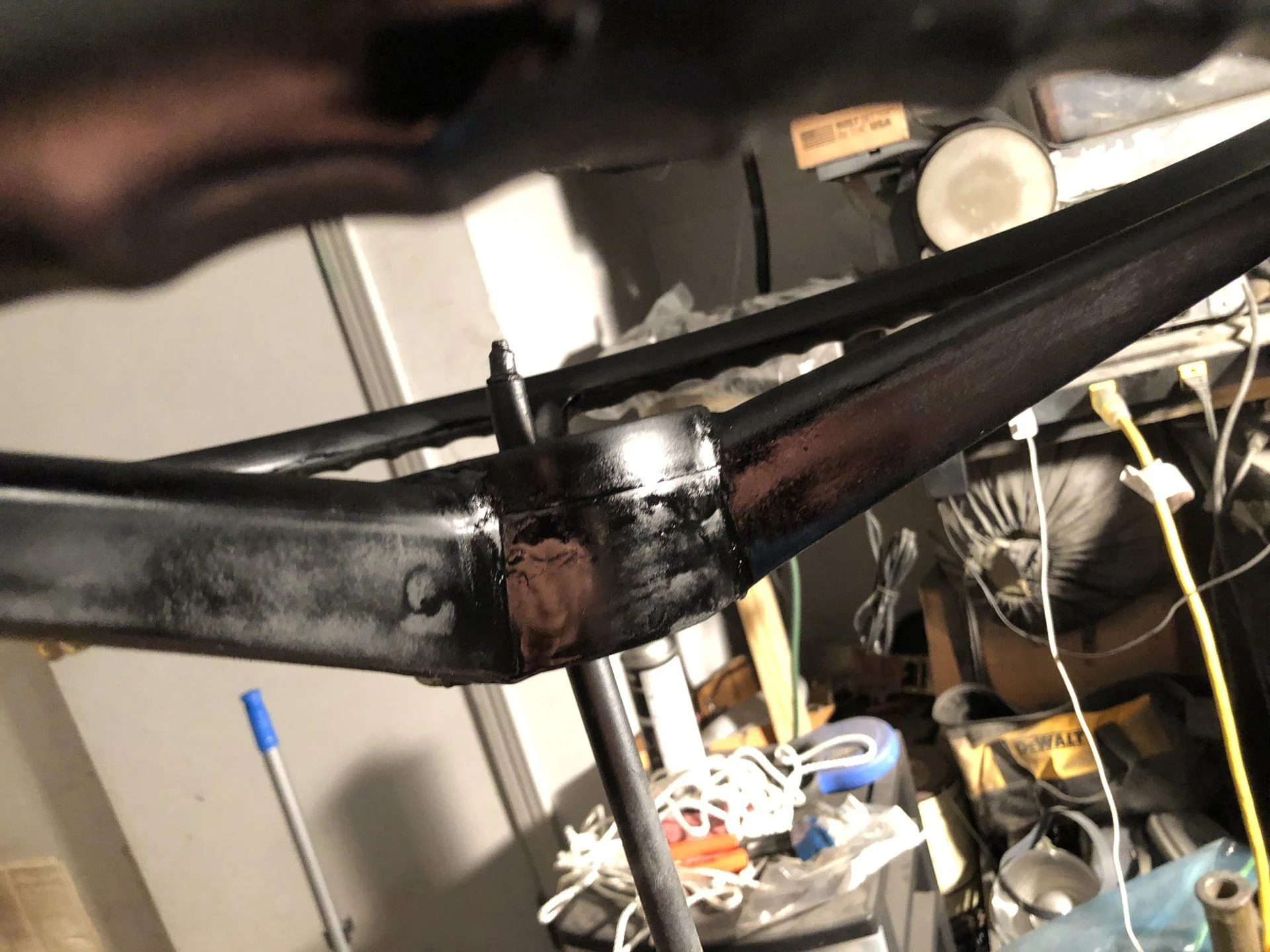

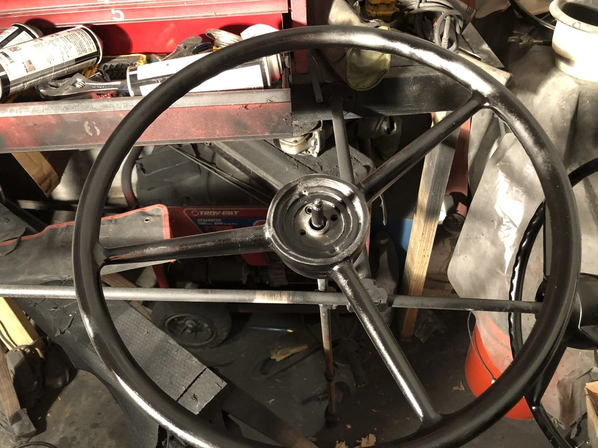

PS: a lot of heavy grit sanding will be required. I’ll show more tomorrow after the epoxy sets up.

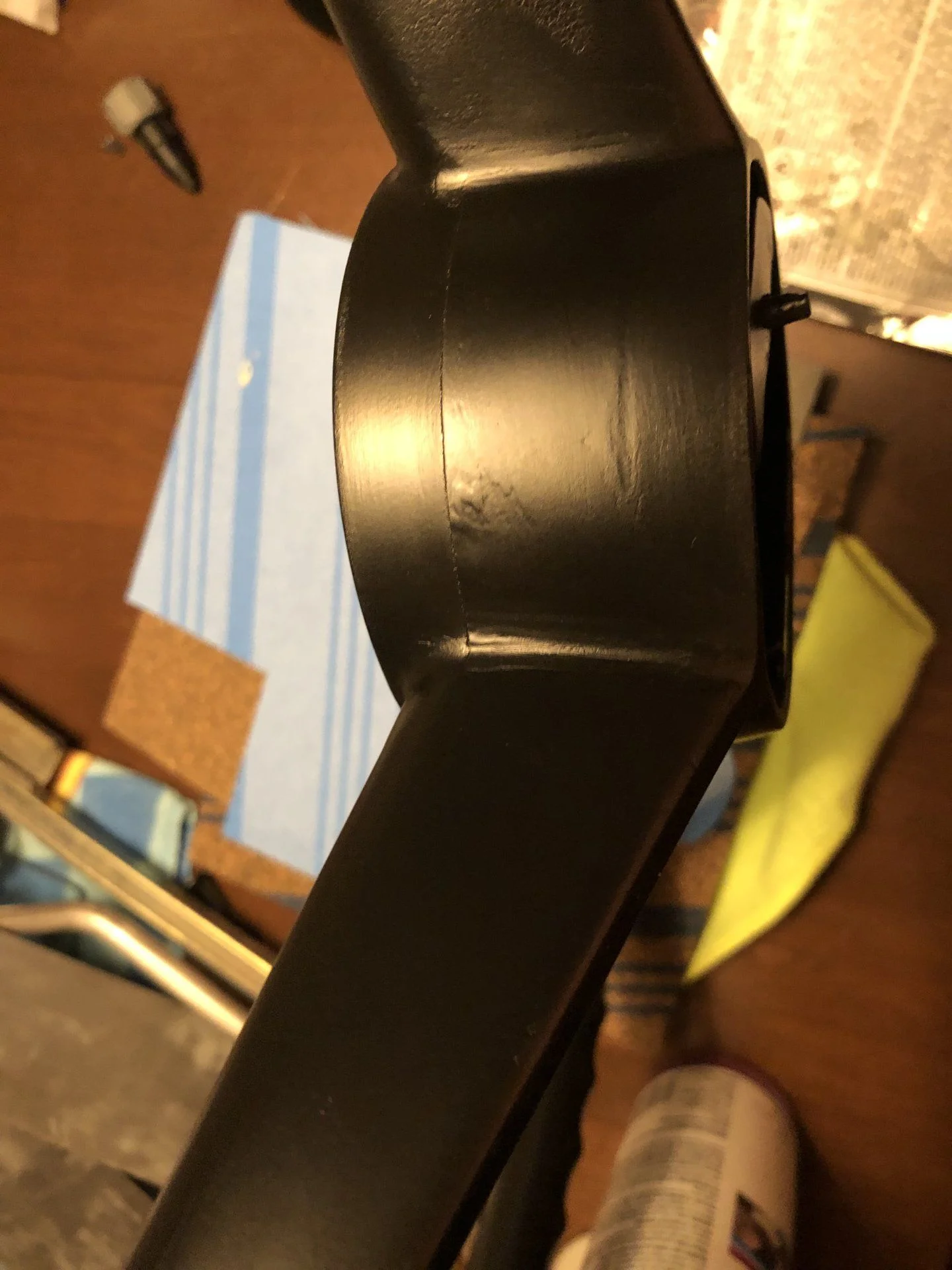

The black primer showed me the bad spots,

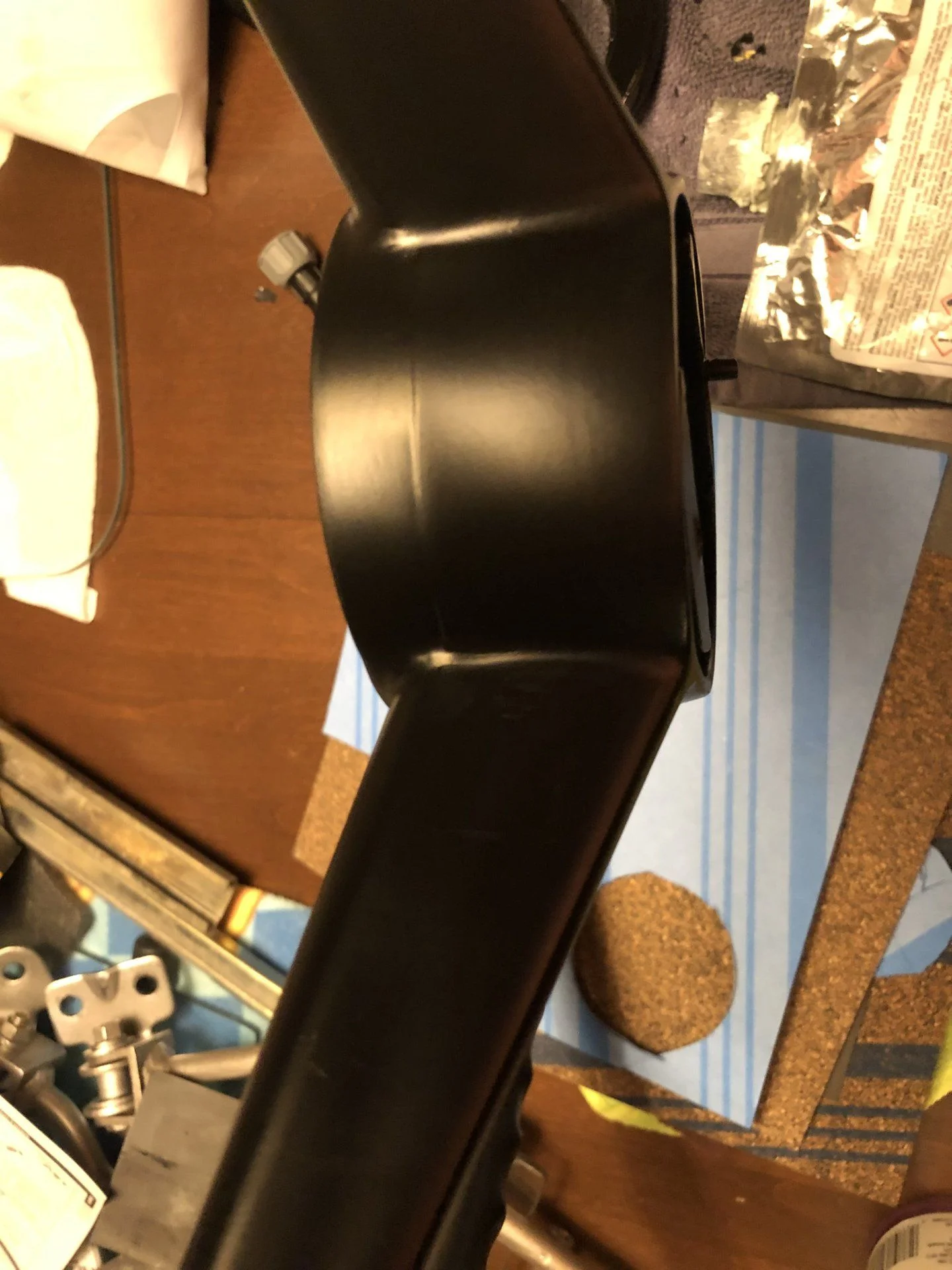

But you can see how the the wheel will come out perfect.
Here is the wheel, I have I light coat of black paint and found one side of the hub that needs a little attention

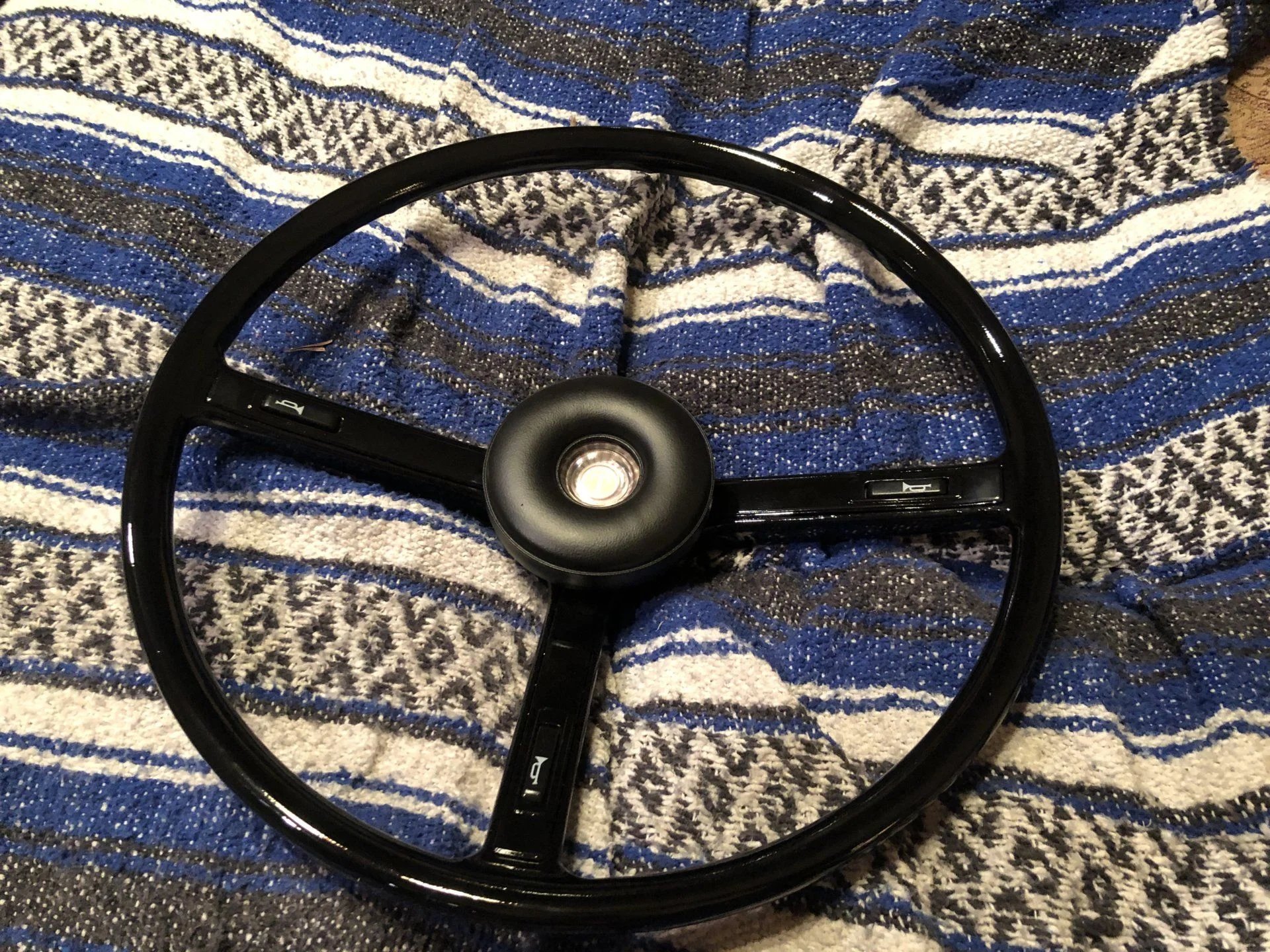

Here’s a 67’ I just did for S4cruiser
After, I didn’t realize early wheels had all chrome horn buttons.

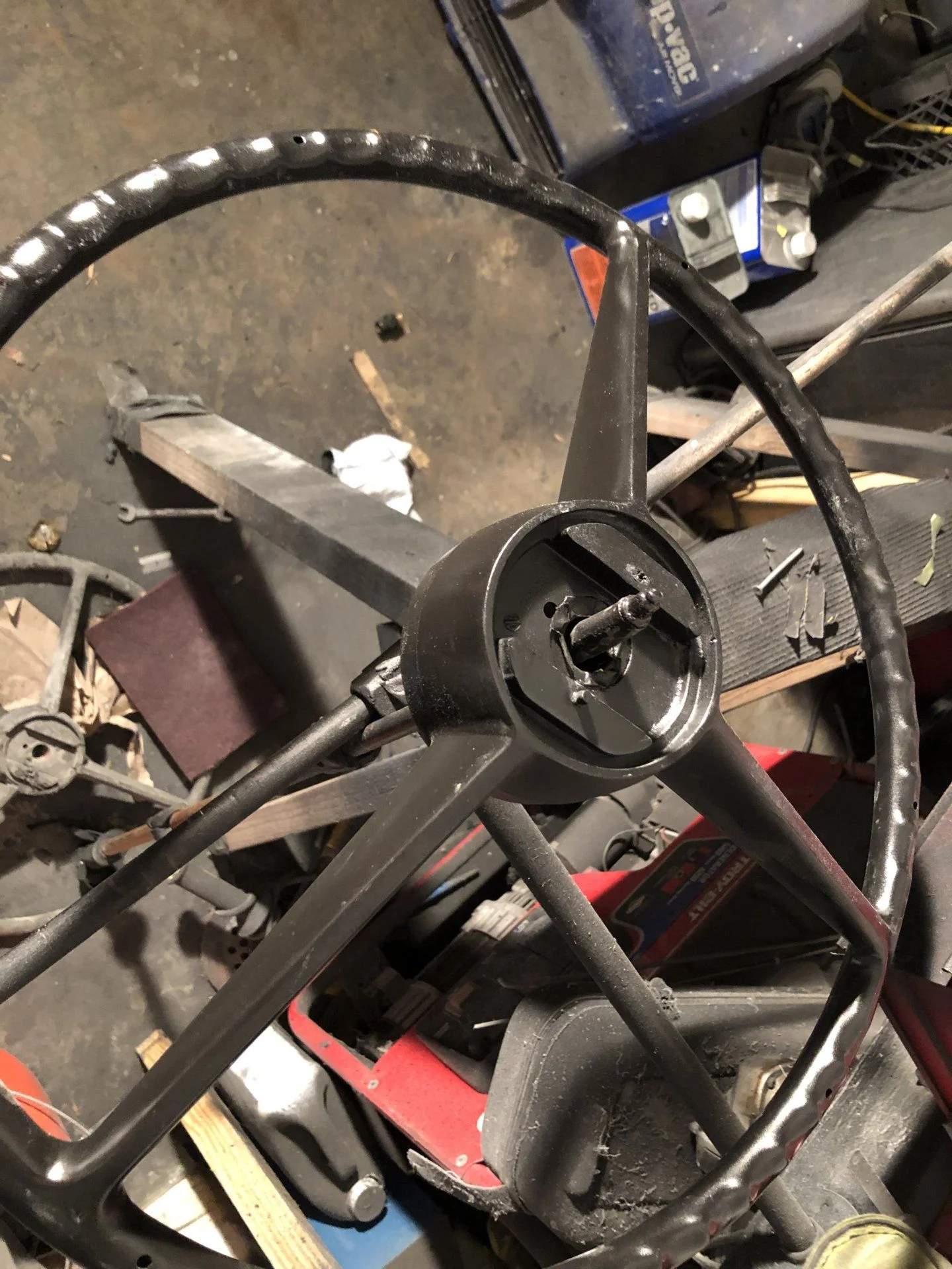

@Birdhead This has been one of my favorite threads for a while now. I've always had it in the back of my head that my steering wheel needed attention some day and that day came on Saturday. I pulled the column to do the power steering conversion and as I was bolting stuff back up I got thinking about the wheel itself.

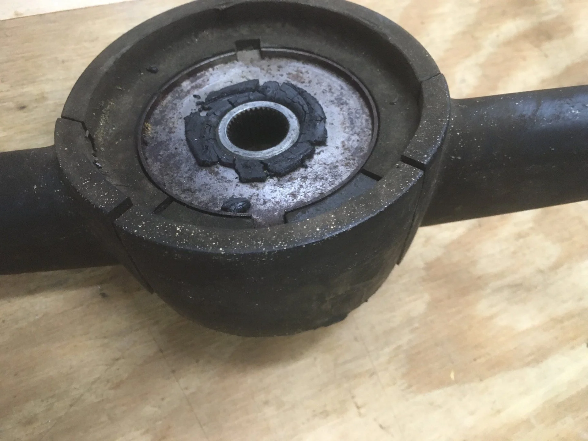

I LOVE the look of the older wheels silver center horn button. Unfortunately I have a '74. My biggest issue are the contacts attached to the 3 horn buttons. The spring steel is rusted and they are all broken. Do you have any advice for how to go about fixing that? The wheel itself has some expected scratches but is basically crack free.

Yes I have restored a few, I may have some of those parts at the house, I’ll check when I get home.

I keep an eye out for cheap wheels for parts all the time, I’ll start looking for a cheap one if I don’t have the parts.

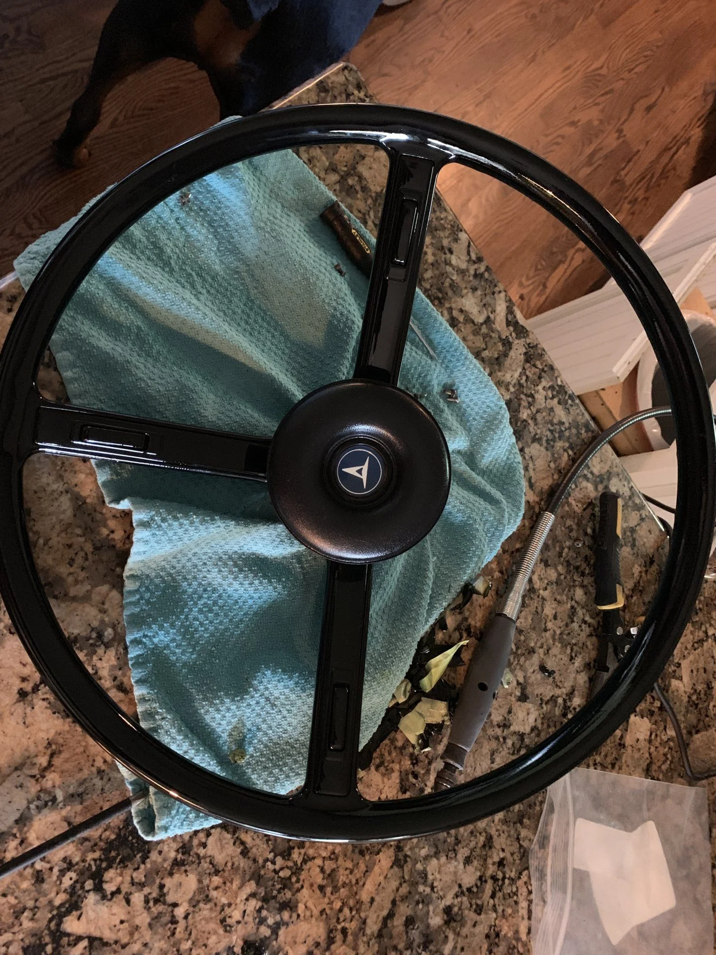

Latest two.
