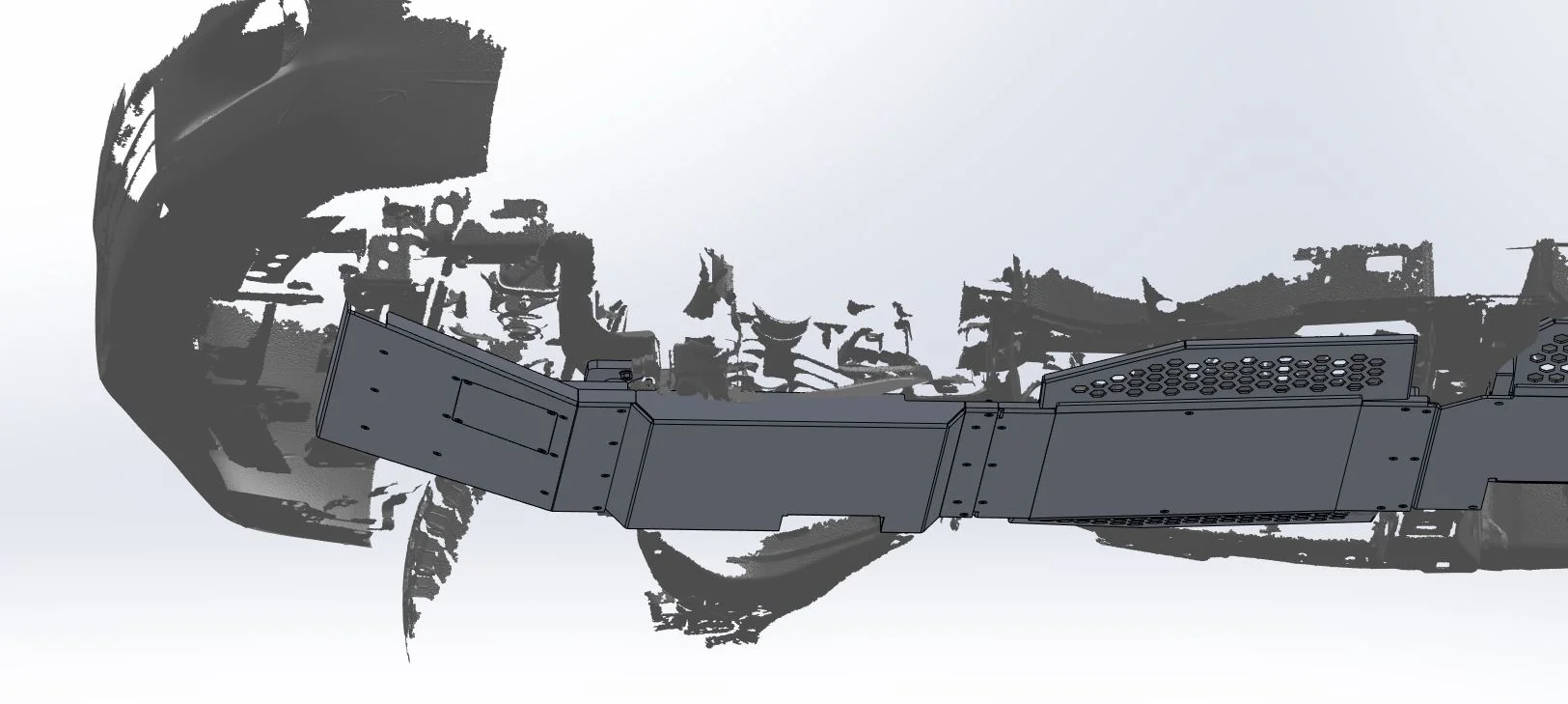

Currently, to work with diff drops everything (sub frame with skids) will need to be spaced down. Otherwise I would need to redesign the sub frame or design another engine skid that has a bulge in it, the skids would look like this, which I don't think anyone would like.

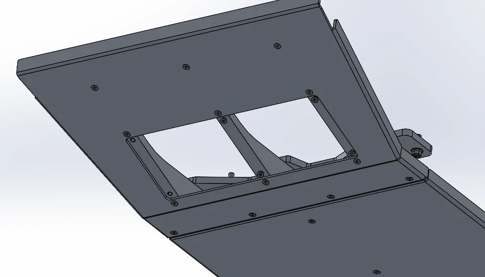

Like making the front access panel larger?

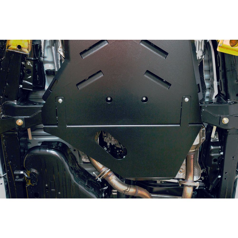

If you are talking about this, then yes:
There is a small plate that is directly beneath the transfer case that does not get removed with the Slee system.

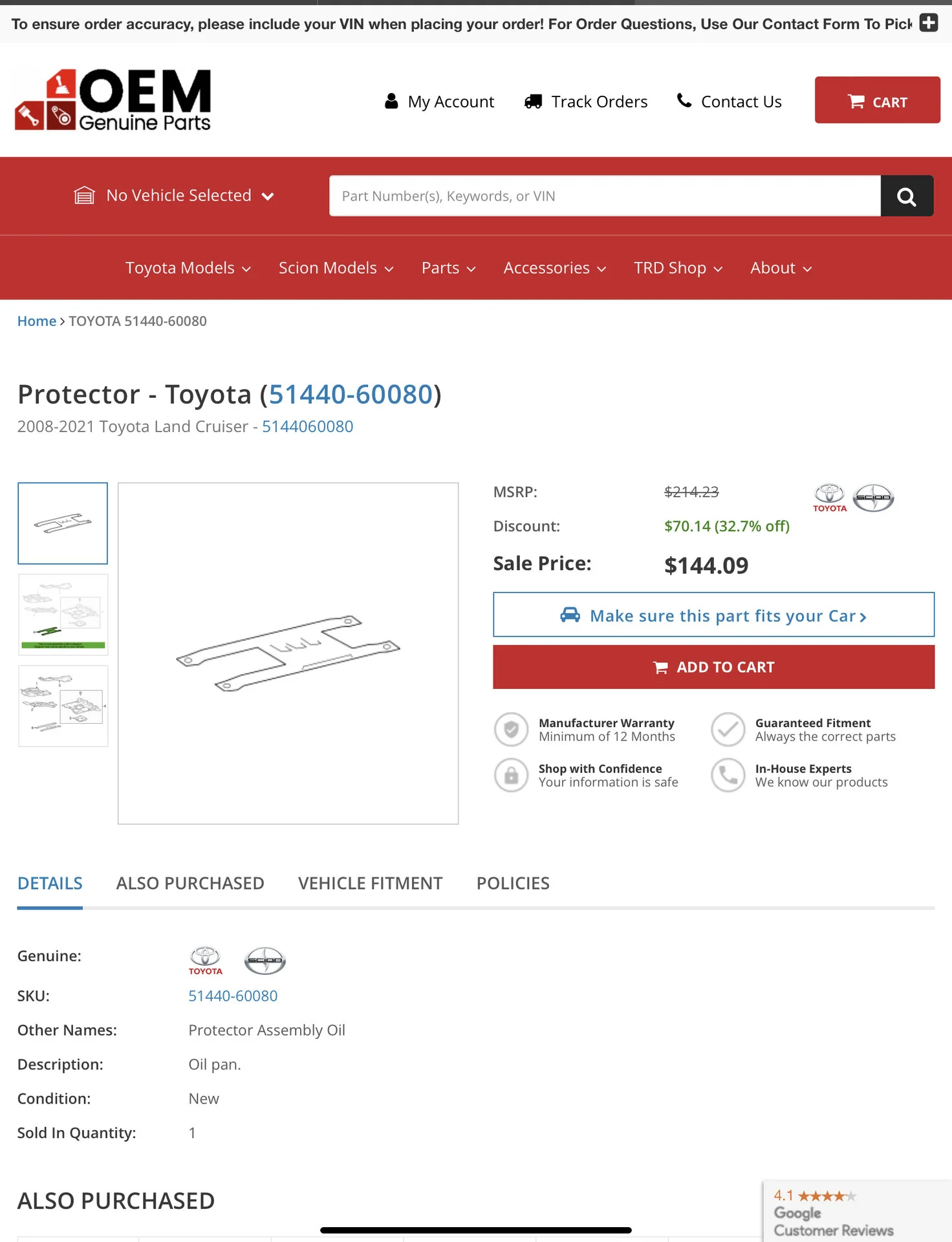

What is this plate for? Mine is very rusted and looks like i should replace it. Is it Easy to do and anyone have a part number for this?
That is the stock transmission pan guard.
Part number: 5144060080
Bolts x4: 90119A0134
I'm sure you can pick one of from someone that removed theirs for pretty cheap.

This plate in the picture covers the tranmission and part of the TC. It is the rear-most factory skid that gets removed for the Slee system. My son was under that section and removed all the factory plates so I never got a good look at it.
You can see where the one in the picture is located in this:
20200204_151436-jpg.2206542
There is a smaller plate that is attached to the TC covers the rear of the TC that does not get removed. It can be seen in this:
20200527_163722-jpg.2336115
Picture from Slee of the same area with their skids installed:
Hope this helps.
