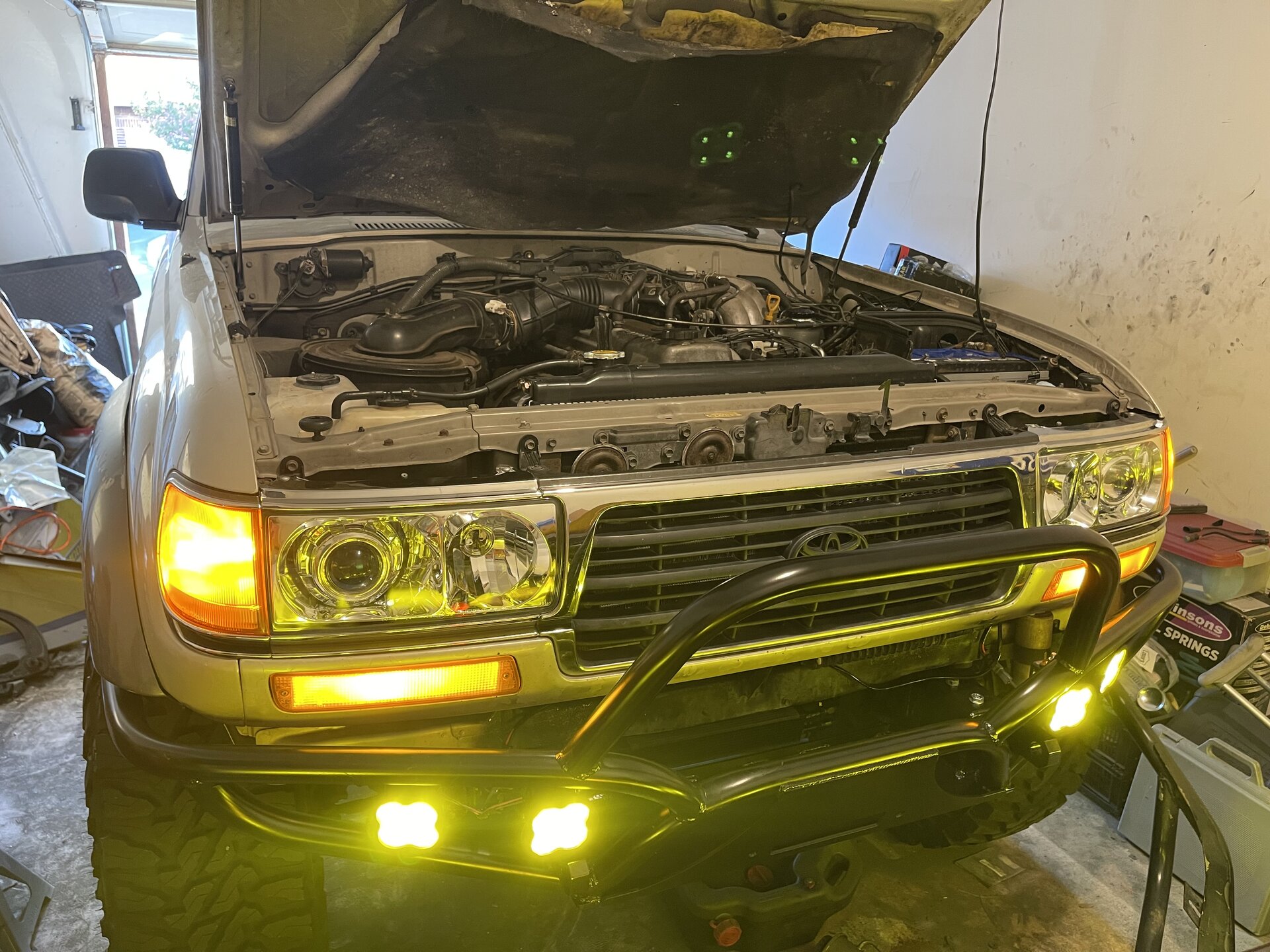

holy hell! those are the brightest parking lights! Nice work! Massive amount to have accomplished in a short amount of time. It looks like you fond a great cruiser, and are putting in lots of time making it excellent. I'm excited to see how things proceed!

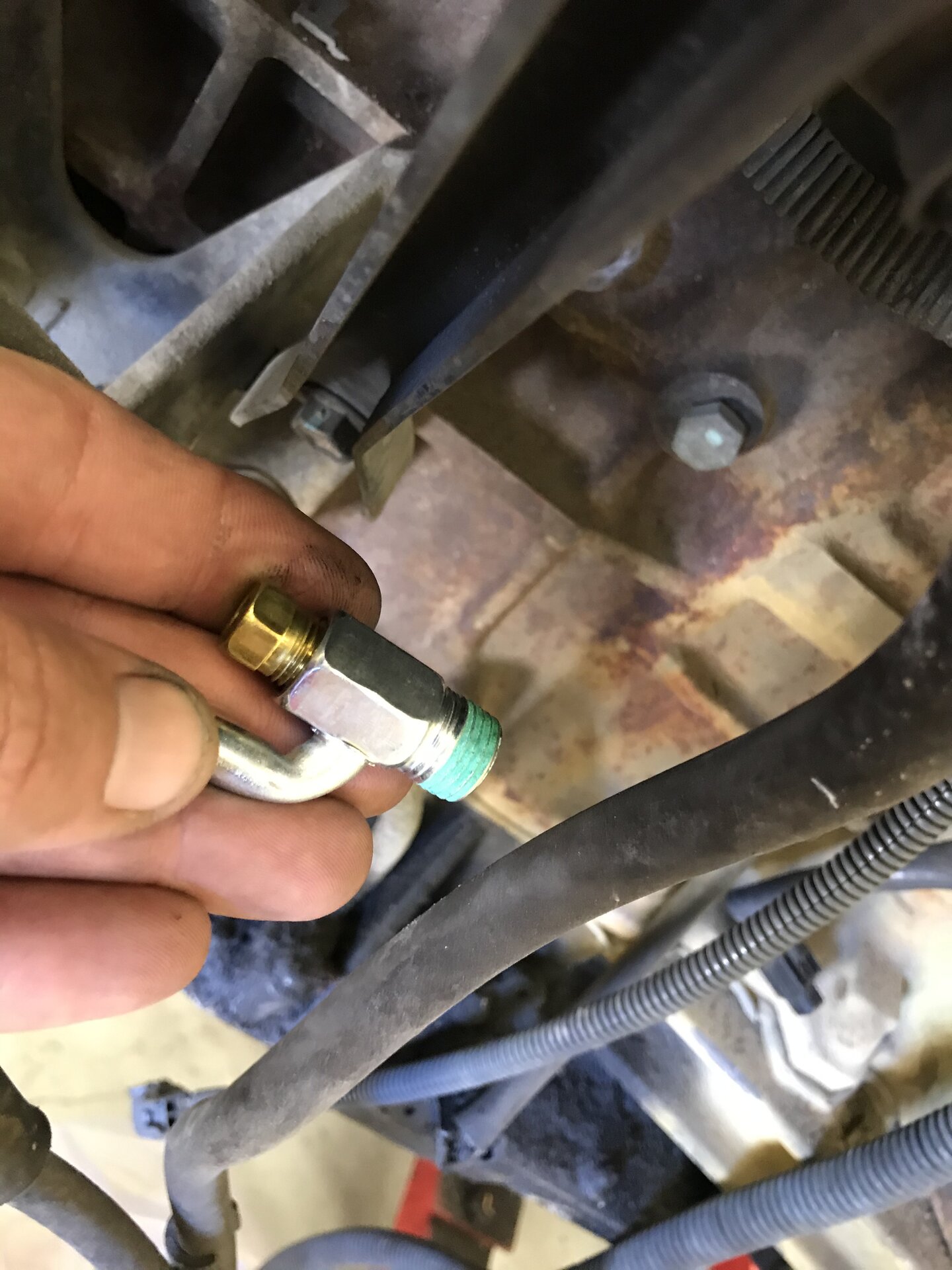

One quick note: it looks like you replaced the block drain plug with the 2uZ petcock...I'm not sure if this is the same one that Wit's End sells, but it leaked for me and a few other folks, so keep an eye on it...hopefully you saved your original plug. You may not have an issue, but I assume the block on the 97 is identical to the one on the 93.
Carry on Sir.
That’s because any of the newer style petcocks are a different thread pitch. For example when you buy a new short block you have to buy a new style petcock because the old style (just a plug) has a different thread pitch. Old not compatible with new and vise versa.
Cheers
Cheers
Hmmm....the newer one seemed to thread in fine for me. No leaks since I've installed it.
Don’t want to clutter your thread but for reference.
Old style
new style
New short blocks won’t take the old style, thread pitch is different so here in my shop, new short block gets the new style while a rebuilt block gets the old one put back in. No idea why you had no issues, I encountered this some years ago and now just go with my new gets new and old gets old so no issues or further problem encounters.
Cheers
Old style
new style
Cheers
No worries about clogging the thread! Yeah, that is strange. I thought this was a relatively common swap.
No leaks/puddles on the ground post-swap - ran about 5-6 flush cycles out the spout and has been fine since the cooling system overhaul.

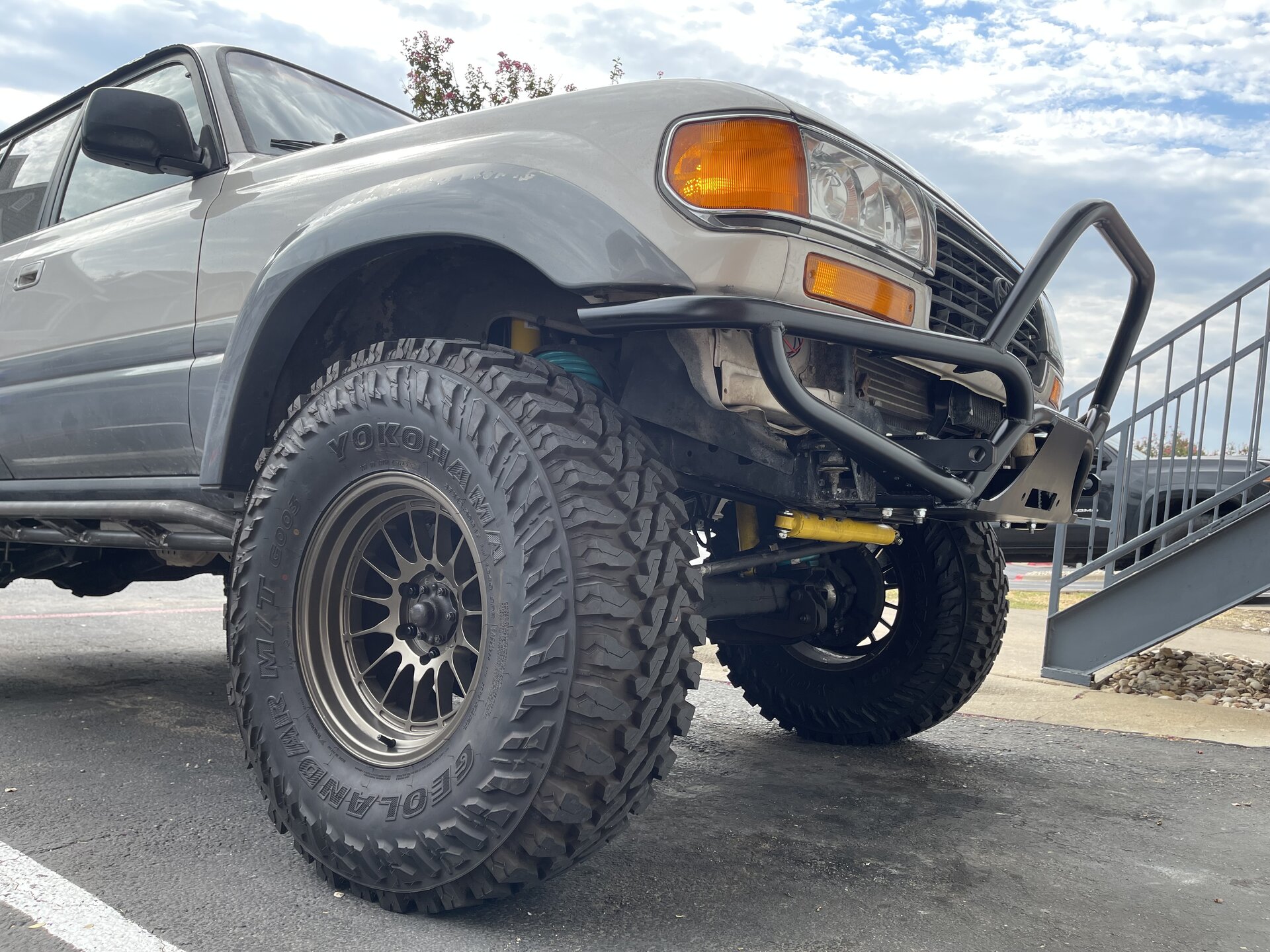

nice rig what size lift are running to fit the 37s any trimming?
Thanks - it's a simple Dobinsons setup - 4" Flexi coils (C59-614V/615V) with their longest (CS59-684/685 "6" lift") yellow nitro shocks. I had some rubbing on the front initially before the @eimkeith Radius Arm Mounts but all is good on the street right now - drives way better with some caster. I need to get her lifted again on a forklift to check my clearances…or I need to go wheeling once it cools down a bit 🤣.

Finally finished that last tricky slider leg that goes under/between the cats. We used 1/2” plate gusseted across with 2x 1/2” plates, boxed and an extra plate gusset extended up to the top of the frame. I also managed to paint…one side so far.
I like the angle these sit at, but boy is it a PITA to paint!
The week before I also dropped in the old winch. This took some….uh…creative clearancing since the control box is huge on this thing.
The center support was notched along with the sheet metal below the grille. The transmission cooler had to be moved up and a bit sideways leaving just enough clearance. I used some pre drilled flat bar and cut off lengths I needed to make sure it still bolted to (most of) the stock locations, but hey, she fits!

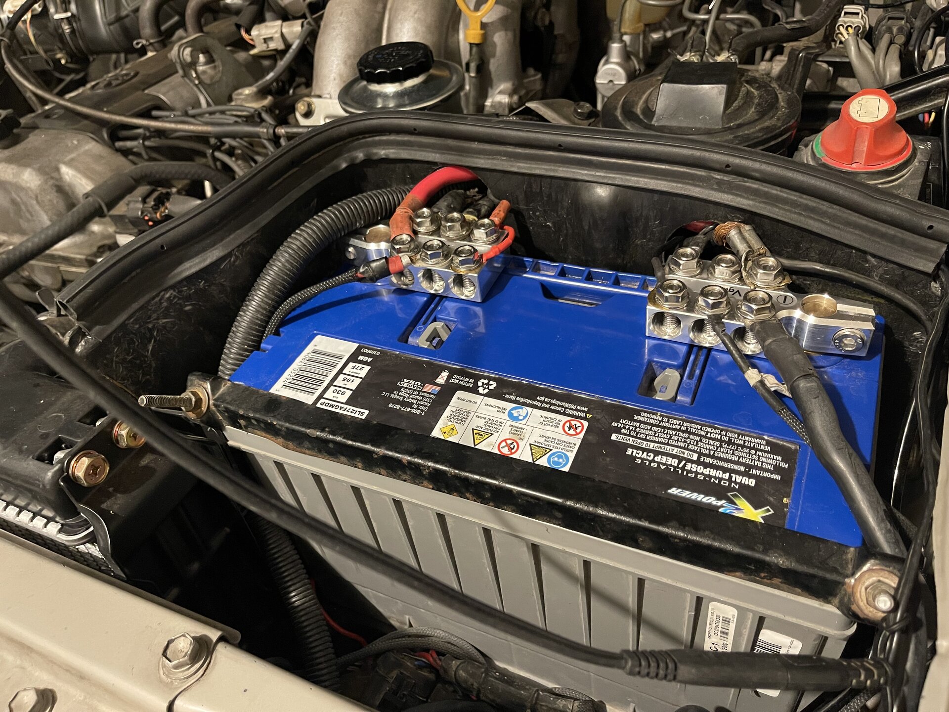

The winch left me…well zero space to properly attach it to the battery’s positive terminal so I decided to “clean it up” a little.
I had to bend off the extra length on the old negative clamp and re-drill the remaining “lug” with a M8 bit, but it all worked out. The winch lug now has a proper spot and these clamps should come in useful for later expansions as well.

Flex out on the rock and checked some clearances - the fronts stuff great after @eimkeith RAMs! Tiny bit of rub out back by the bumper covers - I could either trim, or move the lower links a smidge forward. I'll probably just leave it until I get my rear tube bumper built.
