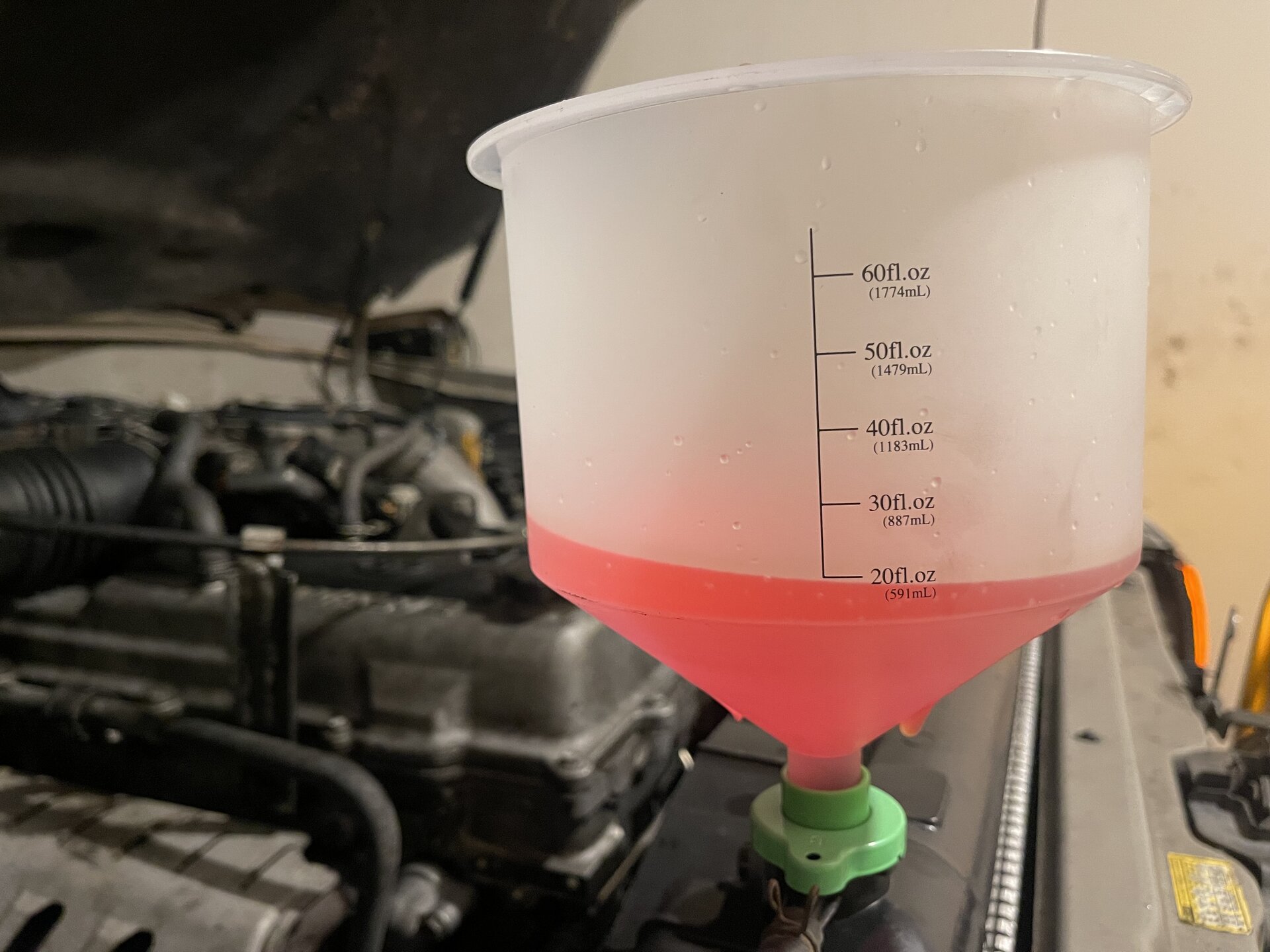

  • Attached radiator fill tool and dumped 3 gallons of distilled in. It drank a bit more overnight.
  • Degreased the battery box and reinstalled the battery/tie down. Reinstalled my tender cabling and tied in the HID relay harness connections.
  • Cranked her up - the AGM was just fine with sitting on the ground for 3 weeks. It's back on the tender.
  • New clutch fan with 25k fluid is a BEAST. I could feel the air across my legs after stepping out of the driving seat, pushing air thru the fender wells.
  • It took about 40-45 minutes for the front heater to start blowing hot. Not sure if this is normal but it sure did take it's sweet time. The rear heater came on ~10 mins before the front.
  • Temps did not exceed 181F during my 1hr of idle time inside the now hot garage. For reference, it was usually at 194-197F after a short drive and idling in the driveway (during a cooler month to boot). Impressive so far.
  • Continued to add some distilled as air worked its way out.
  • Will dump this current distilled and check the color again, it looks just a faint green so it probably caught some of the heater core green coolant that wasn't completely removed. Gonna run distilled through until it's clear then add 1 gallon red to the 3.55 gallons for roughly a 70/30 water/coolant mix. Will add a couple oz of diesel water wetter I picked up as well.

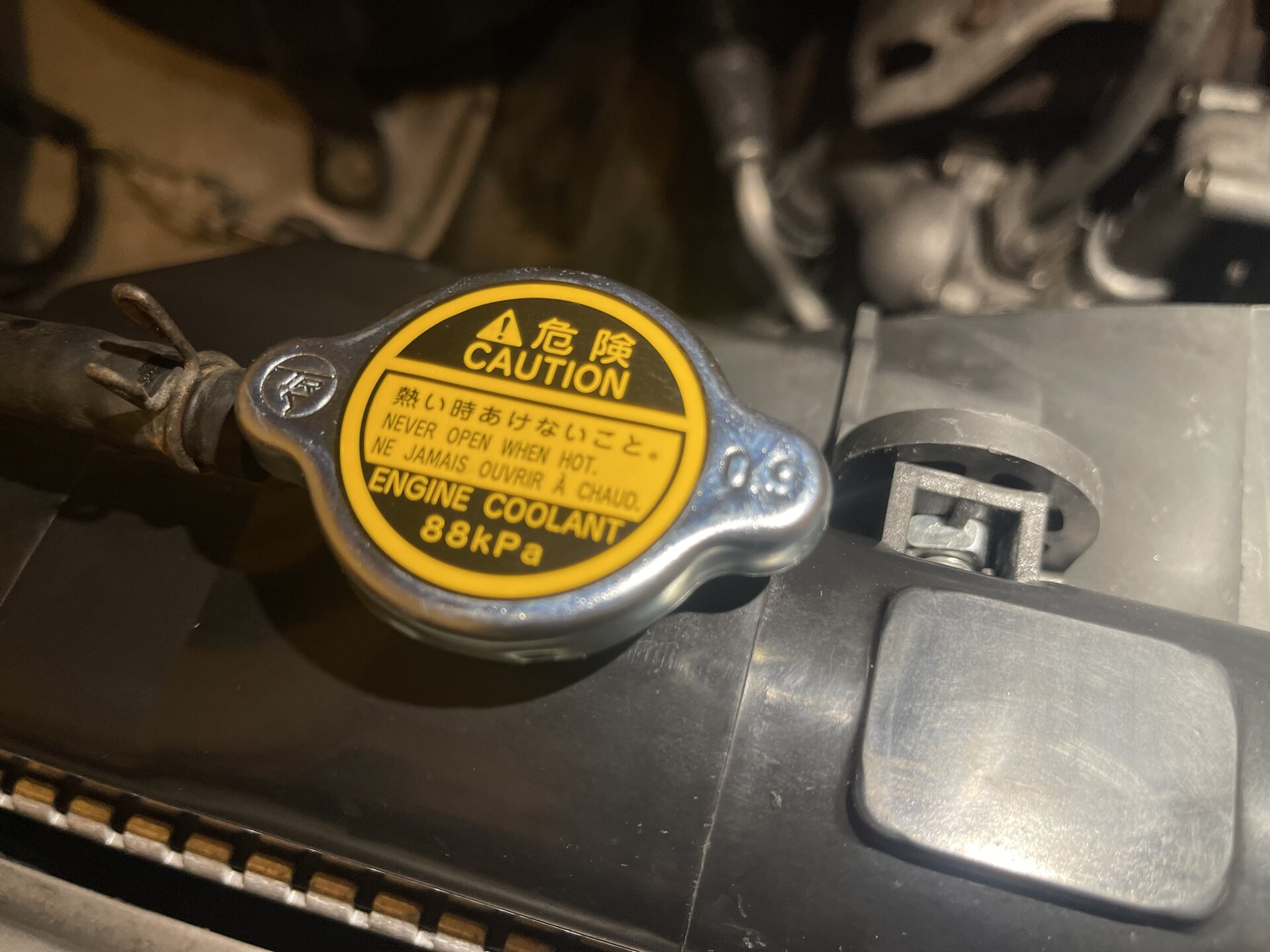

Well I tried it, but not on an OEM cap. I did it on the Sankei cap I bought and ended up bending the tabs too much. 😭
It scraped off some of the plastic that guides the tabs into place and sealed so good that I wasn’t getting any coolant back into the radiator. No good on the Sankei cap, but I also didn’t wanna do it to the oem as it’s my backup cap in case all s*** hits the fan. I bought another Sankei cap for the meantime to experiment on and if that also fails, I’ll probably just buy another OEM cap and bend the one I currently have.
I do appreciate the info though as it’s a step in the right direction, and as stressful as it is, I’d like to provide some info to fellow mudders if they’re ever faced with the same situation as I have!
You ever figure it out? I just got done flushing my system clear of the old green coolant (finally) and gave the brand new cap a tiny bend for starters and slightly overfilled my freshly washed overflow tank. I put the cap on after burping everything so we’ll see tomorrow after cooldown if she sucked any back.
I’ll do some driving around tomorrow after…another project 😉.
I’m so sorry I missed your reply! I’ve been so busy with work that there’s only been a few instances where I’ve been able to indulge on the goings on of mud! I ended up finding a thread where AZ folks used what seems to be a “Performance Radiator” cap. After giving the part number I found and ordering it, it turns out it’s meant for a Mitsubishi 3000 GT and it works fine! It does have a longer coil/stack than the oem which made it possible to run with my TYC but I’m also a bit uncomfortable because it isn’t OEM or even meant for an LC, but it is what it is.
I still have a leak, but I think it’s from the PHH (I over tightened the worm clamp and see a gash with my phone) and didn’t use OEM clamps which I definitely now regret. I was trying to get this coolant/hose refresh done for work as it is my daily and I ****ed it up by going the cheap route.

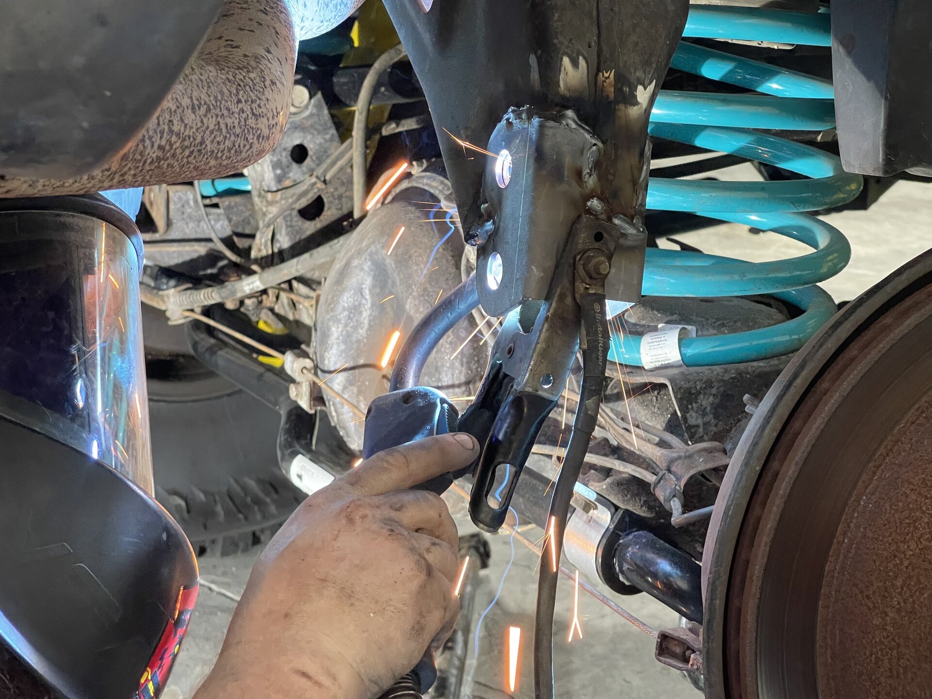

Also finally painted my new front bumper and installed - the old old rusty IronMan bumper really fought me - it didn’t wanna come off. 😠

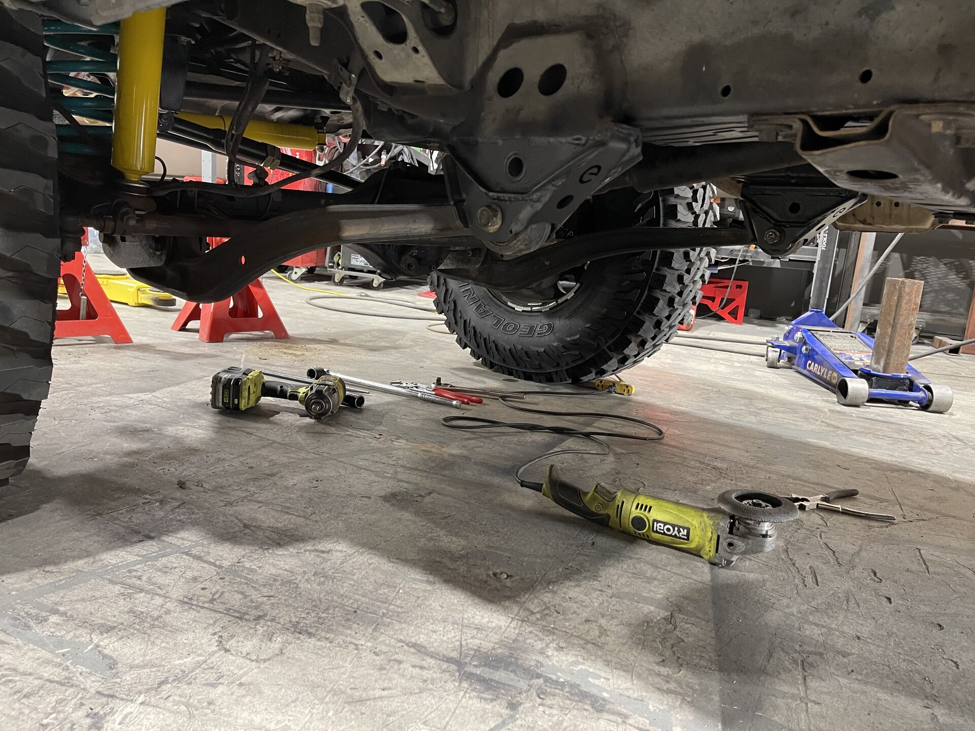

This one bolt was keeping it on - we tried welding a nut to to the top and getting it off since it was so sideways - PO tried wrapping winch line through the middle at some point and the 2/4 top bolts actually installed got very sideways.
Knocked all the tack weld nuts off the inside of the frame horns and…
Replaced with some long m12 grade 10.9 bolts. Seemed simpler and stronger since they only partially threaded.
