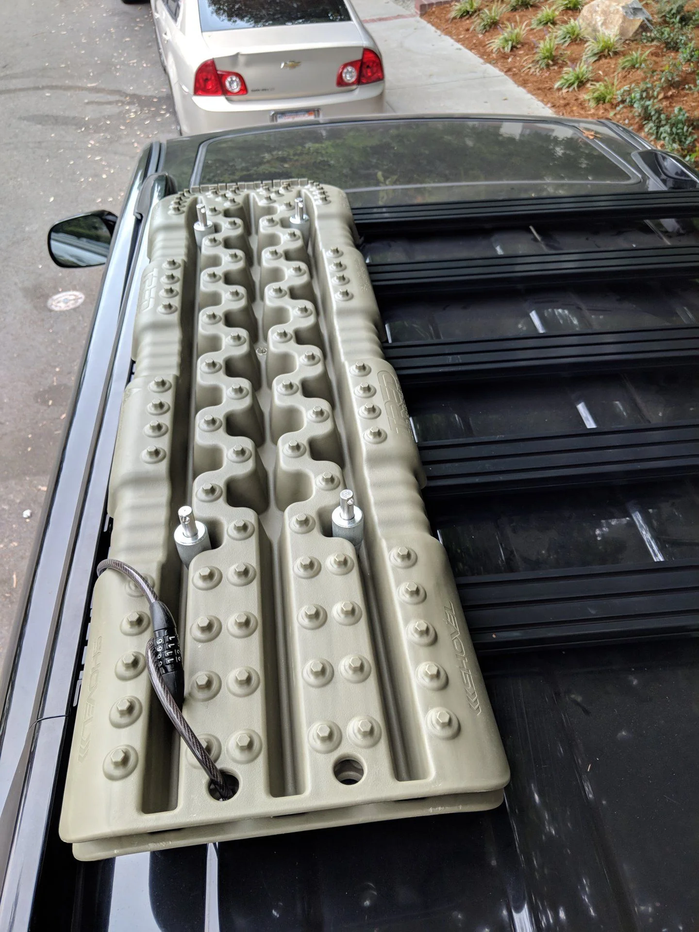

The tred mounts. I used the roll-in nuts on the 10/30. I did have to expand the hole on the tred mounts a bit to fit the 6mm bolt.

Yeah not much room under the rails. Does not block sunroof. And it's flat on top. The srock side rails are flat but the roof curves a bit. I mounted my Treds this weekend with no issues.

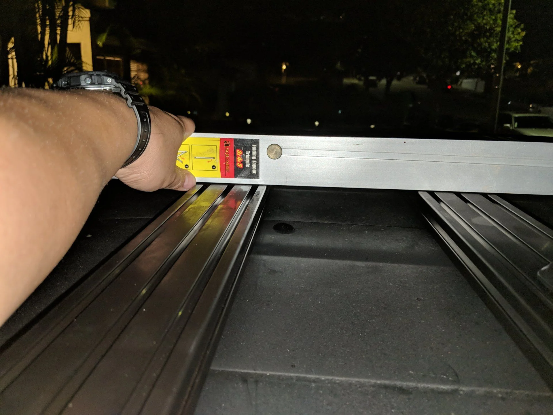

Interesting you report they all sit flat with respect to each other. I'd like to see something rigid lay across them. Could you snap a pic of like a 4' level across the bars?

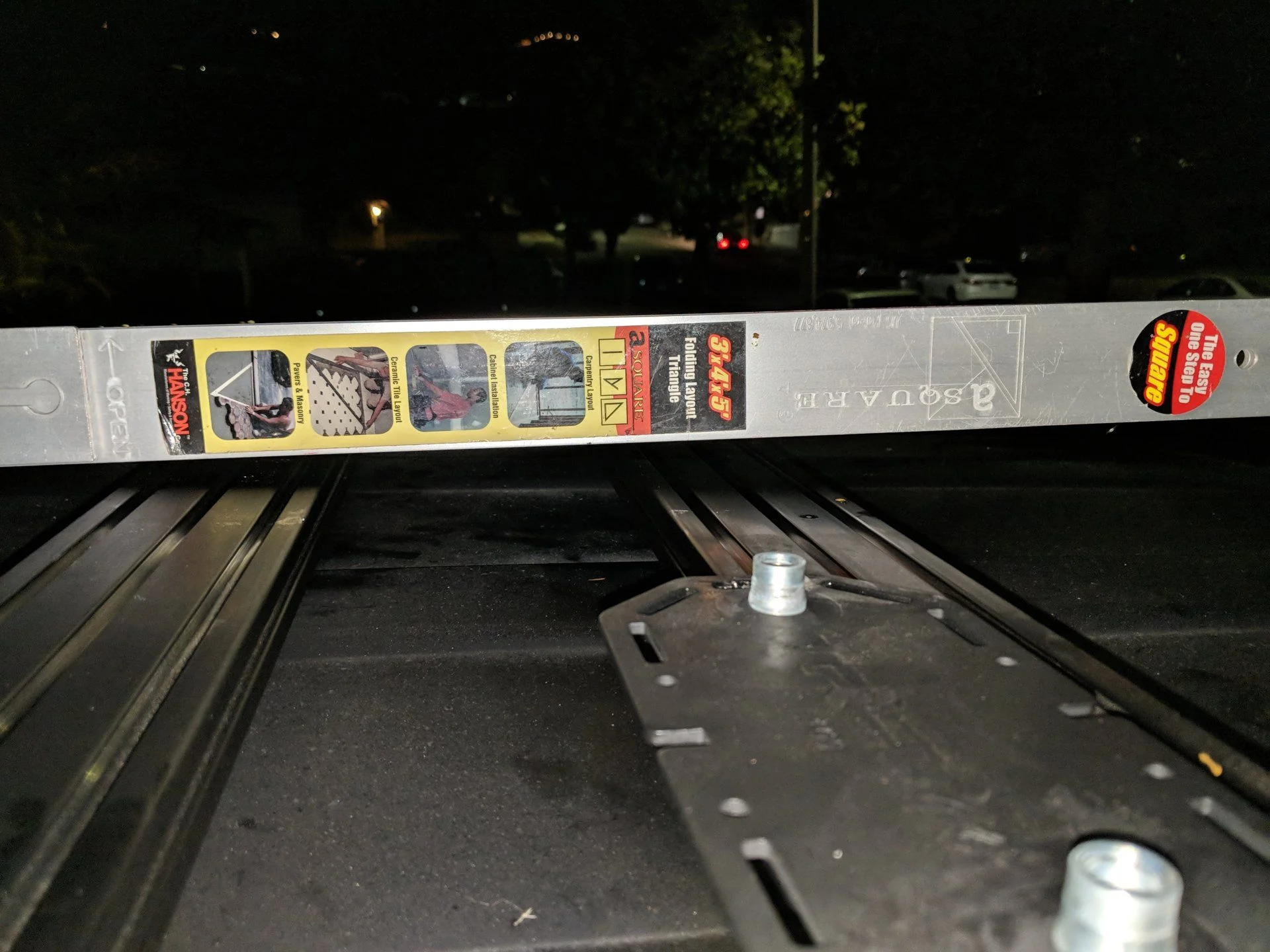

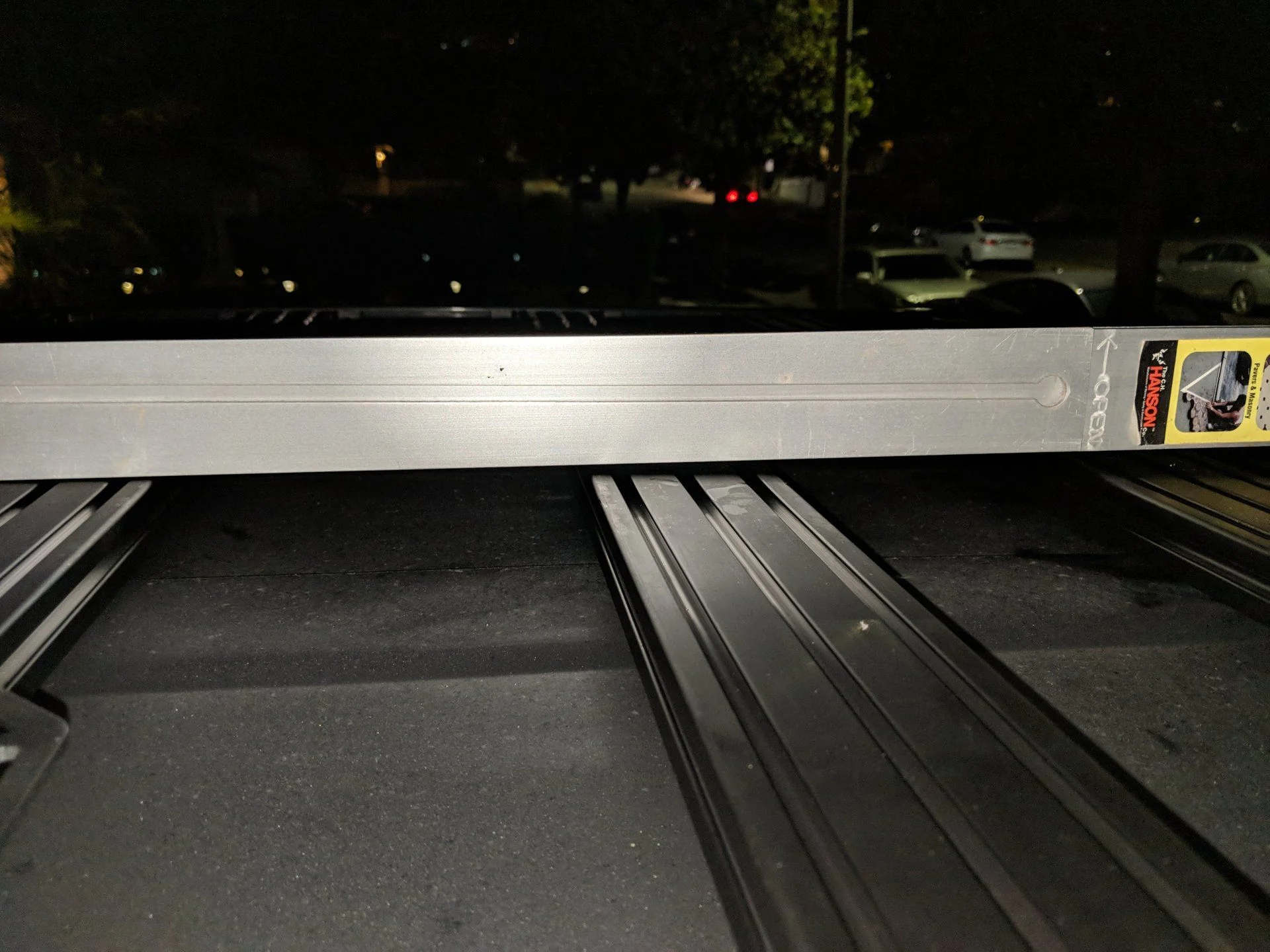

You guys are right it's not leveled. Here's a pic of me holding a folding square flat against the front crossbar.

probably insignificant for most things. I've been overcomplicating a simple mod before I pull the trigger and this level crossbars thought had occurred to me.
Thanks for verifying. I suspect if I did the over rail version, spacers could level it out. larger for front and back and the middle pair, or single if I go 3 bar, as is...
