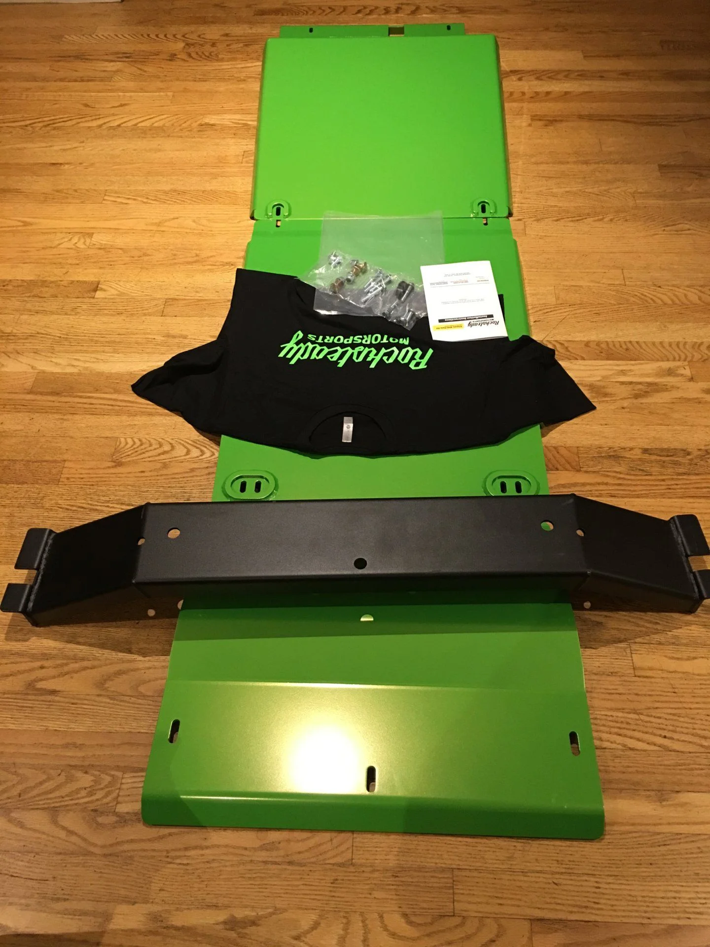

I haven’t installed my RockSteady aluminum skid plates, but no weak brackets on this set.

The rocksteady alumninum skid plate full set is 50 lbs probably due to the heavy duty steel bracket to hold the transfer case plate in place.

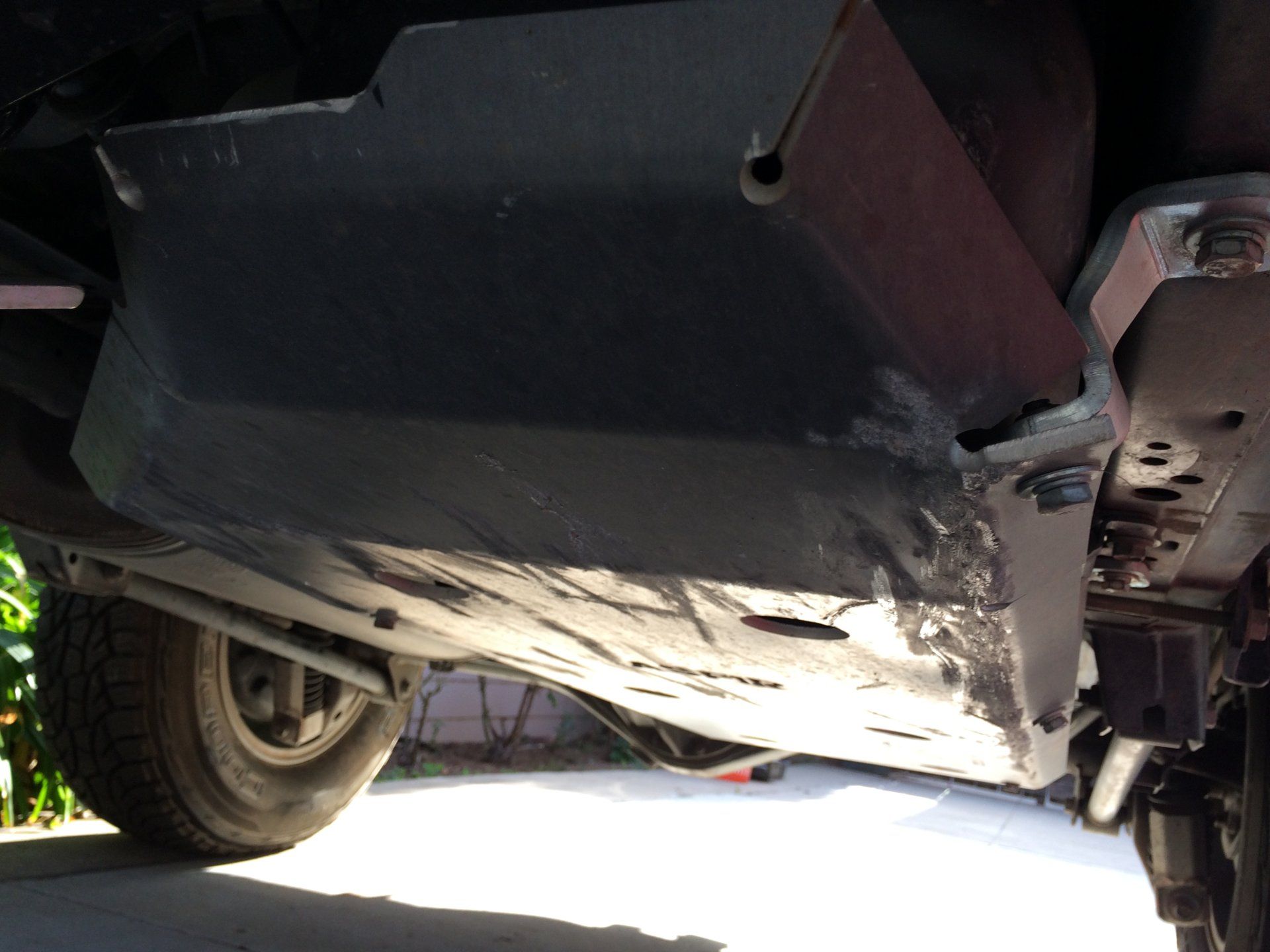

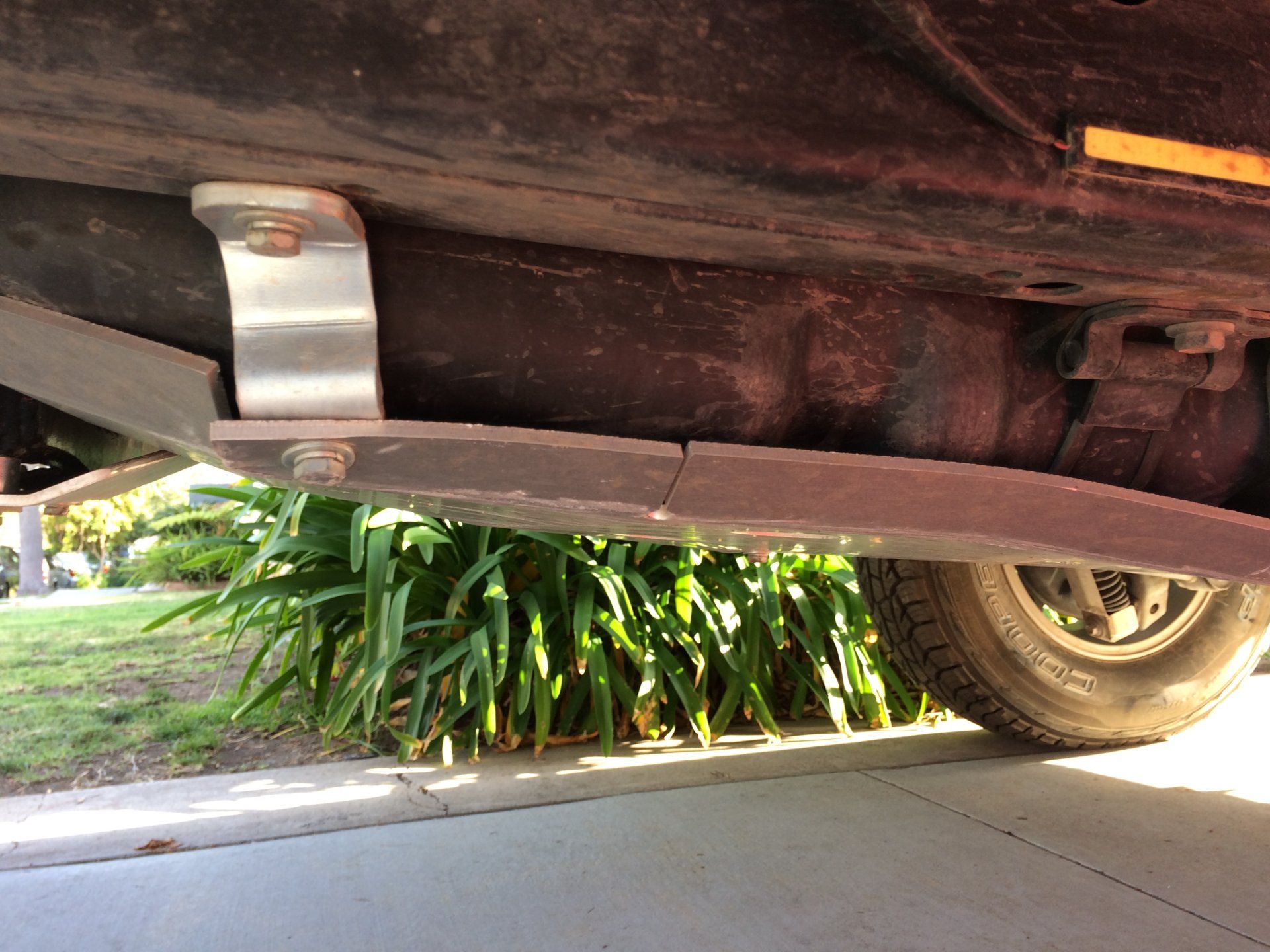

Yeah, my gas skid took a few bad hits trying to get out of a water hole so I hit the ledge about 4 times on the front of the gas tank skid which is the low hanging fruit. Bent both the front of the skid and the steel bracket from the skid to the frame.

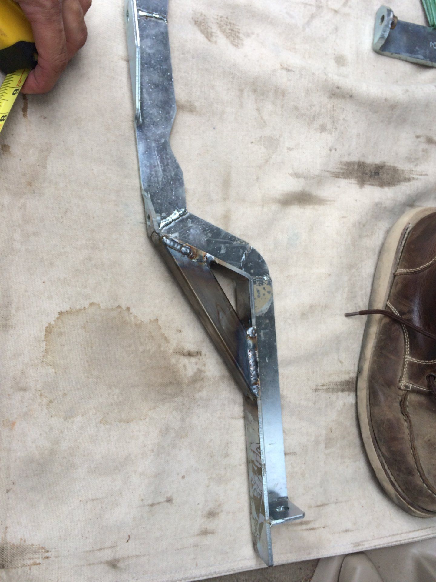

All the brackets on the ASFIR skids are nikle coated steel and I reinforced the long middle support as preventative because it looked like the weak link and @DanKunz had done it also.

Ah...that was the gas tank skid plate whose bracket bent. I didn’t get a gas tank skid plate. You think the stock oem gas tank skid plate is strong enough to bet beat up at Moab?

yeah, that reinforcement looks good. Looking at how that skid is made, I'd have those Al joints TIGd closed. more strength and structure to that pan.
