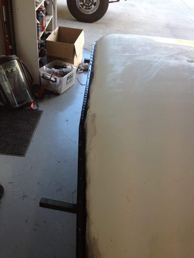

Started the tear down of the roof, here's what I started with-
As you can see the steel gutter edge has seen better days in some spots, but nothing a grinder and some touch up welding cant fix-
Well cut out the crap parts on Saturday and welding in new steel to the affected areas. Didn't take as long as I would of thought. Next stage was to get the wire wheel running along the inside of the channel to remove all the factory chalking, and some silicone that a previous owner must of pumped into the channel to stop leaking.
Got the full POR-15 treatment that I have been using on the truck, once again I should of used gloves while using it - it lasts for days on your hands!
Then starting filling the channel with Sikaflex. I'm going to do several thin layers of this over the next week to build it up, hopefully filling most of the channel to prevent water buildup. I thought about fibreglassing the channel in, but the Sikaflex will bend and move with the truck as required - no chance of cracking then.

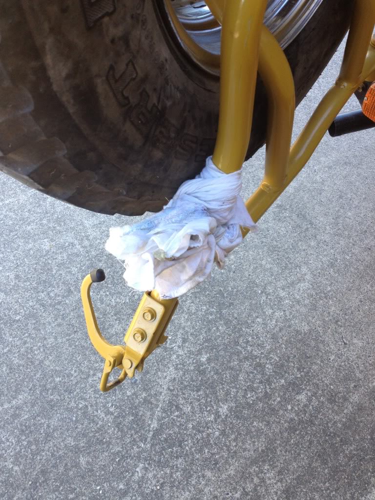

Also found a rubber cap to put over the end of the handle, this works well to stop paint chipping off when closing the catch. Still have to find a small spring to complete this section off-

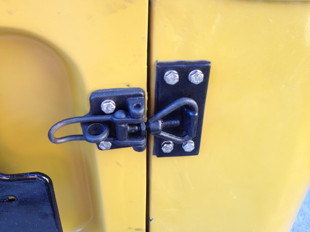

Made up a locking catch for the swing out tailgate. I didn't even think about having a setup on the inside until after I had done it. But at least this design uses the existing holes on the outside the the ambulance door hinges would of been on- Just got to paint it up now, going to stick with a black for this one in case a padlock ends up chipping away at the paint over time.

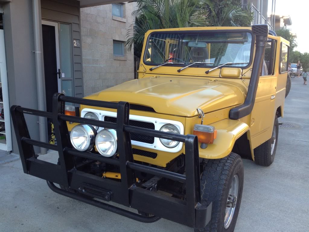

While still waiting for the paint to dry, and avoiding the fridge, I decided to get my spotties out of the box in the spare bedroom. Slowly I'm working through the boxes in there, and much to the :princess: delight I'm down to only 4 boxes in there now. Got the steel wool on the chrome pieces of these, and they sit pretty well on the bar. Haven't wired them up yet, that will be a job for later-
They are the IPF 900 model. I used to think they were as bright as I would need, until I found a HID kit for the headlights in one of the boxes in the spare bedroom. Whacked this in on Saturday arvo as well, and was amazed at the light output. They are a 55w 4300k kit that I bought on ebay a while back. Well after seeing the light output on these I went inside and started looking for an upgrade kit for the IPF 900 spotlights. From the pic you can't really appreciated how much different the light is, when I clean out more space in the garage and adjust them, I'll take some better pics of with and without the HID kit.
One problem - how crap do the parking lights on the fenders look now :doh:

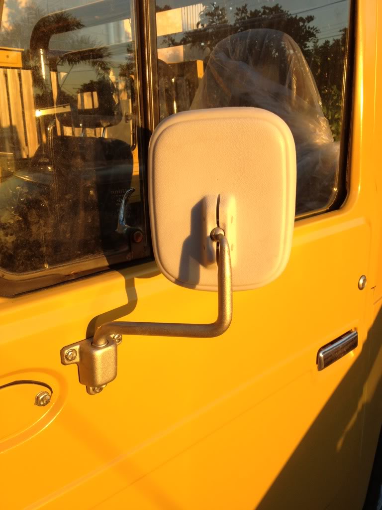

Can you source the gaskets between the mirror and the door?

I usually just cut my own bit of neoprene rubber for the gaskets, but for the mirrors I used the ones that came with them. I had bought these for my old truck, just repainted the arms after a little surface rust. Its only a piece of black plastic, wouldn't be too hard to make up though.

FJ , this is what the original looks like, I assume mine is still as it was fitted by Toyota,,,

Whats wrong with mine?
But seriously yeah I have thought about it, but thinking I need a bigger bit of rubber as the stock one doesnt protect the tailgate as much.

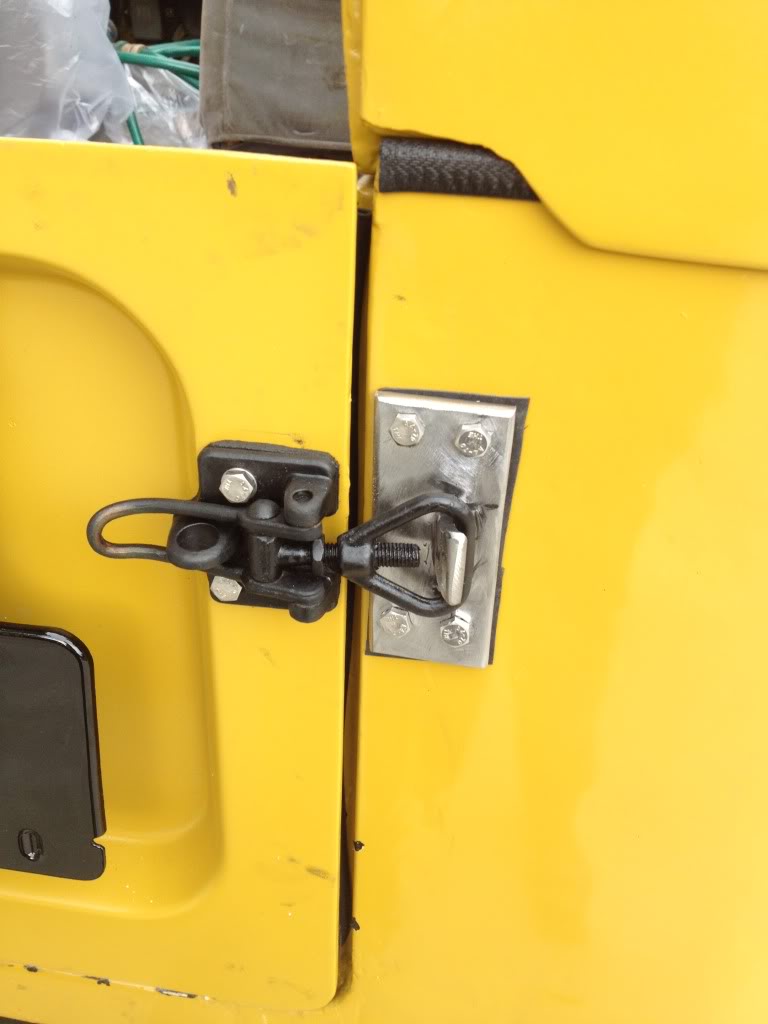

I was thinking about something like this for mine.
I think your latch is awesome, I was on a boat this past weekend and it inspired me to look around for marine grade stainless stuff for my doors, I found your latch in stainless for cheap!
Latch ->Cabinet Hardware

I love the look of that, I might have to look around for a stainless version in marine shops over here.
