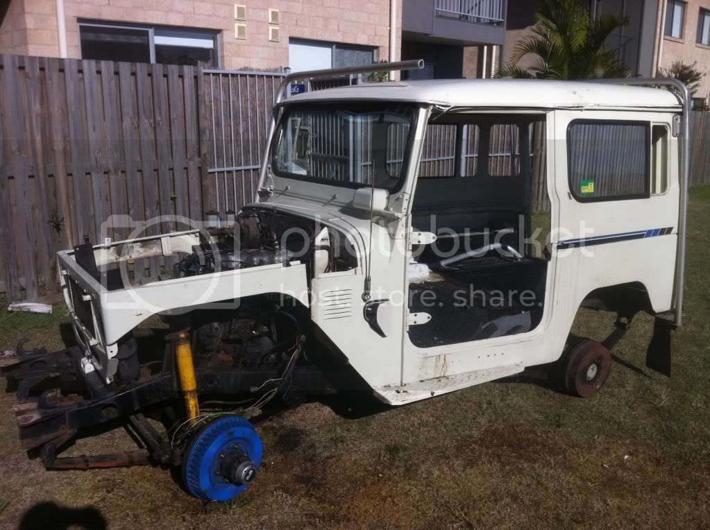

Well I was lucky and had it insured very well, so when it was written off by the insurance company, I bought it back and took what I wanted off it for the new project. Here's a shot of what was left after I pulled off what I wanted to keep, and anything else that I could sell off on eBay and to some mates.

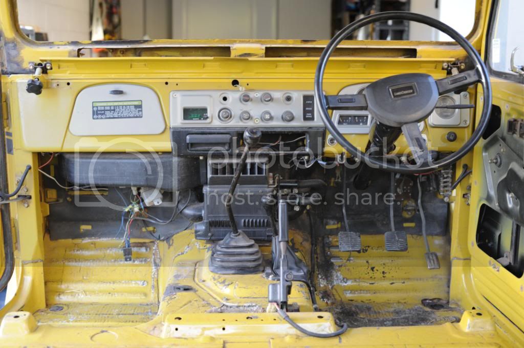

After a few weeks of anxious waiting for it to arrive, it finally arrived one evening last week. Before touching anything on it I decided to go nuts with the camera. Out of the 600 odd shots I took of it, detailing each little nook and cranny, here are a couple to show what I'll be working with -

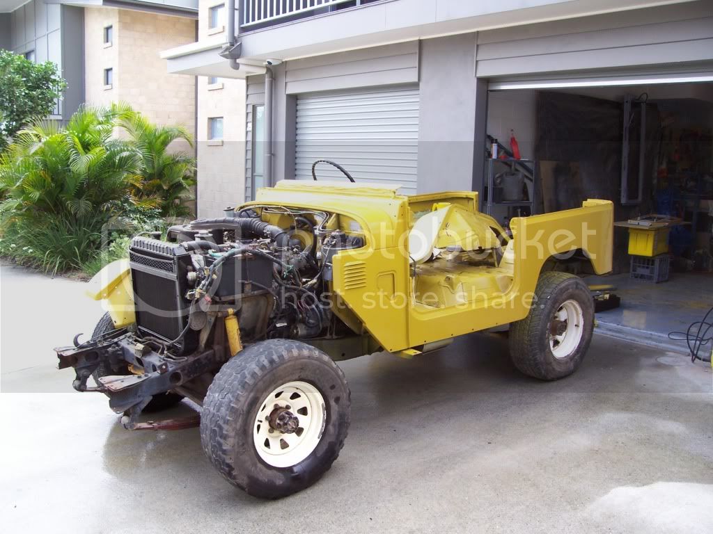

Well the first arvo I got a chance to have a play with it, I spent nearly 3 hours with the degreaser and high pressure cleaner working away at the grime underneath. I was really surprised that there was no rust damage underneath, and the floor pans in the front were spot on perfect.
Next step was to drop all the fluids in it, just to check I wasn't going to waste my time cutting all the rust and repainting before realising something was cactus underneath. All the oils looked fairly clean, but the diesel in the tank was pretty dirty. I emptied the water separator and was surprised at how much crap came out of it -
I didn't end up dumping the radiator though, as after I cleaned up the engine bay I realised I would need a new one- the core was pretty much rooted in some spots.
So after I got it running I backed it into the garage for Saturday evening's entertainment. Stripped off the roof, and the rear side panels. Then had a few beers looking at it while the :princess: was inside looking at wedding planning.
With the top off I could see just what I was in store for with the rust removal on the lower panels. The previous owner had this in a panel shop for a year before he sold it, with it basically looking like the rear corner panels the only work left to be done before a respray. A bit of cutting and some new patches welded in and it will be sweet-

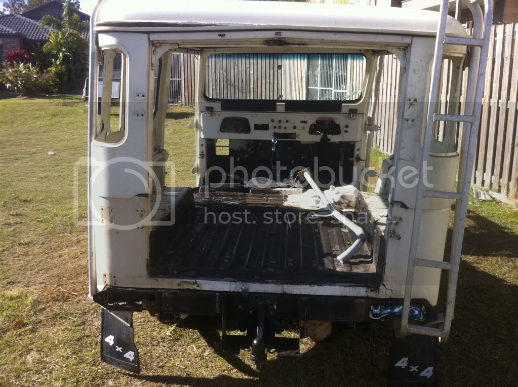

Well during a couple of evenings last week I finished off the metal work at the rear of the truck, then prepped and coated with the POR-15 products.
Well as you can see my welding leaves a little to be desired (I'm using a gas less MIG) but nothing that an abrasive disc wont clean off.
Gee that Marine Clean and Metal Ready stuff is strong on the nose, I now know to make sure I do it outside of the garage. Definitely works though, the paint is the hardest of anything I've ever seen.
Removed the window frame as well and coated it with the POR-15, then tackled the rust under the sill. Although it looks like a bit patch, it didn't seem to hard to fix up. Here's a bit of what I was up against, I've only just realised I didn't take any shots after I fixed. :doh:
