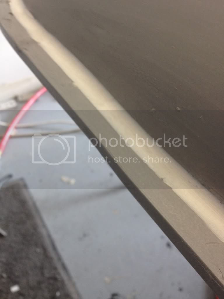

Well the roof came along pretty good, got the final coat on it today. Here's the Sikaflex filling up the channel-
Then after the primer-

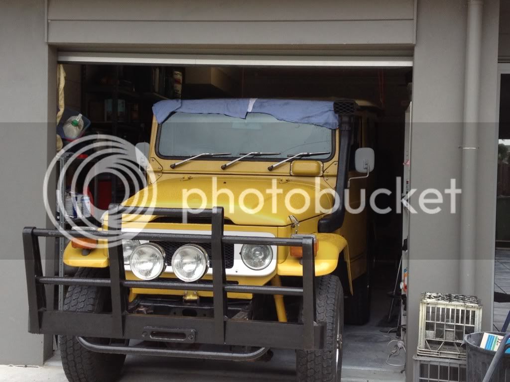

The moment of crapping myself thinking it would fit out of the garage, luckily it had a few inches when I pushed on the roller door-

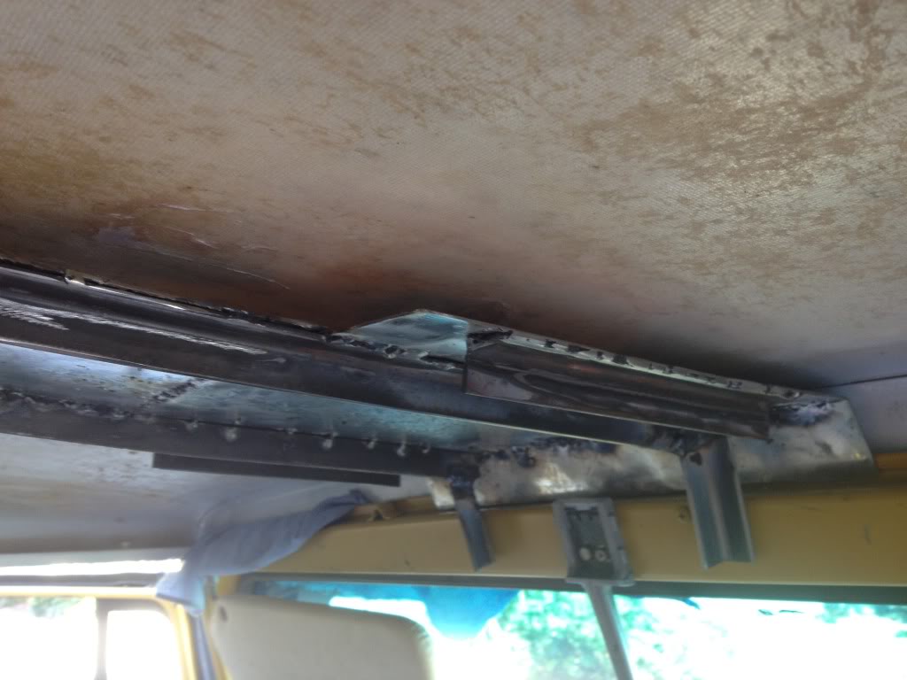

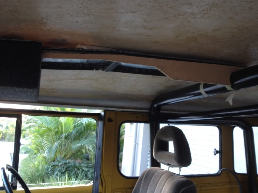

So now that I had the roof on, I decided to make up a centre roof console that I could have installed with or without the roof being on. So I made up a template to match the curve in the roof line from the rollbar to the windscreen, and welding up a steel frame. Attached 1.6mm steel to the top of it to keep the water out of it if I ever got caught without the top on in a shower, and covered the steel with marine carpet, with the edges taken care of with rubber edging. Then made up the underneath with marine ply so I could get the curves and contours that I wanted.
Made a neat little spot that I can put small items in, and there is plenty of room for switch mounts and another radio in the future.

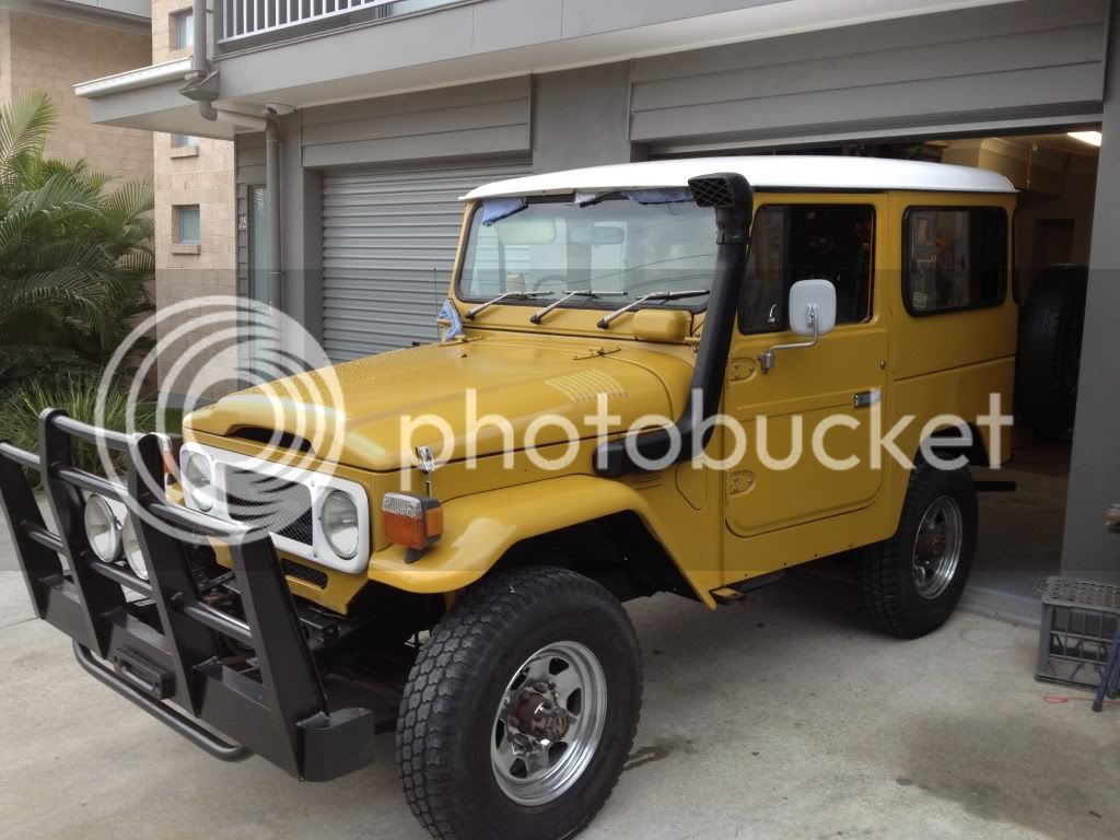

Finally finished off the snorkel install, although these pipes were a bit tricky getting around the side of the air filter.

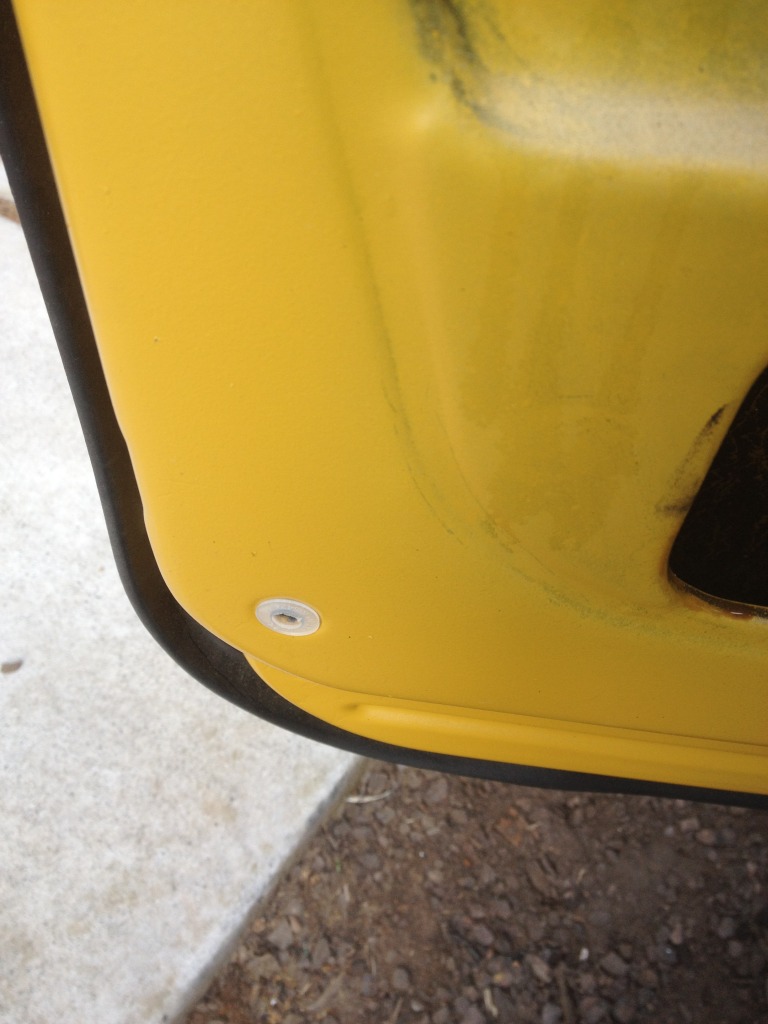

Went to town on the Tectyl spray on the inside of the doors, hopefully this should keep the rust away.

The home made hoist worked well, and although having to squeeze down the side of the truck to pull the ropes up in the single car garage, I still managed to do it without any damage to the truck or panels.

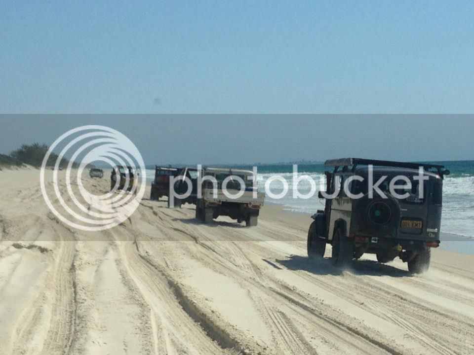

So the first weekend in October a few other guys from SE Qld went up to Bribie Island for the day for a cruise along the beach. Was great driving without the top on, until that night when I got home and realised I was quite sunburnt :frown:
The truck drove well for the day, was the first time I had taken it off road, and seemed to go pretty good.
Well everything went well, except the UHF CB didn't work properly, I must of buggered up the antenna connection somehow. Other than that though was a great day out.
