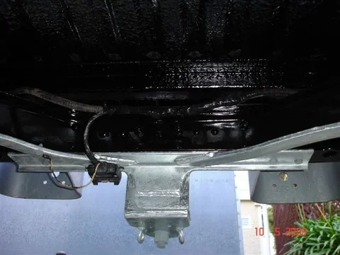

Then painted the rear bar and installed new tail lights- gotta love having a disabled car park opposite my garage! :)

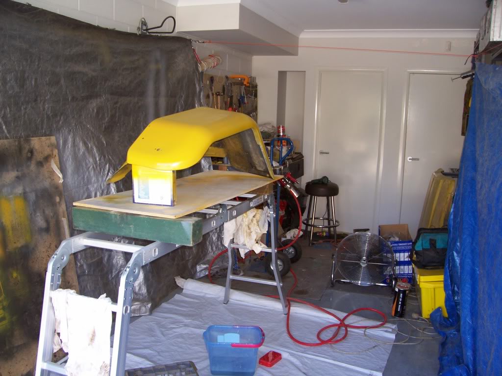

Well the spraying in the garage has definitely worked, here's the set up. I had the roller door half down, and the fan worked a treat sucking out the fumes.

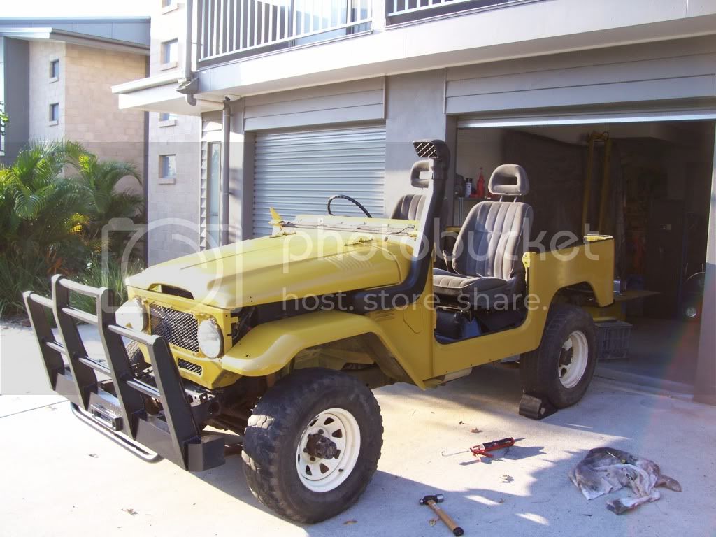

Well got the front panels back on yesterday. Stinking hot in the sun, but steered clear of the :beer: .Was a bit difficult to measure where they were meant to bolt and tighten because I haven't got the bonnet ( hood for you Yanks ) hinges done yet. So I had to sit the bonnet on and go from there. I haven't done the little side panels yet either, this was because I have to cut the LHS for the snorkel fit-out.
Once they were on and bolted I played with a new snorkel I bought a few weeks back-
With the snorkel attached I decided to bolt my newly acquired bull bar to the truck. Gee this was heavy, ended up sitting it on an esky (cooler box for you Yanks, chilly bin for the Kiwis) with a couple of phone books to adjust to the required height. Then it was a case of using the hi-lift jack for the finer adjusting.
Now that I have the bar on it should be a lot easier to paint, I'm going to do a hammered black finish. Have to weld on a few other tabs first though for my UHF radio, and some extra spot lights.
