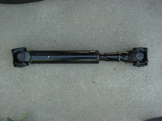

Driveshaft is in!
I ordered up my rear driveshaft to be stretched - 26 inches, flange to flange...
It came in, and I estimate about 1.5 of the ~2 inches of slip are inserted. I think this will work well, as I believe most lift spring packs settle in a little bit over time, which should expose more slip yoke.
