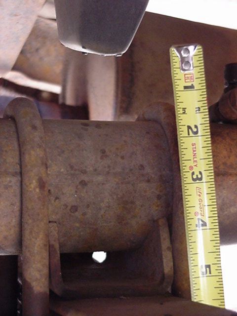

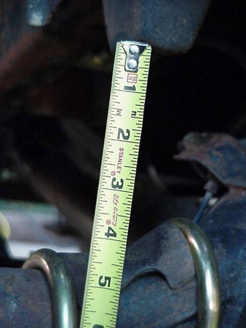

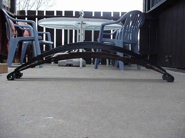

Flipping rear spring pack to extend wheelbase
First pic shows the two rear springs side by side to measure spring pin offset from center. About 2 inches offset from center, or 4 inches difference btwn mounting springs conventionally, or flipped.
Wheelwells will need to be opened up, and exhaust pipe moved.

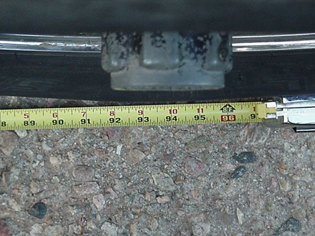

Wheelbase
Tried to measure wheelbase with a tape (I can't claim perfect precision), and a pic of front shackle angle...
