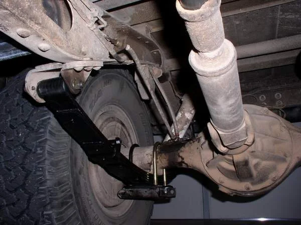

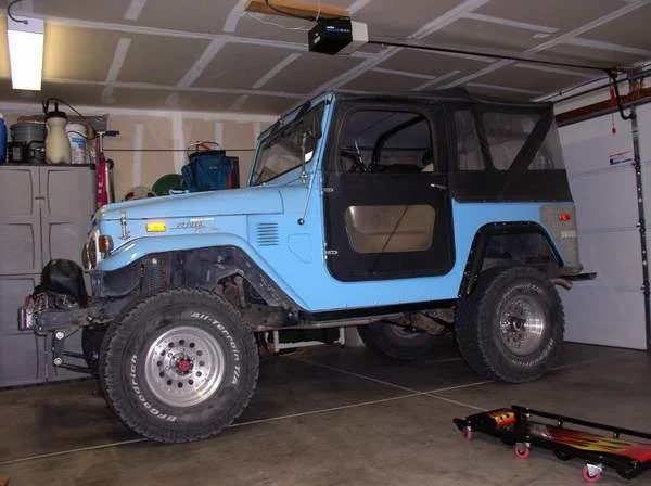

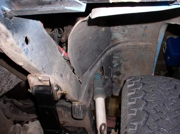

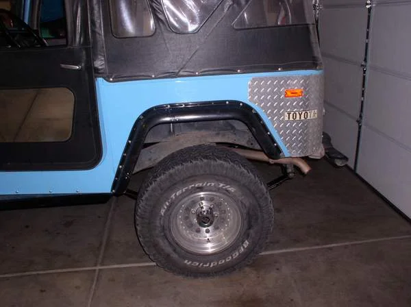

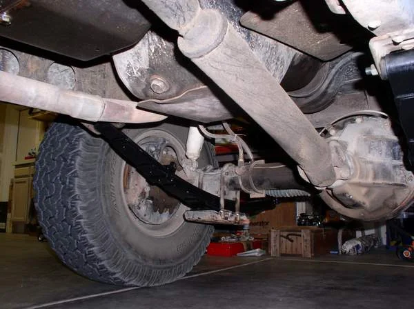

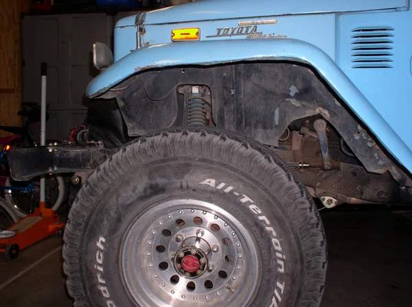

Here's some pictures of my install. It came out nicely.
I am stunned by how much room is now available in the wheel wells. Looks like I need new tires (35's)
Right now, the only problem is my rear brake line. I have the Raybestos BH38009 (5" Longer) hose on order - the stock length is tight as a banjo string. I want to go wheeling, but the first time that axle drops - POW! No brakes.

For the rear line, you can mount an L bracket upside down from the frame channel where the metal brake line transitions to hose. Then move the factory line anchor onto the new L bracket. Should net you about 4 more inches of travel.
