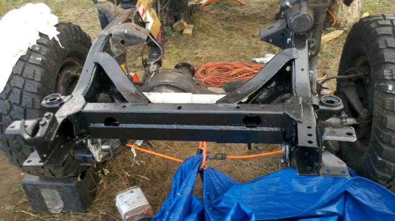

Well, while the driver's side is still "loose", I went ahead and cleaned up the the top of the rails and the rear shock cross bar, along with the other cross bar in front of it.
Got the rust off, Metal Blasted it, put two coats of Rust Bullet on them and then the Rust Bullet Black on top of it. Looks much better
NOW I can finish the lift kit by installing the driver's side and tightening it all down.
Pic of the cross bars
Pic of the frame nose, painted black

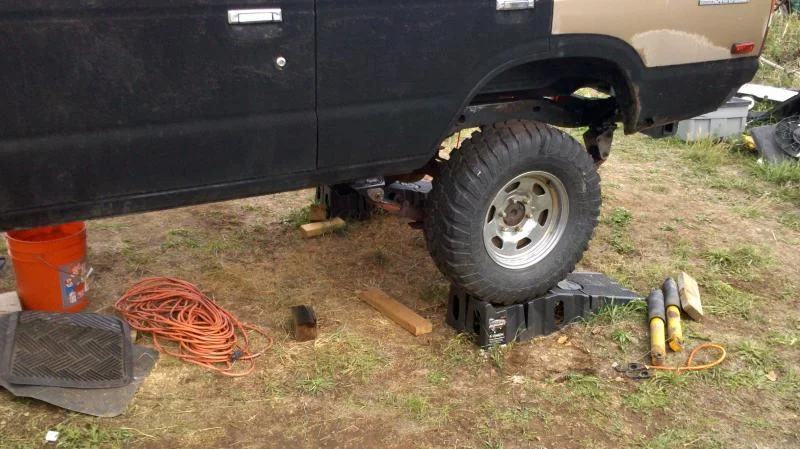

And today, the lift kit is installed and DONE - It took so long because I could NOT stand to install the kit on those rusty mounts. I just HAD to clean the rusty out and get them painted for the future! I started on August 8th, so 1 month and 1 week, working an hour here and there. Compare lift with the following post: https://forum.ih8mud.com/showpost.php?p=8716082&postcount=106 Definitely can see the lift difference
Pics of the rear and front pucks on both sides (PS painted black, which I will also do to the DS one to reduce the stark of a white puck on black frame)
and pic of DS rear tire. (Note all tires on also on ramps to allow working under the body - it really helps keep my head from hitting things)
The point of interest is the distance between the top of tire and the top of the rear wheel well. Definitely an increase of distance.
The tires are 31x10.50x15 on 8 inch rims. They look too small now, so I gotta fix that.
Will continue to work on most of the frame (save for the power train mount points), getting it cleaned and painted. More wire brushing to go.
Decided to just cleanup and paint the rear cross members and wait on pulling the C channel supports (in pic 1 below) until we do the new rear bumper (with spare tire carrier and gas can carrier swing outs). Jake pulls the C channels at that point along with the cross members, as well as the receiver. So all that will be done in the future - ie when the money arrives - and the frame will be fairly well done.

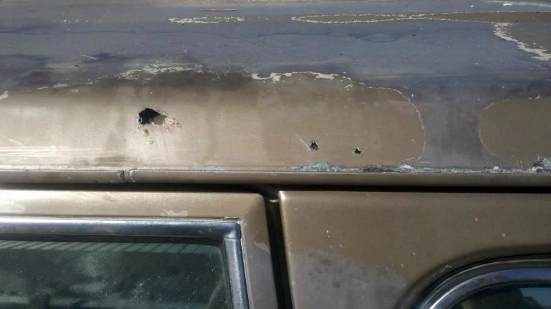

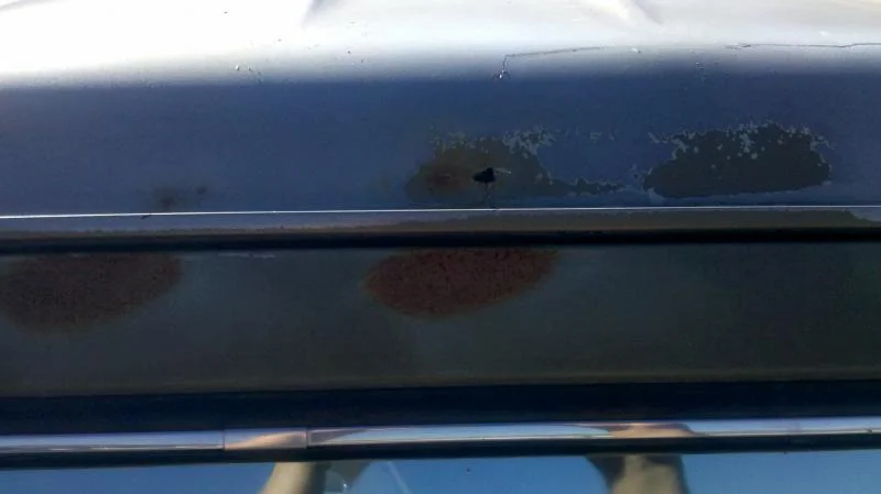

I already knew that my FJ60 needed some work on the rear quarter panels due to the rust (or holes) found there. I have a plan to work on that....................
but I have found that my cruiser has UPPER CRUISER CLAP!
In prepping the truck for parking this winter I am repairing the rain gutters because of pools of water in my DS and PS foot wells after rains happening here. So started cleaning the sealing compound from the gutter on the DS. Rusty in there, but cleaned up and put some Metal Blaster on it to get that rust out.
Then working back, I kept cleaning and then saw some serious rust spots on the root at pillar C, poked at it with the wood chisel I am using to get the compound out and poked a HOLE through the roof. Upon going around the whole gutter, I found 3 areas total doing this.
One above DS pillar C mentioned
One in the back above the hatch and
one area in front of PS pillar D.
Dang - a rust hunt is on.
What are my options to fix this?

pics below show the above areas/
Ignore the rust on the hatch in pic #2, the ENTIRE hatch is being replaced with a great one I got from a mudder in TN. It just needs painting.

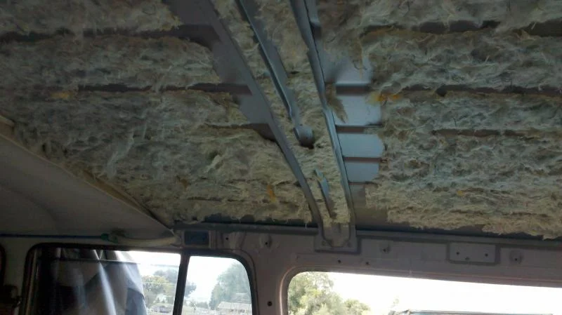

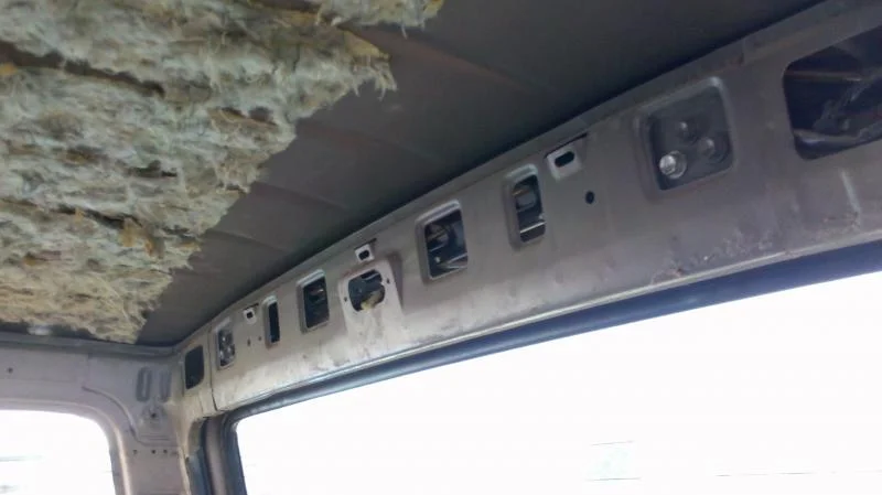

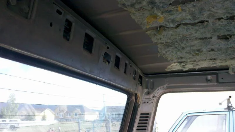

got some time yesterday to:
take out the rear side windows
pull the back size of the headliner
look for the rust on the roof and edges
No rust on the window frames - good
cannot see any rust on the main roof - good
from inside, I can see light through the holes in the root - bad, yet visible.

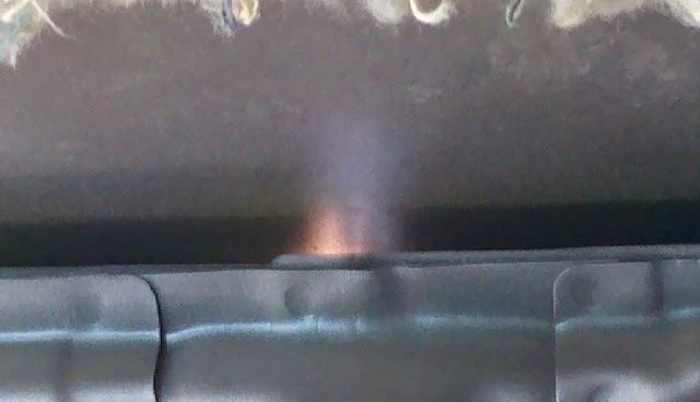

I know now what others have said about the glue holding the insulation to the roof. Any suggestions on a solvent?
I really haven't been able to find pictures of the roof w/o the liner, so here are some.
pics 1-3 are looking to roof from each side and a pic of the rear roof line
pic 4 is out of focus b/c it is too close, but that light streak is the rust hole looking outside.

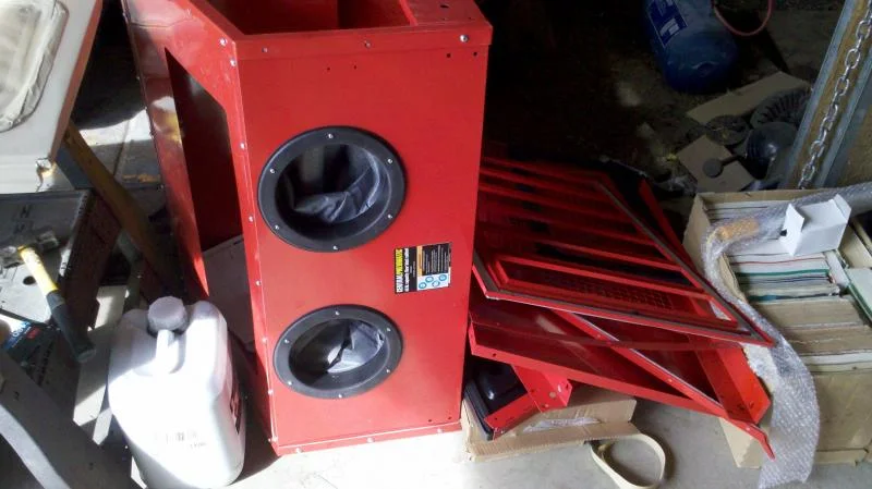

pic 5 is a set of parts I bought for a encased small parts blast cabinet. I started assembling last night - GREAT, we have lots of small parts that need blasting

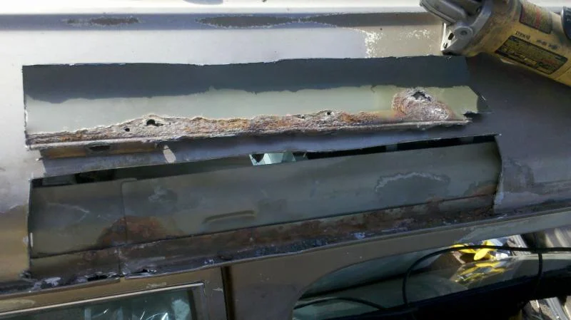

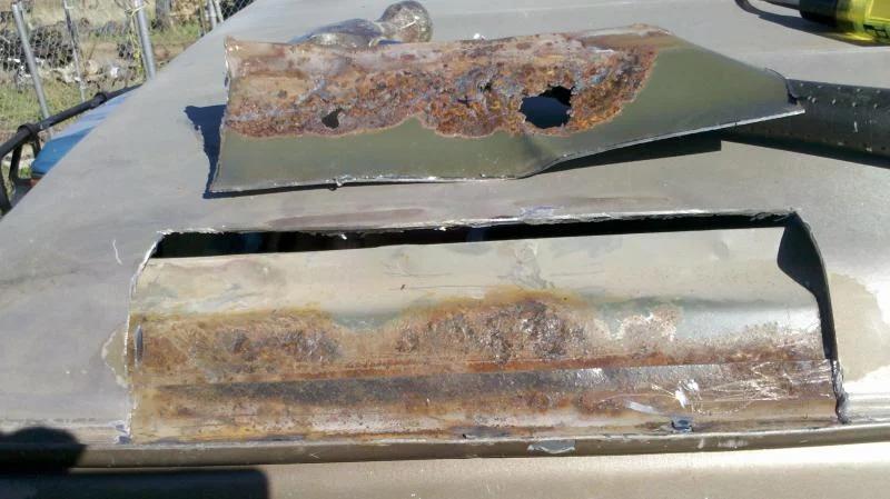

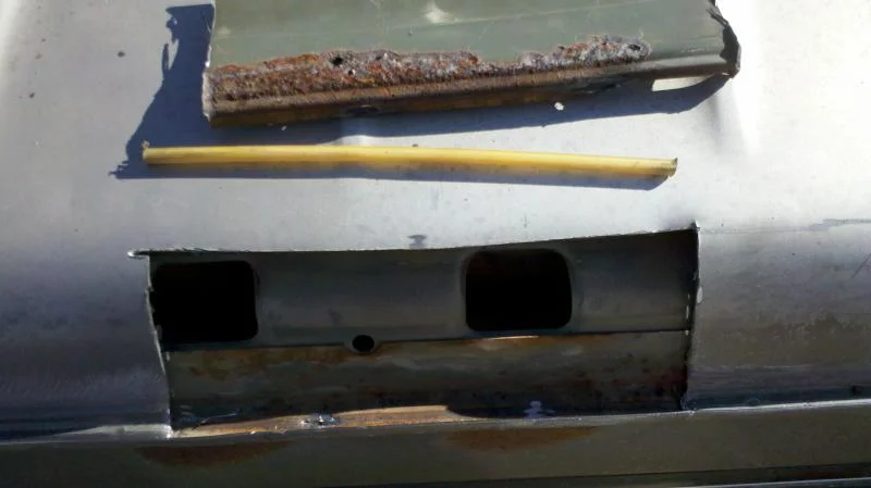

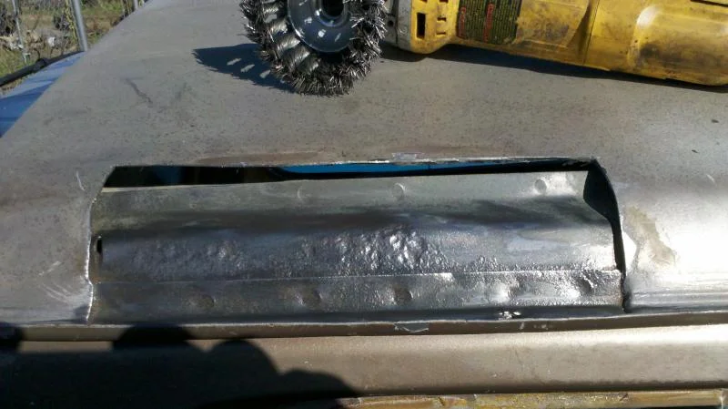

65 degrees today and lots of sun, snow melted and I decided to do something which I have no idea how to do it OR, more importantly, if I can fix it afterward: Cut holes in my roof..........OW
pics are below. I did the PS one first and learned that spot welds are hard to separate. I used my narrow wood chisel to s-c-r-a-p-e the sealant out of the gutter, took some work, but got it out. Later I learned that the DeWalt wire brush head stripped out all that sealant like butter under a hot knife. The rest of the sealant will be quick.
On the second cut, I said to myself: Maybe the cutter wheel will trim down the spot welds enough to get them off. It did, just be careful, wear down the top part of the weld, a little push with a screwdriver and pop, they come off. On the third cut that guy just came out. cool.
I took pics of before and after I took the wire brush to on the first cut. Sprayed Rust Bullet's Metal Blaster and made the rust go away. Cuts 2 and 3, just the before cleaning them up.
I figure I will spray Metal Blaster into the roof edge seam connections a couple of times, allowing it to dry, then squirting the ATF into the entire roof seals, like Kevin did, that will slow down the rust. I hope.
Or I could figure out a way to spray the Rust Bullet down in there.....
Kevin mention drain holes in the pillars....need to figure out how, w/o cutting them open
now to come up with some new metal to put into the holes, and learn how to weld them up....more things to learn on this project
dougbert

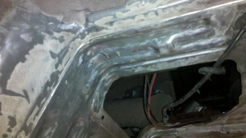

pic 1 just open roof on PS and what it looks like
pic 2 after cleaning it up with the rotary wire brush
pic 3 rear, above the hatch opened up. And yeah, I cut through the rear window washer hose - doh
pict 4 DS side above C pillar, opened up
all three now are cleaned up and metal blaster working its magic on the rust

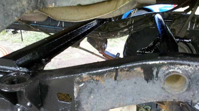

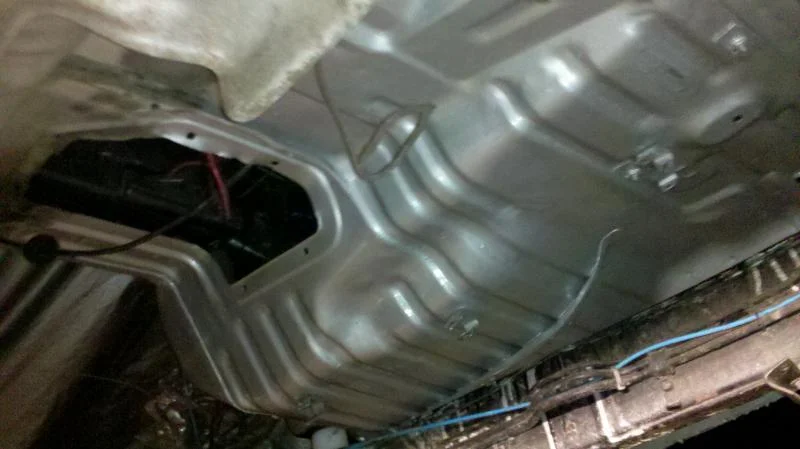

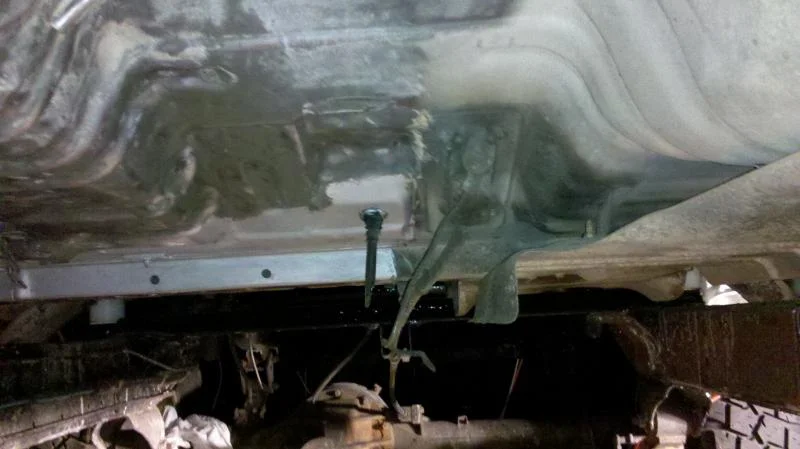

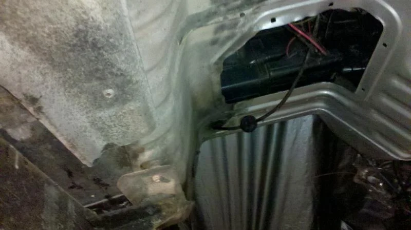

yesterday was the frame again and the underbody
cleaned up a section on the PS and under the floor bump and then painted 1st coat of Rust Bullet.
Using the high speed wire brush to clean off dirt and grease
pic 1 - looking toward the back, "cleaned" on the left, still dirty on the right, where the E-brake is
and man is it DIRTY and GREASY on the right. The e-brake case is so black
pic 2 - looking up the tranny stick hole, PS on the left
pic 3 - PS inside of frame looking toward right rear wheel, yet to be cleaned up, and the under-floor cleaned up
pic 4 - PS foot well after one coat of rust bullet
pic 5 - looking forward at DS foot well yet to be done, mostly the heat shields, under the well.
I have decided to do small (doable) sections, as I have just an hour here and there, and it does not overwhelm me looking at ALL of it yet to be done. I have don't have place inside to work on it with all the big equipment (I have access to such when needed, but it is a shared resource), so I work in the field, and do a little at a time.
