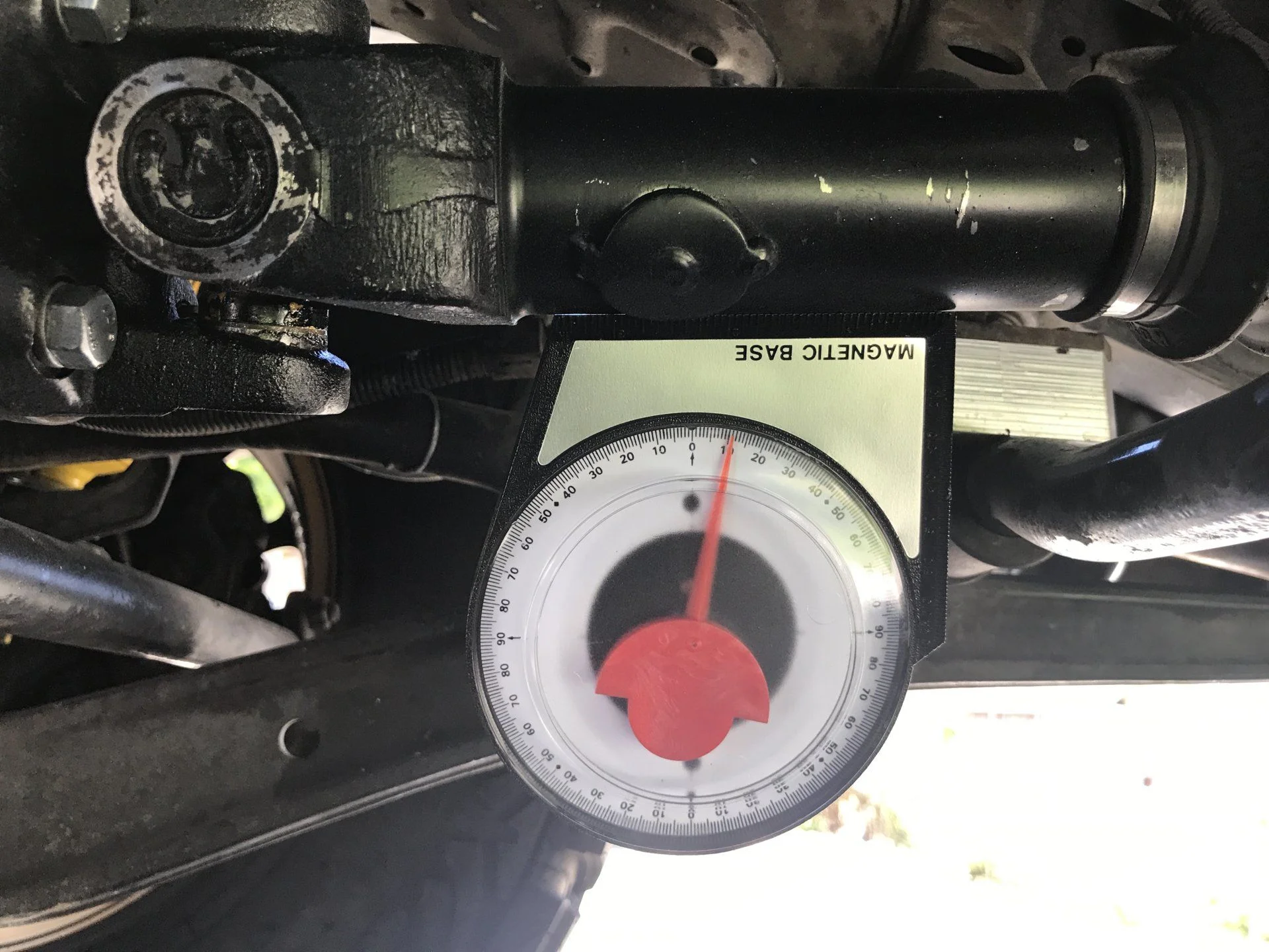

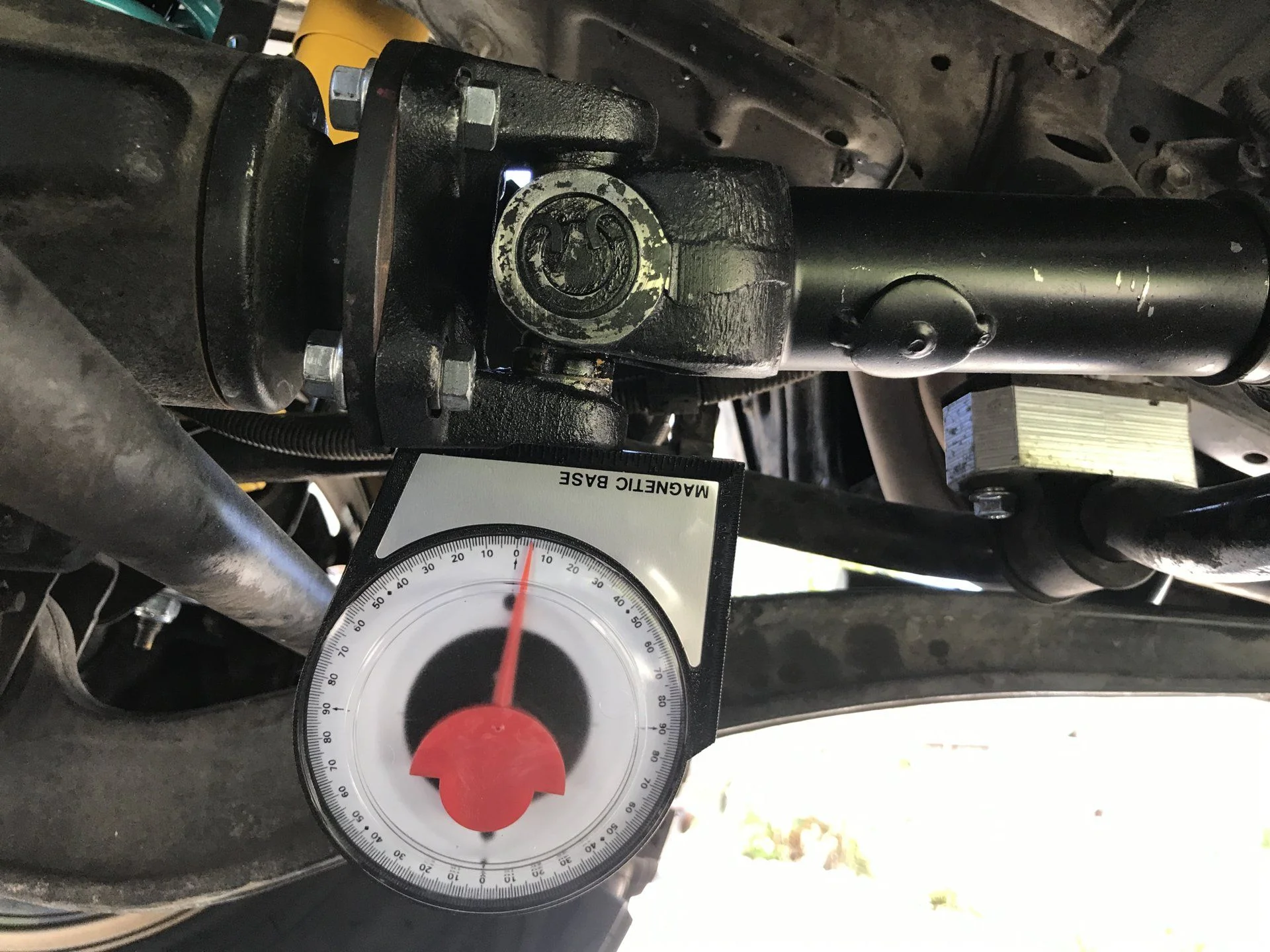

See below for the photos. I verified the angles with my iphones level app as well. Speaking to Tom Woods he mentioned that difference is typically not enough to be problematic. That being said, the noise disappeared the other day, and had only come back sporadically. Clearly I have more diagnosing to do but I'm starting to suspect the noise is coming from elsewhere.
Measure the pinion angle at the flange like in the pic below to give a more accurate reading (just to be sure).
