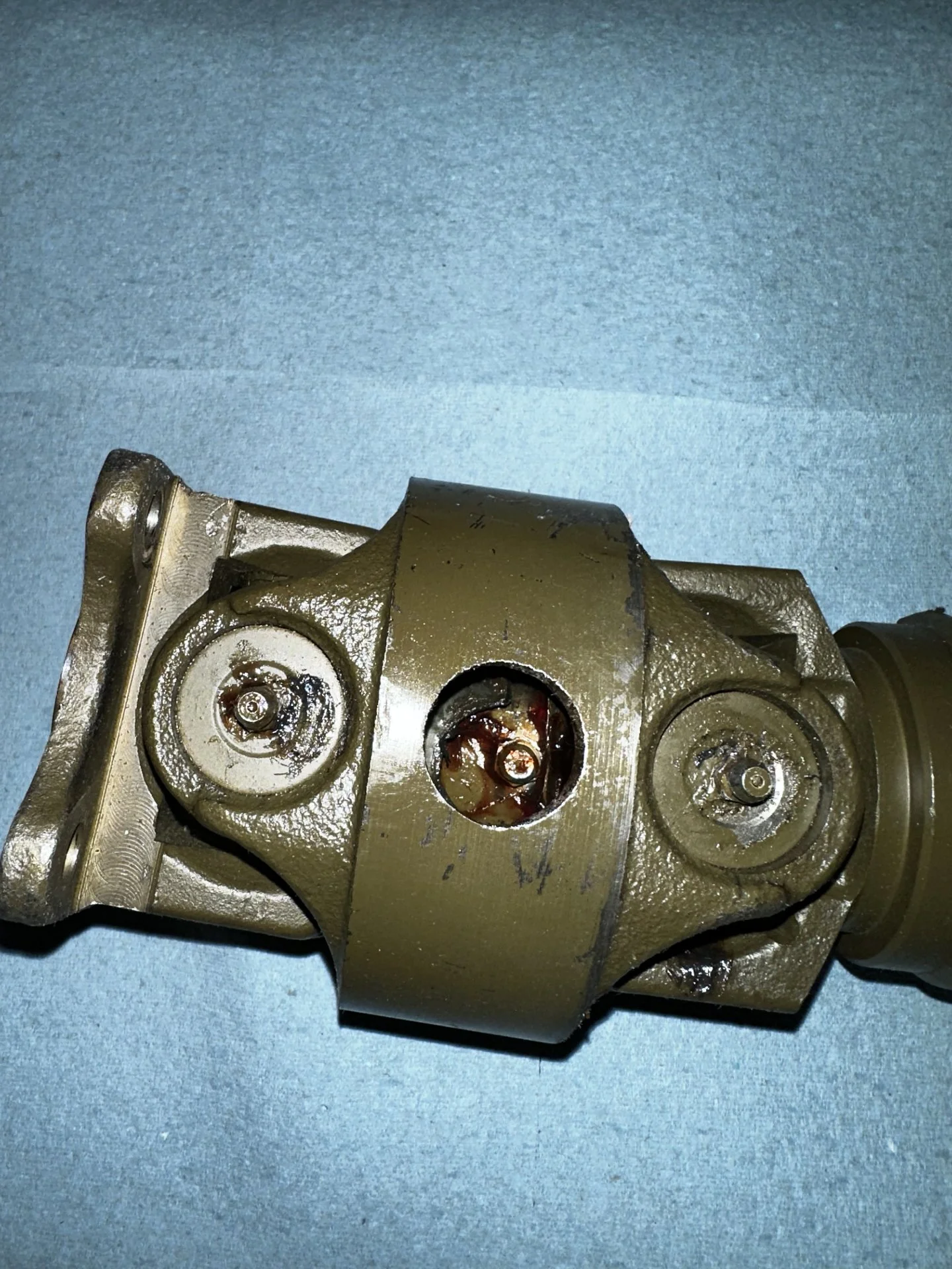

TW DC shaft is going well so far. To note - toward the end of the first tank of gas, I thought I had a mild front vibration at times, though not like before. Checked for play and then topped off with red-n-tacky. Joints seemed to take more grease than I thought, and the first “purge” was very minimal before clean red stuff came out. They were greased from TW (white/no color grease) but maybe not enough? I’m usually one to check those things from square one, but skipped it. Feels all good now.
2 of 3 zerks were loose. Also a good thing to double check from the start - glad I poked around.

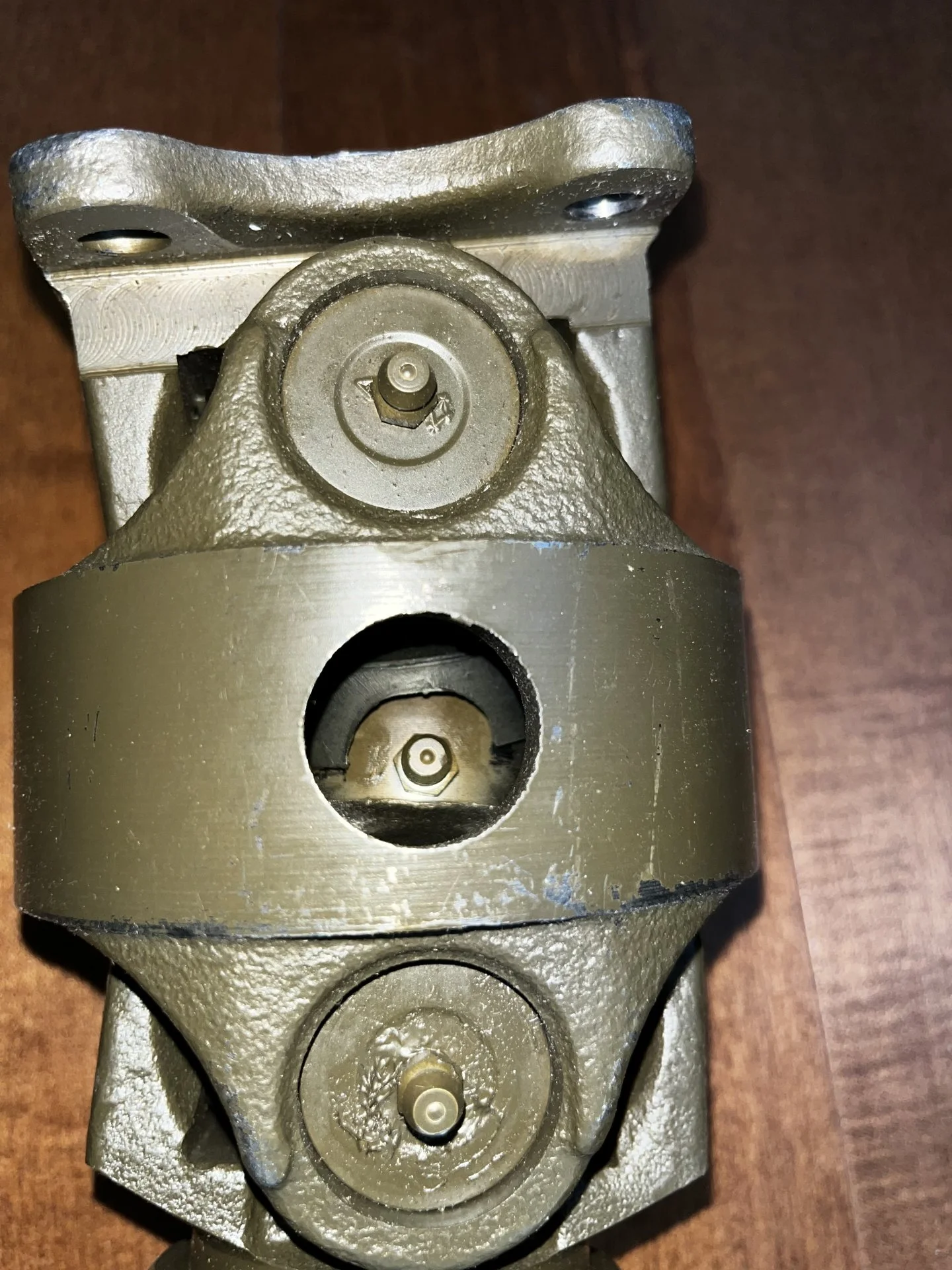

With the plews 05-019 needle they recommend, I was able to grease the DC ball without removing that end. Barely took any grease, so that part was fine. They supply a plastic adapter but the plews looked to be a better (necessary?) fit

There's a small ball and socket that keeps it all centred in there and it needs to be greased

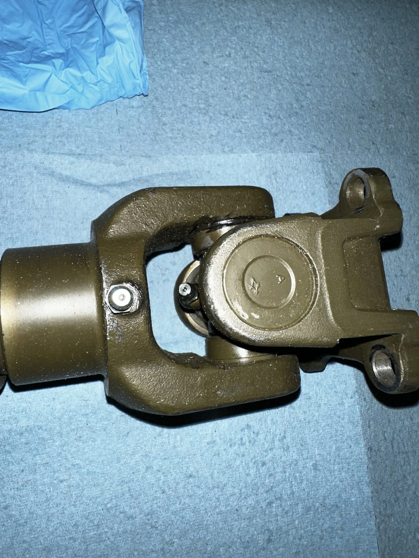

I'm still running your og shaft and wanted to get confirmation that the DC end has two zerks and not a third ball joint zerk like the new model? Many thanks.
the CVs with outer clips also have the third zirk but you need to rotate the shaft so that it gets exposed. The best idea is to drop the shaft and find it as it can be in a couple of locations. The shafts I sell now makes greasing a breeze.
So there is a third zerk in mine above? I can easily access the two at the joints. Could not spot a third in the middle.
it's inside the joint. There are a few types used over the years but they all need the shaft to be bent at the CV to allow access. I know where to find them and it can be frustrating even for me.
Of course not one of the finest DC shafts from landtank, but the ball zerk on my TW shaft is definitely tight. It uses the flush style fitting that takes a needle adapter. The plews adapter they recommend is long and skinny, I can just fit it on there with the shaft rotated the right way. Wonder if that's possible for you as well. And like he said, even though I know where it is and how to get to it, it's still kind of a B.
