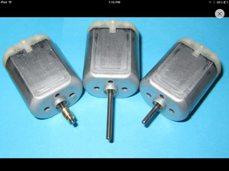

Which style shaft motor from photo below did you end up ordering...?
I ordered the smooth long shaft style from what I have been reading...Hope its the right one. I have a 1997 model fzj80.

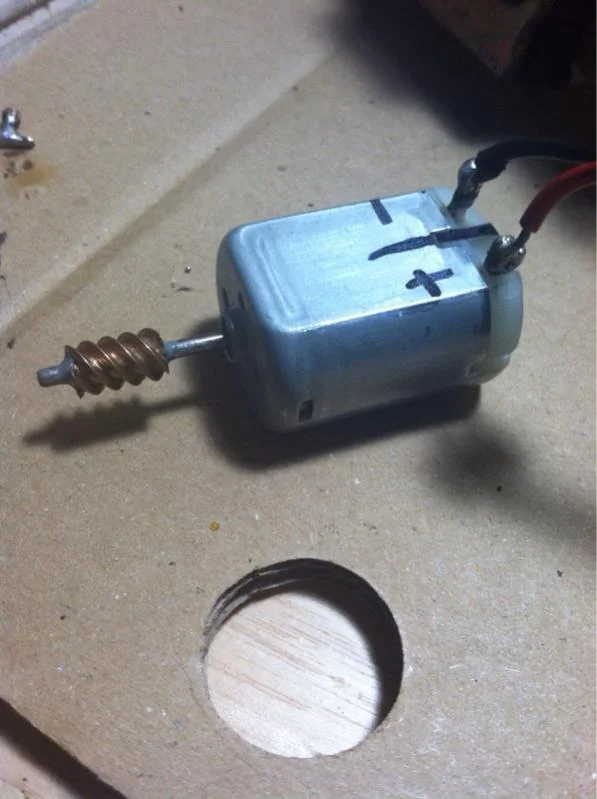

Bought mabuchi motors with 20mm solid shafts. Tap worm gear off blown motor... Shafts on new motor are slimmer... A little JB weld to hold the worm gear in place.
This is for a 1997 fzj80.
I'm sure jb weld will do the trick. I roughed the shafts up with my dremel and brazed the gear on with solder and a small torch. Seemed pretty bulletproof and works like a champ now.
Does someone know for sure which of the motors shown above is correct? Or, do all of them require some modification?
