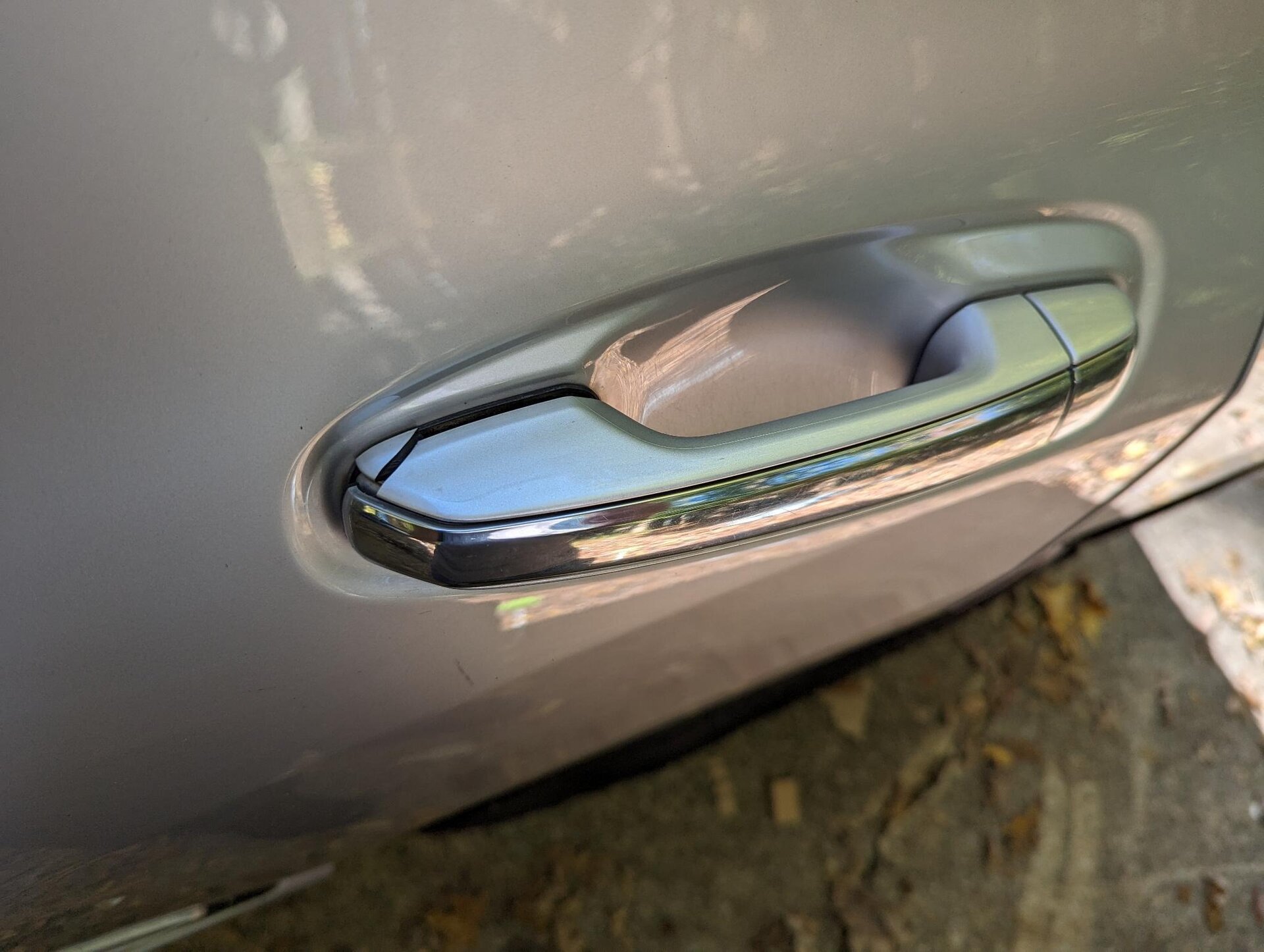

the one from bell comes with the chrome through doesn’t it, i assume the one from partsouq is full color matched correct?
I ordered and received a color-matched handle (for my RX) in Claret Red Mica from Bell. Different part numbers for different paint codes, usually.
This is my handle.
That part number is a direct US replacement with the chrome. You need to find the part number from the UAE or Japan that doesn't have the chrome strip. I'll see if I can find them.
