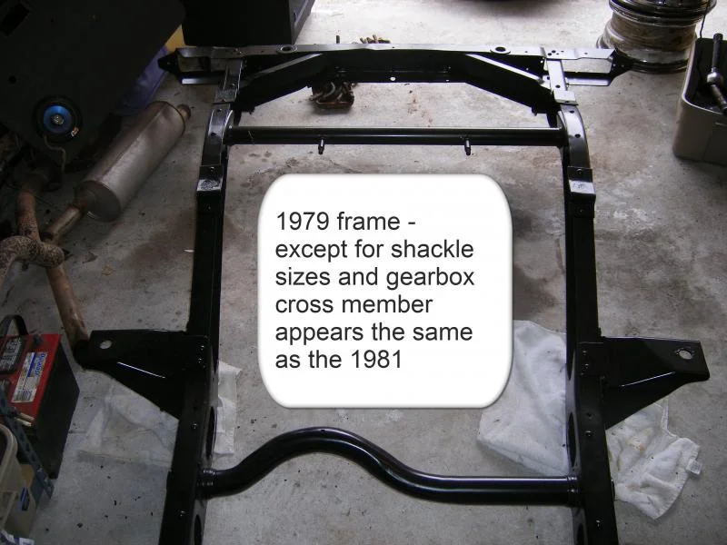

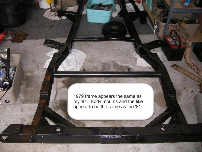

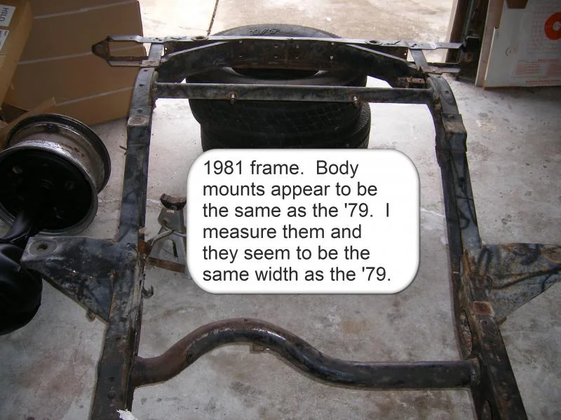

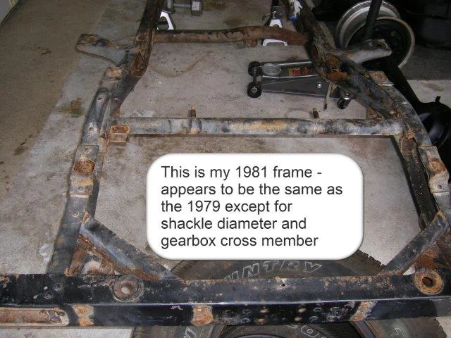

The Land Cruiser experts tell me that my old 1981 should fit a 1979 frame but i am starting to find out otherwise. I purchased a 1981 FJ40 and am doing a full restoration. The frame was rusted out so based on advice I purchased a good 1979 frame from Classic Cruiser in Colorado. I understood that '79 through '83 frames are the same. I have since discovered the following:
  • The cross member that supports the gearbox on he '81 is non-existent on the'79. I have to weld/bolt the cross member from the '81 to the '79 frame. Kind of a shame as I have already sand blasted and powder coated the frame.
  • The springs are different in that the shackle bush "eyes" in the '79 are 25mm whereas on the '81 the are 35mm. The springs are 35mm too.
  • I hear the gas tank fittings are different as is the hand brake.
  • And worse, i now understand that the body will not fit - but when I look at the two frames side by side all the body mount looks exactly the same and measure the same.
I was told that late model '78 Land Cruiser were registered as '79s in early '79 and that more than likely I have a '78 frame. I am not sure what to believe at this point. Does anyone have any advise or experience with these year models FJ40s?
I believe I can take care of the cross member for the gear box and with the Old Man Emu springs I have I will be able to work around the shackle difference....but is there anything else?
Thanks for your input!

Thanks for the replies. I do not see provisions for the the fuel tank on the '79. Here are some detailed pics of what I have described. I have heard that that the '78 and earlier model frames are varstly different to '79 to '83. I think I can overcome the gearbox cross member issue and spring differences, but what I am worried about it what I don't know. What other issues can i expect if I keep this frame.

Much of the info you were told in your first post is correct.
With careful measurements, you should be able to position the later transmission cradle and drill and bolt it to the frame keeping your powder coating. The hot rivets holding the un-needed right side rear motor mount ear on the '79 frame can be ground and the ear removed. Need a bit of touch up paint to the frame.
If your truck was originally a North American import, the parking brake actuated the brakes on the rear axle, so you should be able to use what you already have.
There are various bushing options from OldManEmu, and several vendors on this web site can advise you.
Gas tanks from 1/79 up bolt to the underside of the cab, so you should also be okay there.
You already knew to expect a little fiddling, brackets, and adjustments when using different year frames and bodies--welcome to Mud !
Your 81 body will bolt right up to a '79 frame. I believe SOR sells spring bushings that will work with your frame/spring combo.
The crossmember is an easy fix. Just drill 4 holes on each side of the inner frame rail and bolt up the crossmember.
