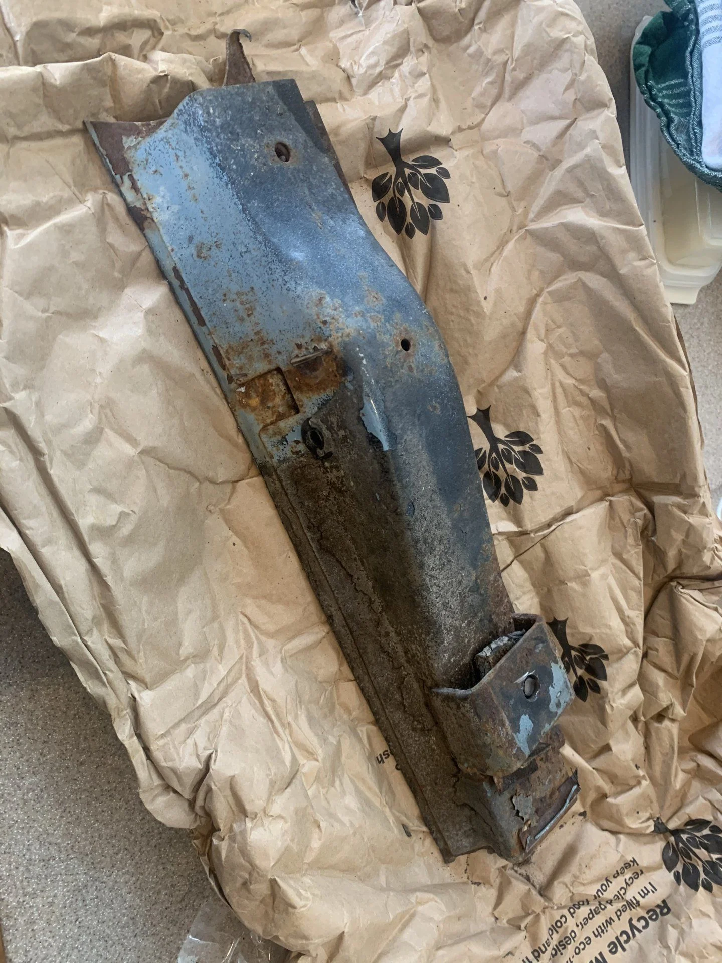

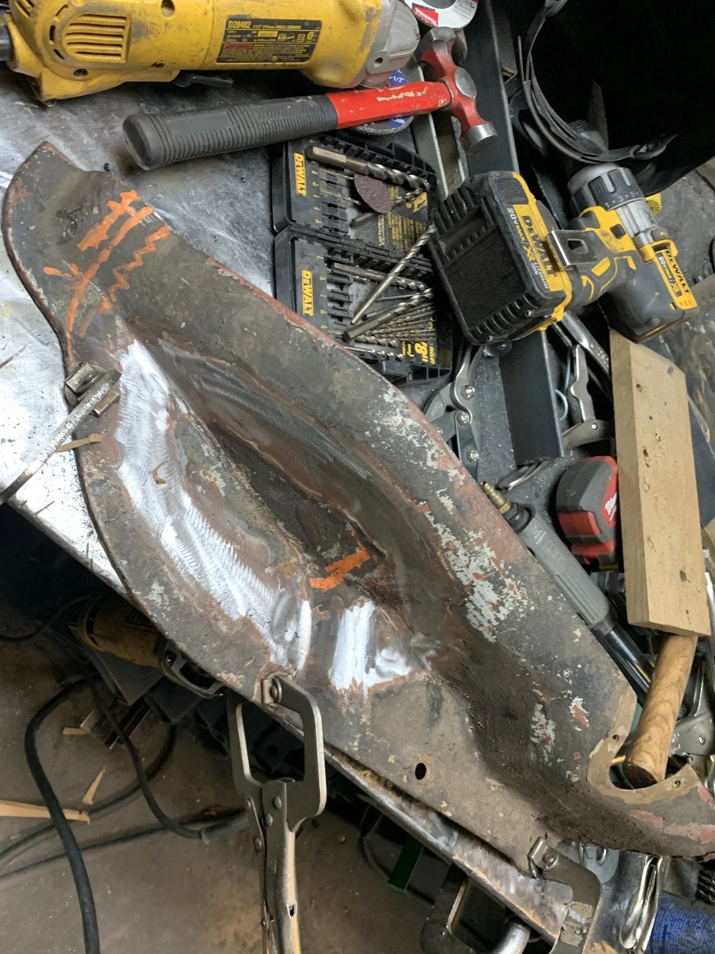

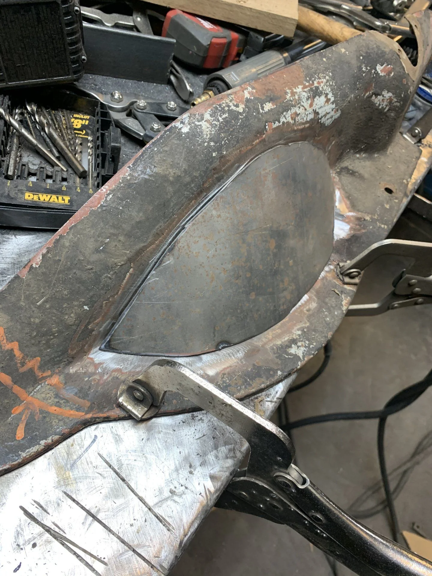

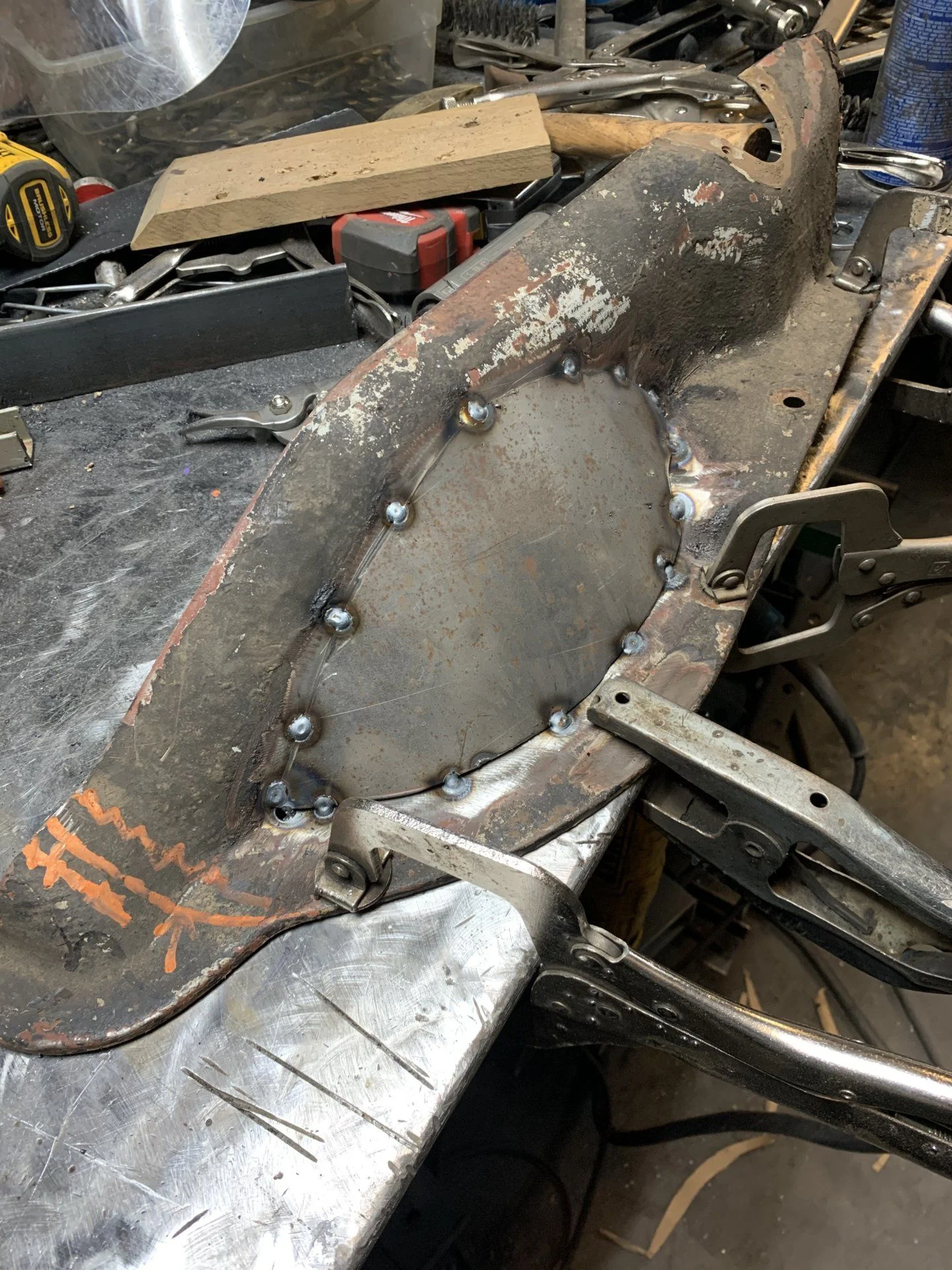

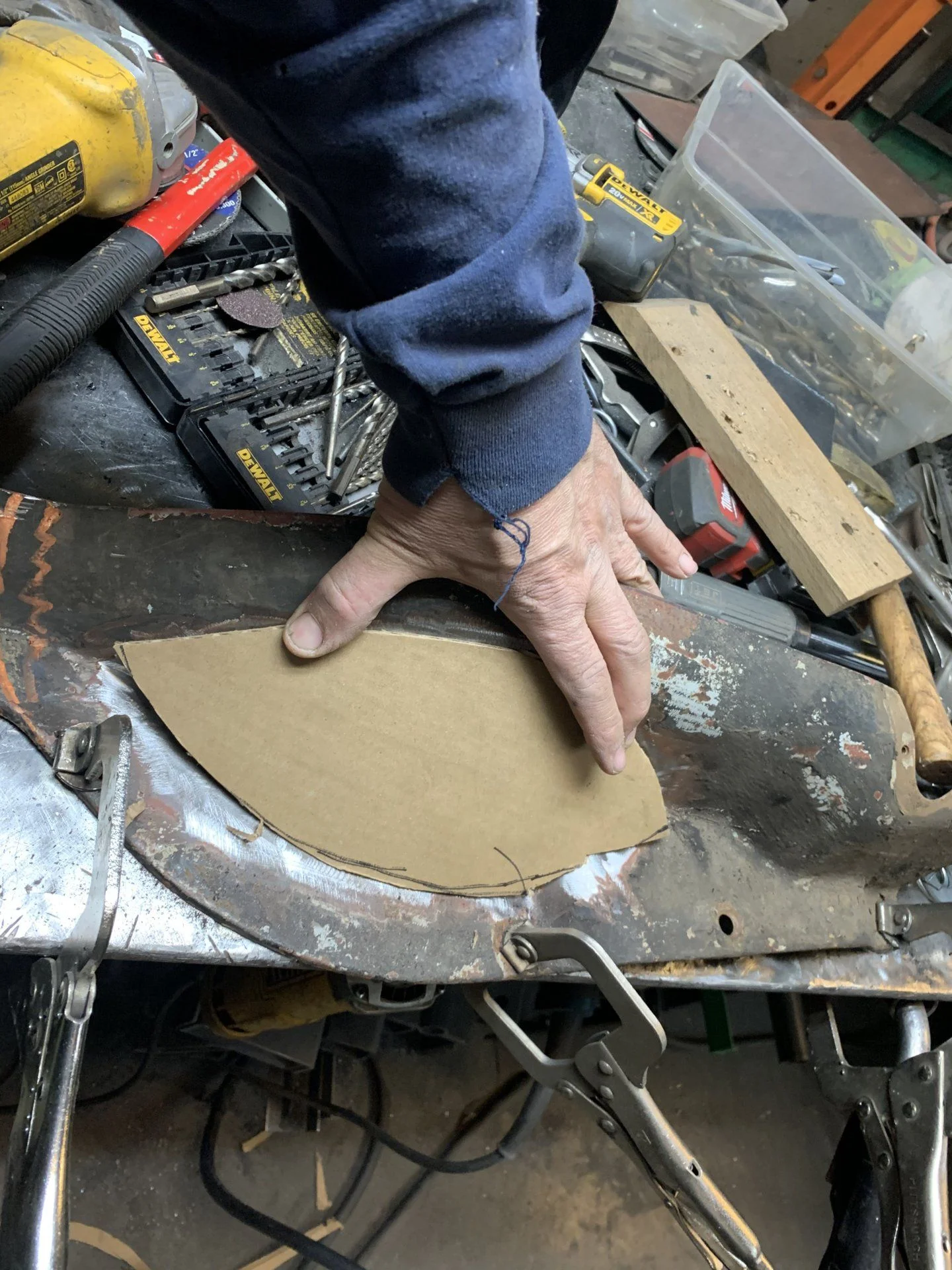

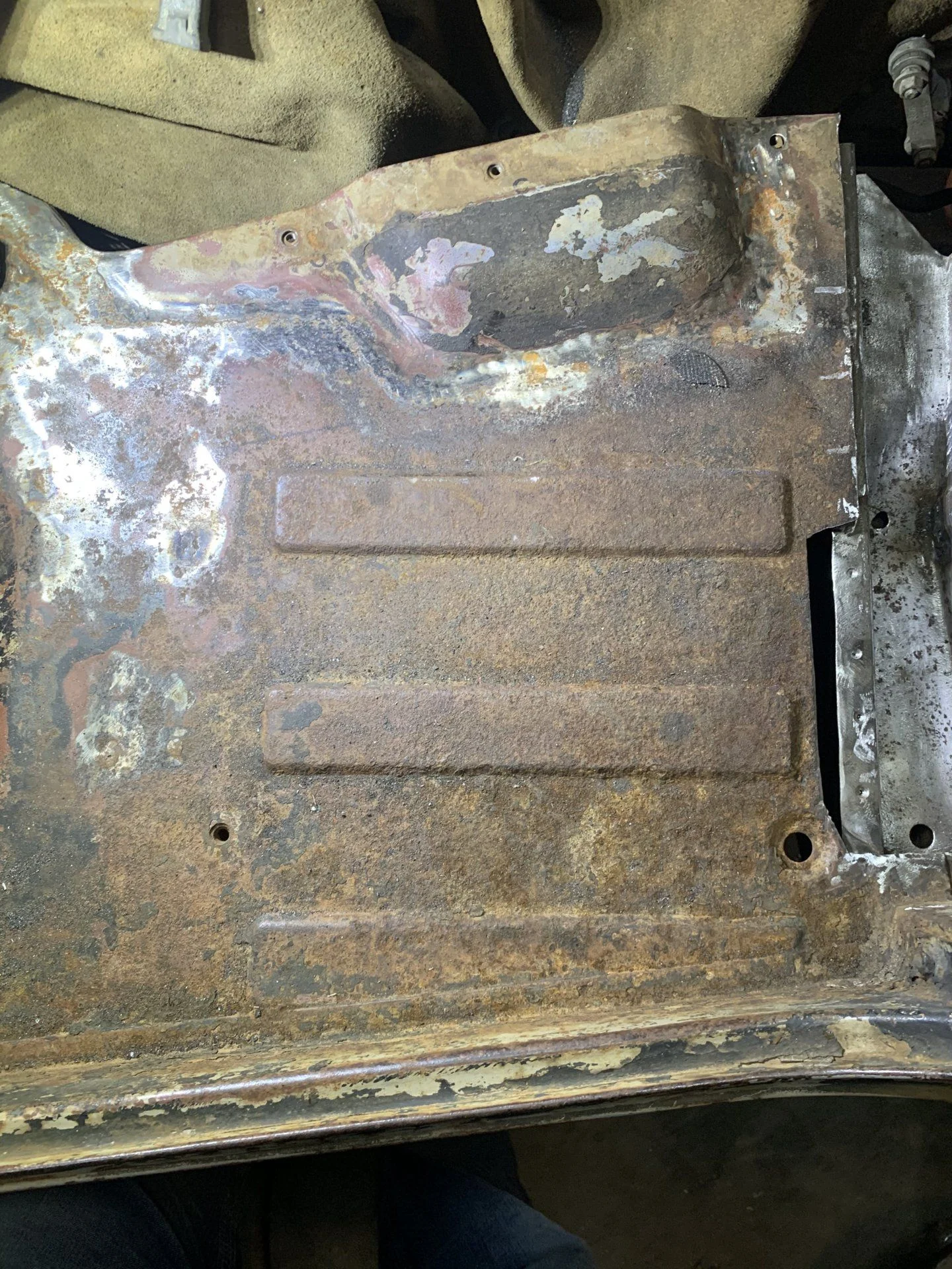

On closer inspection the entire bottom is shot. Will replace it.
Thanks go out to @Tank5 for sending me another bottom bracket. Hopefully it is hear early next week. I have a few more days until my tax season "deadline" is completed and I can spend some quality time on the project.

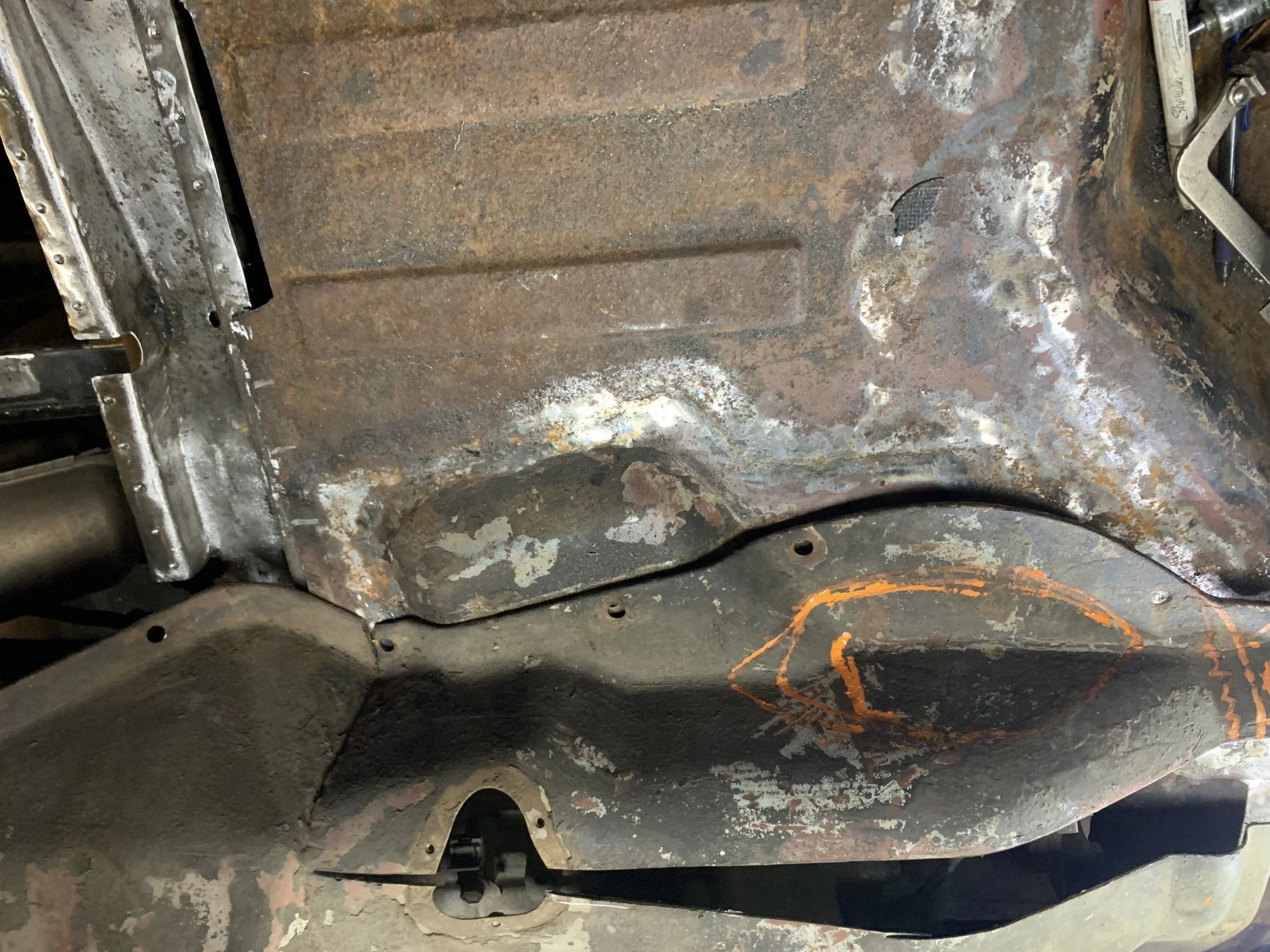

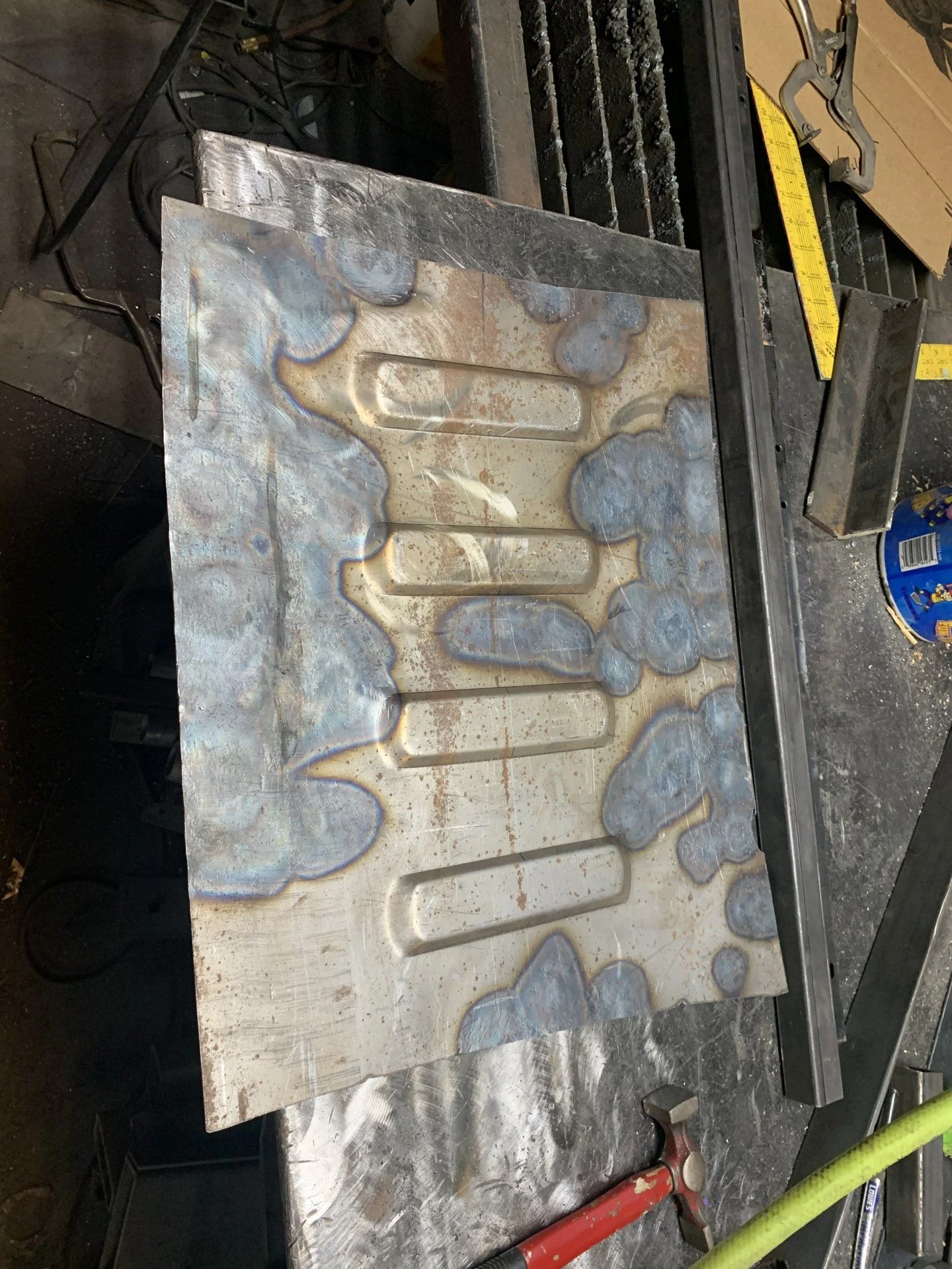

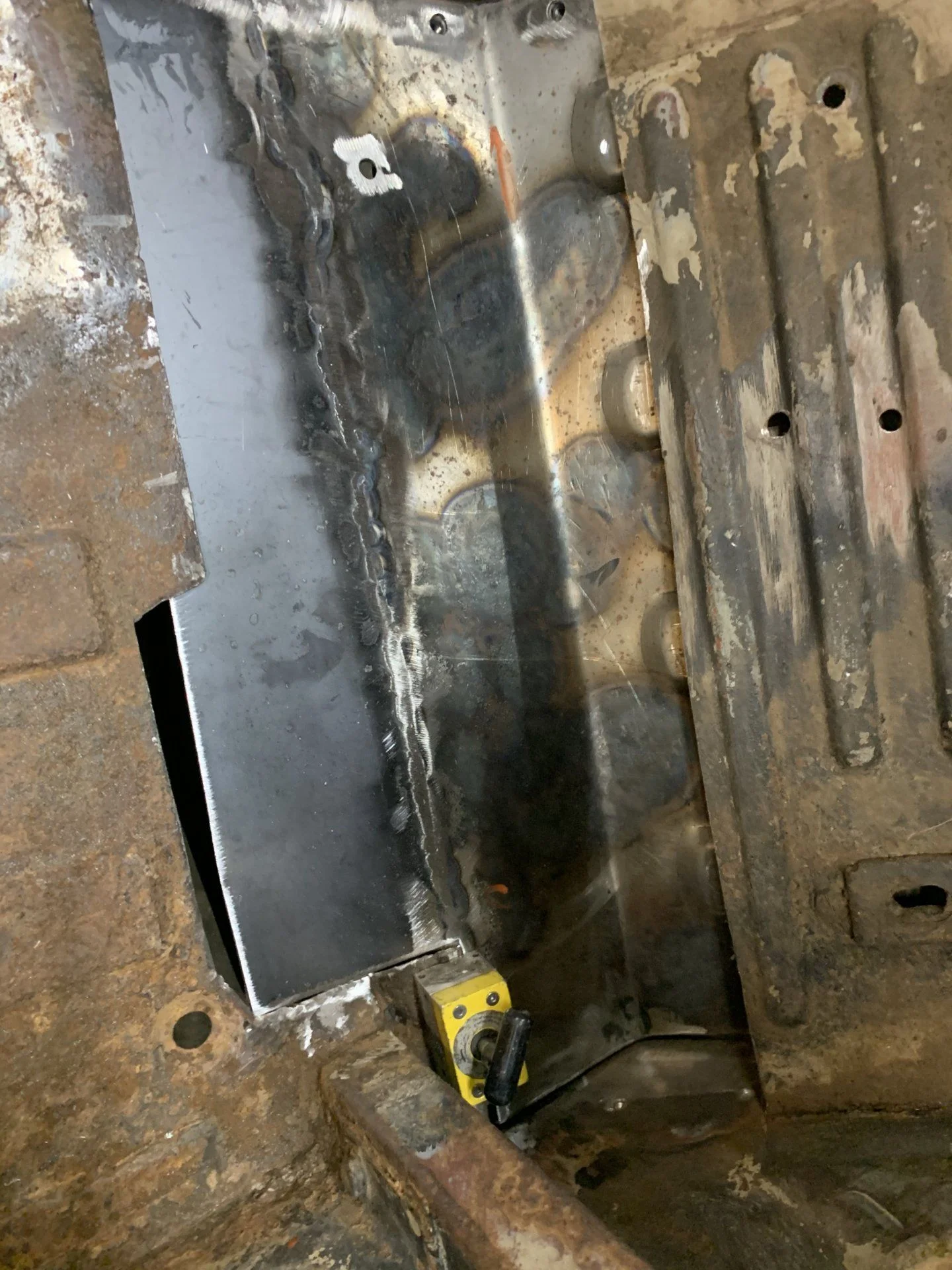

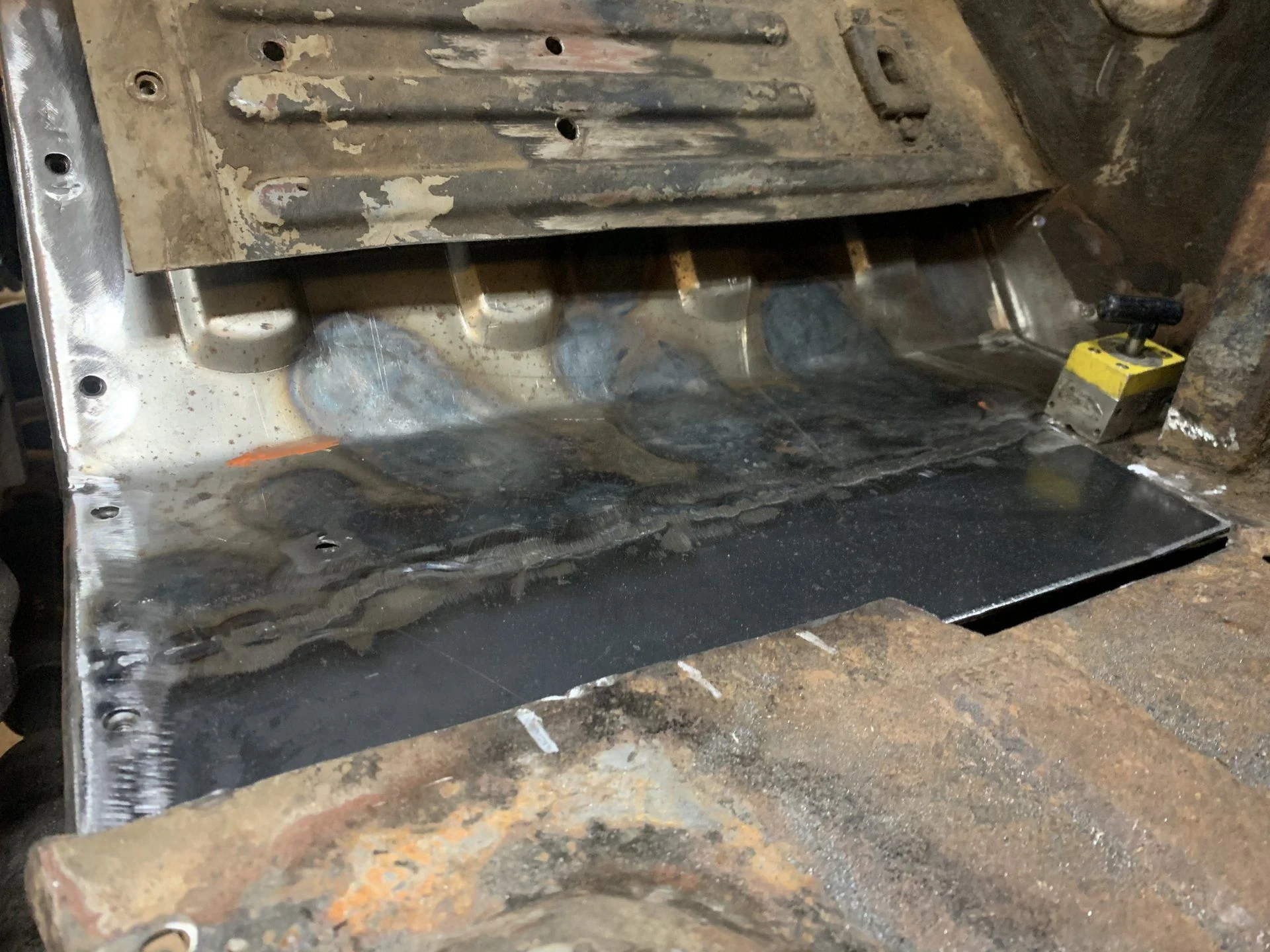

Started on pass side this week. I have not had a lot of time but feeling good about the progress...

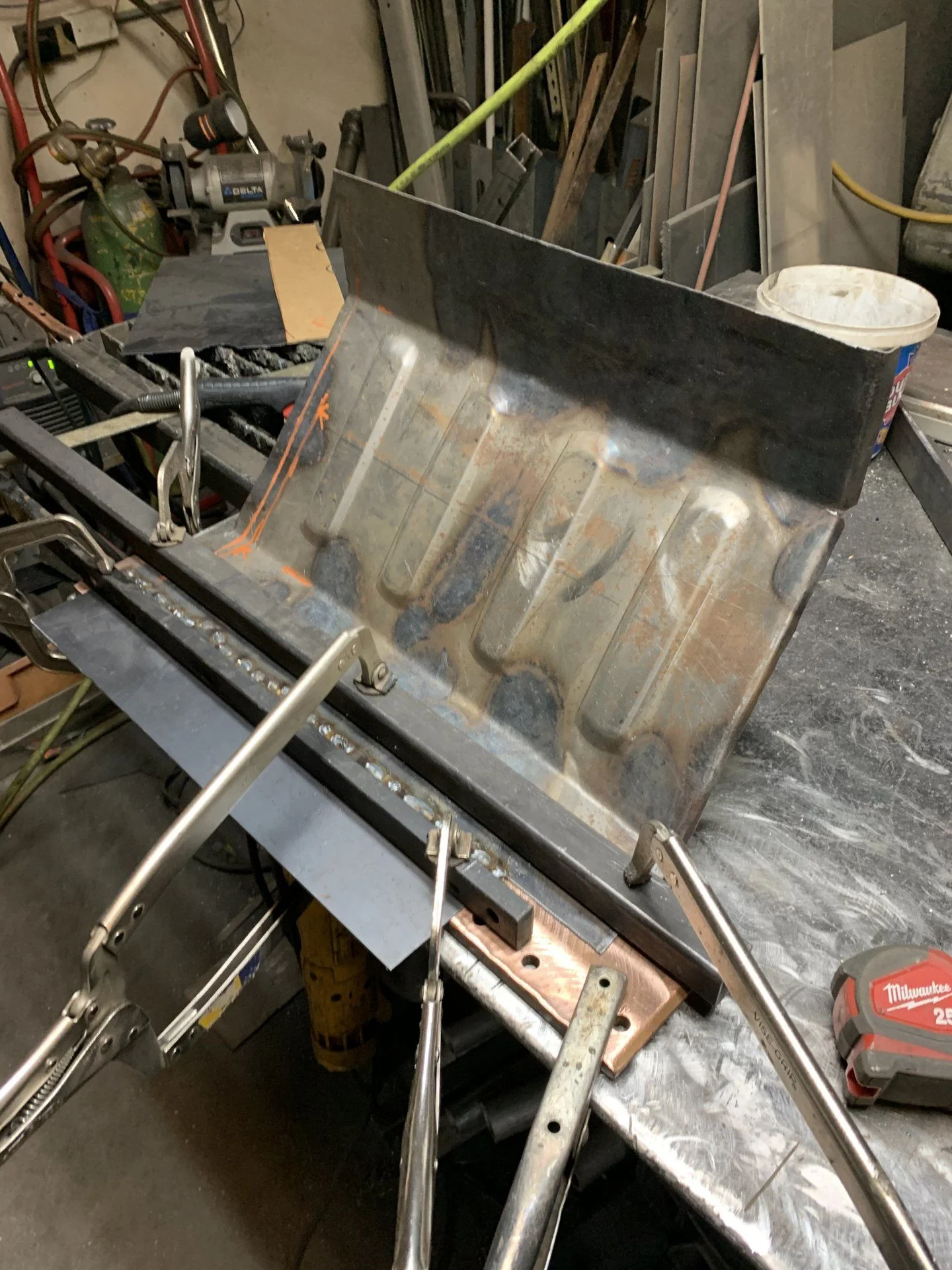

I use the English wheel to stretch the ribs before I bead them in. This helps with the distortion after. Especially when there is bending After it limits the amount of shrinking.
Have to give credit and thanks to @Tank5 ... he planned out the Tranny tunnel and really original way.... I was thinking about removing the hump on the passenger side and realized that someone had cut and welded it in and that’s when I remembered that the tranny tunnel was adapted for this
The locker actuator on the transfer case was touching the cover...
So I laid out what needed to be adopted...
A few minutes later

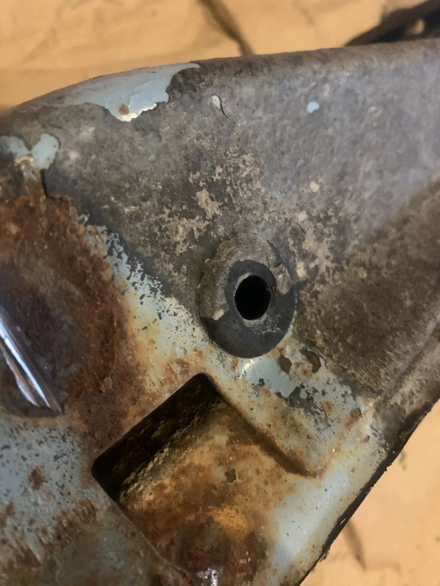

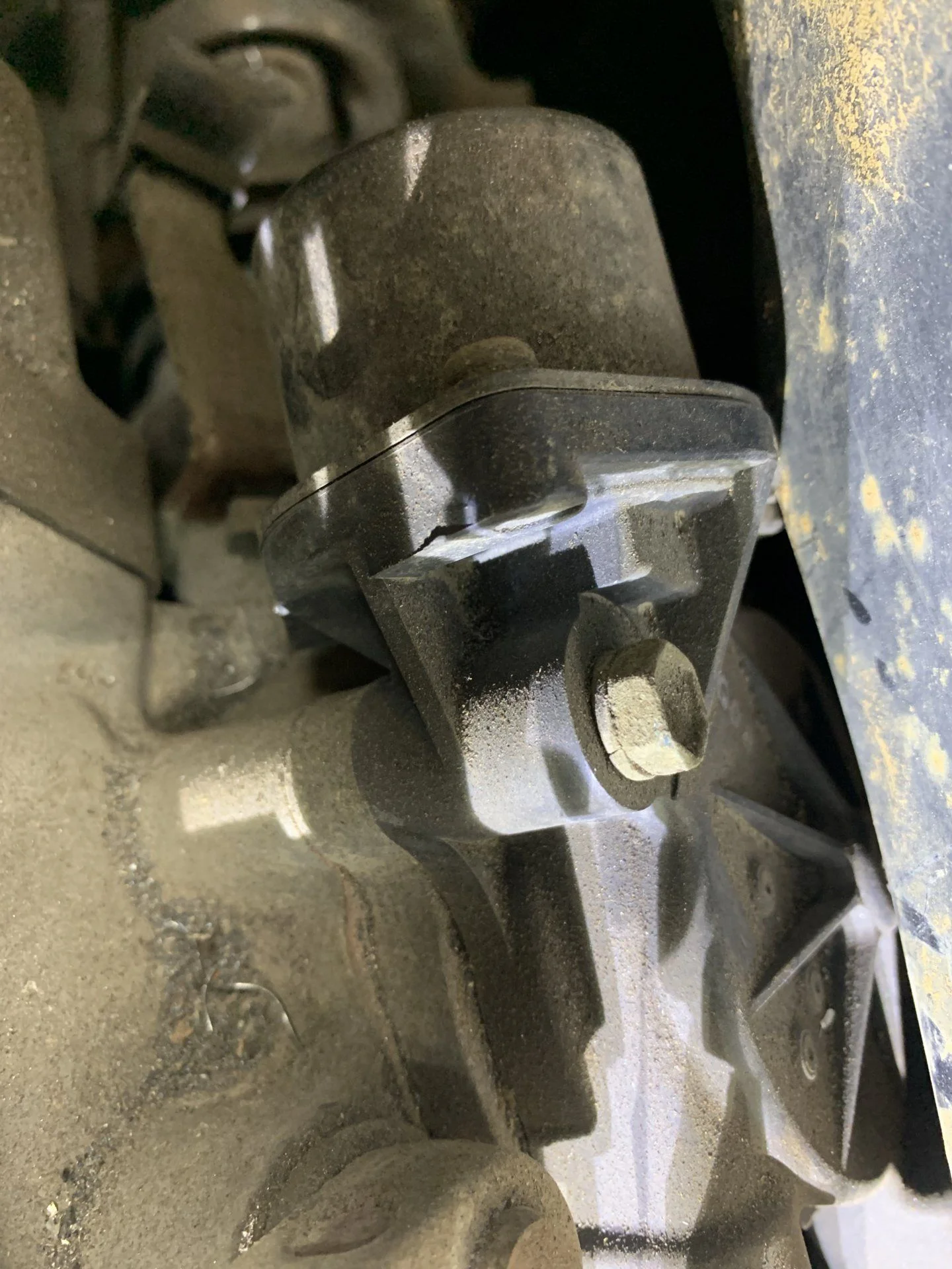

@Tank5 came through with another body mount... I don’t recall seeing a rubber grommet on these before, was there a wire going through this?
