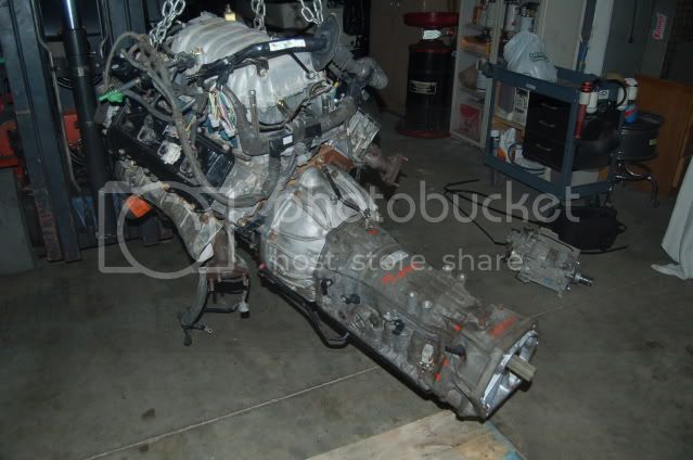

I found this 40th at a shady used car lot. Motor was blown and the interior was nearly trashed. Perfect, time for a 2uz 4.7l v8. That was 12 months ago. I’ve done some engine conversions on bmw’s, but this is the first Toyota I have EVER worked on. I struggled for 9 months (on and off) trying to get the vvti motor to work. I was unsuccessful. I finally gave up and just put the non-vvti motor in.

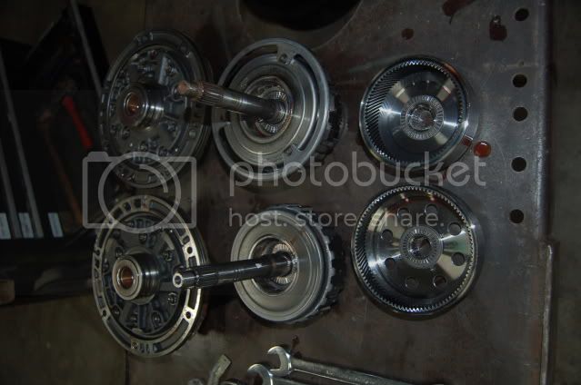

A343f transmission (96 cruiser) modified with A340 (04 tundra) parts. MANY thanks to Toojayzee!

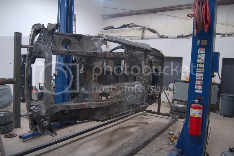

DECONSTRUCTION:
Motor out.
Power wash engine bay.
Remove entire interior including carpet.
Clean seats, panels, carpet, and everything else.
Modify trans tunnel.

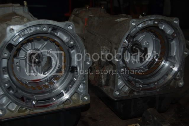

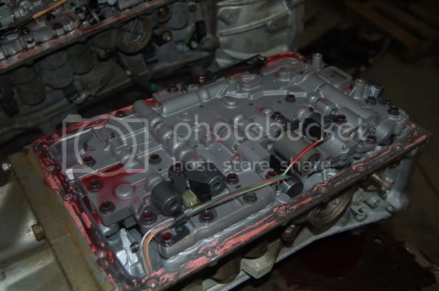

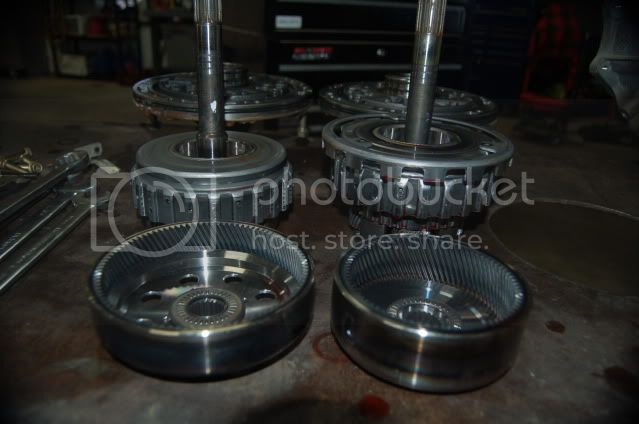

The next night, I yanked the vvti out. I was pretty bummed that i wouldnt have an a750f, but ...... at least i could drive it. I went and bought an a343f out of a 96 cruiser (seeing i sold my old one) and began work. I followed toojayzees thread and swaped the planitary, oil pump, speend sensor and valve body off the 04 tundra a340e tranny.
RE-PURCHASING:
I took a bath on selling the vvti parts, but i guess thats part of the learning process. (The buyer seemed like a real standup guy, he is here on the forums. To be honest, i am a bit envious that he will have the a750f. )

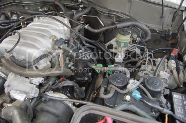

re-bought electronics, dme, evap and throttle body for an 01 tundra and swapped over the harnesses. Everything went together smoothly. Time to drop it in.
Fitted the motor / trans. reworked the trans lines, shifter linkage, made a transfer case lever adapter, reworked the exhaust. Now the wiring. I am not sure if it was "the rejuvination" of my spirits or what. But I found a lot of mistakes from my first try. Regardless, this time it started first try.

this was the first time i have ever worked on an automatic tranny. i was scared to death to be honest. but after diving into it, it was no more difficult than tearing apart a variable cam motor...... once you figure out how it works, it is not that bad.
