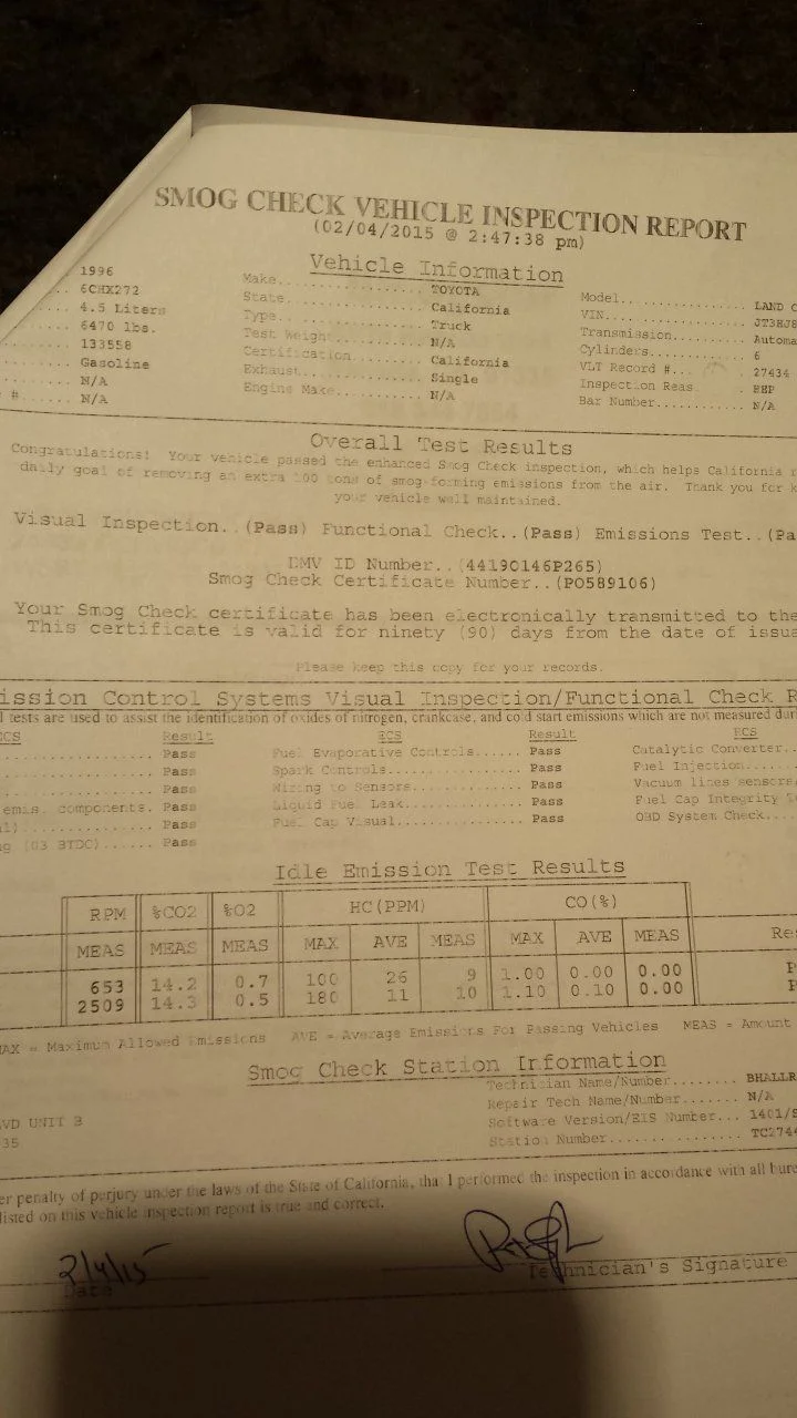

Thanks, I am actually do for smog I believe on my next Reg. which is soon. Keep you posted on how it does.
We don't have smog testing in Iowa if you want to send one out here to be tested on a 3FE... ;)
I Passed!!! with flying colors I might add. Smog Tech said it actually put down some ridiculously clean numbers.
And it was a STAR smog that was required.
